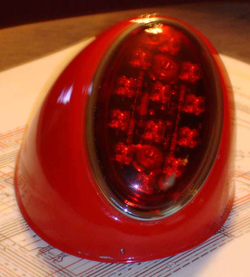

I had seen this thread and I bought some of the Beetle Eye Taillights to see if they fit. So with a little modification they will fit better but for now it is going to work like this. thanks for posting the web site for the lights

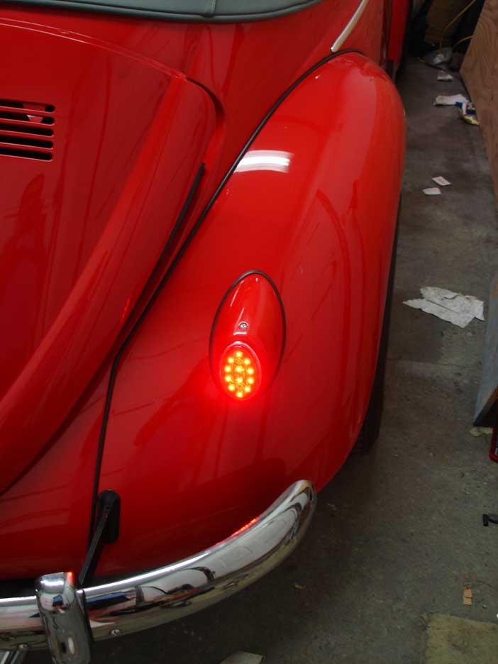

PostPosted: Sun Aug 31, 2008 8:58 pm    Post subject: beetle eye tail lights Reply with quote
A little fab work the beetle eye tail lights do fit

PostPosted: Sun Aug 31, 2008 10:05 pm    Post subject: Reply with quote
No kidding! That's awesome! Glad to be of service.

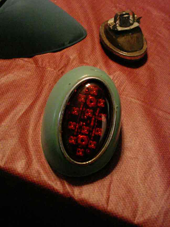

PostPosted: Thu Sep 04, 2008 6:43 pm    Post subject: Beetle eye tail lights Reply with quote
hope this help's

volksauto wrote:
[img]
I see the two screws in the center of the tabs, I guess they're holding the light behind the tabs you fabed, but what's holding the tabs to the inside of the housing ?

PostPosted: Thu Sep 04, 2008 9:00 pm    Post subject: Reply with quote
And was there any modification of the physical light assembly itself to make it fit?

PostPosted: Thu Sep 04, 2008 9:44 pm    Post subject: Re: Beetle eye tail lights Reply with quote
mannys66 wrote:
volksauto wrote:
[img]
The lense itself.

PostPosted: Fri Sep 05, 2008 12:19 pm    Post subject: Re: Beetle eye tail lights Reply with quote
hermitkid wrote:
mannys66 wrote:
volksauto wrote:
[img]
The lense itself.
so without seeing how this guy put this together, you're telling me that the lense holds the tabs and not the tabs hold the lense? why dont we just wait for him to answer. the suspense is killing me, maybe not all that much, but I really wana know.

PostPosted: Fri Sep 05, 2008 12:38 pm    Post subject: Reply with quote
the light body looks squeezed between the lense and the tabs...
very nice mod btw...
