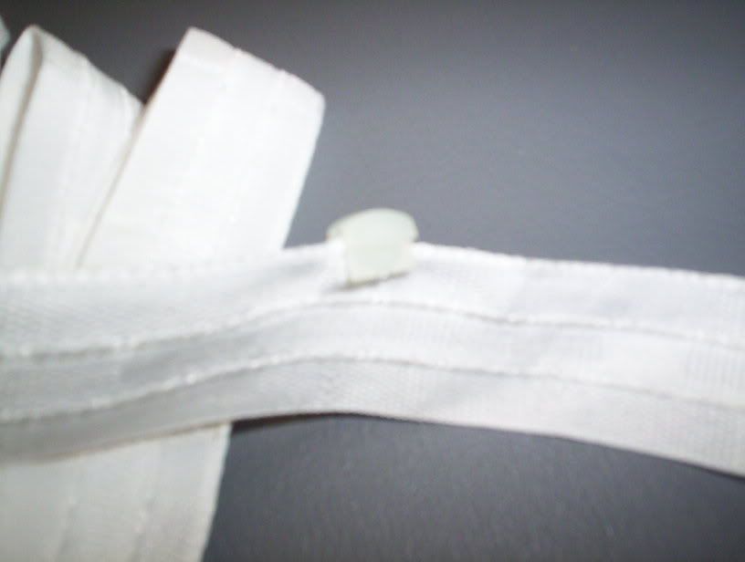

those may work, but i think you need these
Interesting. I already have about a dozen of those gliders in the rail, but after looking at the GoWesty web site I thought all the loops had snapped off mine! So the hooks snake around the tiny gap at the back of the glider, right?
no. these get stiched directly on to the curtian, then the whole shebang slides into the tracks. well, that was my understanding, and how i did my bus

Can anyone tell me how exactly these work. I have them in my 70 westy, on both driver and passenger side, and have no idea how to use them. Were making curtains, and need to know how to hook em up. If anyones got a picture of it i would be able to wrap my head around it a little easier
Are the hooks a seperate piece that hook onto these little buggers, and do they need to be sewn into the curtain?

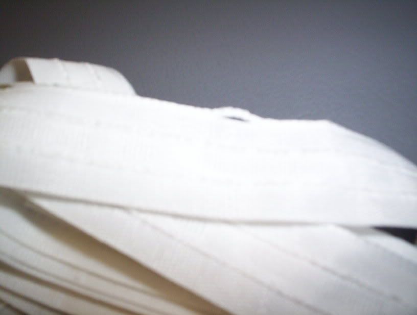

PostPosted: Mon Mar 21, 2011 5:19 pm    Post subject: Reply with quote
You need to buy silent gliss loop top tape the little gliders fit into the very little loops on the tape and then slide into the track from the side .
