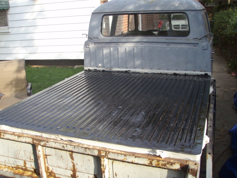

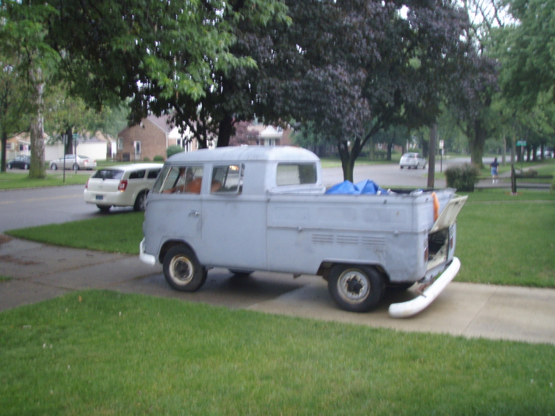

So, during the summer of '08, I did a complete brake job. New lines, DC master and hardware, wheel cylinders, tune-up work.
First Drive - STOP your bumper is dragging!
Resealed and painted the tank, New exhaust

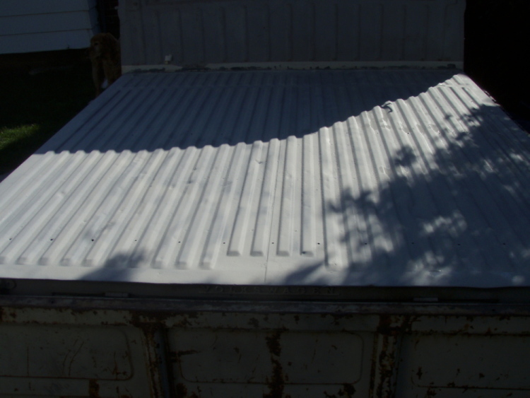

Sanded the bed down
POR-15
Paint
Put a fair number of miles on it.
After that Lions tailgate, the truck was moved into the garage and the chevelle was moved out. General tinkering for a month or two, then over a 2 week christmas break, I sanded the entire truck. Bare metal in some spots, original paint in others. DRY!

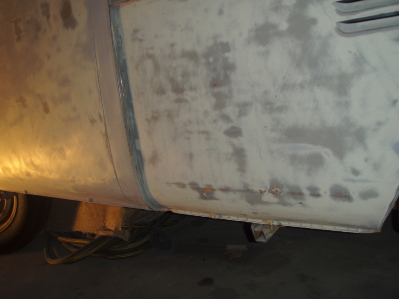

Finally drop the engine and move it away from the wall. While sanding the passenger side. I notice logos. Slow down, check it out and I see this:

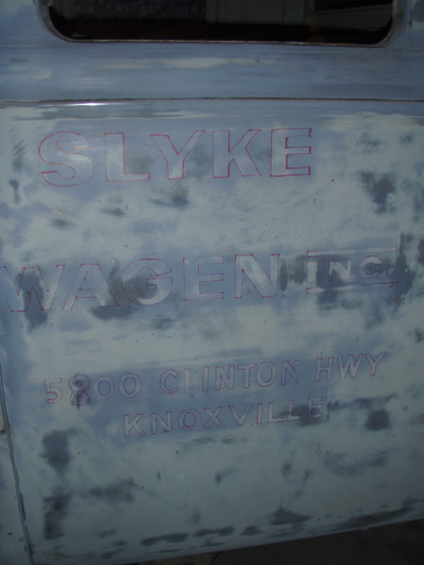

This truck always seemed too dry to be a Michigan vehicle. Luckily, while sanding, I spotted these logos. (traced with a sharpie) Turns out the old wagen shop is now a Harley dealership. Anyone in the Knoxville area remember this shop?
Yeah I thought it was a small VW shop. Turns out it was, and I was missing "Van" and "Volks"
VanSlyke Volkswagen Inc. An early VW dealer in TN. Looks like the front doors were replaced at some time.

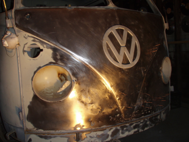

Today, we got 9 inches of snow. I was in the garage using my new stud welder on the nose.

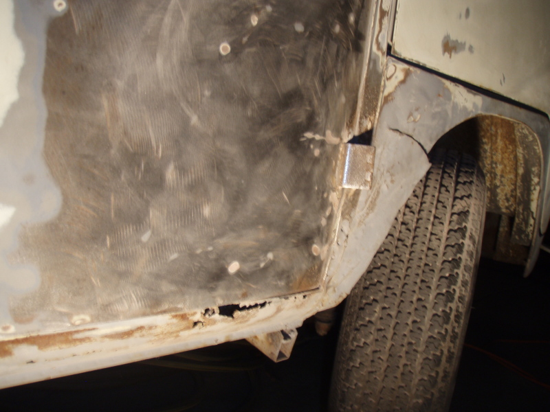

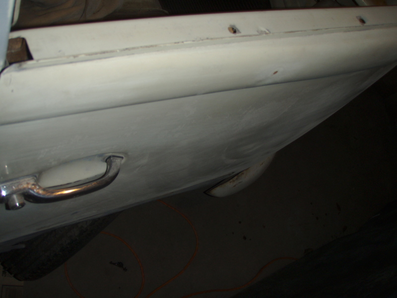

Drivers side corner is bad. But the late, truck only vents are good. The wheel tub is good. I'll probably end up using an entire tall, wheel lip panel, tray and a full corner. If I can get someone to make one.
The rest of the drivers side is very nice. I'll end up spraying POR or something in the rocker and weld up one small hole. Otherwise it's noice!
The passenger side has issues in the dogleg area. I need a 3rd door truck rocker, B-Pillar sections, and dogleg. Initially I was thinking a complete dogleg. Now I'm curious if I can just do a skin. Or if just the skin is sold. Both doors are dry, but I need to re-weld the inner/outer on the bottom of the 3rd door, and tweak the bottom hinge a bit. When I do the rocker/B/dogleg.

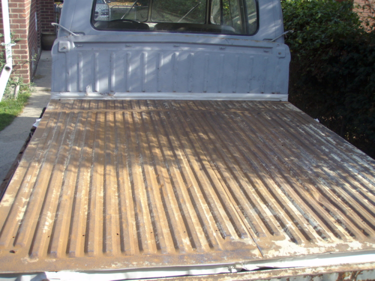

Passenger side bed is pretty clean. It needs some hammer/dolly work on the upper corner. I'll probably do a new lower corner and battery tray.

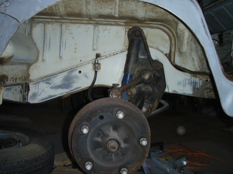

Wheel off to get a closer look at the dogleg, closeout, rocker and B-pillar which is expected next week.
Nice eh? Like it was maintained at a dealership. Wink
Numerous sessions with the unispot, then hammer work. Still needs some more, but it's getting closer.

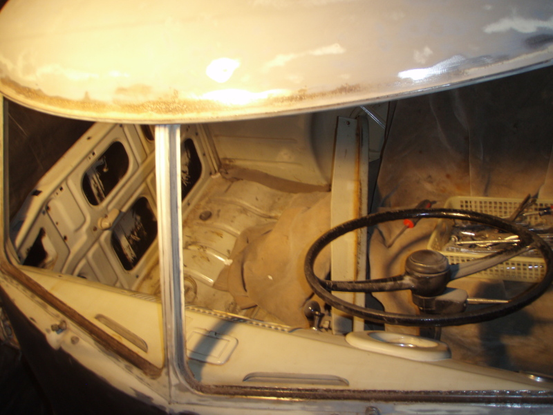

Did the deed in the deep confines of doublecabdom. I'll replace a small area of floor and some partition metal, then weld the new saddles in.
I'm ready to get going on the welding. Still a couple things to order, but the bulk should be here soon.

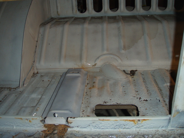

Started cutting on my B-pillar. It looks worse than it is, because of previous attempts at collision repair down low. A new B-pillar, rocker, dogleg outer and dogleg closeout should weld in nice.
The hinge, upper B, jackpoint, and door channel are surprisingly well in line.
I separated the dogleg. It's solid and straight except by the floor. I'll sand, POR-15, then fit the outer dogleg.
I decided to just patch the floor instead of replacing outers, so I made some templates for the floor and dogleg inner patches.

To replace the bottom channel, there is a hammered over edge along the bottom of the gate. I carefully separated that fold and removed the old channel. Later, I need to weld in a small section, then work on getting the hinges in-line and the new lower channel fitted and welded in.
Saturday, I started cutting on the corner, out with the old and in with the new.
