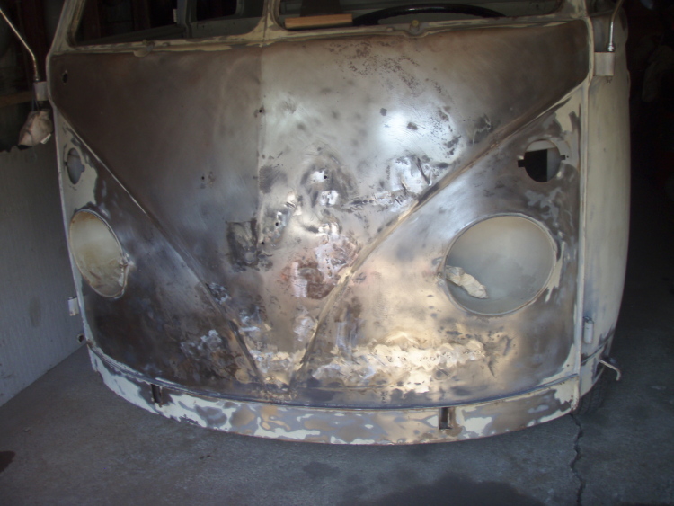

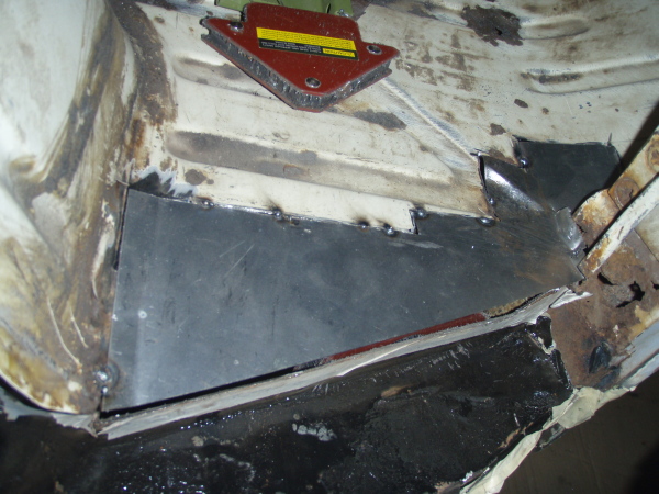

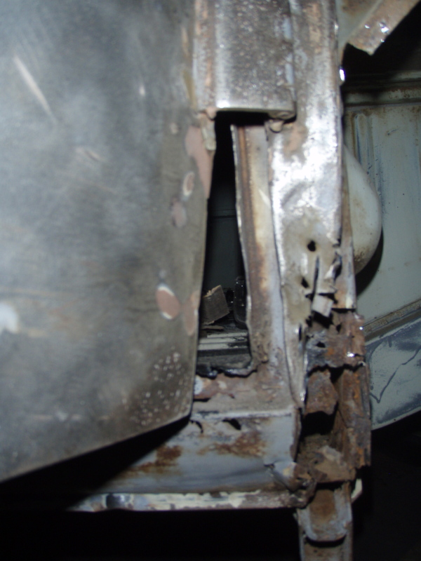

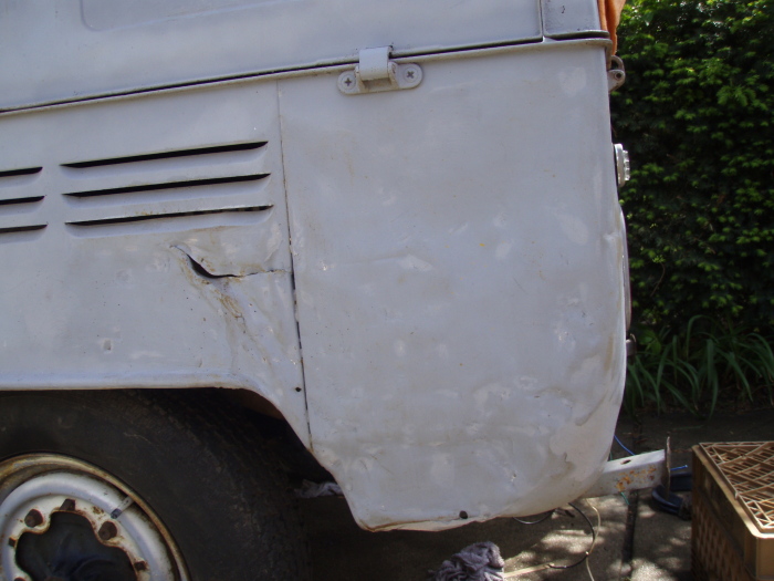

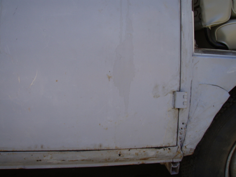

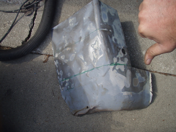

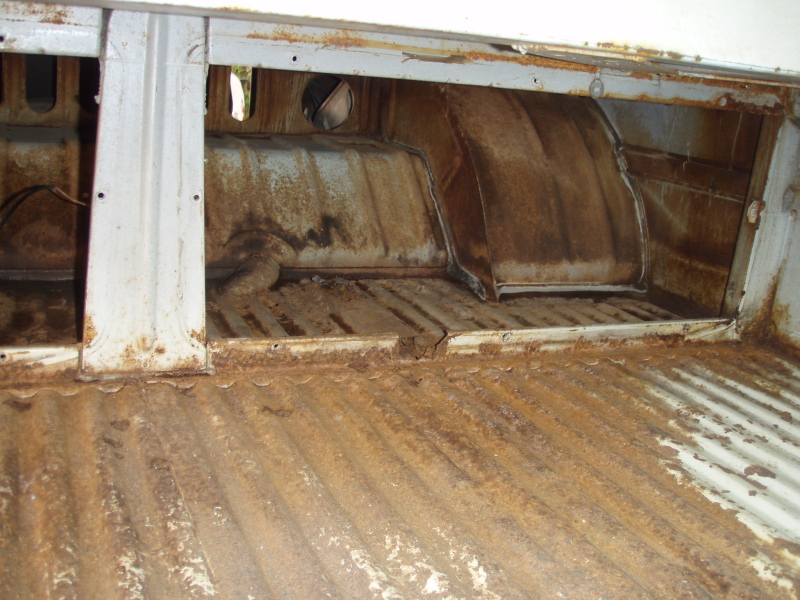

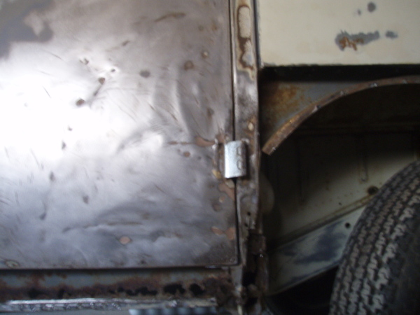

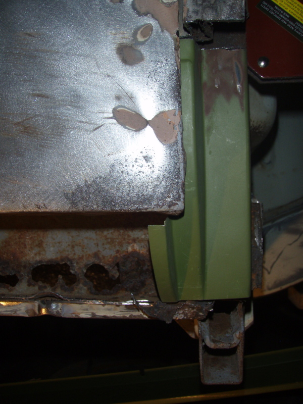

The real issues are the passenger dogleg and the driver rear corner. The dogleg metal was sliced, in a wierd sort of way. I'll replace the whole dogleg along with the short rocker and B pillar area. The rocker is pretty nice, but I'll just redo that whole area at the same time. My dog KOBE, used as a wheel chock)

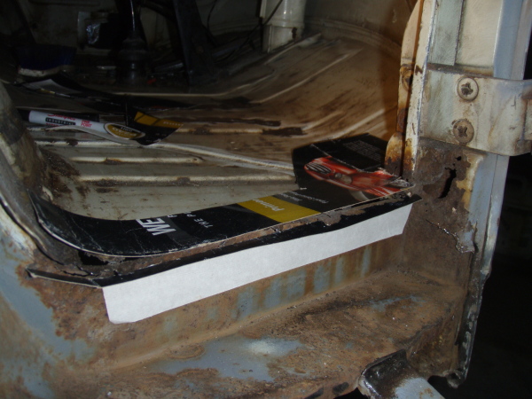

The floors have some small holes which I'll repair, then about a small section of floor which needs to be replaced. The rear corner is funky as well. I'll gain some skills before I attack this.

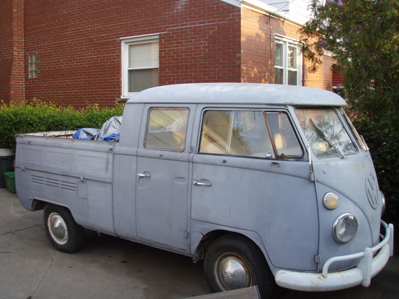

PostPosted: Sun May 04, 2008 5:50 pm    Post subject: Reply with quote

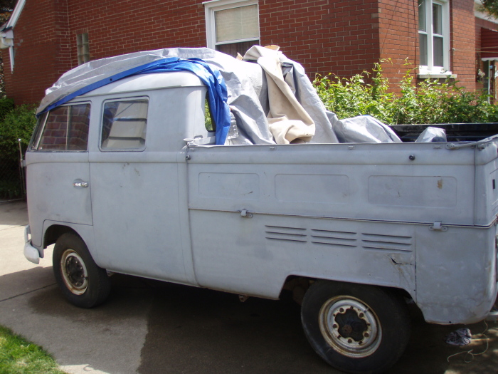

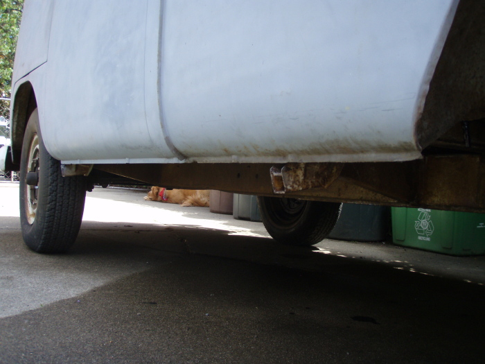

I towed it home on March 27th of this year. Since then I've been busy on the weekends doing work on the truck, my green bus and my chevelle. I've been pretty pleased with how productive my weekends have been.
I didn't get a key with it, so I pulled off the rear handle and took it and a VW blank to a locksmith. After a week he got it done. And the moment of truth......it fit the ignition. yeaaah!
Since it was going to live outside for a while, I rigged up a big gray tarp with 2 liter-bottles, and a closure in the front. Easy on, Easy off. Unfortunately, the day after I got it, we got a late snowstorm all day Friday. The only thing on the truck was a nice thick layer of Garage dust. It leaked from the bed (slat holes) and some window seals. I was bummed, but I got it dry and got it covered and I keep it very aired out.

The story goes:
It was sitting in the PO's garage for 12 years. During that time, he stripped it inside and outside, did some minor bodywork and then sprayed primer. He had grand visions of it being a father/son project. But him and the kid got older, busier, and there it sat.
Prior to that, I heard it was on the Oakland University campus at student housing. I do know the 2nd PO only had it for a year or two. Beyond that, I'm not sure. It has been used based on the condition of the bed and gates, but likely not during any Michigan winters. The delivery port was Washington.

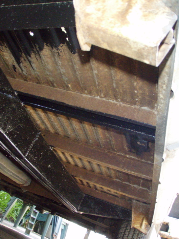

Here's an undershot. This is where leftover in the cup POR-15 goes.

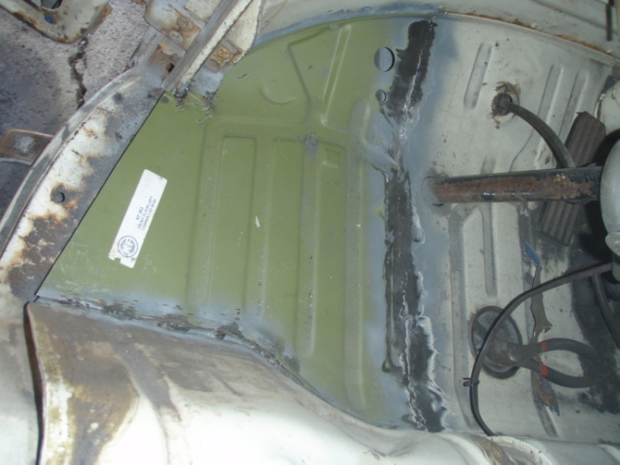

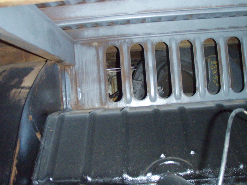

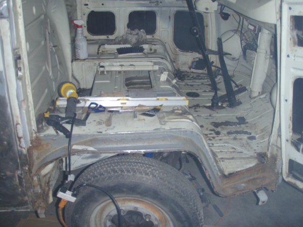

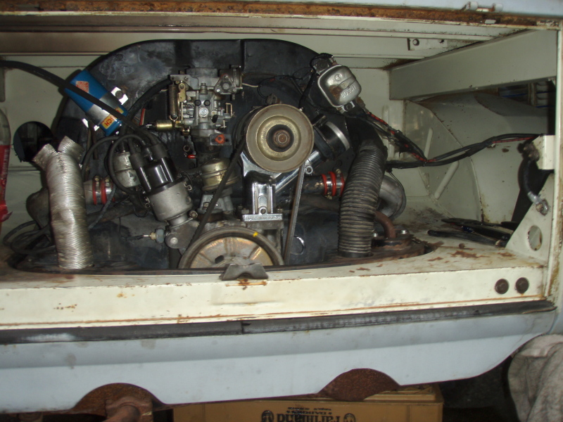

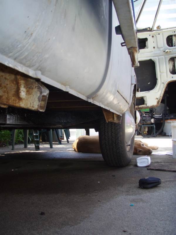

Well, I pulled a Type2 II motor for the first time today. I wanted to powerwash the engine bay and install a new seal. Got it out and back in without issue. Very productive day off.
I got it fired for the first time on Friday. I was ecstatic. I actually drove it out of the driveway and backed it in. E-brake only. My MC and rubber lines are ordered.

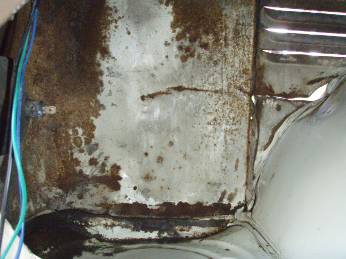

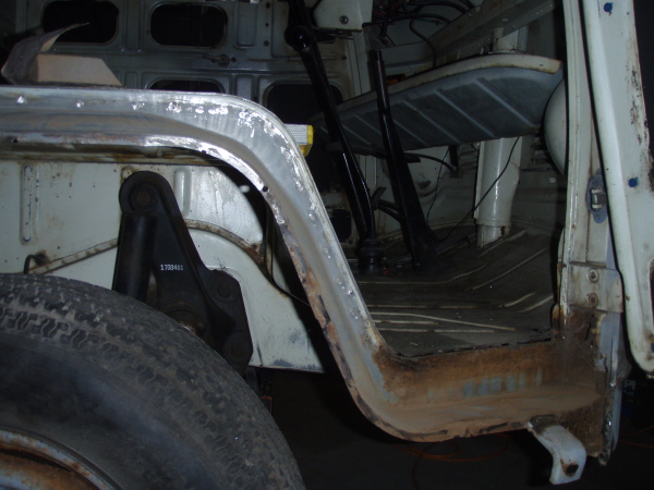

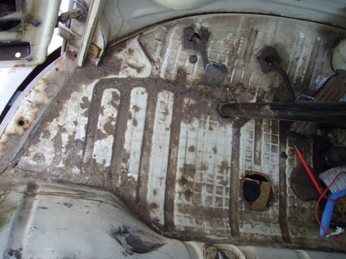

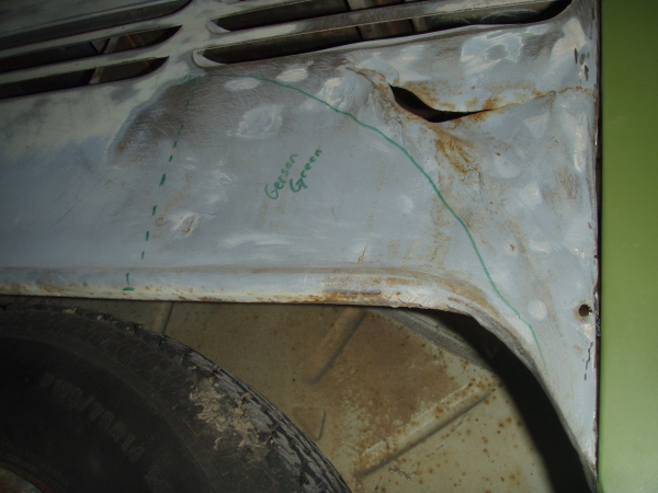

I can finally check out the drivers side.
Heres the ripped corner.
The front floor is ok. It needs some small patches. (styrofoam)

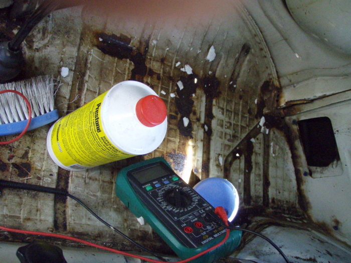

PostPosted: Wed May 21, 2008 5:26 pm    Post subject: Reply with quote

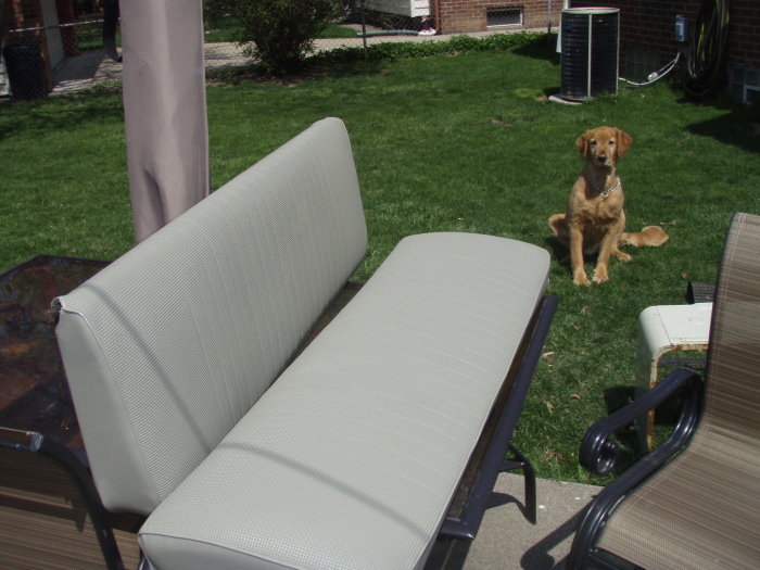

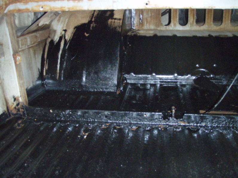

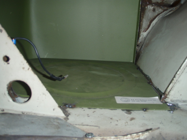

Here's the front. The seats were all re-covered by the PO's fried who worked at Lear.
I soon realized it wasn't starting due to lack of fuel. Apparently someone didn't hook up the fuel tank. So I pulled it, and started wire brushing, coating and painting.
After this pic, I put 2 cans of commercial gray in the tank area and on the POR-15ed floor. It needs just a bit more paint.
I'm going to coat my tank, paint it, and get it back in.
I order a reserve fuel tap, new donut and plenty of fuel line.

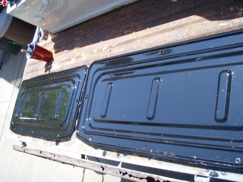

PostPosted: Wed May 21, 2008 5:40 pm    Post subject: Reply with quote
I've also been working on all the bolt-on stuff.

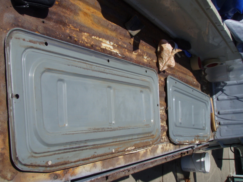

67 only pedal pan:

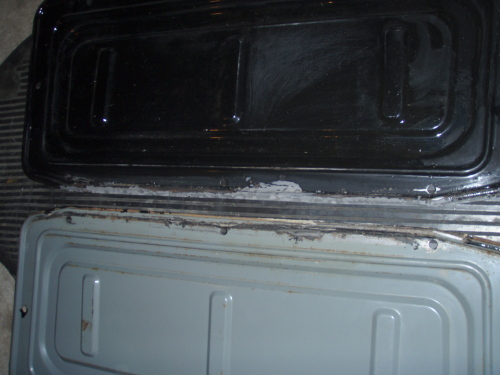

The fuel tank dividers needed some love.
POR-15, tape and JB Weld added some real estate. They are going to sand up pretty nice, then get painted. They look good enough to be out of eyesight.

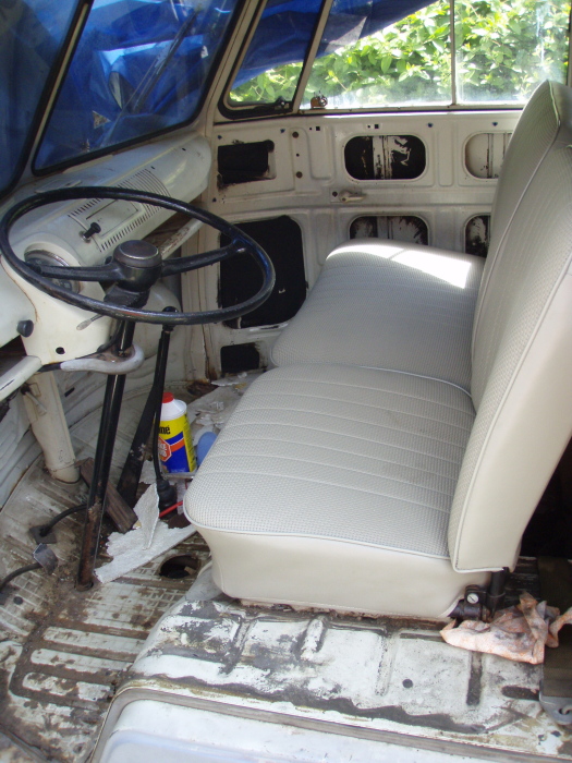

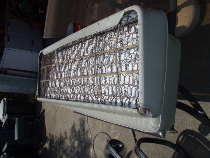

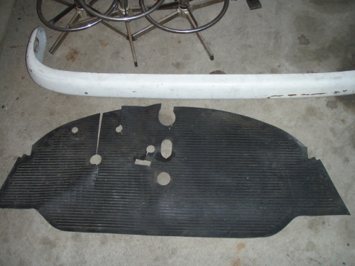

The truck is mostly complete. All the 67 only stuff is there.
Interior panels will work, seats, pedestal, rubber mat front and back, pedal pan, tank dividers, all the lights lenses and bezels, bumpers, engine hatch, radio delete, rearview, elephant ear mirrors, etc.
The only things it is missing is the:
Oil bath air filter. (Anyone have a spare? PLEASE!!!!!!!!!!!!!!)
Rear bumper overriders. (I like it without anyway)
and a few small odds and ends.

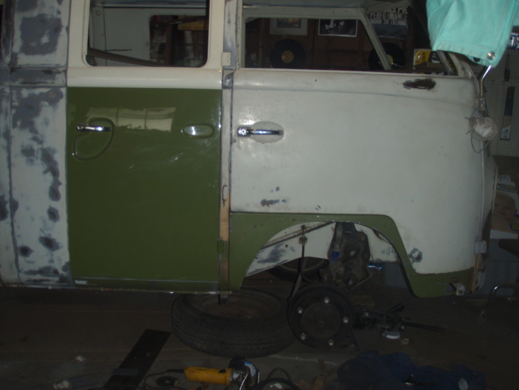

I've been staying super busy, just getting stuff done on weekends and today I had a day off. I'm also working on my Chevelle, working and travelling too much and trying to find time for my wife and daughter.

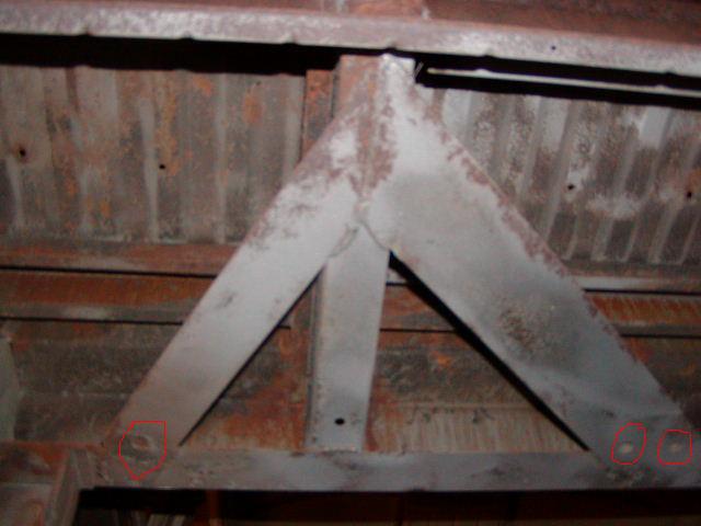

I was happy to find stevem49090's photo
Seat belt mounting points. Perfect for a center mounted car seat.

It doesnt live in the garage yet, but soon.
I hope to get it in and start doing some welding, bodywork and paint.
The original pearl white that is in the cab and engine bay is pretty nice. The exterior was stripped then sprayed with primer by the PO. Which sounds like a good enough excuse to paint it Dove Blue and as stock as I can make it.
