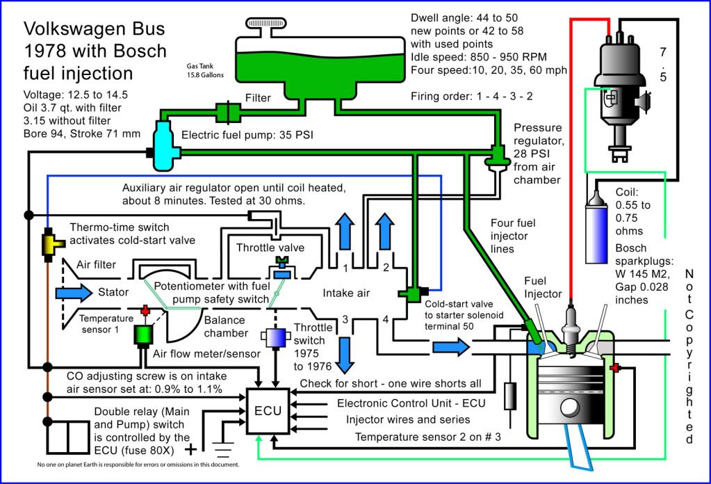

PostPosted: Sun Jun 14, 2009 8:41 am    Post subject: This may help but hasen't been edited by a pro! Reply with quote
<a title="Fuel-Injected-VW-BUS.jpg" href="http://s640.photobucket.com/albums/uu128/Edtheimpailer/?action=view&amp;current=Fuel-Injected-VW-BUS.jpg">
<img src="http://i640.photobucket.com/albums/uu128/Edtheimpailer/th_Fuel-Injected-VW-BUS.jpg" border="0"/>
</a>
We all have problems and so do buses. The universe is, after all, winding down.

PostPosted: Sun Jun 14, 2009 8:47 am    Post subject: No upload?? Reply with quote
http://i640.photobucket.com/albums/uu128/Edtheimpailer/Fuel-Injected-VW-BUS.jpg?t=1244994348
