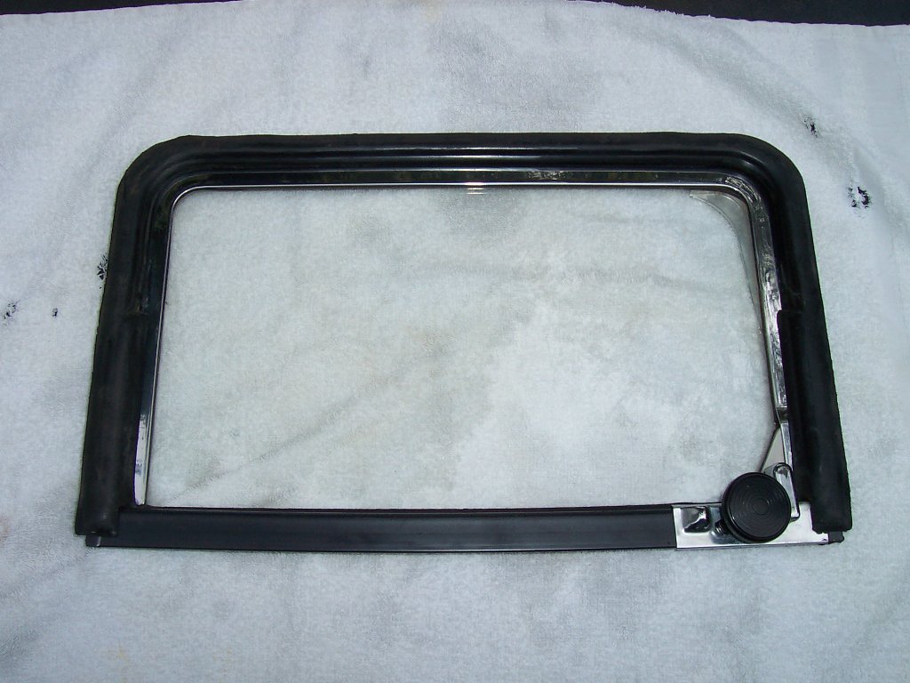

The bus vent window is chrome. The Westy vent window is black. I have not seen any good used black windows.
Yes, you will need to remove the big window first, then the vent window. Pull it to the rear about an inch and then it tilts out from the bottom.
Or you can put in one window from the pass side and forget about the vent window.
The bottom pivot rusts and then shears off..... then the window flops when open.
I had another person ask me for a vent window. Sent him pics and a price. Never heard back......
Here are pics of it, ready to use as is with a very nice seal:

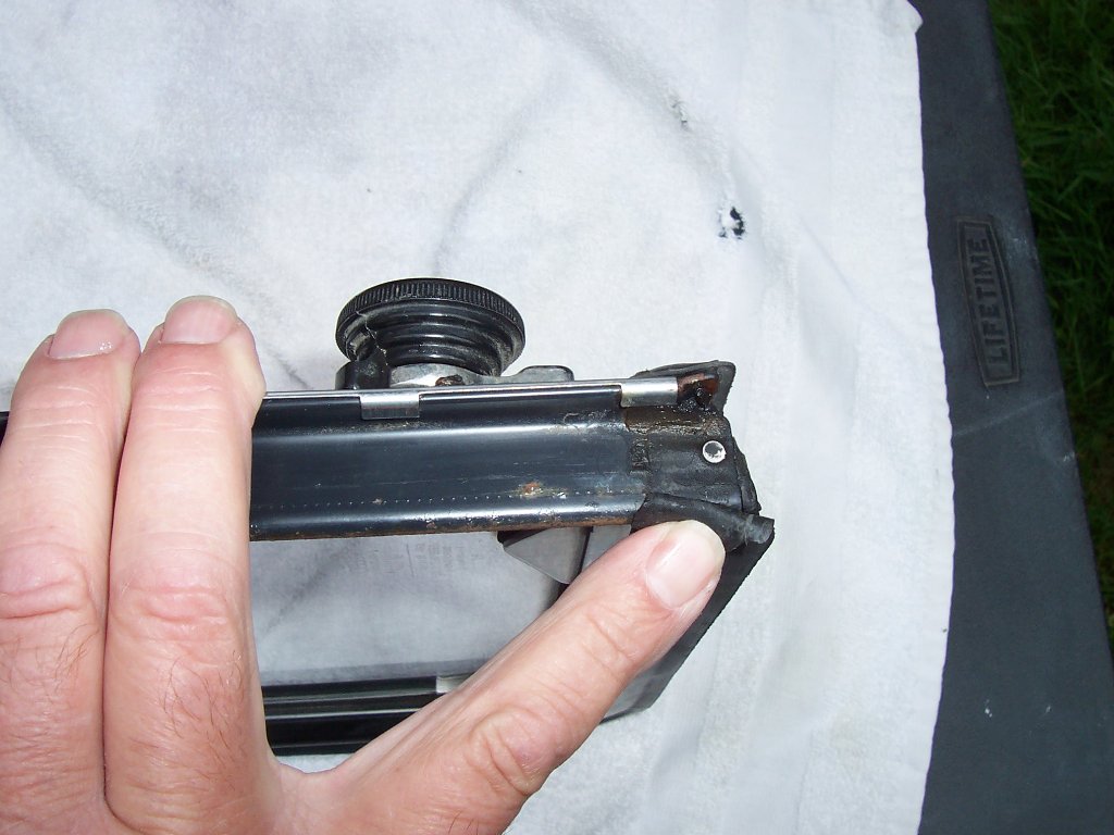

The rear vent window (hmmmm....all the rear vent windows) have a frame that lives inside a rubber seal. Be careful when you go to remove that frame and seal assembly. The frame has two metal tags that should be bent over the pinch weld in the window opening. Look for those two tags on the front side of the window. You'll have to peel back some of the rubber seal on the inside of the bus to locate them.
Only after you get the entire assembly out will you be able to get a good look at the frame. Many are not in very good shape due to rust and corrosion. This is especially true of the area around the bottom post.
Basically if you have a new seal (and your frame is OK - be sure to clean it thoroughly and repaint it) you're set to go for reinstallation. I'm sitting on mine right now because my assistant (my wife) has a bum wrist right now. The vent window seal is a beast all unto itself and has nothing to do with the regular window seal.
The vent window can be taken out and reinstalled without having to remove the main window. Matter of fact that's just what I'm doing.

Thanks for the responses and the photos, Karl.
So, if I'm understanding correctly, if the bottom part is rusted, there are no parts that can really be replaced on it? So, if part of the frame is rusted out, I just need a whole new frame ?
