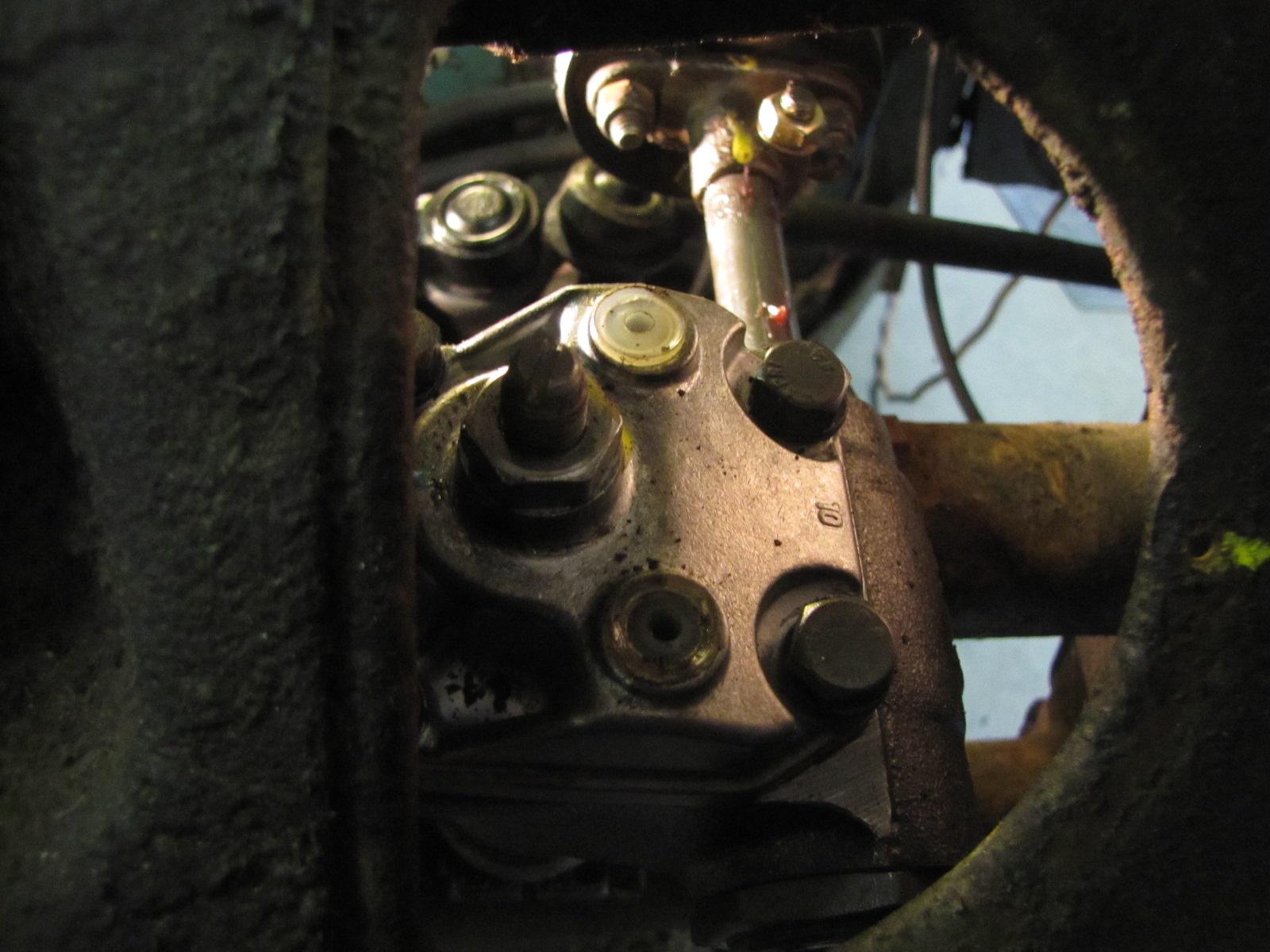

I replaced the old, stiff steering box in the '64 vert this week.
Here is the old steering box in place. It was hard to turn and forget about wheel return after turning.
I first removed the tie rods to confirm the problem was with the steering box, it was.
New TRW steering box.
These mount studs need to be transferred from the old box to the new one. Mine came out with no problems after some cleaning and lube.
My old steering box was from a '55-'61 bug, which has a larger output shaft and different pitman arm.
Bug City in Berlin, CT supplied me with the used '62-'65 pitman arm, shown installed on the new TRW steering box.
'55-'61 pitman arm in foreground wouldn't work with new steering box.
New steering box installed. Also replaced the right side tie rod ends and greased the left side ones.
Much nicer steering now. Next step is an alignment.
