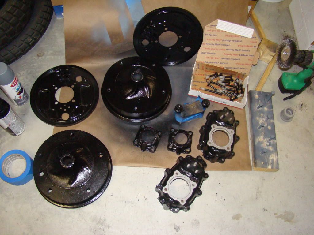

Spent all weekend sandblasting and painting axle tube/grb's and associated brake parts. found that the mounting holes that attach the grb to the spring plate utterly shot, threads missing, holes wobbled out after a couple of hours cleaning off crud and blasting. At least I didn't paint that one yet! I get about fifteen minutes of blasting before I need to let my tank refill . Blaster requires 10 scfm at 100 psi and my compressor delivers 5.4 scfm at 90 psi . but with the 200 psi and 15 gal tank it runs ok with the regulator set at 80 psi . Stops delivering sand at 50 psi so I go work on something else until it fills . Got my axles installed in the transaxle with a chickenshit set of snap ring pliers. And finally cleaned off the silicone off from the side plates Rolling Eyes . Oh and sliced my finger open on a rabid piece of sheet metal while cleaning my harbor freight sandblaster . nice unit actually just should have inspected it before use.
and I have a couple of questions the big thin washer that goes behind the bearing cap before the axle seat is pitted pretty bad does that have to be smooth to do its job and the outer bearing spacer is also pitted it is safe to assume that has to be smooth to seal ? and I didnt paint where the backing plate will meet the grb cover thinking it will work better with the seal that goes there? or should I paint it too?

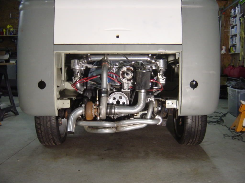

Over the weekend I put this in my bus.
...Specs? Shocked
-Andrew
GarryA
Joined: September 28, 2009
Posts: 613
Location: South Carolina
GarryA is offline
PostPosted: Mon Dec 21, 2009 10:06 pm    Post subject: Reply with quote
Andrew wrote:
...Specs? Shocked
I figured somebody was going to ask.
Super secret custom turbo crankshaft cam and other internals. Laughing
See that big empty whole in the pulley? Right now it is just a mock up of a once was 2382. I needed to make everything fit, make brackets for the computer box, electric fuel pump, pressure regulator, O2 control box, Oberg filter, oil cooler and about 40 feet of braided fuel and oil lines. Plus fitting the rear tin. Once I get it all the mechanicals of the bus worked out it will be torn down for final paint. Long block will be ordered then. In the mean time I am researching what I want inside the motor. The turbo system is CB performance fuel injection. The one that you can hook a computer up to and map the fuel ratios and it is supposed to be a "learning" system. I can't wait to teach it a few things with my right foot.
