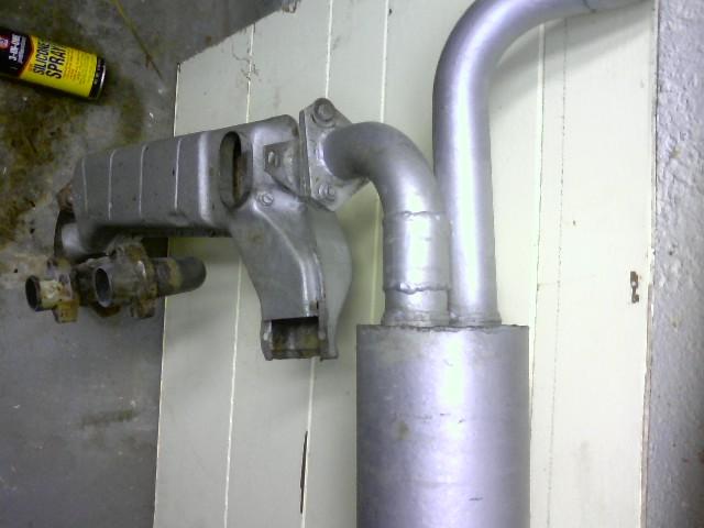

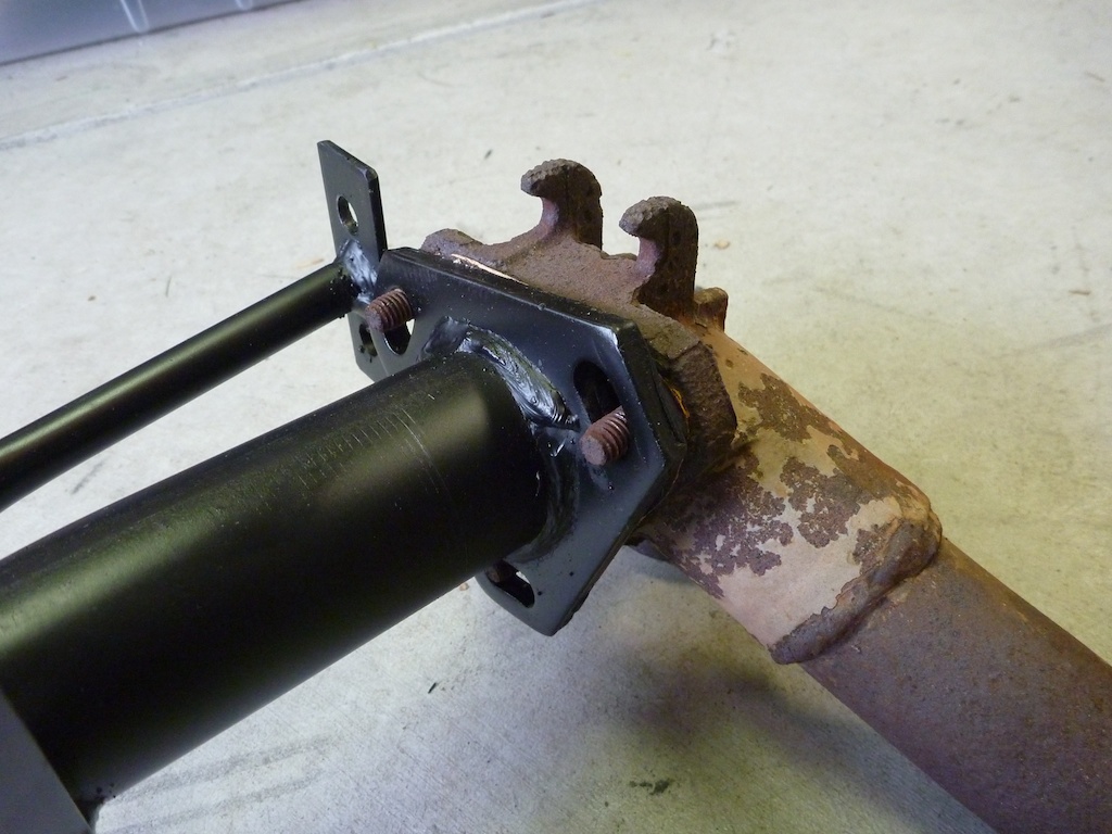

Just as the subject asks; has anyone had to "alter" their PaceSetter in order to get it to fit? Mine arrived and it looks like the flanges are about 1" too close and one flange may need to be rotated slightly.
See here:
I have it reversed against the OEM exhaust in this pic. The left end is mated properly to the triangle flange but notice where the right end lands. Not only is it bent inward an inch, but it's also below the level of the alternate flange.
Up close of left end; notice that I've run out of room for adjusting the angle in the bolt slots:
Up close of right end misalignment:
I've contacted gowestyautoparts.com about the issue but their return policy is strict and I'm afraid they're going to say "you signed for it, it's yours!" and PaceSetter's return policy for warranty repairs has me paying shipping to them (not likely cheap for such a big box) and then trusting that they will properly fix the problem.
Should a local muffler/machine shop be able to take care of this? They will likely have to remove one of the flanges or twist a pipe in order to fix the alignment issue, as well as bend the pipes farther apart.
Any thoughts?

I'd make a plywood template of the one that fits and go to a small time muffler or metalworking shop, and see what they say. more likely to get a fix from a small shop than the chains.
Probably easiest to cut off one of the pipes and weld in a section to push the flange out to where it needs to be. Otherwise your angles will be different and most likely give you sealing problems.

I'd be fitting it to the heater boxes, not trying to line it up with the old exhaust that came off the Bus. How it lines up with what's on the Bus is important, not how it lines up with something that came off.
I was wondering about that, but since I don't have the engine together yet the old exhaust is the only thing I have to go by and I don't want to get all the way to the muffler and then have to wait for a couple weeks for shipping to get the bus running. But maybe I'll do as you suggest before I pay for shipping it anywhere; a local muffler shop should be able to take care of this within a day or 2 hopefully if it doesn't fit.
The old exhaust was complete and leak-proof all the way up to the cat-muffler connection, so I trust it more than I do PaceSetter.

When you sit the flanges flat on a flat surface (table, straightedge) are they both flat? or is one tweeked inwards like the muff got tossed off the UPS loading dock onto it's end?

Can't really put the entire muffler on a straight edge for this as the pipes are staggered a few inches. But after looking at it closely it does appear that the flanges aren't exactly flat with each other. Shipping/manufacturing damage is a possibility.
SGKent wrote:
use a tape measure to measure it correctly and if it doesn't fit send it back. Flipping it over like you did changes all the angles.
When both are facing the same way the OEM has 26.5" between top most bolt holes, PaceSetter is 25.75.
I've heard back from GoWesty about the problem and it looks like they'll work with me on this. The reason I was worried is because I bought it through their gowestyautoparts.com site, which has this to say about returns:
