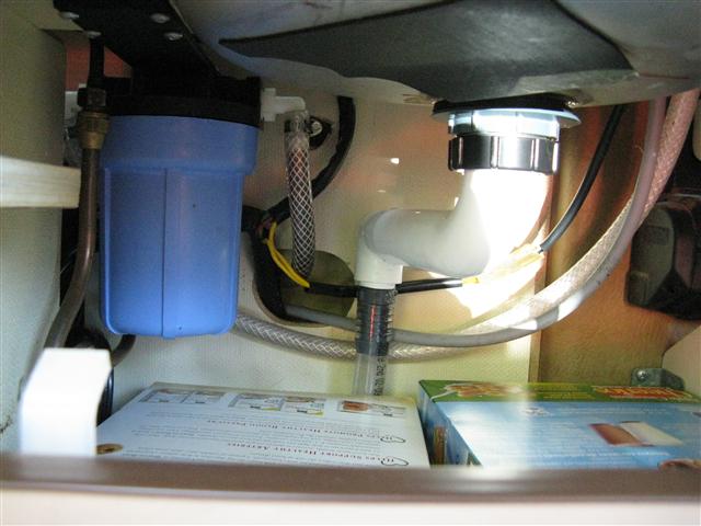

I wanted a grey water tank but eurocampers has been out of stock forever, so I decided to make my own.
For the tank I used 6" PVC sewer pipe with two end caps. The sewer pipe is light weight and perfect for the job. I drilled and threaded the end caps - on the rear side a 3/4" NPT at the bottom. On the front 3/4" NPT and a 1/8" NPT on the top. The rear is the drain, using some 3/4" pipe and fittings, with a garden hose ball valve. The front has a 1/4" vinyl vent hose that goes up above the gas tank and terminates inside the front fender.
I redid the drain for the sink because the stock one drained slowly even with the vent. This is because of the small hose size and that there are now two traps. I found some fittings to go from the stock strainer basket to a 3/4" vinyl hose. The hose then goes through the hole in the floor, around the frame member, and up to the tank. This creates a trap so you don't get any smells.
The tank is just under 5 gallons capacity which works well for me. I have a filter on the faucet, and I drink the water, so not all 10 gallons will go into the grey water tank. On my recent road trip I put the fresh water tank into the red indicator ( < 2.5 gal I believe) and the grey water tank was not full.
It doesn't hang very low, it's above the propane tanks by probably 3/4".

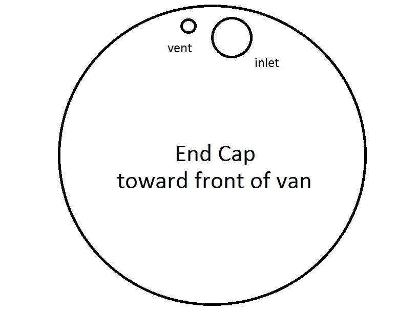

Can you post drawings that show where the inlet, outlet and the vent is located ?
Thanks
Steve

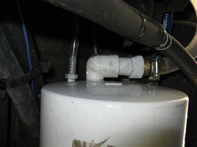

Thanks
The drain is at the very bottom, that's easy. Here is a diagram of the inlet side:
And two closer pics:
