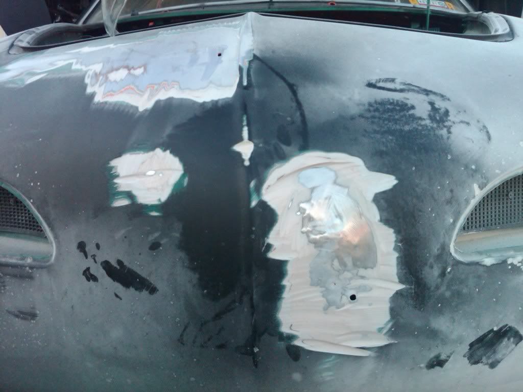

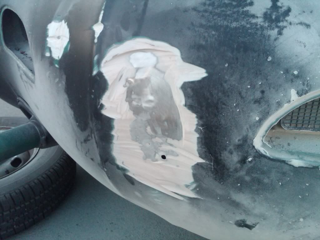

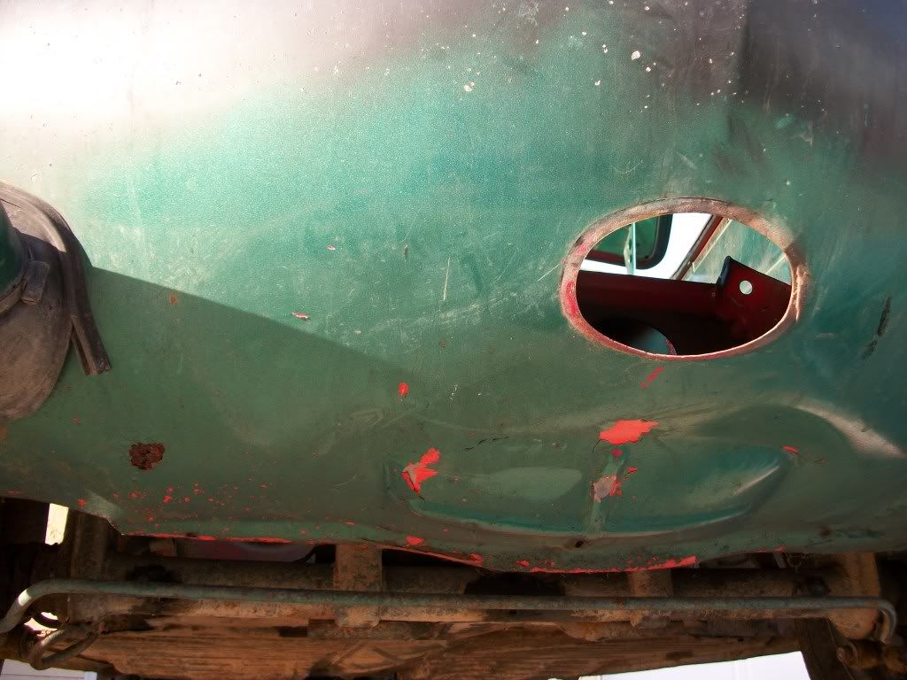

so heres the pictures i promised.. i didint get as many as i thought, i got excited to work on her so i just took a few.. heres what i got.. and nose damage doesnt look great.. now im really considering cuting and welding on.. what do you guys think?

heres the latest.. i started taking off the paint at certain spots that i was worried about.. and wow, they used alot of filler.. i think i might have to replace the nose.. what do you guys think? ill finish of the front completly tommorow... my battery died today so i had to stop there..

With some time and patience, that nose can look 100%. You just need to make some templates and bump the metal slowly back into place. If you are paying someone, it might be cheaper to cut/weld, but if you are doing it yourself, just take your time and work the dents out. When you have a really tough section, maybe cut out the small chunck.

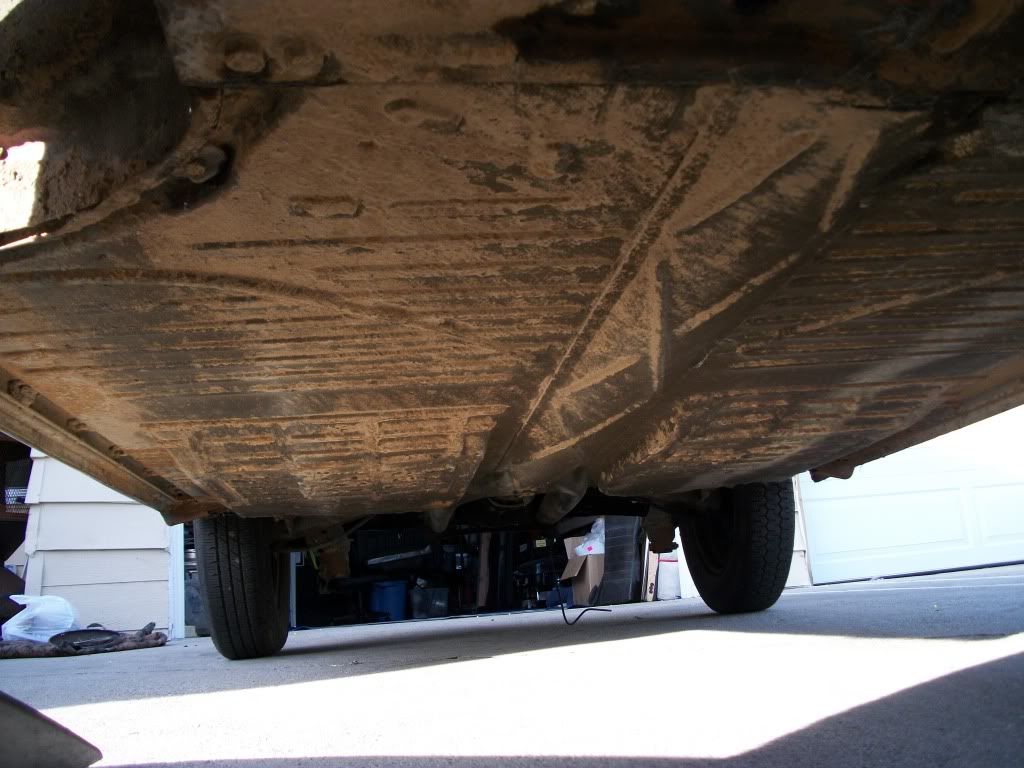

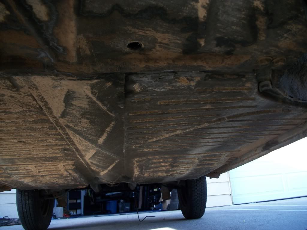

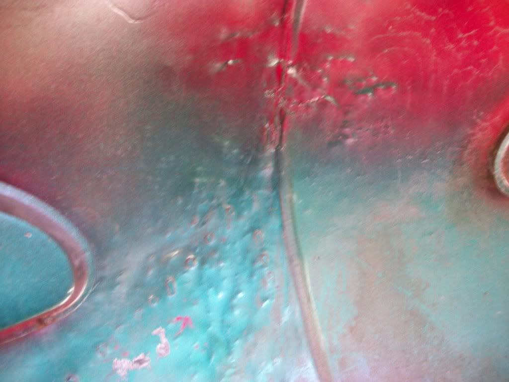

thanks! i really look forward to any and all advice i can get on here since im doing this solo and only based off of the info i get on here.. i guess tommorow we will see how bad the body is.. there is some rust at the very bottom of the front.. so im thinking i might have to replace the front.. we will see tommorow when i tackle at least half the car with my new grinder i got today.. im using a fiber sander/stripper to take off the paint.. at first i thought i could do the job with my drill but i saw the grinder for 49 bucks and i realized it was worth it.. anyways.. big day tommorow!!

Some of John Kelly's stuff: http://www.thesamba.com/vw/forum/viewtopic.php?t=308403
Check out his website: http://www.ghiaspecialties.com
I recommend spending money on his Tuck Shrinking and Shrinking Disc DVDs.

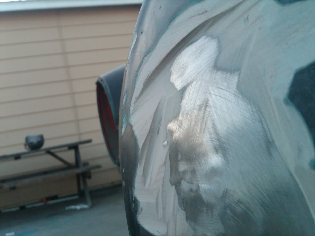

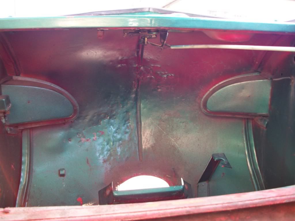

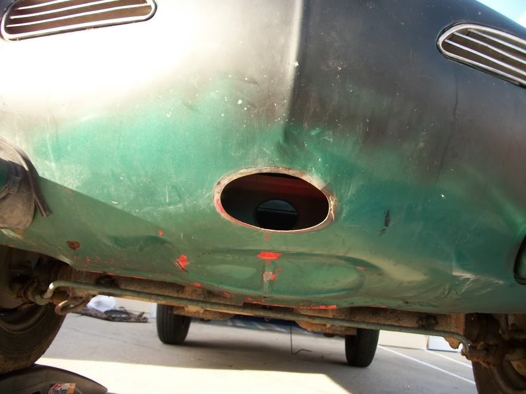

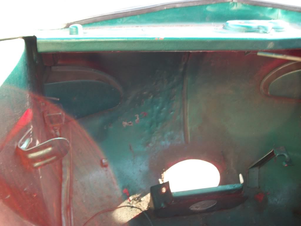

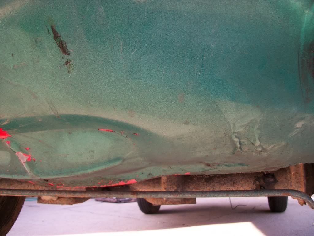

So after a little time off from working on her, i decided to give aircraft remover... and it is much better than my grinder i think.. here is what i got done today..
i found some rust but it looks like just surface (?) rust, it isnt very deep... im starting to get excited about taking the body off when im done going as far as i can go at home and sending it to a shop for them to get the nooks and crannies for me.. probably by sandblasting her ...
and while the body is at the body shop getting the last touches and getting painted, ill work on the frame at home.. which brings me to the following question.. how do i take the tar boards off? i want to just take a scraper to them but it seems like i would make a big mess that way.. how have you guys done it? again..thanks in advance for your advice...

It looks like you are doing a fine job. I would suggest getting a propane torch with an automatic ignitor to remove the bondo. If you can get to the back of the panel, like the nose section, heat the back of the panel and scrape the bondo off, just don't heat the metal till its red hot, just enough to soften the bondo. You can use if from the front side, it just takes a little longer. You can also use it to remove the tar boards, just use it on the back side of the metal, especially on the floor pans, might help to have a second person scraping while you heat the areas up. I would remove all the paint and bondo from the nose section and see what you have to work with. Since you can get to both sides of the nose you might be able to metal work it and get it back into shape, thought the nose ridge looks a little dicey. As stated above look at John Kelly's web site for great body work information http://www.ghiaspecialties.com/ He has gotten out of the Ghia business, but he does teach a few metal working classes and runs a great Inn with his wife on the Washington coast, right on the beach. I don't know if he is making the shrinking discs again or not. The last time I talked to him he wasn't making them any more, but he passed me on to the inventor of the shrinking disc, Wray Schelin, and I was able to get one from him along with a great DVD on how to use it. I have used it a little on my 57 Ghia, but I still have a long way to go until I master it. It's not that hard, just time consuming. If it were me I would practice on the nose and see where you get. Worse case senario you end up cutting it out and replacing it, but you get to lear a lot along the way.

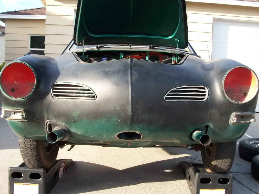

So this is as she sits right now.. I built the dolly, measured the right measurements, just from the wrong places.. so the dolly sits a a few inches too low to be able to roll the chassis under the body .. no biggie, ill fix it later..
ive been slowly working on scraping the paint and bondo off and its a bit frustrating.. i think im going to go buy the torch and heat it up and scrape instead.. the bondo seems to be a little thicker/deeper in some areas and it doesnt come off as easily with aircraft remover once its thicker/deeper.. so heres the pics i have for now..

Wouldnt use a torch if I were you. Too much of a chance to warp the panels. Check out the fiber wheels for stripping paint. You can get them at autozone, pepboys..ect.. the best that I have found are the 3m wheels.. seem to last a little longer. they work great in the wide open areas but do chew up pretty fast when you get too close to edges... or odd shaped pieces.. hope this helps.

I used a propane torch often on my body metal. Its only for removing the bondo areas which are already damaged metal. I had no warping problems. No need to make it red hot just til the filler softens and scrape away. It would probably be worth buying an electric grinder as it will be one of your most used tools during this stage of your project. Luck!
