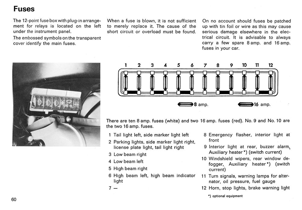

I'm wondering if the top one is actually the correct one for later buses. Here is the fuse configuration for a 75, and it seems to match the top cover you have (and the one i ordered)

Here's the answer! peep the photo of the fuse cover to the left. This is from a 1972 manual.

Don't always trust photos in VW manuals, they often recycled pics from previous years. Notice the pictured one shows the right fuses as dome lights but the text says they are signals and horn Wink
IIRC the dome light was at the very end on a 70 or 71.

Good call. I didn't go through the fuse listing on the 72 manual as much as I did for the 75 Smile
So help me out - am I OK to use the cover that I bought?

Looks pretty close to me, print a copy of that page you posted and keep it with your spare fuses if you're worried.
