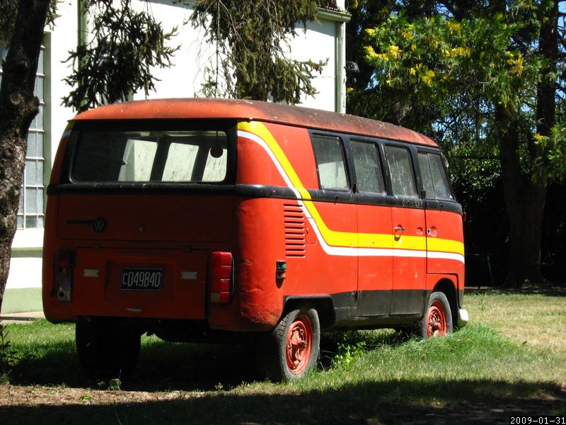

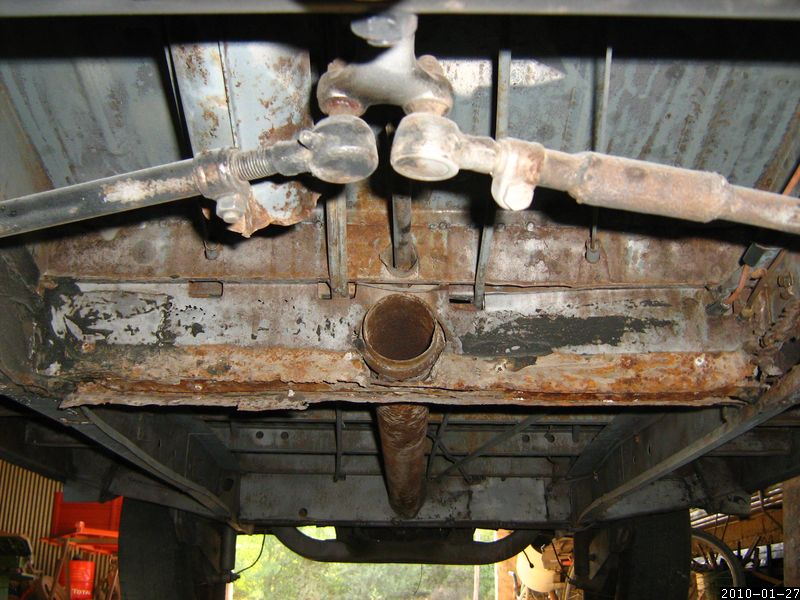

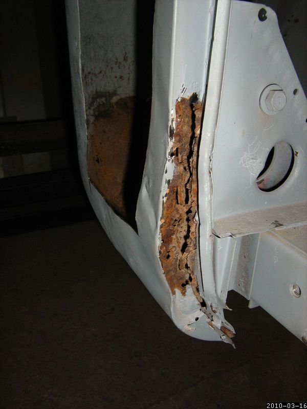

Hello! I'm Martin, from Argentina, i got 25 years old. I bought this bus two years ago, and i'm restoring on my free time.
I always wanted to have a vw bus, and i have been lucky finding this one.
I wish to share the pics of the restoration progress with this community, hope you enjoy them.

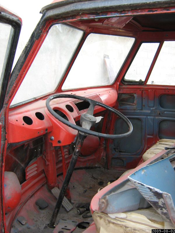

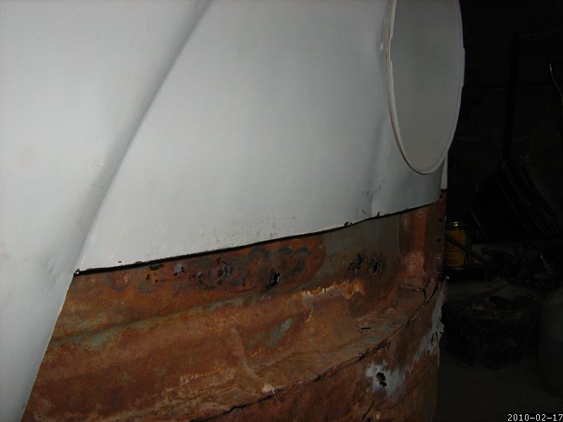

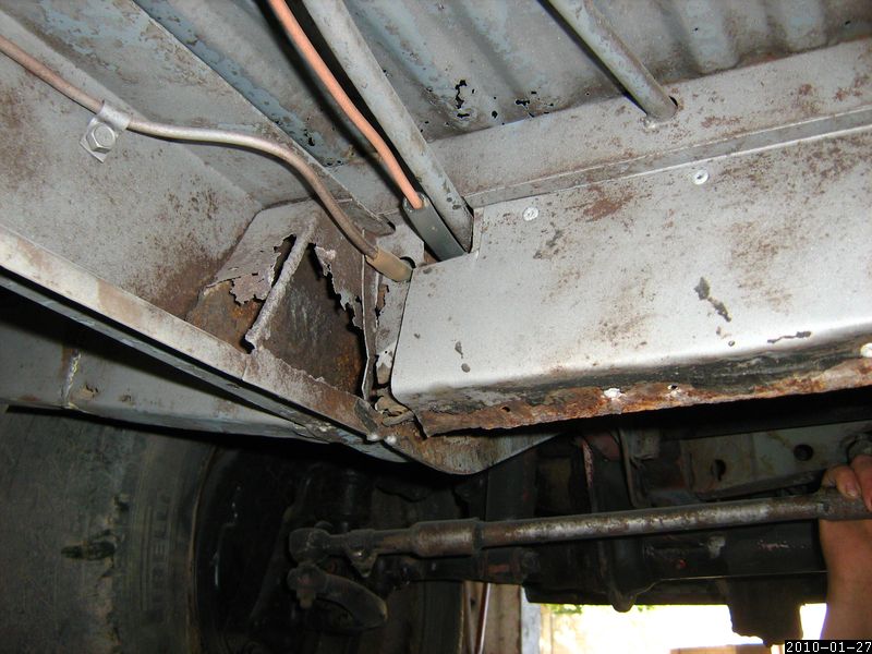

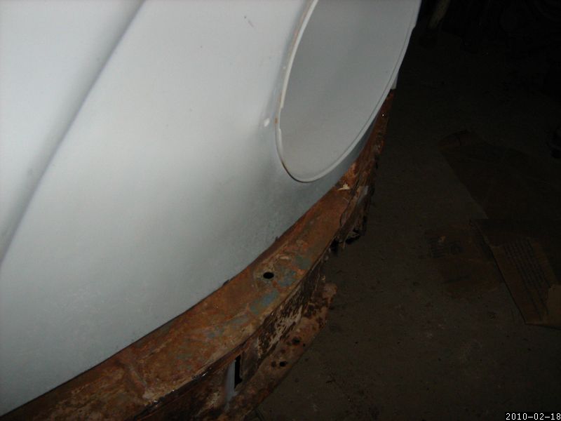

The bus is a german split 65. I think it was hit on left and another hit on front right. It was about two years parked in a yard, the latest owners didn't take care of it, and it comes rusty.
I started the body work on January this year, so i will post some old pics at first.
This forum is very useful to me. I have earned lot of knowledge a lot here.
So thanks to everybody!
Sorry for my english.
Martin.

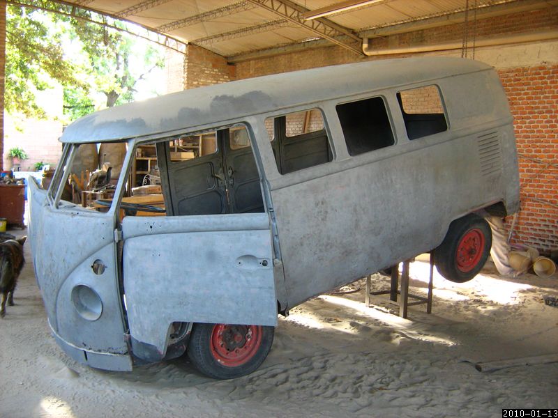

Bus found! Very Happy

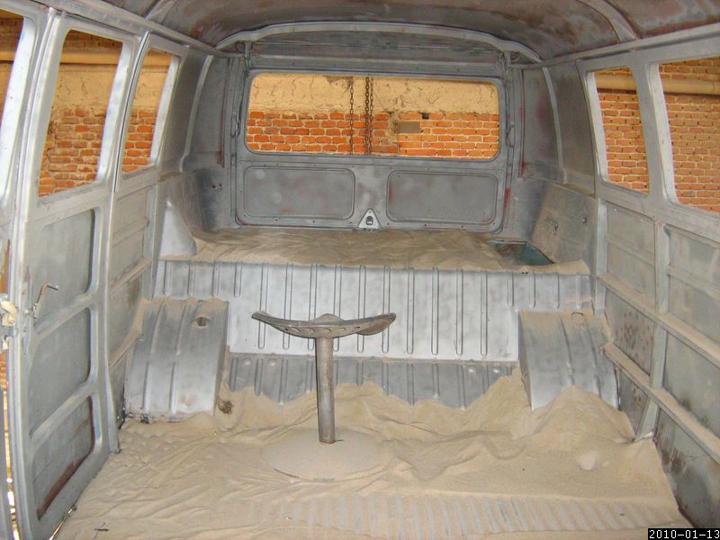

Sandblasting
I wanted to kill this man when i find my bus on this position! lol

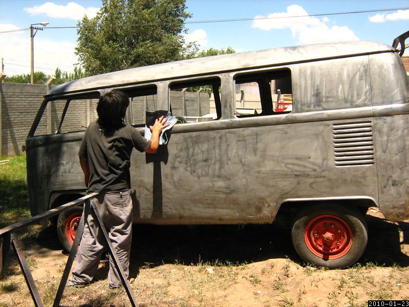

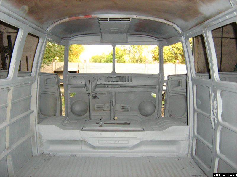

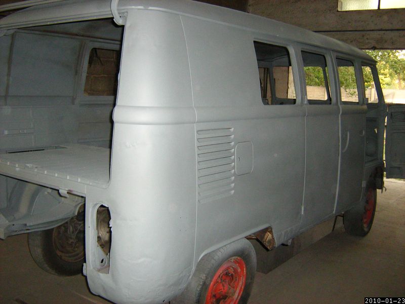

Cleaning for phosphating and primer
First coat of primer

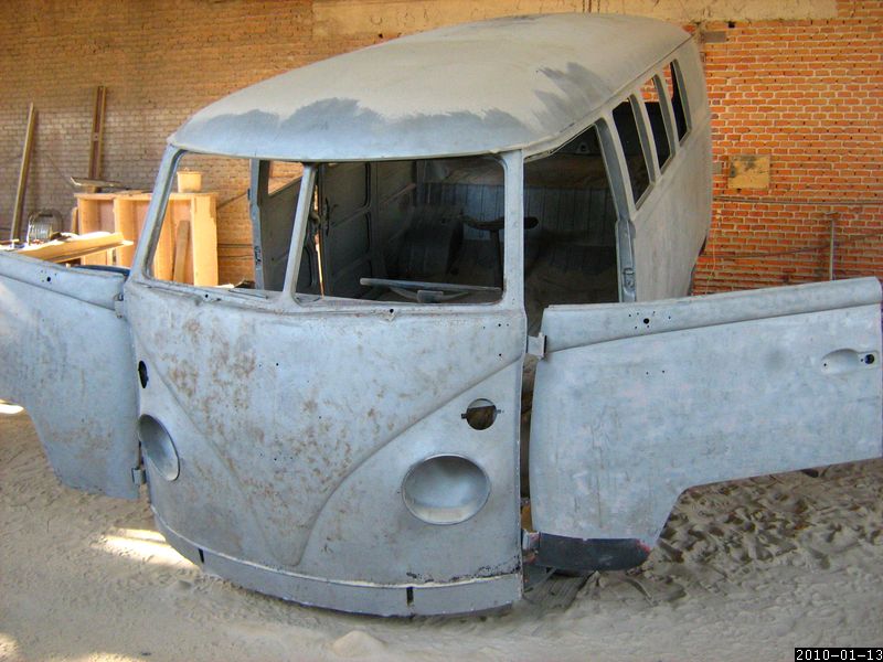

Some more pics:
First hammer steps, hehe

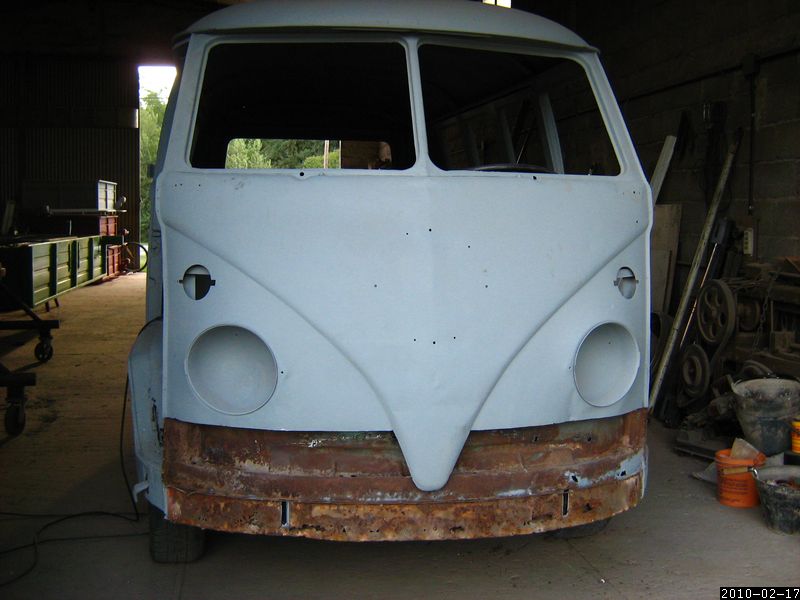

Thanks! Yup, stripes not bad, but i prefer go back to some original color Wink , this bus was dove blue, but my wife likes sealing was red/beige gray.
You can imagine the color it will have when finished... Laughing

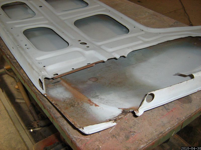

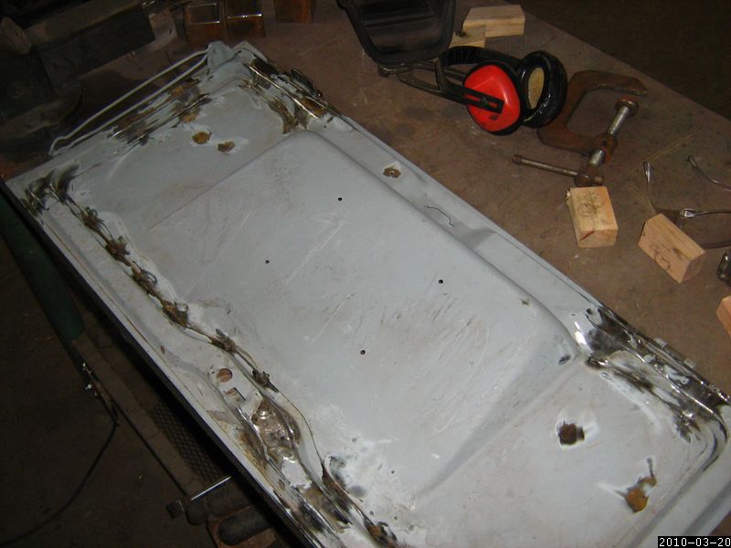

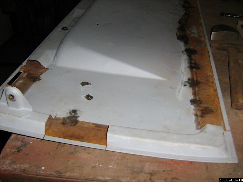

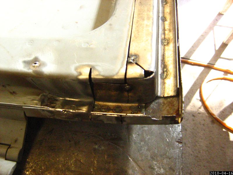

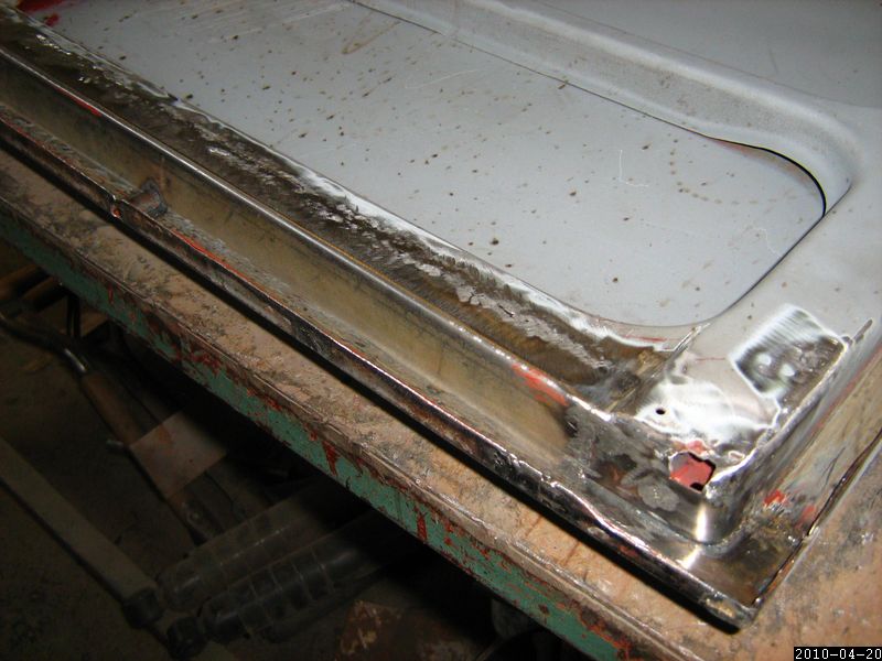

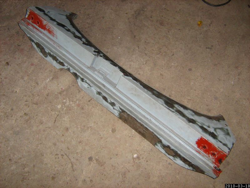

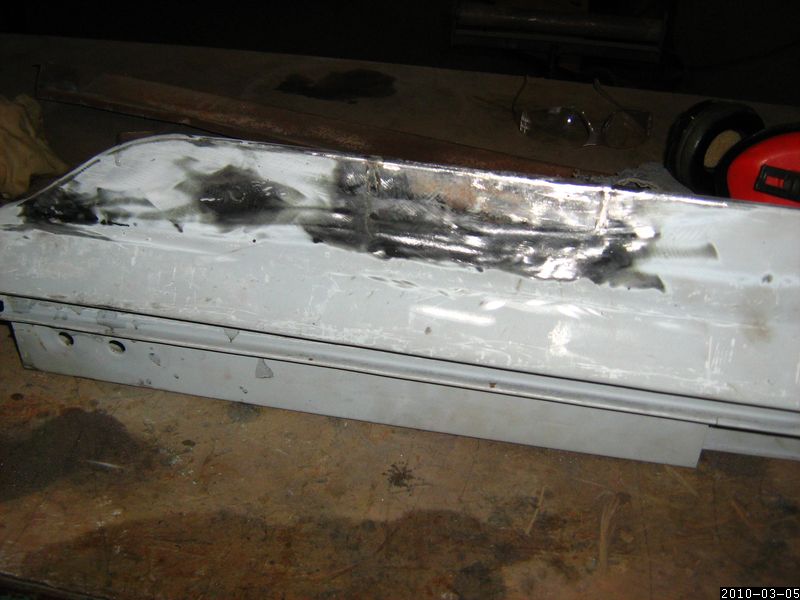

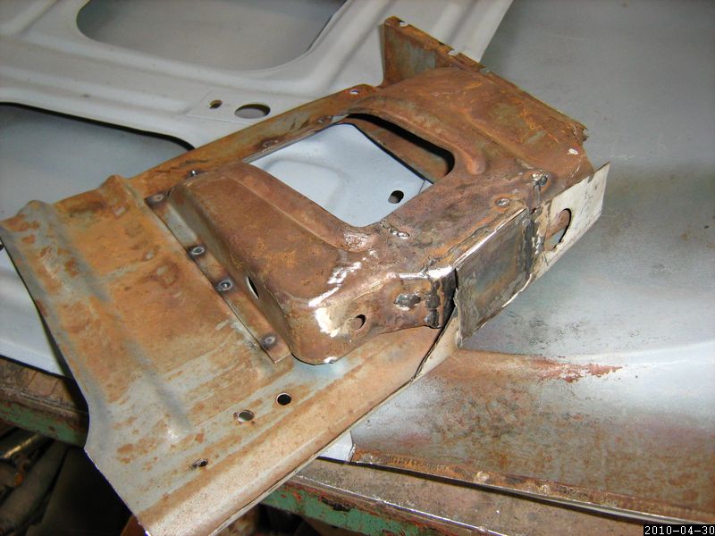

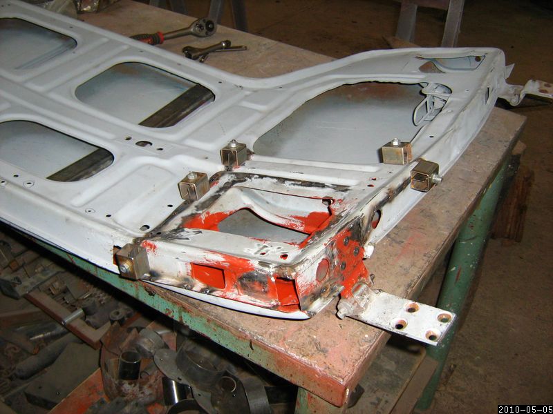

Tailgate repair:
Ready to go:

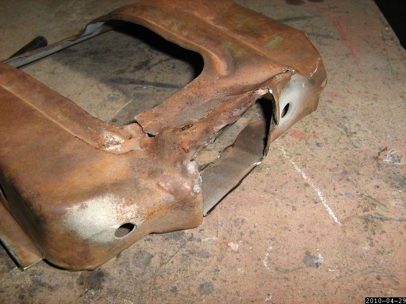

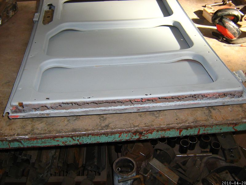

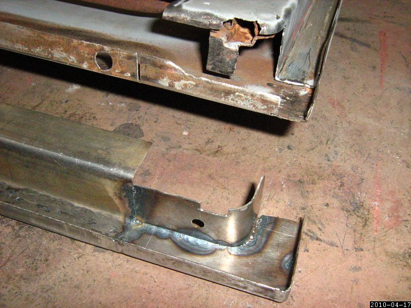

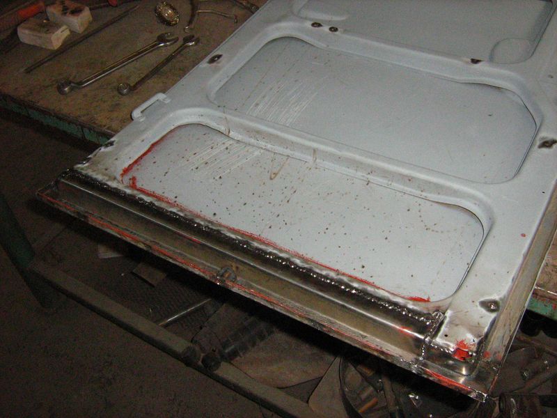

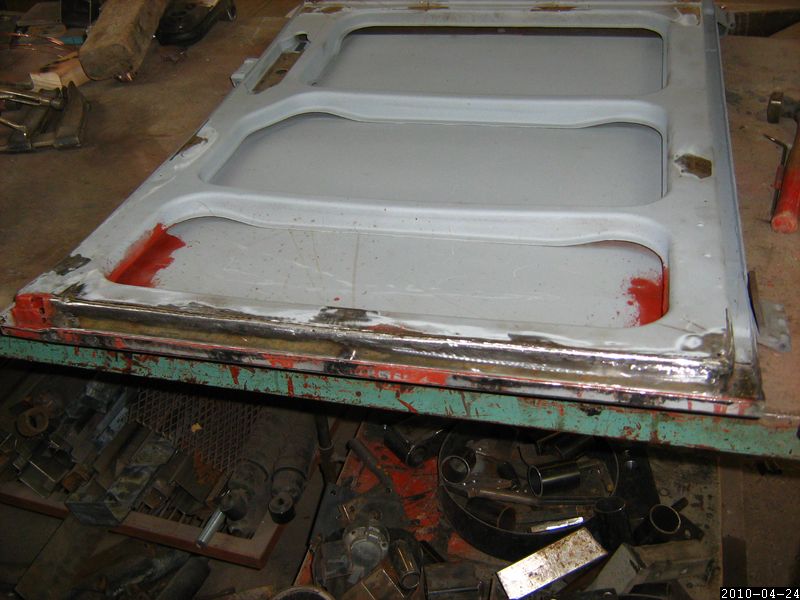

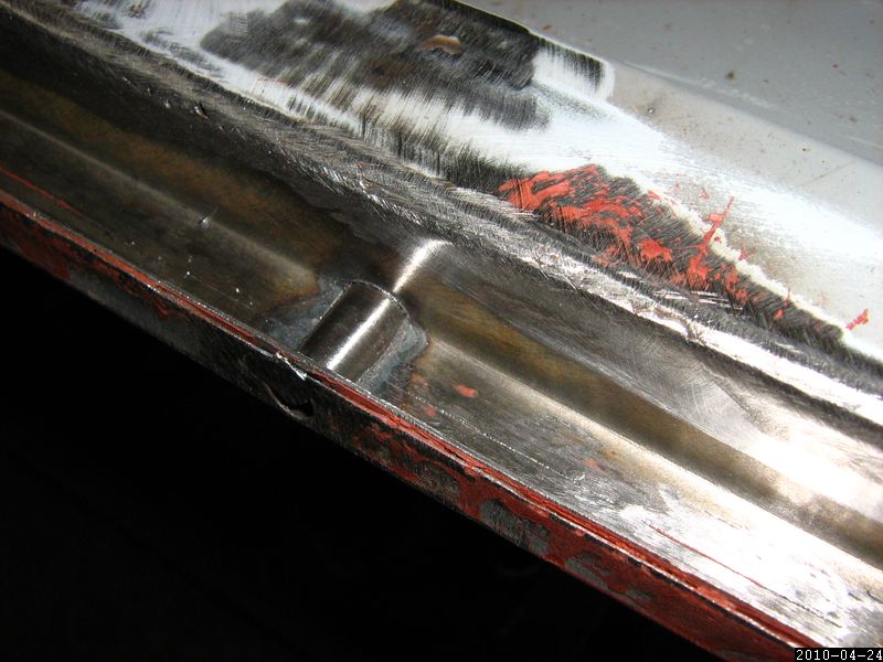

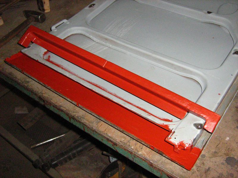

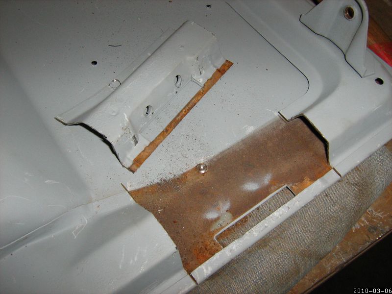

Cargo doors repair, they was too much rusty on bottom.
firula
Joined: March 24, 2010
Posts: 181
Location: Argentina, Prov Bs As
firula is offline

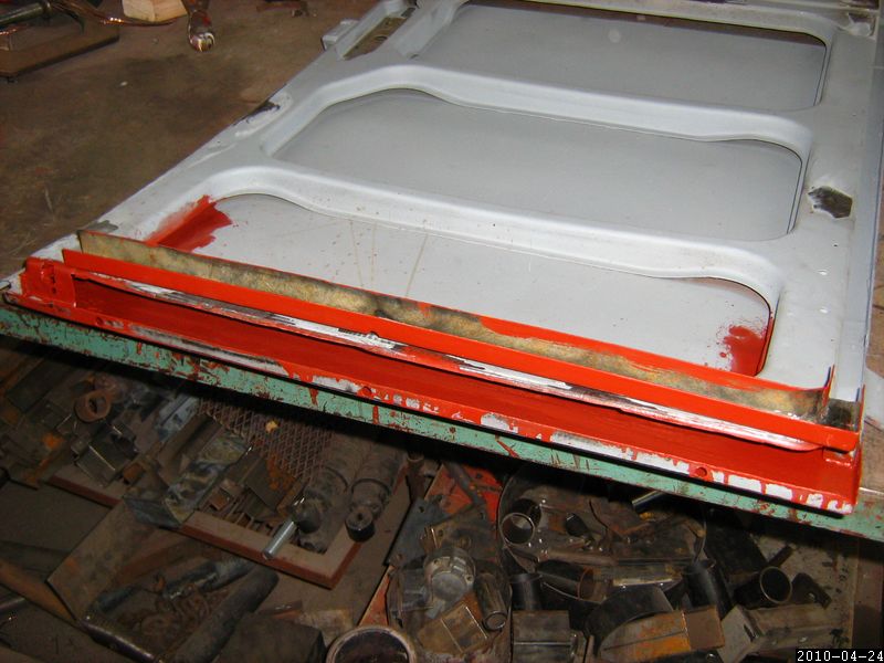

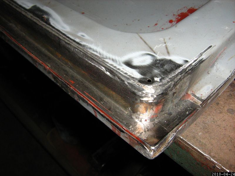

PostPosted: Wed Nov 03, 2010 10:13 am    Post subject: Reply with quote
The other was almost same conditions...
Water drain Razz

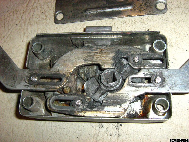

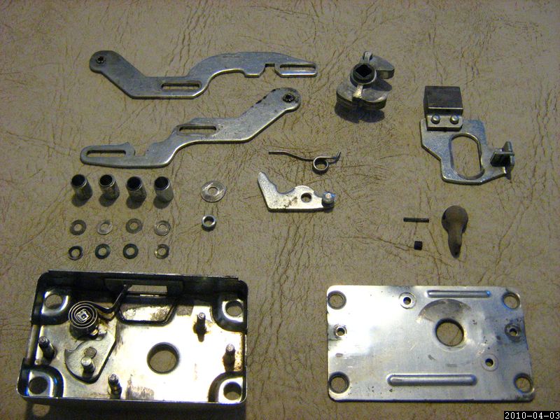

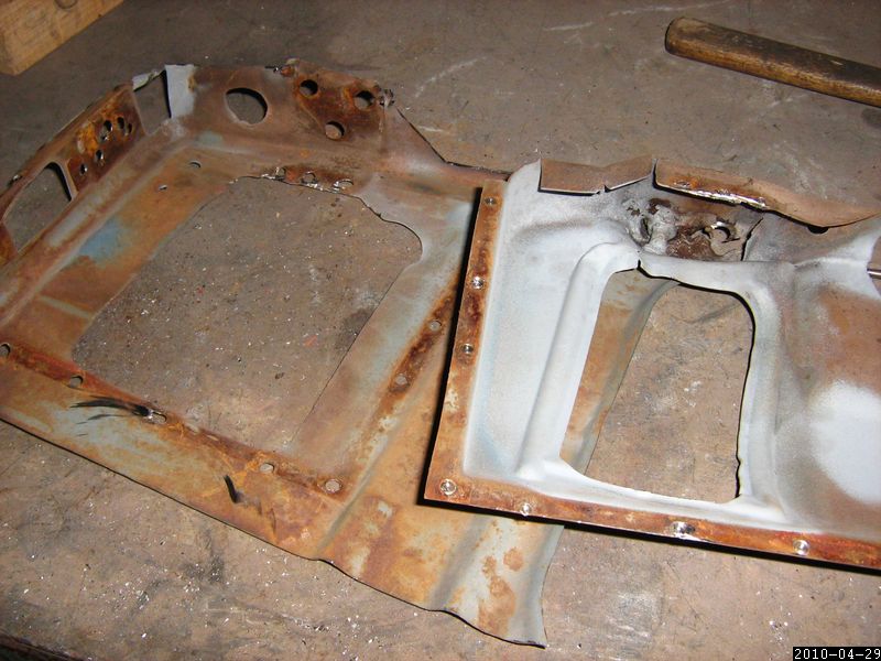

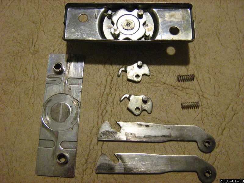

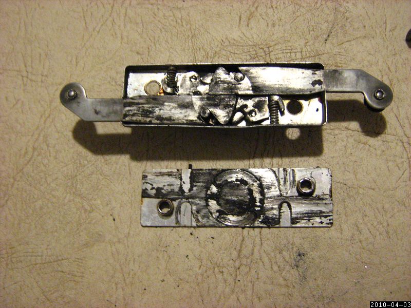

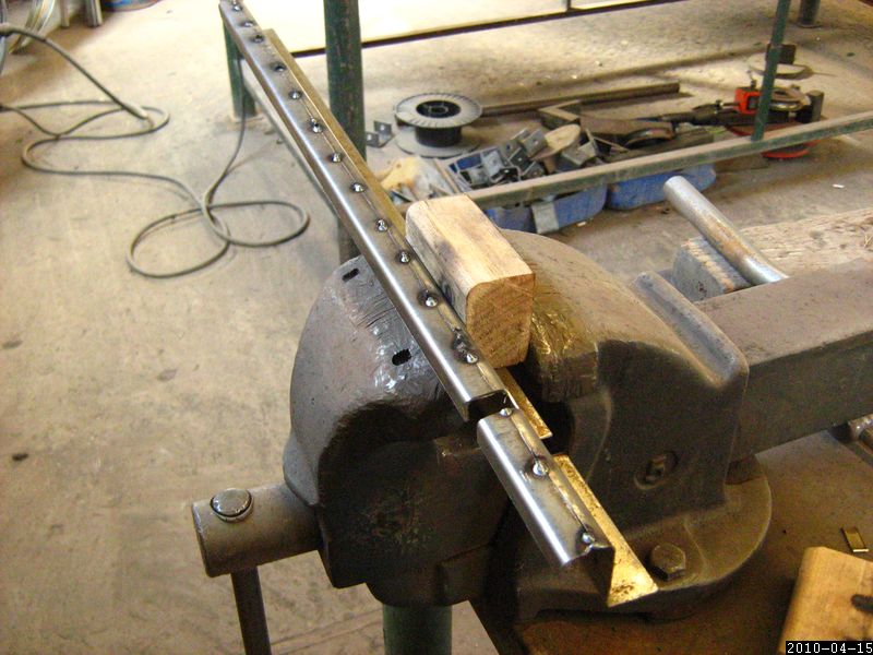

sconord wrote a post about cargo door lock mechanism fix:
http://www.thesamba.com/vw/forum/viewtopic.php?p=4482330
This help me to take out my fear for open it, i cleaned the mechanism, and lubricate it with graphite grease.
I didn't drill out the rivets, i just dremel the rivets borders, leaving enough material to rivet it again. It's just good to maintain the box closed, because later with the 4 screws will be strong tightened.
Thanks sconord!
Old grease and sand from blasting:
Cleaned locks! Very Happy

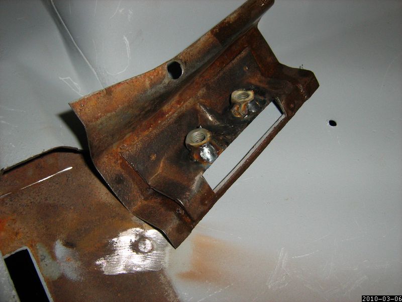

PostPosted: Wed Nov 03, 2010 10:40 am    Post subject: Reply with quote

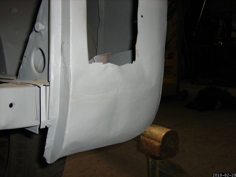

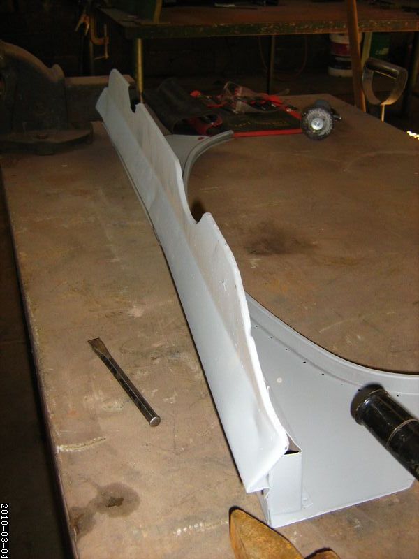

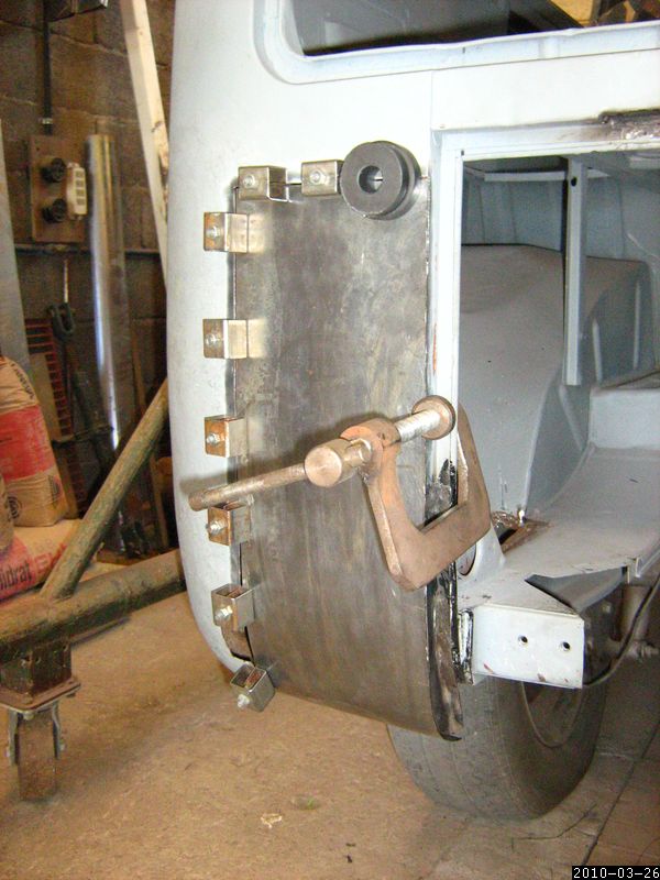

The upper hinge of passenger door was really damaged. I think it was because some hit on font right side.
Lot better! Very Happy
