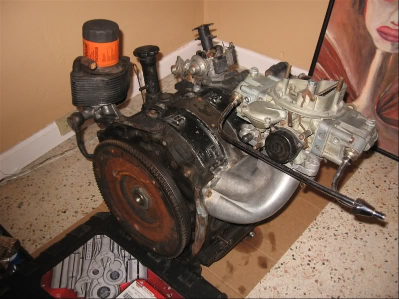

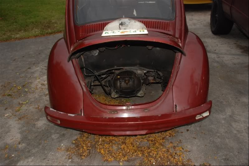

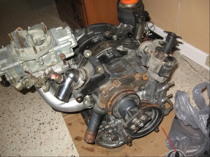

The Swap
So I had this idea. I was going to build my VW motor. Decided to chase down classifieds, but nothing worthwhile. It was going to be about $5000 to be able to have a decent running motor. Soooo, I decided to go for a 12a Rotary. I know some wont agree, I understand. But its so much cheaper, its new for me, and hell, I was gonna pay for the 110hp motor about 300-450 bucks!! I found one up by West Palm Beach with a street port, racing beat holley intake maifold, and seems pretty good. all for $350. What a deal!
As of now, my bug is engineless. I pulled out the old motor. Now I need a few things here and there that Ill be updating as I go.

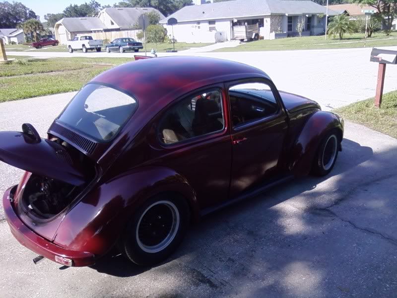

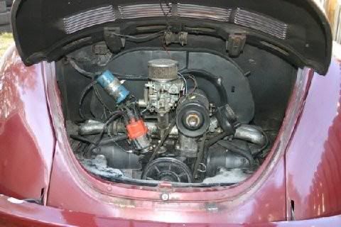

PostPosted: Tue Nov 02, 2010 10:36 pm    Post subject: Reply with quote

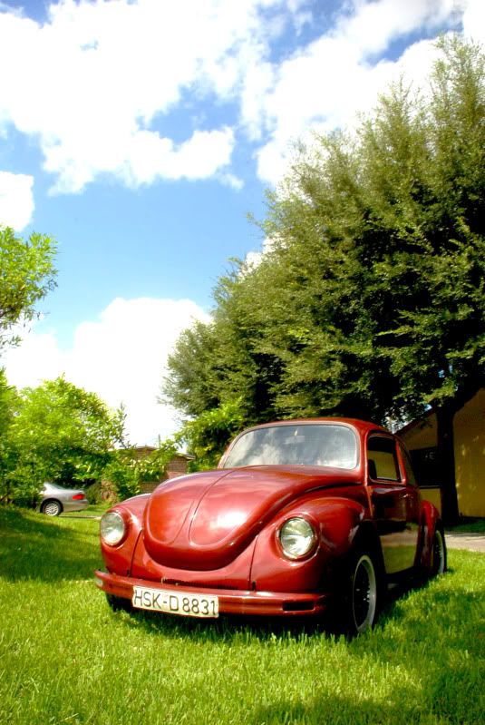

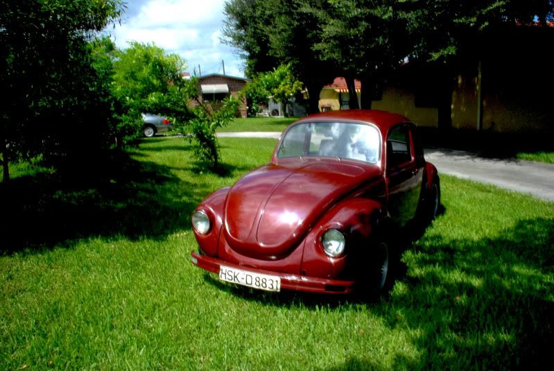

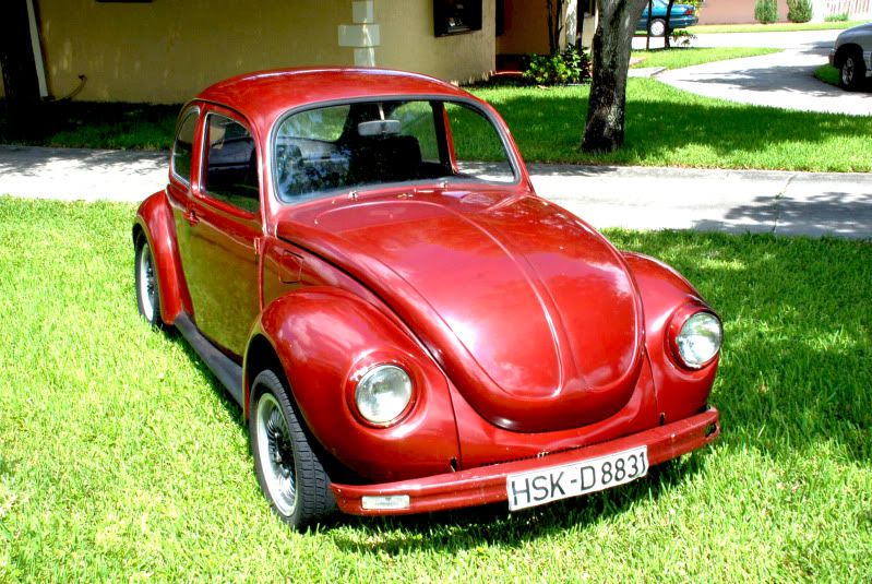

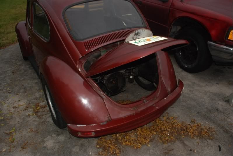

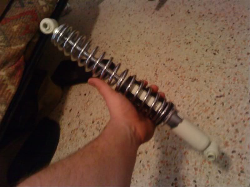

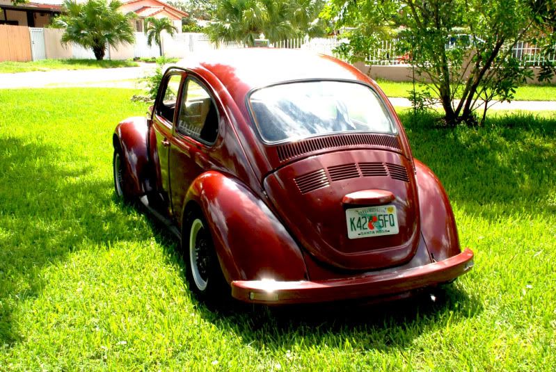

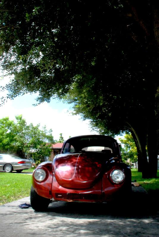

Up in Orlando
In My driveway
Western Wheels
Old Motor
Header Muffler
Down the FL Turnpike at 80mph
Rear Coilovers
Solid Tranny Mounts
Dropping the motor
The New Motor
Photoshoot in my yard
There you go. Ill be updating regularly as a go along.

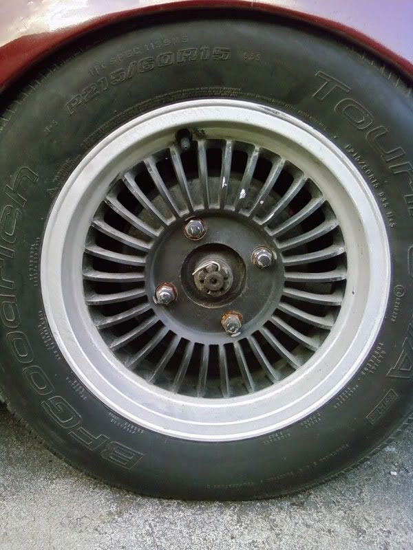

What tire size you have in the front? Do you have the stock strut spring? Rim size?
lots of questions huh! Confused
Thanks.
Thanks.
haha its ok. Im glad to help. the front I dont remember right now. But ill get you the size a little later. Its POURING outside right now. Damn Florida weather!!
@Nepenthe88 - If you do get one, a 12a is easier to work with considering its already carb'd but a 13b has a bigger market. 13b are originally EFI so converting is annoying IMO. The build can run a bit expensive. Mainly due to the transmission upgrade and the adapter.
