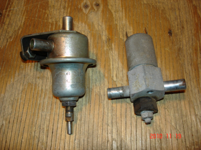

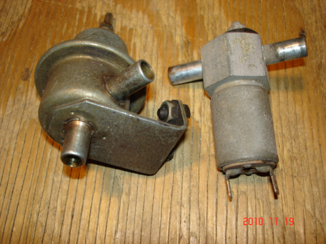

Ahhhhh.... the Samba gallery, it's amazing!:

What's even more amazing are the prices those auto decel valves (on the left in those pics) command these days. They's NLA for looong time. I grabbed one to rathole. If you have a late auto bus, you need to do the same.

well thats made me double take.
I've got the one on the rhs.
Per BD pic I clearly do have a decel valve but bentley said I didn't (FI section, 10 I think, page 24).
So after reading it didn't I assumed it was the aux air regulator (per bentley also section 10 page 12)
So if that is decel then I do have one. It connects into the air filter S housing.

Congratulations, the AAR is the dotty thing that #50 connects to in the diagram BTW Wink
