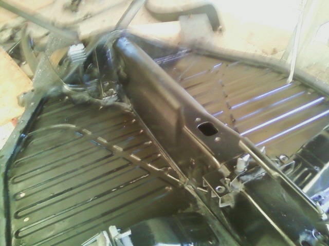

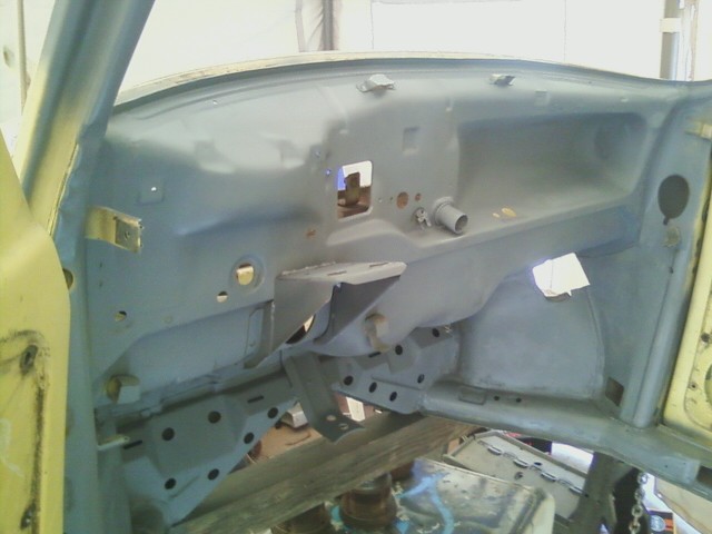

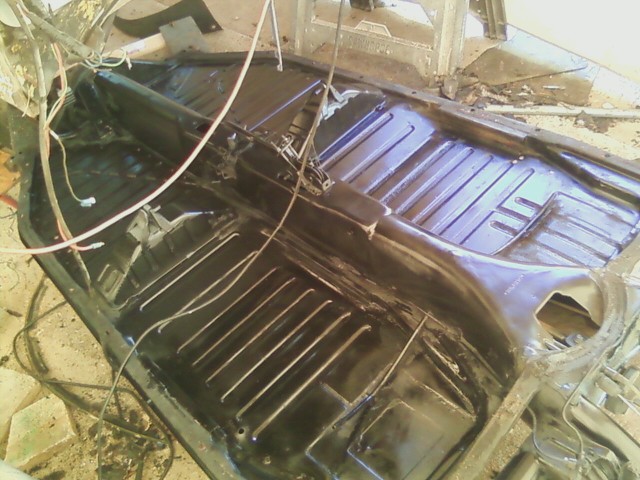

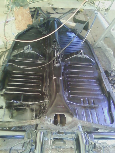

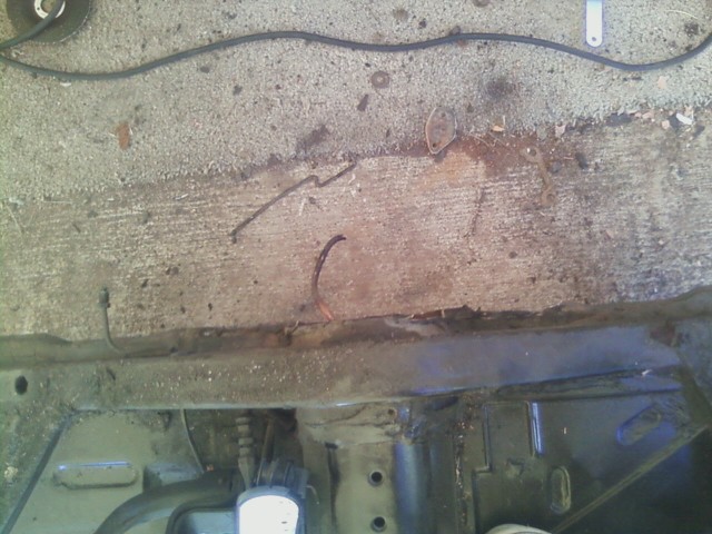

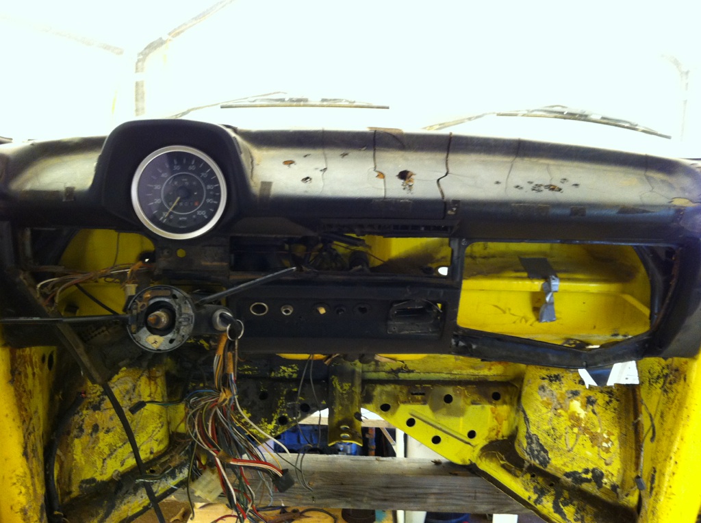

Got quite a bit more work done on the car yesterday and today.
My damn camera didn't work so i dont have pictures of the frame after i stripped the pan all the way down. Evil or Very Mad
So I striped off all the insulation and nasty glue. and got rid of the little bit of the surface rust at the battery tray. Rattle canned satin black for now once its almost done and is i get more funds i plan on doing truck bed liner. But this will get me by.Anyways here are picture of the finished product!
Let me know what you think
Sorry about the quality. These are off my phone until i can fix the camera.
Dash is also all ripped out. It was a pain to get to all the mounts. I plan on doing something nice and simple once i get the cage put in.

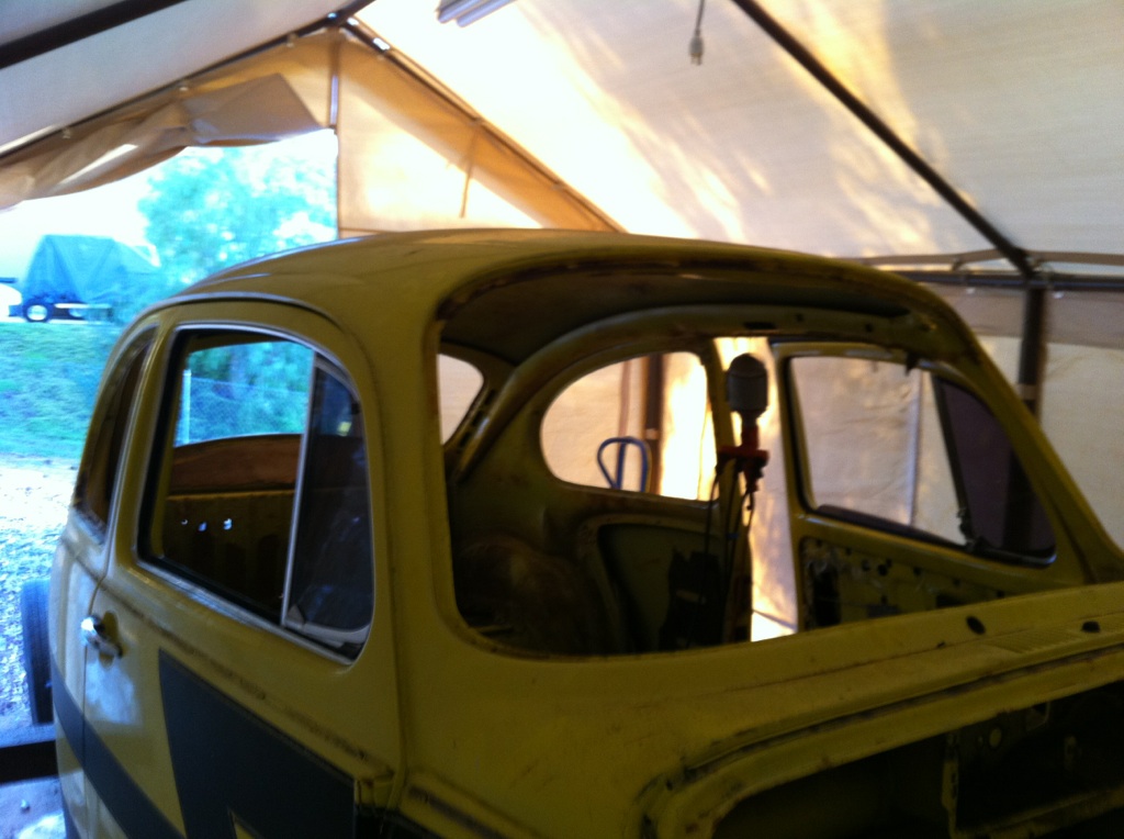

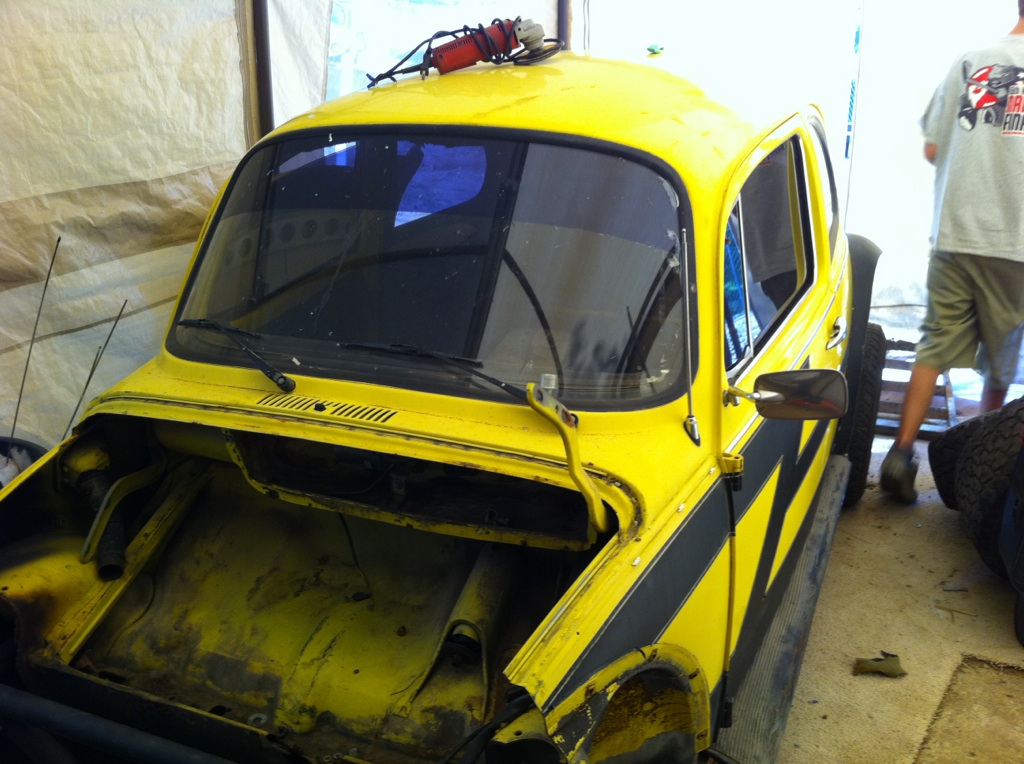

Today i was able to get alot more work done on the car after i got out of school. I had an extra hand so we were able to get alot more than usual done. We started on the body work scince the pan is all painted and ready to go.
First we carefully took out all the windows starting with the rear quarter panels and working our way up to the Windshield. Luckily we too them all out with out any cracks or messups. I was very happy with that. When first figuring wether to try to save the seals or not I figured that id rather have to buy new seals then chancing on buying the windows. So all the seals are shot but it no biggie.
After popping out the windows we went ahead and removed the windshield wipers and the motor and anything else that was remaining such as the rubber seals for the doors and any other thing that wasn't sand able and paintable. So we just started doing body work and cleaning every thing we could out.
Anyways looking forward to another half day of work tomorrow on the bug.
Actually making some process. Surprising.
Pictures!
I hate taking this stuff out!!
Both the '69 and the '74.

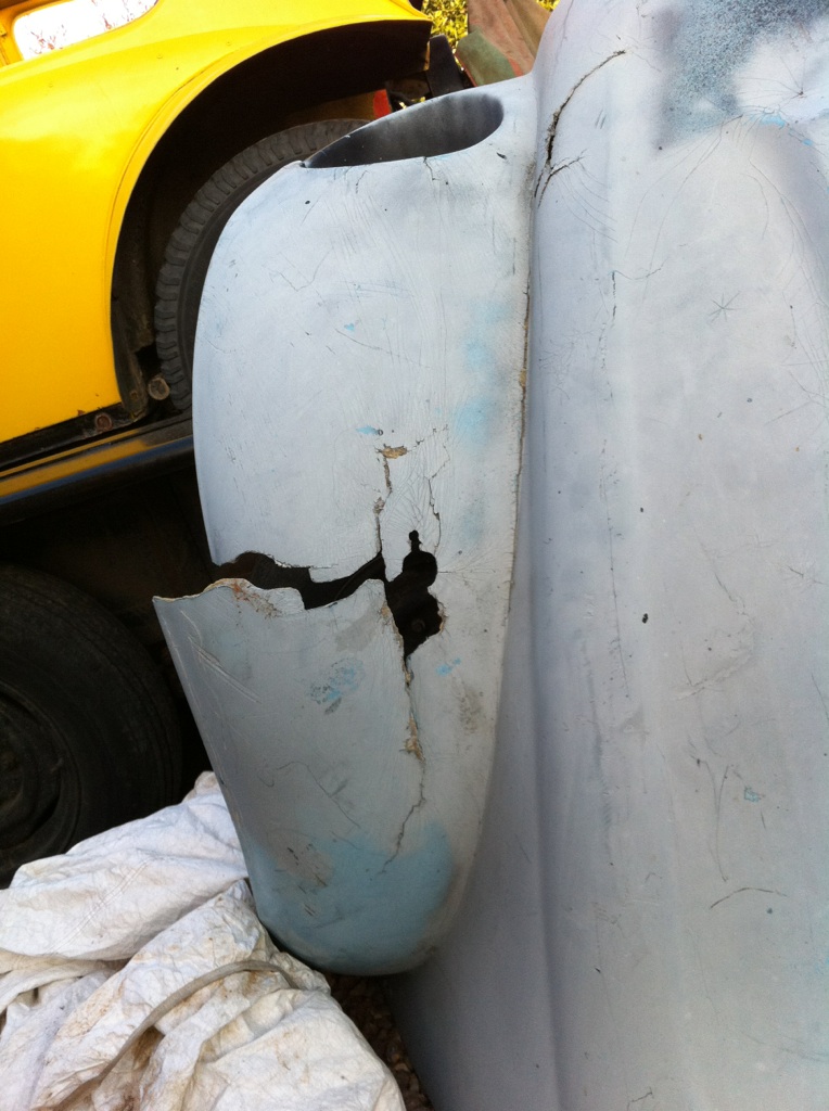

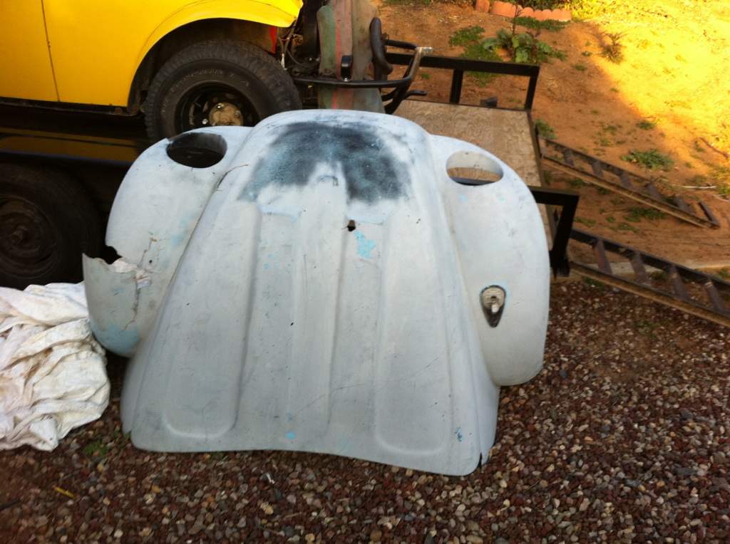

Right here is the one piece front end that the person i bought the car thru in for free. Its pretty beat up. Especially the left fender. Im not sure if im going to Get my friend to fiberglass it for me or if im just going to toss it and buy a used one..
What do you think i should do?
Here it is.
The damage
Let me know what you guys think!

vpogv
Joined: August 14, 2008
Posts: 230
vpogv is offline
PostPosted: Sat Feb 05, 2011 5:44 am    Post subject: Reply with quote
It's beat up but fixable. Should be able to fix it for less than a new one for sure.
larryvance66
Joined: January 27, 2009
Posts: 731
Location: Virginia
larryvance66 is offline
PostPosted: Sat Feb 05, 2011 8:14 am    Post subject: Reply with quote
IMO fiberglass work is the simplest body work you will ever do. Clean it, stick it, sand it, fill it, sand it, done! Very Happy Projects look great! You gotta lotta gumption for someone your age. Keep it up, we will be watching. (and drooling Wink )

rubsterob
Joined: December 31, 2009
Posts: 755
Location: Boise Idaho
rubsterob is offline
PostPosted: Sat Feb 05, 2011 11:15 am    Post subject: Reply with quote
If you do fix it take off the other blinker and fill in the hole under that. To me it looks like the blincker is what caused it to break to begin with

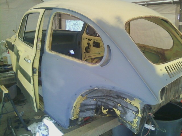

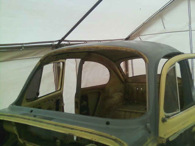

PostPosted: Mon Feb 07, 2011 11:18 pm    Post subject: Reply with quote
Finnaly got some more work done today. I wasnt feeling so good over the weekend so i didnt work on it at all. But after a day of school i worked on it this afternoon. Anyways straight to the pictures!
My friend let me borrow his grinder because mine broke a couple of weeks ago. So i used it for most of the work i needed to cut off and clean up.
First i cut off the remains of the front end off the super beetle.
This is what it looked like first.
Sure gave me a fight! but i finnaly managed to get it off.
Top veiw

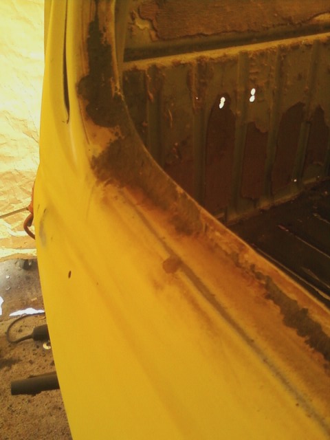

After cutting that off i moved to start stripping the outside paint on the two quarter panels. And i stumbled across some nasty rust that i hadnt already seen. Right in the rear passenger side window seal. take a look.
Anyone know best way of fixing it? or does it just look like surface rust that i can sand down?
Anyways this is the next spot that im going to strip down, right under the dash. Its a mess.
Also i was looking at the spot where the stock gas tank cap goes and was wondering what a good way to fill this spot would be.
Should i just pull it off and weld a little sheet over it? Or would it be easier and better to just bondo the cracks? I havnt bondoed before but im up for learning.
Here are some pictures of it.
Thanks for looking!

PostPosted: Tue Feb 08, 2011 4:28 am    Post subject: Reply with quote
The rust in the window channel doesn't look too bad. Just sand it and go from there, but from the pics it looks to be surface. As far as the gas door is concerned, you can just weld up the door or cut some sheet metal to fit and weld that in (just tack welds around the edges spacing them out and allowing cooling in between to prevent warping the panel). Just bondoing it in will not last at all. Looking like a pretty solid start though. Keep it up!

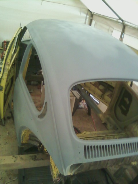

PostPosted: Sun Feb 13, 2011 11:46 pm    Post subject: Reply with quote

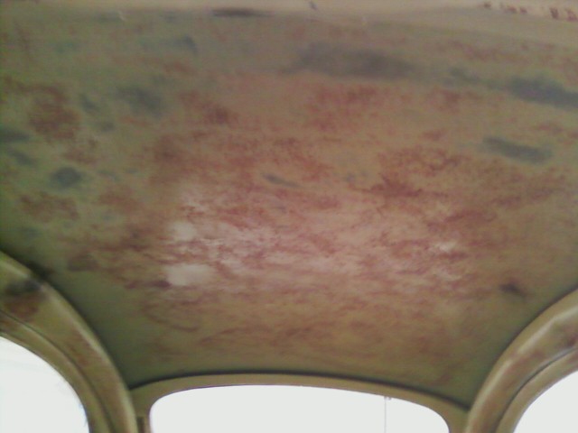

Ive been sick the last week or so.
I havnt gotten much work done to it. But today i went ahead and preped some spots for primer and went ahead and primered them..
Here are a couple pictures.
Hoping to start to feel better so i can finish cleaning and primering the car!
Im also having trouble getting the doors off. Evil or Very Mad
Im unable to loosen the screws enough. Any insight to getting them loose?
Thanks for looking Shocked

PostPosted: Mon Feb 14, 2011 12:47 am    Post subject: Reply with quote
you need an impact screw driver. You hit it with a hammer and it presses down and turns at the same time. You can find them at kragens for like $15.

PostPosted: Wed Feb 16, 2011 5:58 pm    Post subject: Reply with quote
get a torch, propane if that's all you can get, and heat up those door screws till they're nice and hot, then try to unscrew them.

I went ahead and got some work done today after all. I got some more primer so i was able to paint all the rest of the areas i had cleaned off the other day with the sander..
So straight to the pictures of the progress.
As you can see the intire thing isnt done yet.. here are some picture of the places i still need to clean before primering..
back seat area
Outside dash
Inside roof

Been busy the last couple days.
Was able to prime a few more sections today. and i also finally got the doors off.
Took a good look at the one piece front.
I can see why it wont work on the super.
The hood top is alot farther back then the standered would be so it wont line up with the fender wells at all.
I have a number to someone that make kits for supers.
or ill see if i can just fiberglass mine to work.
