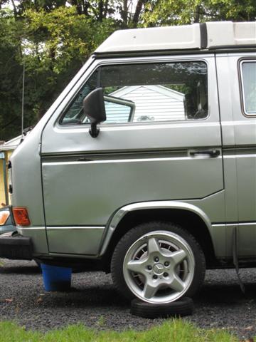

Hey guys, I grabbed these MB rims for my auto 2wd westy. 5x112 16 x 8 possible Offset +42mm. not 100%
need the usual help on fittament. here was an old thread and did some research but could use some guru action. I will post pics in a bit but the link has pics and specs i think.mercedes 1634010202 Ed
Hi Ed,
You know, as good as those wheels look on a Vanagon, the 8" width just does not play nice on a 2wd. You end up pushing the wheels way too far outboard just to gain the necessary clearance between the tires and the upper control arms. A Syncro has completely different front suspension which is why they can work there, but not on a 2wd.
And just for the record, the offset on those is 62mm, not 42mm.
poptop
Joined: February 27, 2003
Posts: 607
Location: jersey
poptop is offline
PostPosted: Thu Jun 23, 2011 3:53 pm    Post subject: Reply with quote
Now what? Non refundable! Is there Absolutly no way to use them. If not I cAn try to find narrower ones for the front. Or these sweet rims are up for grabs. Uhgg

PostPosted: Thu Jun 23, 2011 4:21 pm    Post subject: Reply with quote
Here's the deal! We can build adapters to physically bolt them onto your van (you will need adapters because the difference in offset is too great to make up with traditional spacers). However, the front offset will be way off from ideal and the front wheels will most like be sticking out of the fender openings a bit. The rear track width will be much narrower than the front because we have to tuck the rears in enough to clear the sliding door. In my opinion, all of that conspires against the installation on a 2wd. If you are determined to install them, regardless of the negative effects, we can definitely help you do that, but I wouldn't recommend it.
That style of wheel was available in Europe in a 16x6½ ET47, but they were never imported into the US. If you can find a pair in Europe, yes, you could definitely use those on the front.

PostPosted: Thu Jun 23, 2011 5:52 pm    Post subject: Reply with quote
I saw a couple 6.5s on ebay but that creats issues for rotations. They look sweet. I'll see what i can find. In the meantime if anyone needs them for a syncro pm me.

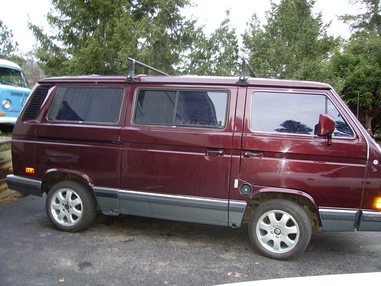

The new owner of the Atiwe 7s and 9s I had for sale a while ago has just sent me some photos...

PostPosted: Thu Jul 07, 2011 3:54 am    Post subject: Reply with quote
This is a sharp looking van! I see you are from Oregon, did u by chance happen to be up in Washington on the Key Peninsula last weekend? Pretty sure I spotted you.
