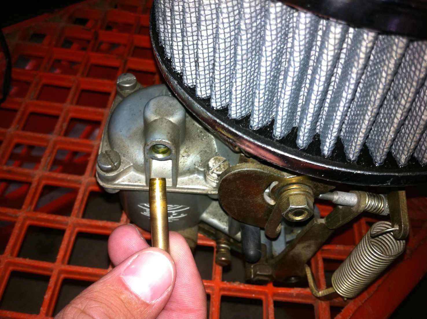

so, i was driving the other day blah blah blah, got home and lifted the engine door to let her cool off, then i smelled STRONG gasoline and thought, oh crap. so i looked at my fuel lines and the inlet to the carb was soaked. so i played with it and it just slid right out!
so i plugged the line and am trying to figure out the best way to fix the carb.
should i get some kind of gas resitsant sealant? and switch ends and press in the good end? gimme yo ideas! thanks.

You’re lucky you found it when you did; the thing to do is thread in a brass pipe fitting as they do on Formula V prepped Solex carbs…

Yep, 1/16" NPT IIRC, hard to find but available online, there's a link in one of the many fuel line threads.

Thanks for the spec BD-
FYI, Found a samba post with links where to buy parts :0)
http://www.thesamba.com/vw/forum/viewtopic.php?t=420661
1/4 x 1/16 Hose Barb X Male Adapter ( $4.35)
http://www.fastfittings.com/product/32301
1/16"-27 NPT National Pipe Taper High Speed Steel Pipe Tap ($5.90)
http://www.amazon.com/National-Pipe-Taper-Speed-Steel/dp/B000U7LSPO
