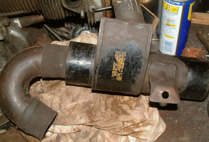

Hi. Anyone knows what year VW used thiis type of Luftfiler/Airfilter? I have in for my 1949 std. mod VW. But the engine is from 1952?! the pic is in the gallery on this forum!! BT, Norway

This is the "Cyclonic" air filter, referred to as "Kübelwagen" air cleaners by some of the VW old-timers. In any case, these were commonly found on Hoffman-imported, U.S.-market splits. There is a discussion on them in this thread:

This is the Mann "Cyclonic" felt cone air filter, first used on VWs (Type 11A) in July 1949, at Chassis No. 1-0114186, according to Progressive Refinements. However, some old-timers refer to these as "Kübelwagen" air cleaners. In any case, these were commonly found on Hoffman-imported, U.S.-market splits. There is a discussion on them in this thread:
http://www.thesamba.com/vw/forum/viewtopic.php?t=325034
I have seen a cupple of these filters but dont think I have seen the MANN version, all I have seen would be KNECHT. Some say they would be a better solution for dusty roads. They would allso be used on the dual carb Express kit. The filter could be a dealer and not customer option, anyone know?

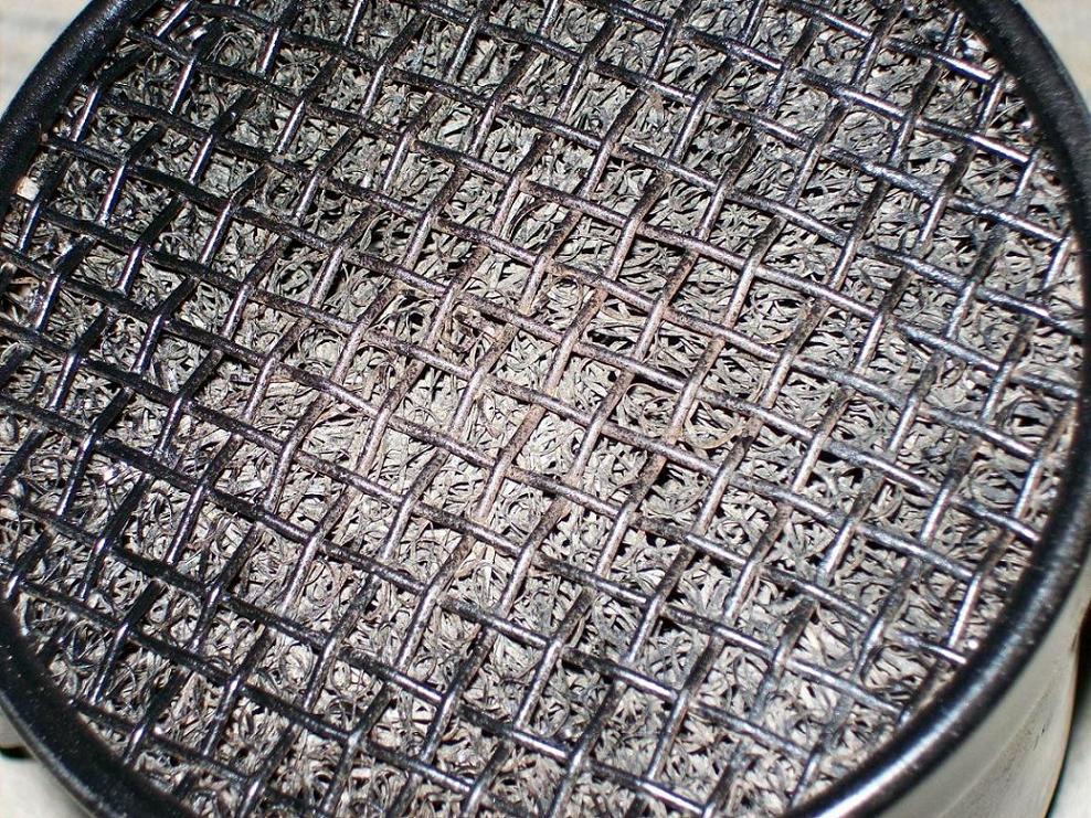

I believe you are correct about this version being made by KNECHT. It is also not a felt element. The filter element is sort of like those old copper pot scrubbers.

I forgot to write, its a Knecht filter.

Its maybe original to your car. They put it over when they put a newer engine in it. Factory rebuild engine maybe? Is your car Møller import?

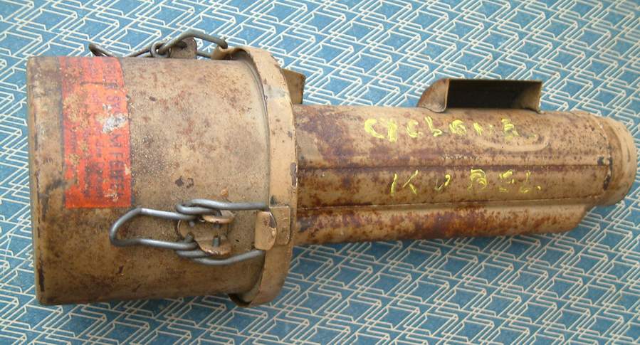

The oldtimers probably refered to it as a kubel filter because it is very similar in appearance to this, note how the clamps are identical (could well be from the same manufacturer):
The cyclone first appeared during the war to address the dusty conditions of N. Africa and Russia in the summer. The above one is quite rare, this is the more common version, sorry it's not a better picture:

I agree--original post edited. To answer the original poster, I would say the cyclonic filter was discontinued when the oil bath filter was introduced (20 Aug 52). Garwood mentions (pp. 38, 92) that either the Mann "mushroom" or the Knecht "sock" filter was used 1945-48. I cannot find a picture of the Knecht "sock" filter in the gallery, but I saw one several years ago and thought it looked very similar to the cyclonic filter, but with a felt sock in place of the mesh filter element.

Just brought home this May -52 engine with just the same type of aircleaner.
This one is a Knecht.
