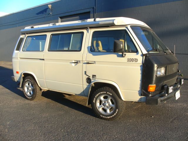

madspaniard
Joined: August 18, 2008
Posts: 3795
Location: Alameda, CA
madspaniard is offline
PostPosted: Mon Nov 12, 2012 2:00 pm    Post subject: Reply with quote
I have the most recent version of the Van Cafe (syncro.org) springs.
There is a lot of info here, especially towards the end.
http://www.thesamba.com/vw/forum/viewtopic.php?t=499853&highlight=suspension
I can give you more info about my particular set up if needed but that thread contains most of it.
PostPosted: Mon Nov 12, 2012 2:03 pm    Post subject: Reply with quote
tarandusVDub wrote:
This thread among others have said the VC springs are too soft...
Not the case (so far) for the newest version that I have installed in my westy. If something, they fall on the stiff side.

Madspaniard, which VC springs do you have? My 86 Westy has stock springs with Koni shocks. I like the ride, but wouldn't mind better handling and a slightly lower stance (my Westy just, and I mean just, clears my garage door opening).
madspaniard
Posts: 3795
PostPosted: Mon Nov 12, 2012 5:21 pm    Post subject: Reply with quote
these ones
http://www.van-cafe.com/home/van/page_837_533/2wd_springs.html
Their latest version came out in late June and I instelled them shortly after.

PostPosted: Mon Nov 12, 2012 10:39 pm    Post subject: Reply with quote
madspaniard wrote:
these ones
From the other thread
madspaniard wrote:
No affiliation to vanCafe or Syncro.org, just chasing my suspension nirvana here.
As far as I know, what has changed from the previous version of these springs is:
front springs: thicker spring wire, same spring rate
rear springs: slightly stiffer spring rate
The fronts are hot wound, the rears are cold wound and made of chrome silicon.
I have Knoni shocks and 15" Nokian WRC tires
These are the same springs I installed this spring. I have Koni Shocks with 15" wheels and 215 75 15 BFG's. I had to add a couple of spacers to the top to the front shocks to keep the BFG's from hitting the wheel well. I also have ADDCO Sway bars front and rear. My van handles great. The VC springs are not to soft, and for the first time since I have owned it I can ride along behind a Semi truck without being blown all over the road.
It definitely is taller than stock but not as high as the 1-1/2" lift springs.
