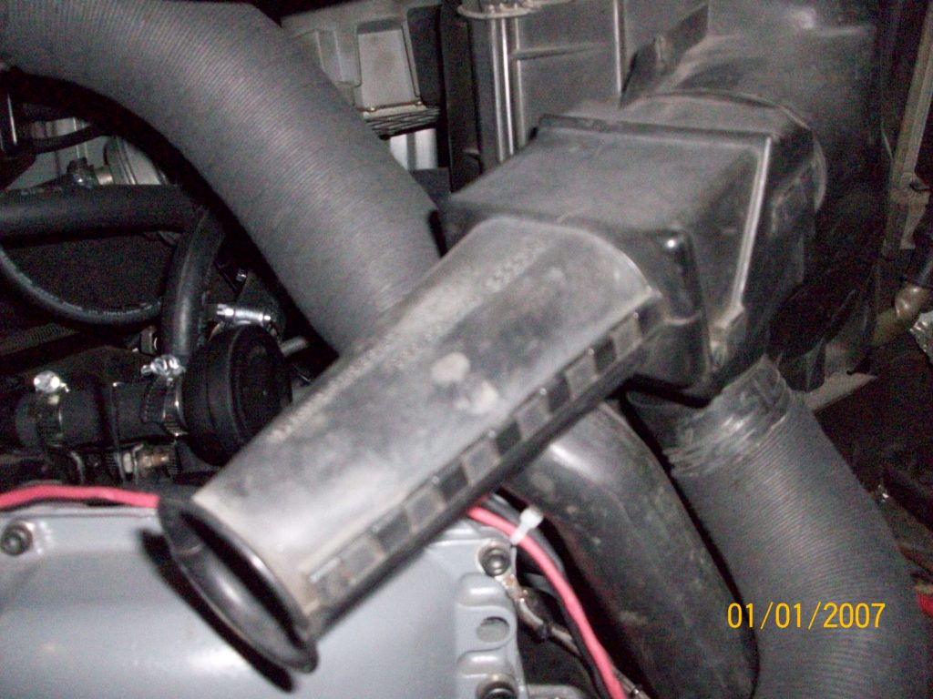

Another work in progress nearly complete now is the breather box on my Type IV motor.
I have a type IV motor 1975, built at 2 liters, using the stock FI. I have a cheapo EMPI exhaust on it.
I do want to post this because I found a solution that was not expensive, easy to retrofit and can be taken to the next level for a final outcome.
Here are the links to the 2 post's on this site in regards to the subject matter where as a lot of replies went back and forth.
http://www.thesamba.com/vw/forum/viewtopic.php?t=251133&postdays=0&postorder=asc&start=0
http://www.thesamba.com/vw/forum/viewtopic.php?t=295812&postdays=0&postorder=asc&start=0
There were some others. Several regular posters SG Kent and Ray Greenwood talked about making replacement parts for the existing units and a ton of discussion on how this thing works. Some discussions were to convert from factory crank case pressure regulator to a PCV valve of some sort etc. etc. I also ran into posts and replies about just leaving the oil level low on the stick and the blow by is reduced. Not completely but less never the same. This does not work for me as this motor is like a 3 quart motor in the case and leaving out a ½ quart or more is a disaster waiting to happen.
I kind of discovered that a 2002-04 Audi A4 uses the same pressure regulator just a little different looking than ours in mounting. Here is the supplier.
http://www.ecstuning.com/Audi-B6_A4-FWD1.8T/Engine/Emission/PCV/ES7858/
I bought it and put it on my motor using the old "blown" pressure valve as a 90 deg elbow breather tube. See the photos attached. Also use some sealer on the little vent hole on the old pressure regulator that was a ambient pressure vent hole for the blown out diaphragm that is in the sealed case of your old pressure regulator. This completely seals the old pressure regulator and makes it an elbow for your new regulator.
Fast and Easy. Like me Smile
When I got my bus and tore down the blown motor, aside from the usual evidence of low oil, hot oil, overheated parts there was a lot of oil from blow by out of the crank case in the "s" boot, plenum, intake tubes, valves, carbonized pistons etc.
As I bench tested every component of my FI (many times over and over) to understand how this is going to work, when I got to the pressure regulator I had a feeling this thing is not right but not knowing what I know now I put it on the motor and kept going.
I have sorted out the leaking front/rear main seal problem (3 times pulled the motor) and I have no drips. I was still consuming oil from top line fill to the lower level. As I did the motor pull three times I noticed oil in the "s" boot, throttle valve, hoses coming out of the breather box. hmmmmm.... I did some homework (read the samba links about 20 times) to figure this little thing out and then went out to find a new one. They don't exist any more. Somewhere I stumbled on a search for pressure valves that they are on Audi's and VW passats etc. Went to a junk yard and found these things but they were in bad shape.
Found this site ECS Tuning) and bought one. Trippy, it does not completely stop flow of pressure but it stops a lot of it. More than by half (my guess with it in my mouth) Smile
The site did take two weeks to ship it as this is one of these drop ship joints on the web selling stuff. It eventually it got here.
I found an Audi forum that explains the pressure regulator the best I have seen. Here is the link;
http://forums.audiworld.com/showthread.php?t=2802385&highlight=pcv+valve
Here is the description that I am referring to;
"For the part you have referenced, here is a description from "diagnosticator" over on AZ. Guy knows what he is talking about:
"The diaphragm is crimped around the edge and forms a chamber between the top of the diaphragm and the top cover. The bottom side of the diaphragm forms the top of the lower chamber that has the center inlet port and the outlet ports. The top chamber is vented to the ambient air pressure. When the pressure at the outlet port is lower than the crankcase pressure relative to the ambient pressure, the diaphragm is pulled downward and partially blocks the inlet port inside the valve, reducing the volume of crankcase blow by gasses that are pulled out of the crankcase that flow into the tip. When the CC pressure is higher, the diagram moves up away from the inlet port, increasing the flow area inside the PRV and vents more blow by to the TIP. The distance of the bottom side of the diaphragm from the inside end of the inlet port, and the resulting flow area of the blow by gasses in the valve, is determined by a balance between the crankcase blow by volume and pressure, the outside ambient air pressure, and the pressure in the TIP.
When the valve gets old, the diaphragm gets stiff and will not respond to the low pressure differentials that operate the valve normally, effecting crankcase ventilation control accuracy." "
I have 300 miles so far on this pressure regulator and I am happy to report no more oil in the hose from the tower to the "s" boot. It is dry as a bone. My hot idle became more consistent and stable since I put this new regulator on. So I been able to drop the idle screw on the throttle valve back a 1/4 turn. I have a hot consistent idle at 850 rpm. Very sweet….My biggest deal was the oil suck into the intakes. This is just carbonization waiting to happen.
I have to think that a vast majority of busses have blown pressure regulators. Now you have a 50 dollar fix. Also this part comes off a 1.8L, 4 cylinder motor so the pressure setting for blow off has got to be nearly similar.
This is a fast and easy fix for most any one at this point. If you want to get a little more fancy, go to the plastic store in your area and get some high temp plastic sheet about 1/4 thick and pattern the bottom of your original pressure regulator mounting to the tower box. (it will look kind of like a oil filler tube gasket) make your center hole the size of the new pressure regulator (eng suck side) JB weld it to your new mount plate and put a o-ring on the bottom and bolt it on. Not as fast and easy but....nearly stock looking for you tinkerers.

ser123ser
Joined: February 03, 2008
Posts: 148
Location: PERRIS CA
ser123ser is offline
PostPosted: Fri Jan 06, 2012 9:12 pm    Post subject: Reply with quote
1975 kombi, its the same as the original output side of the pressure regulator. When I went looking in Junk yards I found these pressure regulators and noticed they were the same in hole sizes as the original. But they were all broken or "suck thru's" None of them worked. So I manned up and bought one as I noted.
I did not buy the cloth covered hose that cost's 20 bucks from the vw joints for the breather box connection to the "s" boot. That is a rip off.
The hose in the picture is 3/4" vent hose that I have been using for about a year now clamped tight.
I cut into the existing hose as you see in the pictures and stuffed this thing into it and added 2 clamps. Pretty much a perfect fit.
fast and easy
Steve
Perris CA
outstanding in my field.
