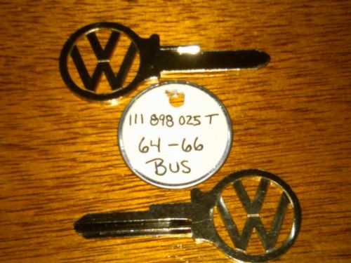

64-66 Bus Key Codes are T series...Example: T3307

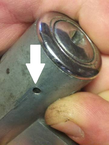

Ignition 64-66 Bus:
Front Door Handle 64 -66 Bus:
Rear Hatch Lock 64-66 Bus:

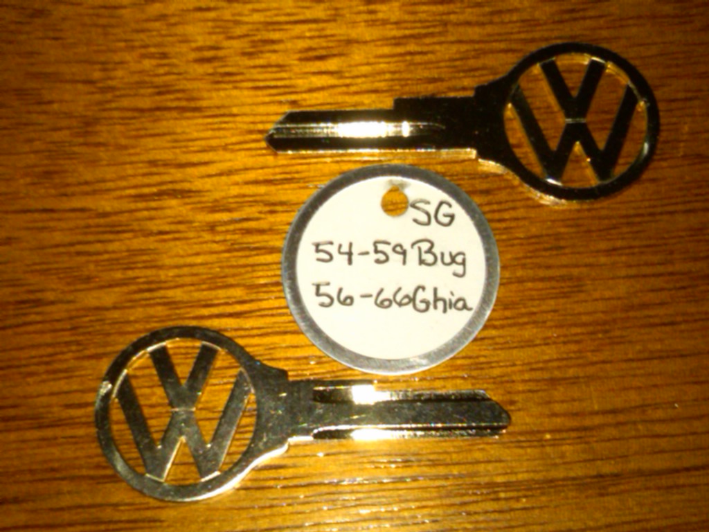

PostPosted: Tue Feb 07, 2012 9:31 am    Post subject: SG Code locations for 54-59 Bugs Reply with quote
Here are some SG codes. 54-59 Bug

PostPosted: Tue Feb 07, 2012 11:55 am    Post subject: Re: SG Code locations for 54-59 Bugs Reply with quote
SteelersBus wrote:
Hey, that T handle looks familiar... Wink

PostPosted: Thu Feb 23, 2012 1:13 am    Post subject: Re: SG Code locations for 54-59 Bugs Reply with quote
This is wrong. The switch in the pic is a 58-59 switch. The 54-57 switch looks different because the oval's dash is a different shape.
Sometimes the codes are stamped on the body of the switch too. And some switches have no code whatsoever!

PostPosted: Thu Feb 23, 2012 10:20 am    Post subject: Reply with quote
That picture was posted to give a general idea of where most codes are located for 54-59 SG codes on ignitions. Yes, the 54-57 ignition has a longer mounting tab. All are SG codes, which I was referring to.
If you do not see a code, be sure to try to locate a VW emblem or part number to be sure it is not aftermarket.

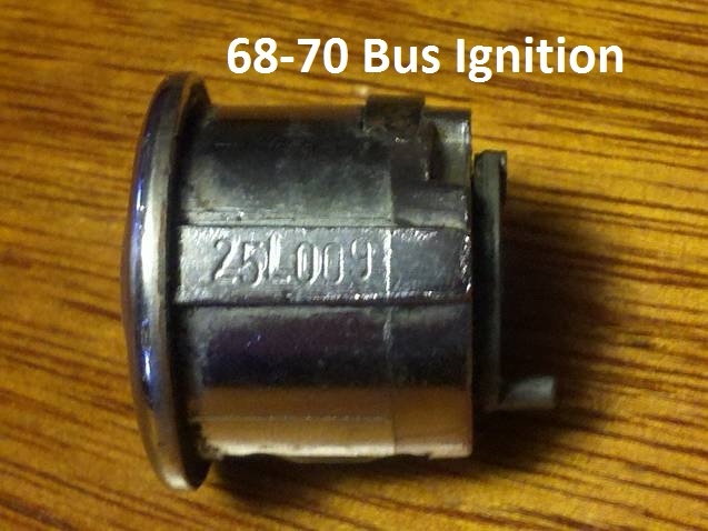

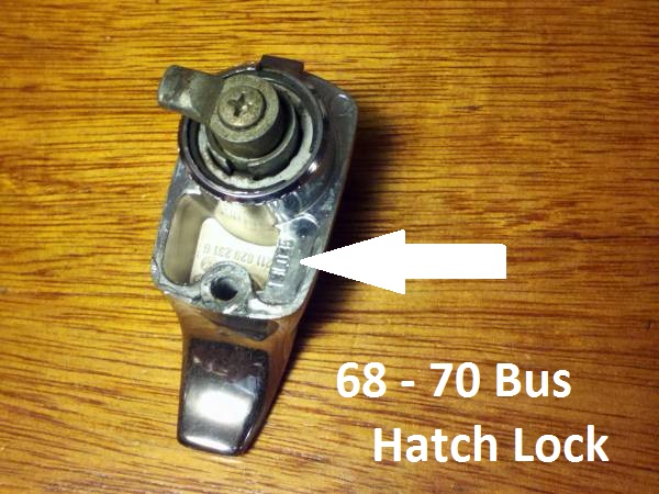

Early Bay Window Bus Key Codes
68-70 Buses are L Codes...Example: 23L098
L series Key Blank
The housings from 68-70 vary but the idea is the same. A tension spring has to be depressed to release the ignition barrel.
The front door handles are held on by two 4mm screws. Once handle is removed, the code will be at one of two locations.(seen in first picture)
Rear Hatch Lock

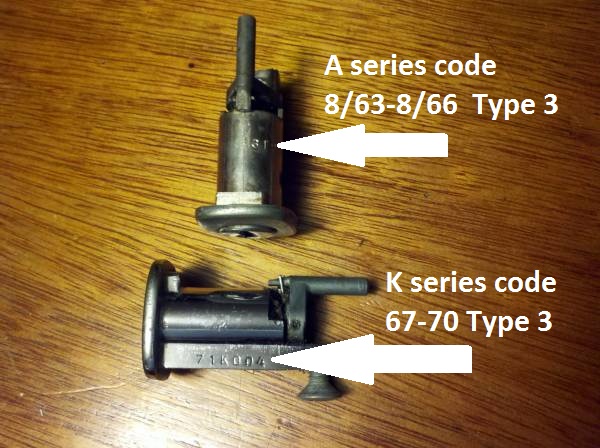

PostPosted: Sun Mar 11, 2012 8:08 pm    Post subject: Reply with quote
Any pix for type 3 key codes/locations?

PostPosted: Sun Mar 11, 2012 8:14 pm    Post subject: Reply with quote
For a 65 Notch?
