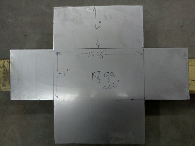

This gonna happen tomorrow
I am going do see how big I can make it...
I would luv to 10 5/8" in height GC2
It does not look like that can happen BUT maybe
if i try like you suggest cut out the bottom
& just make a sleeve box that a bit higher than the existing box & can get 11" ..
in any case I think I will sleeve it & make the 2 new sleeve boxs removable ...
that is a very good idea

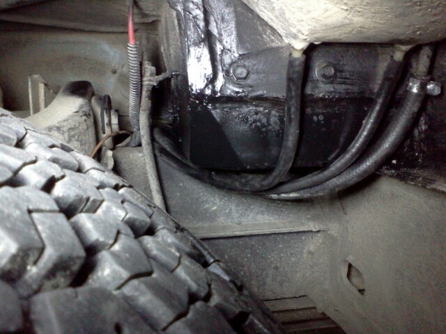

So I did the dirty deed & figured in for a penny ..
So I opened the battery box up to fit a Group 31 deep cycle 125 AMP Hrs that be 250 for both Smile
The box size 7Wx13Wx10.5H and both seats still rotate
So I dont think I can allow for the battery box to be removable & still create a water tight seal
with all the water kicked up by the front wheels
If you elect to just cut out just the bottom of the box maybe so I but that extra 50AMP hrs I get from the group 31 vs group 27 was worth cutting out the wall on the finder
Ill post a few more pics of the final mount after they are installed & water tight

jordauto wrote:
That looks great. Yes,my thought was to leave the existing walls and only remove the bottom. That would allow some foam gasket tape to seal it.
yah for a group 27 you have about the same width as group 31 you CANT get a horizontal sealing surface that you can clamp down
so you are left with a friction seal from the sides
& foam gasket self adhesive is going to be exposed to some pretty harsh conditions
mud snow rain not a good long term sealing in a vertical position
jordauto wrote:
Could you weld in some 1/8"x 1" around the top of the opening to make a flange for a seal?
Yah I don have much space for flange I am not quite sure why i want to make the box removable..
Other than I like the flexibility & be able to change the tank seals w/o dropping the tank Smile
I can seal it fully with urethane
But I will mull it over for a few days just in case I see a way that would be fool proof

A sawzall was used to cut the hole.Using care not to cut too deep and cut any fuel lines below.The raw metal edges were cleaned up with a small grinder and painted to protect them from the elements.The next step was to prep the steel and cut it.I used 18 ga steel which is thicker than the original.
I used a metal brake to bend the box and tack welded the corners before a test fit.I started with the plan of using a group 27 deep cycle battery but had to downgrade to the group 24 due to possble tire contact concerns.So the box was removed and the outside leading corner was cut off to increase clearance.
This shows the new box all welded and cleaned up ready to paint before installing.The small round hole will allow the upper control arm bolt to be removed without having to remove the whole box.There is a small cover that is held on with sheet metal screws and sealed with silicone.
The view of the finished product installed and sealed.Auto body sealer was used to seal the joints and then painted over.The box is semi permanent,it's held in with screws and bolts so it can be removed if needed.
This shows the height and clearance over the group 24 deep cycle. That pic actually shows the group 27 before the box was cut down to fit the 24 but they are both the same height. I ended up using the group 24 deep cylce from Costco,it was the most AH capacity for the price and the warranty is good anywhere there is a Costco. 95 Amp hour rating for $ 77.00 cdn. I believe the original group 41 was about 40-45 amp hours.So there you have it,almost double the battery capacity and no loss of storage space in the camper.Total time from measuring to completion was about 1 1/2 days.
