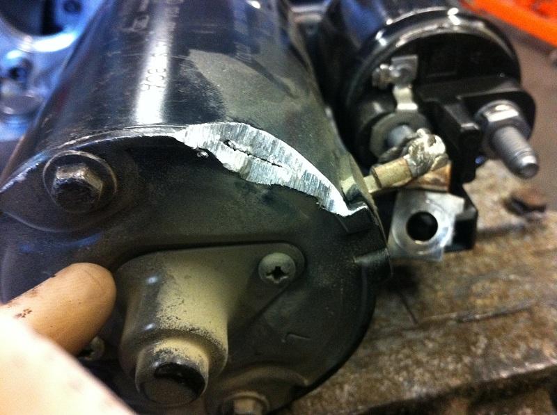

As for my no start, it was the connector on the starter. Must have been being held on by the fuel tank and when I got that up off the trans, the connector fell off. Better now than later!

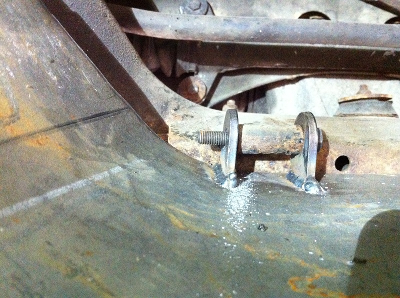

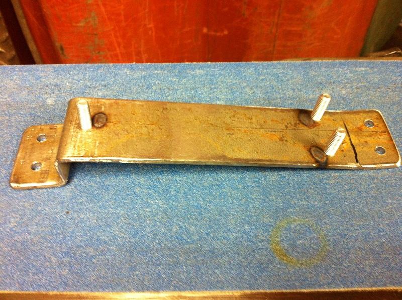

I got my awning reinstalled, I got those Fiamma brackets I was talking about earlier to fit on the Apollo awning. They work great. Lots of work to get them attached but I am pretty sure they aren't coming off!
Backside, you can see where I cut the top rail off. I also tack welded the nuts to the bolts.

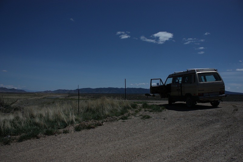

I finally got to 'actually' give it a good drive today! And drive it I did! I drove out to Five Mile Pass recreation area West of Utah Lake. 300 KM round trip (Canadians... so that's about 180 miles for the rest of us) Pretty freaking rad. The only other cars I own which could do some of the stuff (caddy and T181), wouldn't be able to do very well without at least a diff. Lucky for me, those smarty pants engineers decided to bless us with lockers and AWD. It's fantastic. Most of my cars are pretty low so I have a HUGE mental block to get over with how much ground clearance this thing has. Also climbing capabilities are above what I had first expected (watch till the end of my video, I don't even want to walk up or down it!)
Here is a video of some of what I did today. Ranged from highway, nice dirt roads, ATV stuff, pretty tight roads (roads?) and other stuff. Sorry for no outside views, it's a little hard to film stuff by yourself. Oh yeah and it's filmed in HD, so watch it in HD...
And some pictures... some iphone, some DSLR
Beautiful cold morning to start off with!
My first gnarly road! It got way worse after this so I had to turn around (probably could have made it but would have wanted a ride out just in case)
awning pics
I have the exact same one. I don't use the awning anymore. I don't trust the attachment.
I still have the alumium ones but they don't work well I find.
Theu don't catch the gutter that well.
Did you make those for the exact same reason?

Yup. Basically it felt like the awning was going to fall off or break off the rain gutter. This one isn't coming off!

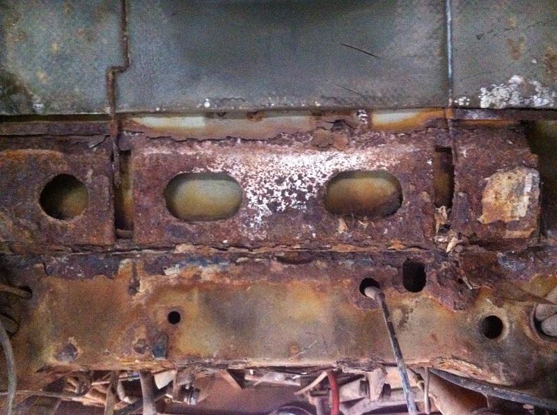

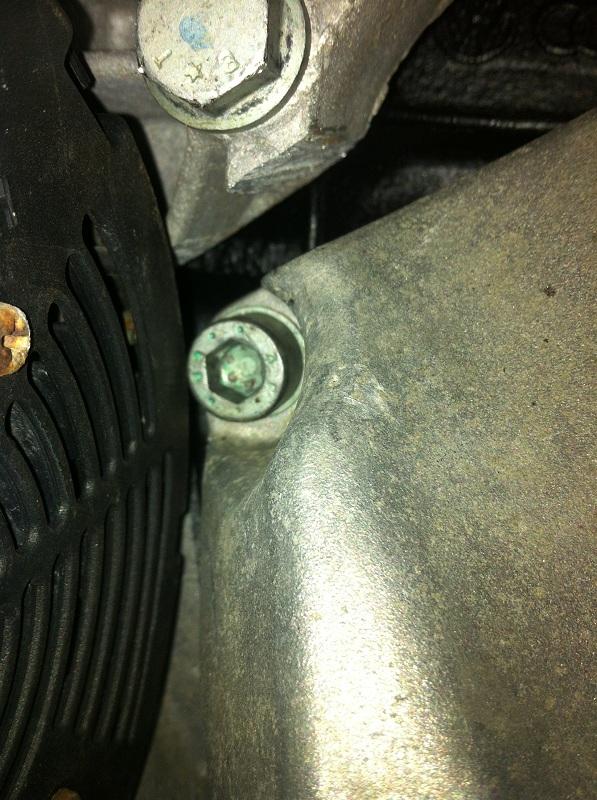

Ok so it's been a couple weeks, I think I would rather forget most of what happened last weekend actually. I got most of it out of my head except this picture will haunt me forever...
I was able to get the one on the right out but the one on the left would not move. Even with some heat it wasn't going anywhere. Add to that I couldn't get one of the housing bolts out of the head (I was NOT going to break one of those off!), and I was not a happy camper. But the thermostat works now (I got 15mpg on my first fill up) and there are no leaks. I did some things I am not proud of to get it to seal and this is the last I will ever speak of it.
I honestly can't remember what I did the rest of last weekend, but I think it involved yard work (finally!).

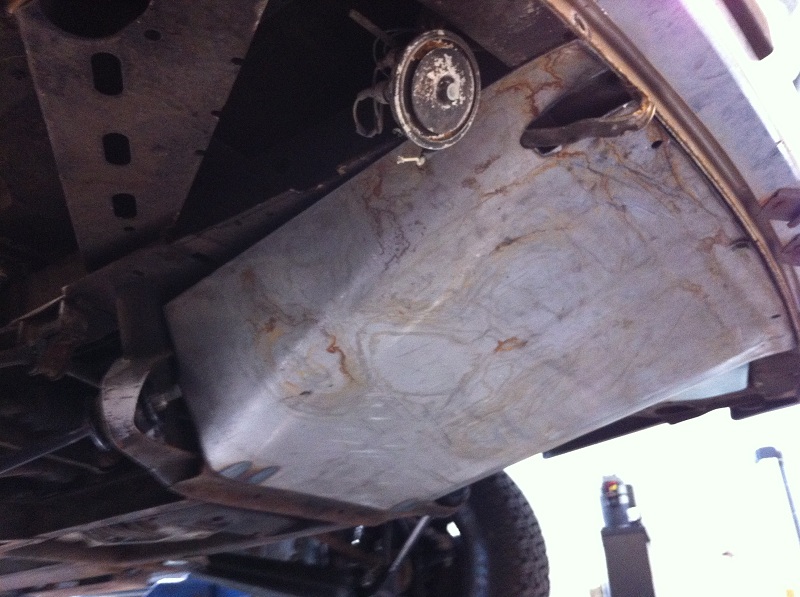

But THIS weekend was a big one! I got my fuel tank secured better (going to get the stainless straps ASAP), my driveline protector back on, new catalytic converter so I can pass emissions, and I got my park brake cables done. Maybe that was last week but all I care about is they are done. I'm missing pics of those though, but they work awesome. Factory cables from a New Beetle or something and just added a small tube to extend the bowden tube and a spacer on the pull rod. I'll get pics. Pretty much I can pull the cable and even if I rev it up in low gear it won't go anywhere. This is on the rear disc brakes too.

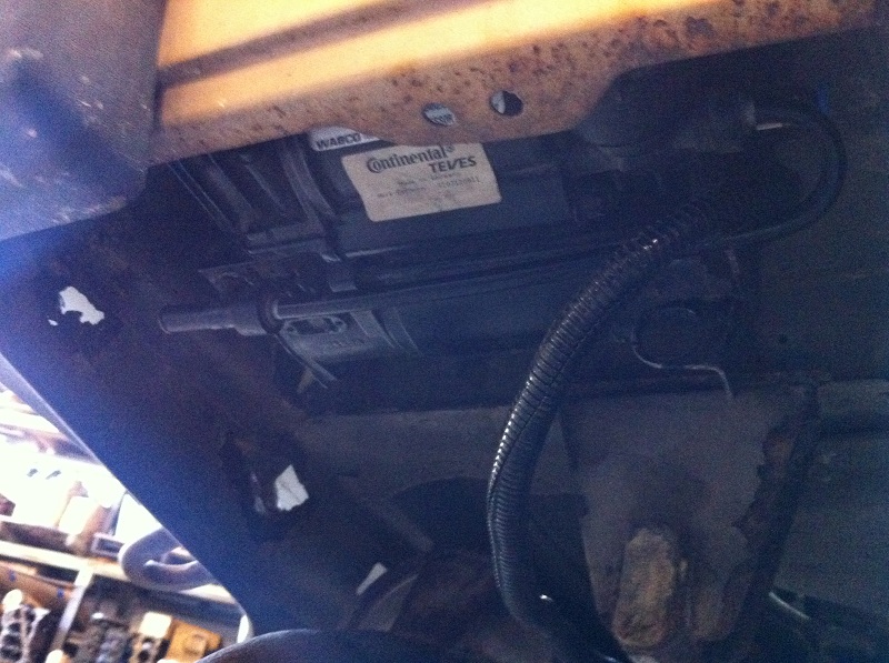

Other fun stuff accomplished this weekend was installation of my air compressor!

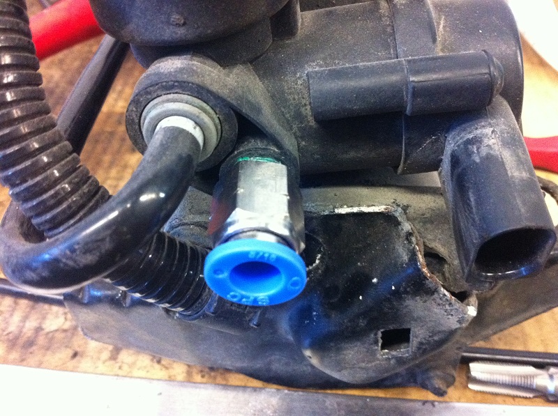

So Allroad compressors often sound like a box of rocks. Turns out they can be disassembled, cleaned and put back together. We have replaced a couple at the shop so I had one laying around.
The stock stuff uses a 10x1 thread with a pretty small hose. Hose and Rubber didn't have anything good to use so I changed it to 1/8NPT.
New 8mm or 5/16? air brake hose fitting.
Installed
I think I am in to all the very nice fittings and hose $70? totally worth it for what it does. I turned it on it's side and found some bosses that could be tapped for 5/16x18 (hardware store didn't have metric rubber bumpers with studs). Drilled three holes in the space in the right rear most corner (up behind the brake light) and used some big fender washers! It's super quiet and wiring is right there at the alternator. It's relayed from the alternator activation wire so it only turns on when the car is running (zero parasitic draw and will always have sufficient current). Also using a circuit breaker instead of a fuse that can reset itself if it blows. I might install a manual switch when I get a second battery. I have two 2.5 gallon freon tanks to be installed in the skid plate and when I build my bumpers, I'll have an outlet on each one. It's behind my license plate for now. It's awesome, now I can let air out of my tires and refill, fill my bike tires easy, pump up a raft? Whatever I want!

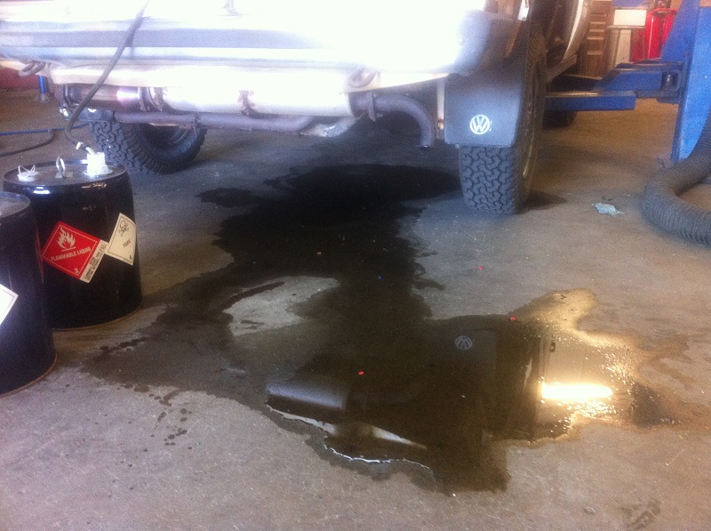

So I had a pretty good Saturday, went to the shop earlyish so I could go home and do some other stuff...

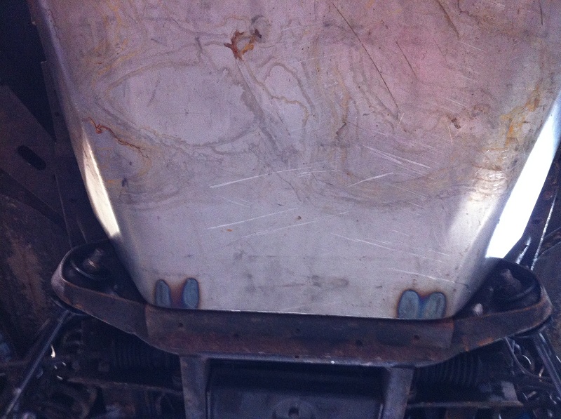

Get to the shop, smells like gasoline... I was REALLY hoping it wasn't my car...
wrong

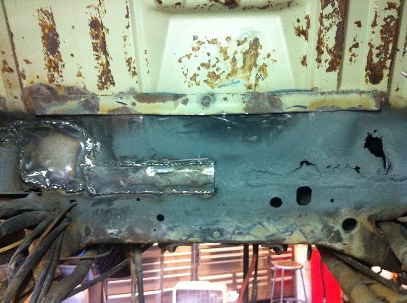

Apparently when I secured my fuel tank better, I moved the fuel inlet to the tank and it leaked all over... Almost 1/8 of a tank over night Sad
Got the fuel inlet out, sandblasted and POR-15'd. It's good now, glad it happened now then in Moab!

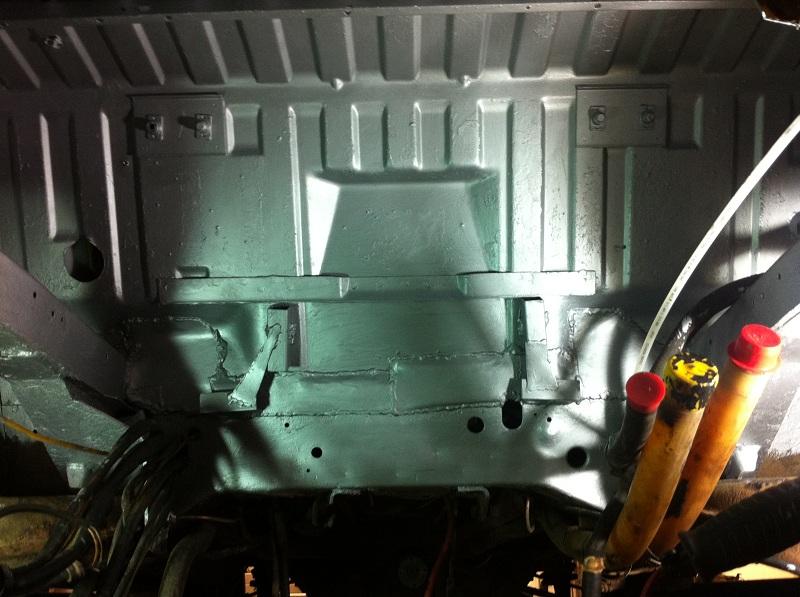

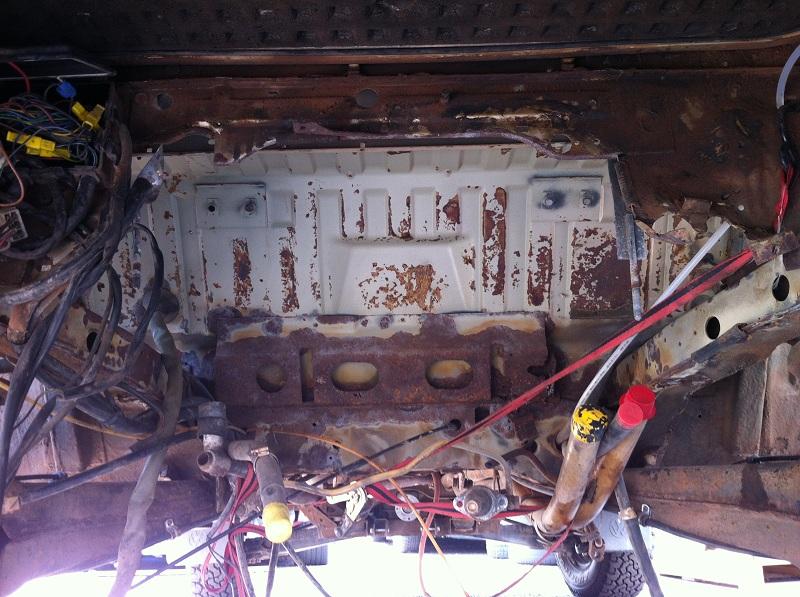

While that was drying, I got to do the REALLY cool stuff!

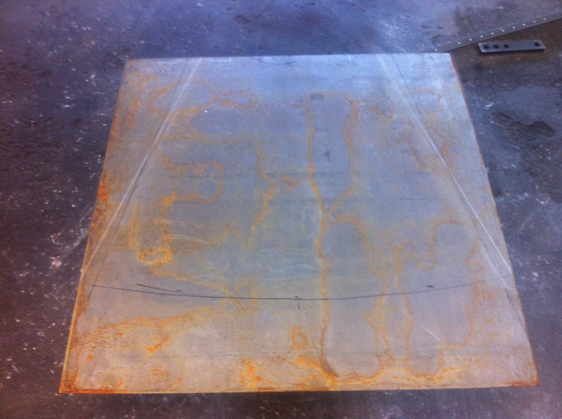

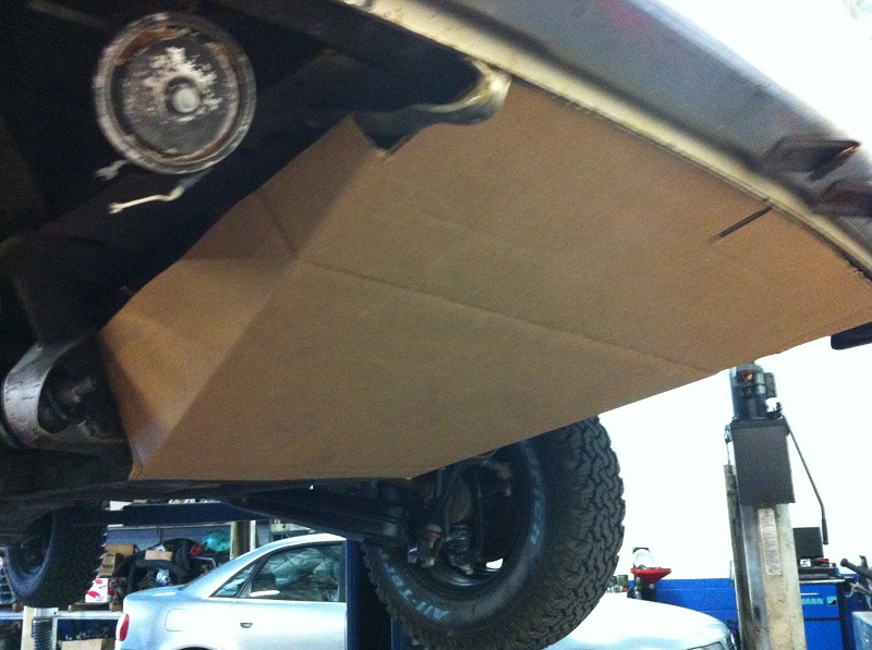

I needed more space where the spare tire goes to hold the air tanks, maybe some spares, and ummm... I really want air horns. Yes, air horns. Google Siberian air horn, it's pretty fantastic. They will be relayed with a 87a circuit so stock horn is always on and then flip a switch and the loudness happens through the stock horn button. Someday...
Cardboard template.
Blank slate, 3'x3' $30 11 gauge (almost 3/16) outdoor steel. Measure twice, cut once. Glad I did too! White lines are the correct ones!!!
What do you do when the brake available can't bend your thick steel? You get creative!
Forklift is plenty strong, container isn't going anywhere.
Plasma cutters are awesome.
After more grinding it fits better!
Welded on some offroad tabs for the hinge
Lots of room!
Installed!!
I have to leave a spot for the factory tow hook until I get my bumpers done.
Super stoked
Still have to finish it but it's on! It will be painted the same black I have been using and likely a sticker/stencil of the locker diagram on the dash. It looks like I can also lower the mounting points up front to make it flush with the pinch weld. I'll have to see when that gets done

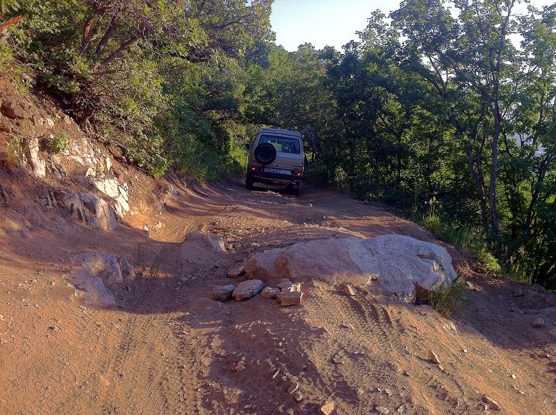

So off on another adventure. Syncro Safari was in a few weeks so I needed to put more miles on the car to try and sort everything out. That trip would effectively double my mileage I have put on the car so far.

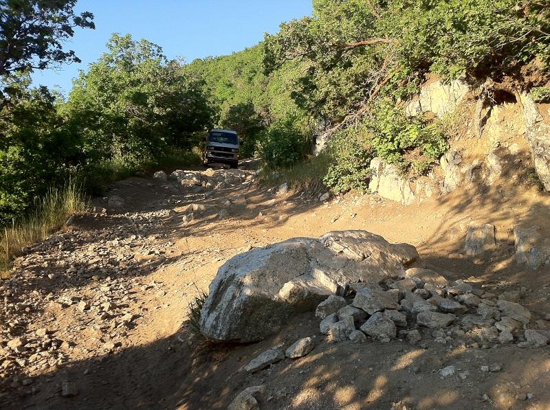

I drove up to Bountiful Utah, there is Skyline drive. Popular with OHV and motorcycles. Found a little road off the side and decided to follow it. Found this big rock in the way.
I had actually tried to back up and turn around, but I ended up going over it.
Doesn't look too bad from this side, I went to the left as you could see from the video.
https://www.thesamba.com/vw/gallery/pix/954465.jpg
Nice view up there too!
https://www.thesamba.com/vw/gallery/pix/954464.jpg
edit: for some reason the above pictures aren't coming through so I have had to link to them
But I didn't get any footage of the really bad parts, my mind was only thinking how to not roll off the side of the mountain! But here is one of the parts I found on youtube of another vehicle going through it.
You can imagine how much my gold brick of a car was moving around in that ditch with the little articulation we have! My front bumper was scraping through the bottom too! Shocked Needless to say, I was slightly frightened...
But not as frightened as I was going to get... Further down the road was a place where motorcycles highmark and get back up on to the road to coast back down. Pretty much they had worn away much of the road. So picture a vanagon with one tire up on the hillside, one off the road slightly. It may not have looked bad, but definitely felt bad tilting like that, looking down at a hundred feet or so of 45* slope!!
Thankfully I made it through! And got some applause from some 4wheeler guys at the bottom. I felt good about not dying or rolling my syncro that day Very Happy

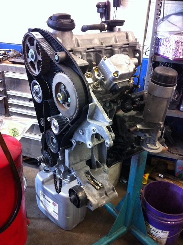

Up next: Syncro Safari and TDI engine conversion parts!!

I LOVE driving in sand and can't wait to get out and do it some more, especially with an engine that actually has some pickup!

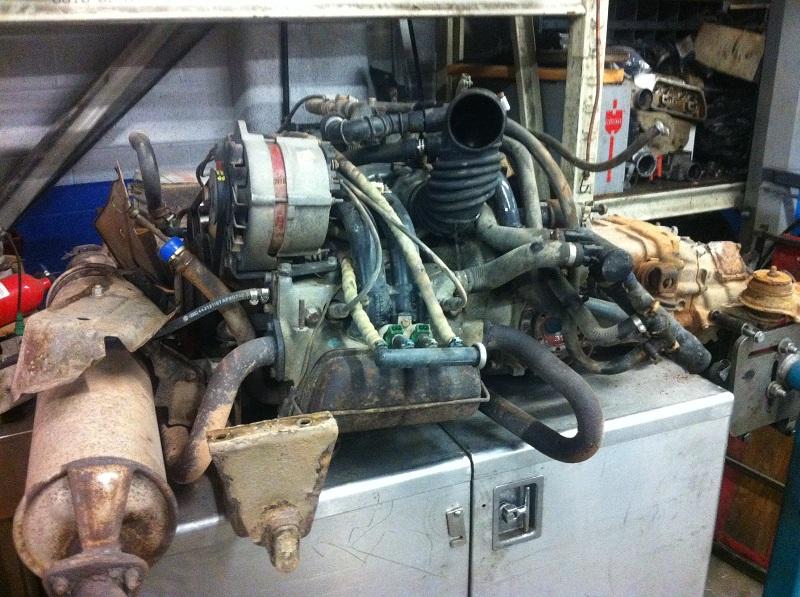

On to the ALH TDI conversion!
I decided when I got back from Syncro Safari, the WBX wasn't cutting it. I had a nagging exhaust gasket blow out every few hundred miles that I was getting tired of cramming JB weld in. I knew if I touched the exhaust to replace it, everything would snowball and I would be removing the heads to drill out the broken off studs in the head. I didn't want to do that.
It's about mid-July at this point. So I started looking around the shop, trying to decide what to do. I eventually wanted to get to a TDI but I have a 2.0L ABA out of a Jetta just sitting there so I was going to put that in, or I could build a 06A 2.0L gas engine and then when I do go TDI, all the mounts will be done.
I started digging and it turned out we had about 70% of the ALH stuff laying around! So I start to gather it up and see what I need.
I got a pretty good pile going and parts would get changed out when I thought more about it, (such as the longitudinal oil pan, I went with the transverse pan as you will see shortly).

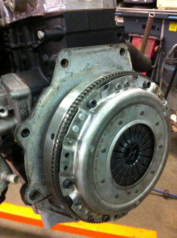

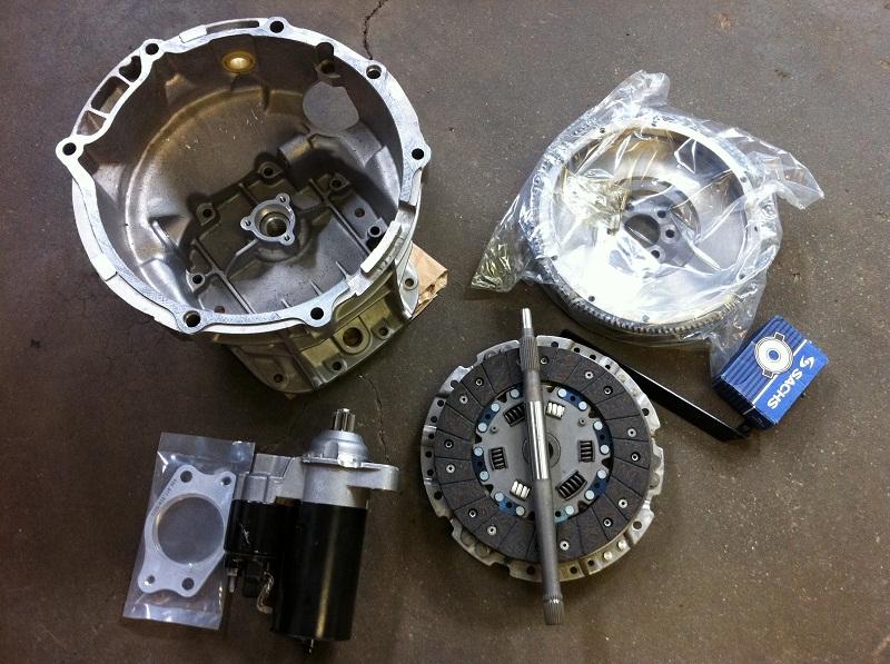

I ordered up the 15* Mexican bell housing from Eurospec Sport
They welded this for the hydraulic clutch
It also comes with a mount for 2wd transmissions but I don't use it.
I also ordered new oversize pistons from them. The ones I had were scuffed kind of bad so I didn't want to use them.
Last view of the WBX, July 31

I get the fuel tank out (falls out?) Passenger side strap is totally broken, drivers side mounting point is missing. Is it bad that this isn't as bad as I thought it was going to be?
After sandblasting with a siphon type blaster, outside on the pavement, in 100* heat...
I can now literally say, I have had sand everywhere. Even with earplugs in, I was still pulling sand out Sad

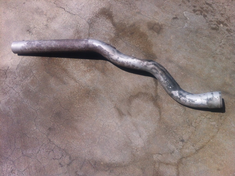

Modified gas filler neck.
Turns out there are two small resistance welds that hold the whole narrow piece in. I just heated it up and tore them out with my impact gun. I measure over 30mm so I should be able to fill even at the large trucker pumps.
I sent my block to me machined for the pistons, each one was very slightly different so I had a specific hole for each piston. He also decked it straight while it was there. My crank was rusty and I was worried it would have to be turned but he blasted it with walnuts? then polished it. It's beautiful.
After getting the crank and pistons back, I sent everything out to get balanced. Turns out one of the fire chiefs in town is the best! I told him what I was doing with it and he spun them up to 5k RPM. Said my optimum RPM range will be 2500 to 3500. Awesome.
He spun and balanced everything in the picture as well as the pressure plate and flywheel.
Started assembly!
Shiny!!
Longblocked, new cam/lifters too!

What did I say about the firewall not being as bad as I thought? Yeah......
Some weldable zinc primer and some patches, just like mending my favorite pair of pants.
I love this tool so much
Now coated in Rustbullet. I only caught the van on fire once welding all that Shocked
3M undercoating
Note to self, even though the can says it dries in one hour, wait longer before you try to stuff the fuel tank back into place...
New stainless steel tank straps plus lots of very thick duct tape on both the tank and straps. I ate my bag of cookies WAY before I had these installed.

I bought the rest of the parts I didn't have at the shop from a seller on TDIclub.
I read about people cutting these ad being afraid of breaking so they take it back out, we'll see what happens here
A few minutes with the sawzall saved me hours of custom mount building
I'm not running A/C or P/S so there is much less weight and strain on the bracket. If it breaks, I'll modify a new one and have it welded and reinforced at the weak points.

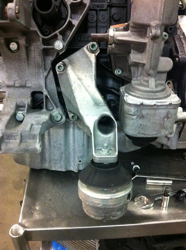

TDI alternator barely clears the 1.8T mount
The ALH never came to the USA in longitudinal format, only transverse so mount building has to be creative! But I wanted it to be bolted in as close to as a factory longitudinal engine as I could. I tried to keep the distance between the mounts the same as well as the angle. I am also using a snub mount on the rear to reduce lift of the engine.
It doubles as an exhaust hanger too Smile
One thing with the Mexican bell housing is the gear reduction starter is so long, it hits the locker actuator! Soooo I ground the bracket for the actuator down, then ground on the starter...
I did open it up to see if I had enough space first!
There actually is some space between there

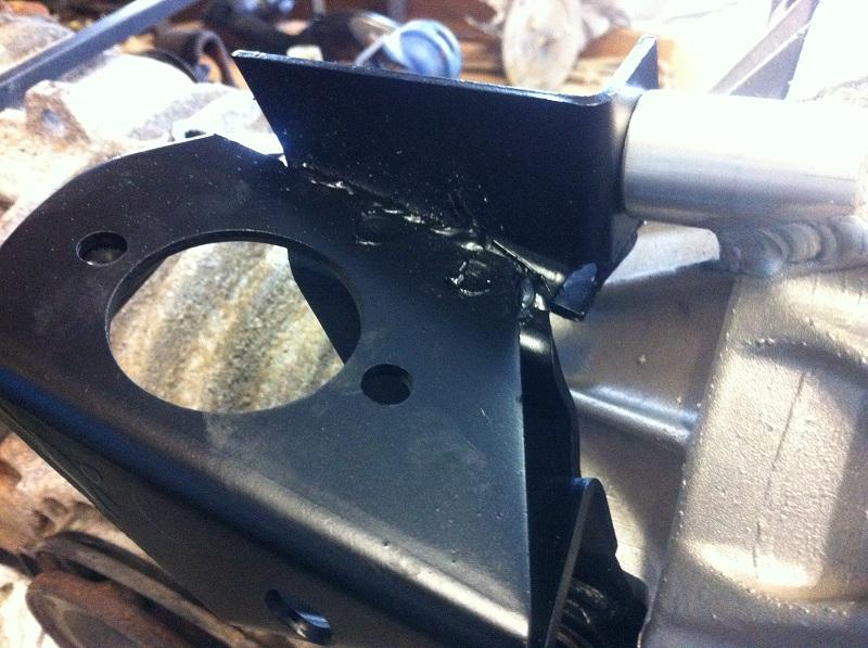

While everything was apart, I decided to proactively make stuff stronger. So I welded up most of the seams on the clutch bracket.
And a Weddle cross shaft bushing (I also welded on the cross shaft where the arms go in)

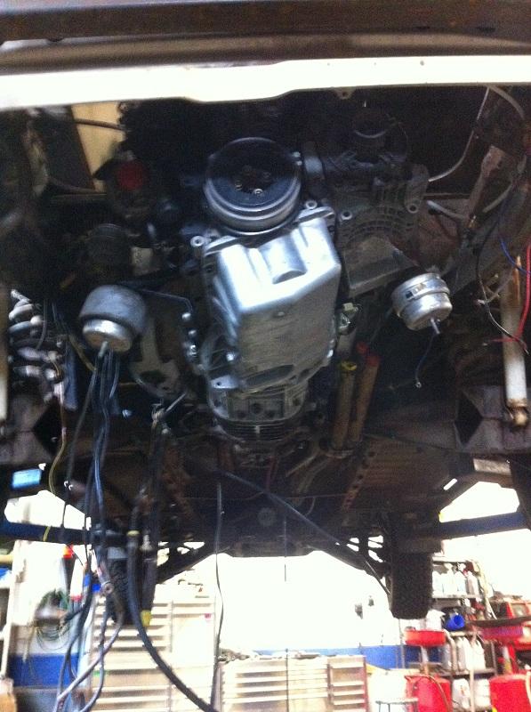

Hey it's hanging in the engine bay!!
Drivers side engine bracket
And I'll be switching to the late style turbo oil return pipe when I find one.
View of the oil pickup tube
The Mexican 15* bell housing is actually slightly more than that. I had to bend the pickup a little to be correct.
Bending some DOM tubing (that was part of a botched roll cage install) for the engine carrier.
I decided on the transverse oil pan because a steel version of this pan is available.
Also because it wasn't too difficult to get away from the cross member people use.
Engine subframe
Note the female portion of the snub mount on the back. The mount plates also got gussets underneath them. It turns out I might be able to mount my rear limiting straps to the most forward brackets of the subframe!
Now I was resisting this as much as I possibly could, but things were settling well with me. I could have fit the engine under the lid, but there were some problems with that.
First of all when I looked at all the crank bolts of stock engined syncros, they were all nearly level with the lower rear louvers on the body. With the TDI fitting under the lid, I was far below that point, almost 4 inches! That also meant I had 4" less ground clearance and my driveline angles weren't correct! Shocked
So I began pushing up the engine until the crank bolt was in the correct spot and my driveline angles matched front and rear. This is where it ends up...
My engine cover was damaged anyway so I cut it in half to play with it. I really didn't want it to go this high, but it must be correct. Besides, I can deal with this issue much easier than losing significant ground clearance!! It will get some sort of fiberglass bubble as soon as I learn how to glass Confused I can also still shave some stuff down to reduce the footprint of the bubble, but it's still going to be there.
This stuff is called Firejacket. Google it for the specs.

Finally gave it some life blood
This has been my view for nearly 2 months...

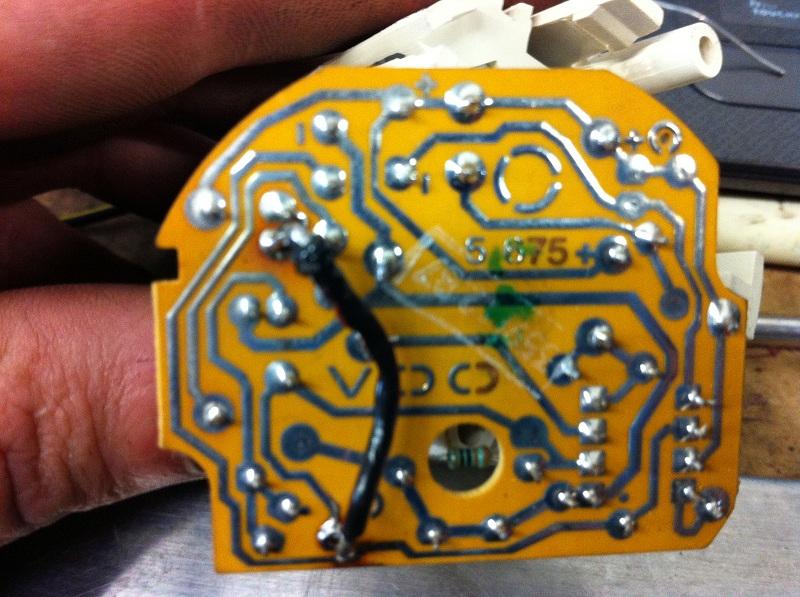

And last but certainly not least, modifications to the tach for the ECU signal
This one is mine:
After TONS of searching and not finding anything, somehow I came upon this post: http://www.brick-yard.co.uk/forum/lt-24-petrol-eng...tml#527970 mind=blown...
Now when I opened up the 1988 tach that was laying around, I noticed it was a bit different. Same basic layout, but the capacitor he had originally as a 0.047, I have as a 0.22. So I'm leaving it for now, at least until the engine runs and I can check it out against what the computer reads in VDCS. I did happen to buy a 0.47 capacitor that exactly like what is stock in my tach, but I'll see if I need it.
So that's it for now. I just keep on picking at the wiring until I hear back from Kerma in Tooele about deleting my IMMO3 issue. I do have a cable on the way from China that I might be able to use to pull the .bin file off the ECU, but I'm not holding my breath it's going to work.
