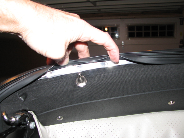

Hi everyone,
Could someone post a photo of late model convertible with the external front header bow seal installed? Thanks in advance!

I've only installed one top, and this is just how I did mine. Also, I've never seen official instructions for installing one of these seals so it may not be correct. It's not very elegant looking, but it definitely keeps the wind and rain out at highway speeds.
HTH. Charley

Charley
That's perfect thank you! I hadn't realized that a bar went in the middle. It looks like you did a nice job on the install -- hope mine comes out as nice.

You're entirely welcome. If you search this forum you should come across an interesting discussion about the external vs hidden seal that includes comments from a couple of pros, Ghiaddict and Aussie Trimmer. IIRC there was also mention of the metal backing strip; you might want to check with Mike at House of Ghia. This seal was included with the top I bought from Chuck's Convertible Tops, and although the instructions didn't include specific pictures on installing this seal, Chuck was very helpful in getting me on the right track. I fabricated the aluminum strip in three pieces, two short end pieces and a long one in the middle. I honestly think using the hidden seal that glues directly to the wood bow results in a better appearance, but I didn't have confidence in my skills to pull it off properly.

Would you happen to recall the dimensions of the aluminum bar you used? I'm looking to do the same job, and was guessing about 1/8" thick by 1/4" or 5/8" wide?

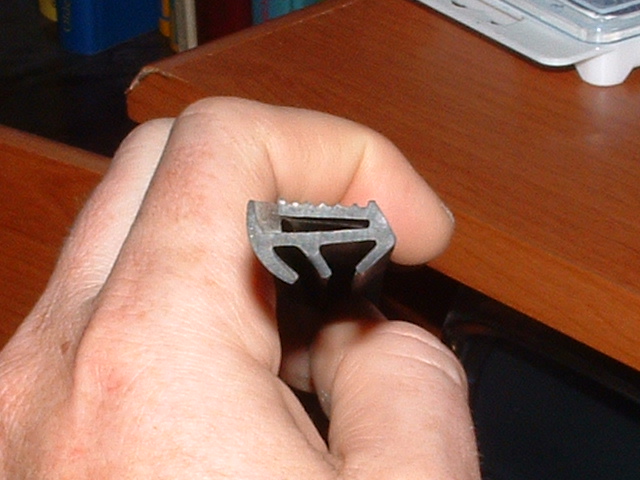

The Al strips I used were about 1/2" wide x 3/32" thick.
Disc wrote:
I'm 100% sure this is not correct way to install that seal.
LOL, there's little "correct" about my cabriolet. Here are pictures of the replacement (borrowed pic) and original header bow (my own) seals. I've observed that the replacement seal is effective when in direct contact with the windshield frame.
See also: http://www.thesamba.com/vw/forum/viewtopic.php?t=214389
Charley
Ghiaddict
Joined: November 20, 2002
Posts: 2632
Location: Now in Honea Path, SC
Ghiaddict is offline
PostPosted: Wed Nov 28, 2012 9:17 am    Post subject: Reply with quote
I'm sorry but I have to disagree with Disc.
We also restored a very low mileage late model KG 'vert
that I'm 100% sure still had the original vinyl top intact
The rubber header seal with metal support strips was installed
exactly as pictured by crocteau. That is we found it
completely exposed on the exterior of the header, on top of the vinyl.
Not sure if it really matters, but there it is for your consideration. Wink
