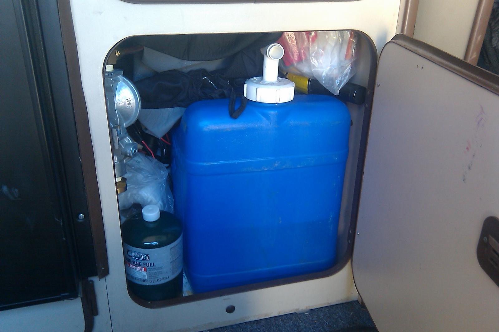

Blue Bay Bus I thought about this a lot. Decided to take it out. Put in a TF49 only had a stove to deal with. So went with a 1LB propane bottle in sink cabinet works well . In Moab I would of bashed the old tank, glad I did this! Now my side rock bars will protect both sides, now that the tank is gone.

the gas tank on the bottom of the van only exists on a 2wd, which generally don't get offroaded to the same extreme as a syncro. The syncro tank is tucked away nicely!
I removed the tank when I did my westy swap and also used 1lb cylinders. I like them. They last a long time.
