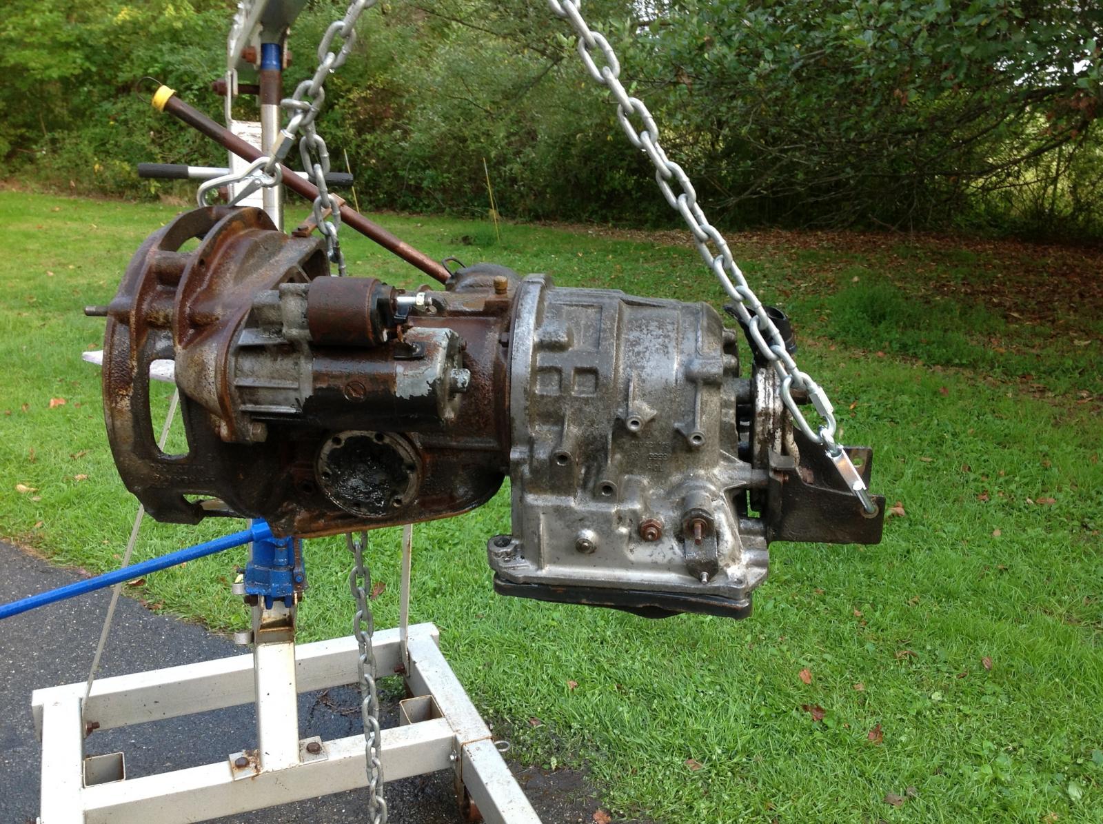

The exhaust has been removed and the heads off!
The exhaust was in terrible shape. The pipes themsevles were thick and the rear pipe even had great flanges at the heads but was rotted at the collector. Odd.
Here is an example of the odd failure of this exhaust.
I got everything off except one stud was broken off in the head. : /
I finally got it out by welding a nut to the end of it and then heating it up thoroughly and pulling it out. I think the threads came with it, but a thread insert should be fine.
The heads look to be in very good shape. No pitting, no cracks between valves, and the valves hold laquor thinner well. All Pushrods are straight.
I hope to just clean things up and slap it back together.
The transmission is looking sharp as well. Every auto trans i've ever seen has had big rust issues, so I've chosen to clean this baby up and coat it to prevent some further corrosion. I spent some time brushing it with simple green and it's looking okay.
I then proceeded to brush the cast iron portion with SEM Rust mort effectively neutralizing the rust and building a good base for the coating I will give it. The game plan is to blast the whole assembly (including the aluminum portion) with a high zinc primer and then a coat of flat black paint.
I'm not so sure I like the decision to go flat black, but we shall see.
Even if it flakes off in a year, the portions covered will be protected. Thats what matters in this climate!~
The crap on our roads in the winter will eat any exposed metal in short order.

djkeev
Joined: September 30, 2007
Posts: 32987
djkeev is offline
PostPosted: Fri Sep 20, 2013 9:41 am    Post subject: Reply with quote
Dang Phishman! We are in the same climate with the same rust / corrosion issues doing the same job!
You however are a few jumps ahead of me and moving quicker! Smile
From what I've read, I'd take the time to split the axle differential from the transmission and replace the two seals in there.
Apparently they go bad and allow the two different oils to mix resulting in nothing good! Shocked
You are this far along..... It would be a shame to not do it.
From all reports these automatics are tougher than the stick shift units IF properly cared for.
Can you believe everything GoWesty says? I don't know, but they've seen more of these units than I ever will! ............. I'm going to replace these seals in mine! Wink
I'm also giving serious thought to using Van Cafe's fin transmission oil cooler and eliminate a few hoses...... Simplify. I'm also going to put in a new engine oil cooler as well.
A good read.........
http://www.gowesty.com/library_article.php?id=305
