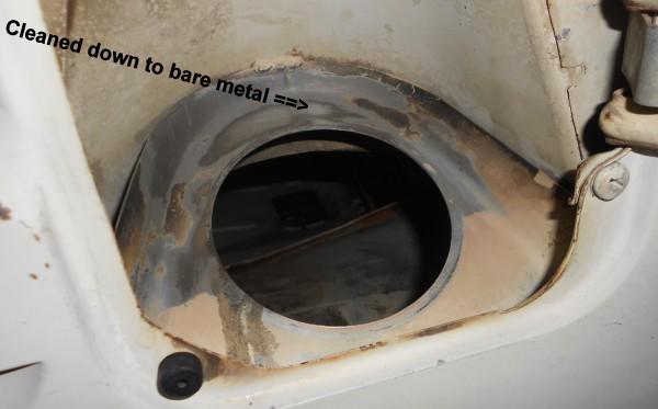

Well, in order to see what was really going on, and to decide whether I needed (or just simply wanted) to replace any parts, I went ahead and removed the fuel tank today.
The gas fume problem, I have decided, was coming from one of two places (or both).
1) When the tank is very full, or too full, and the gas overflows out of the cap due to expanding in heat, or if the car is at an angle, allowing for overflow out of the vented gas cap, then gas would then dribble onto, and possibly through the "Fuel Tank Filler Neck Seal" (which is old), and the gas would then run into the engine compartment (instead of down out the overflow tube which just puts it out on the ground). Since the gas would then be collecting in the engine compartment, it would take longer to evaporate, and thus smell for a longer/more continual amount of time.
2) It appears that there might be a leak in the tank where the neck meets the tank, and since that is a high point on the tank, it only became very noticeable when the tank was very full.
The tank is out, and I don't need to drive my bus to get to work, so I think I'm going to go ahead and buy a new tank.
Have no idea what the old one is worth to someone, but after I have put in the a new tank (give me a couple weeks), if someone wants to make an offer on the old one, and can pick it up in the Bay Area of California, then I'd be willing to sell it, or take a trade of something for it. It would be without the sending unit, and if the new tank doesn't come with the bottom spigot, then it won't have that either.
Since I had time, I also started to try to remove the 45+ years of dirt and crud from the engine compartment since the motor and tank are out of the way.
Any favorite/best products or solutions for doing this? Right now it's just me, soapy water, some Simple Green and a rag I have to keep rinsing out. ...although the work is tedious, I have got to say that as spots of pristine paint are revealed, having been preserved by oil and grime, it's pretty satisfying.

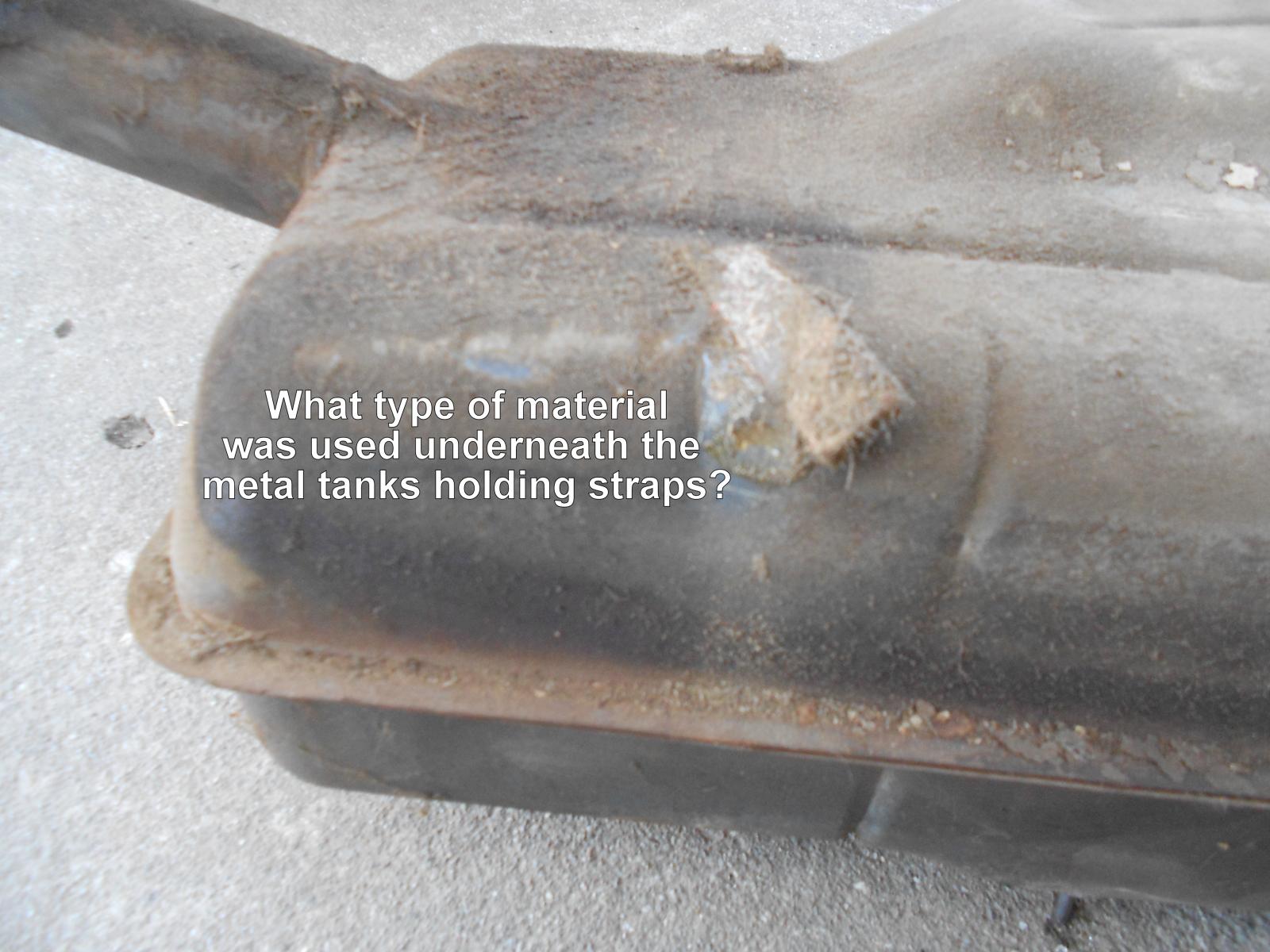

There's s swatch of material underneath each corner of the Gas Tank Metal straps. Anyone know what this material is, and what I should use with the new tank to replace that?

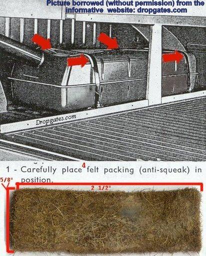

1) "Felt" between the gas tank holding straps and the tank. What have folks used for these? at W.W. it was suggested (by phone), than unless doing a 100% refurb., some simple rubber would work fine. Should I just cut up one of those flat rubber bungee cords for that?

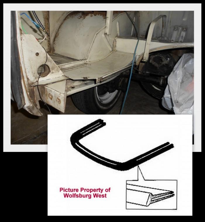

2) Glue for hatch (lid seal) rubber replacement. ~ I'll be replacing the lid seal's rubber which surrounds the engine compartment. Do folks have favorite/best adhesive for this? From another unrelated thread:
Major Woody wrote:
The seals are glued in with "gorilla snot" or 3M yellow weatherstrip adhesive which any good FLAPS should sell. It comes in a toothpaste tube.

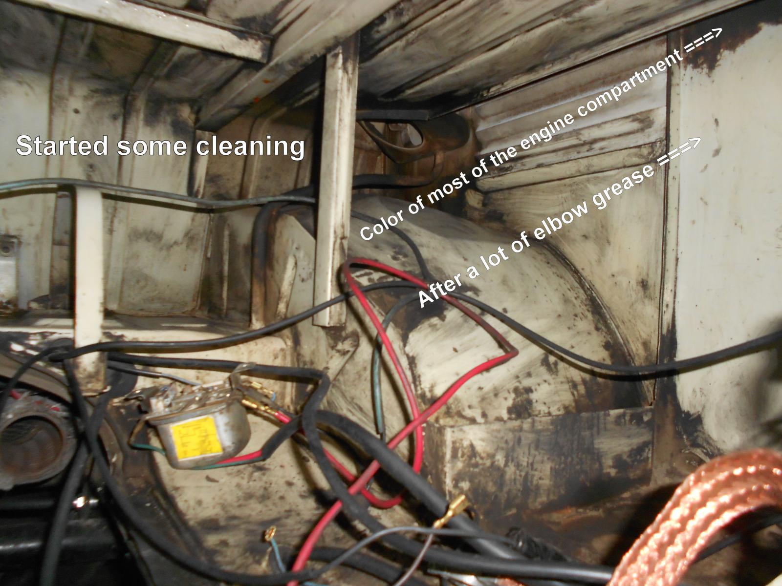

3) I'm still trying to clean the caked-on grime out the engine compartment. It's slow going. I bought some of that purple stuff and spot tested it. It does manage to strip original paint, so I won't be using it. Honestly I have simply been putting gasoline on a rag, and cleaning with that (with protective gloves and goggles). Is there a better way? The engine's out, so it has to be something I can do from/at home. Suggestions?
Thanks everyone.
did you already try the good ole pressure washer?

I used rocker cover gaskets. They are too thick really. Bungee would be to. You could use some inner tube rubber or synthetic felt. I would like to know what is good also.

Stores like Orchard Supply sell felt waether stripping for doors come on a roll and work great for the tank straps.
You can dilute the purple degreaser but it works the best. wearing gloves, spray it on a small area at a time and rub the area with a sponge and then rinse with water.
I use the same 3M sealant Major Woody mentioned. It works great. Wear gloves.

(3) For speedier cleaning I think I'll try a combination...
Although I don't have a pressure washer, I do have a garden hose that I can hook up to a hot water faucet, and it has a pretty good nozzle on it.
Found this thread too "Best way to clean a motor?"
http://www.thesamba.com/vw/forum/viewtopic.php?t=475553
...so I'll cover/wrap everything I don't want getting wet (like the transmission, and remaining wires in the compartment) and then see if the hot water (and a brush/sponge) helps loosen things up and then, as per Crofty's suggestion, use some diluted purple stuff a little at a time, clean, rinse, dry.
(1) Will go to Orchard for the felt weather stripping...
(2) ... and Orchard or an auto parts store for the "3M yellow weatherstrip adhesive"

I'm sure most DIY home improvement stores carry the felt
http://www.amazon.com/Frost-S214-17H-Weather-Strip-16-Inch/dp/B000EU42MS
I don't think you'll find the adhesive at Orchard.

...and some progress on cleaning out the engine compartment.
Using the hose with hot water out in the driveway helped loosen stuff a bit more,
am/was still using some gasoline for the hardest to clean areas, but it's getting down to Simple Green in detailed areas now:
Now some questions.
Below you see that by using gas, and a scrubber sponge (green scrubber side of of a sponge), I have managed to create some spots of bare metal:
Question 1: Am I going to need/want to spray paint this before putting the new tank and filler neck gasket in?
If yes, does someone know the product name/description of some simple Krylon spray paint (and color) that I should use?

About engine seals...
Please see the picture above.
My old seals were/had been cut at the corner(s) of where the seal meets the rear apron.
Question 2: Is that common? Cutting the seal at the corners for ease?
If the answer is no, then how easy/difficult is it to take the apron on or off if the seal is to remain as a big "U"?
Is there a trick (installing, as well as maintaining the "U" when I remove the apron)?
Question 3: The engine to body seals are all made to have a flap or "groove" between a top and bottom flap (see WW's detail view in the picture above).
Should the bottom half go below the engine tin, and the top half above? Or do they both go below...? I honestly do not know.
Thanks in advance for your kind answers to my admittedly simple (minded) questions.

Dadacheese, great thread man!
Have you ever seen the profile of an og engine seal? The Wolfsburg west ones by comparison is sooooo junk!
Thank you for sharing!
Jerry,
No, I haven't. The WW ones is what I have currently to put in this weekend... do you, or other folks have additional advice of better (closer to Original German) rubber for the engine compartment?
...and I hope some folks can chime to too on the questions I have on my post above.
