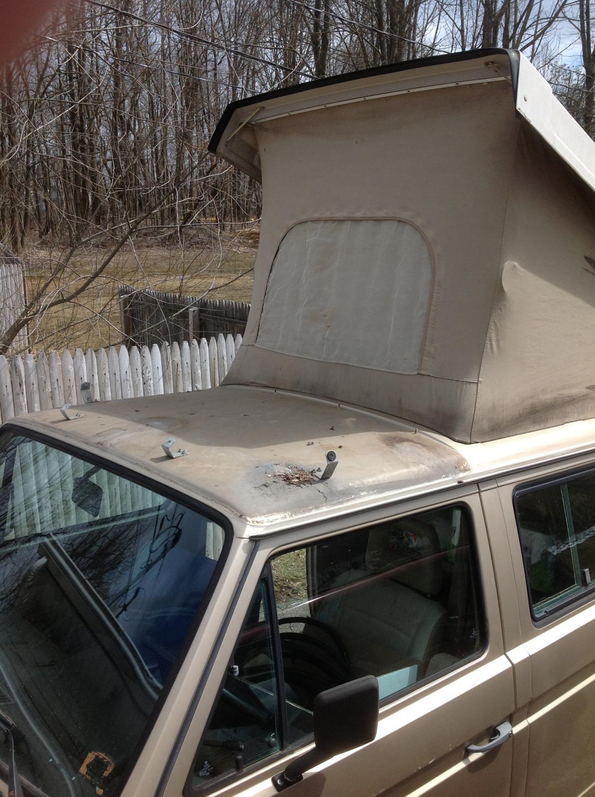

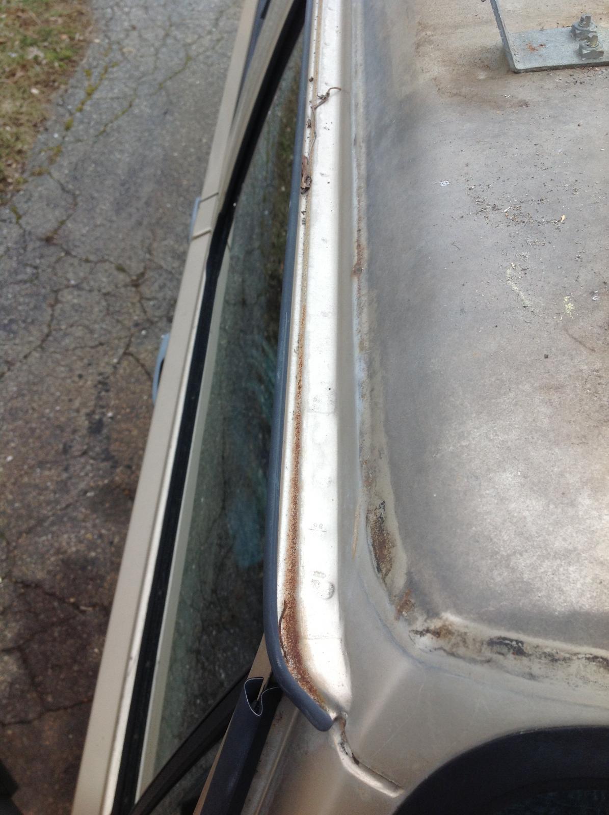

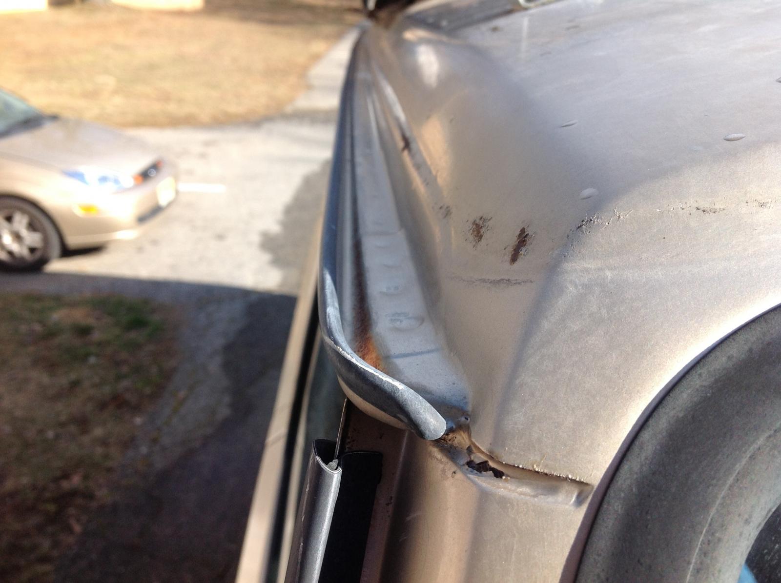

Repairing / repainting the Pop Top......
As an easier to do and handle first piece I removed the front luggage box.
It came off easy, 4 rusty screws and 4 10mm nuts. Took all of maybe 10 minutes.
Under the box it wasn't too bad. A little debris and a LOT of wasp nest! I think that The photos show 27 years of debris.
Considering how easy it is to remove the luggage box, I'm thinking it would be easy enough to make it a yearly maintenance item. 1/2 hour to remove, clean, wax and reinstall?

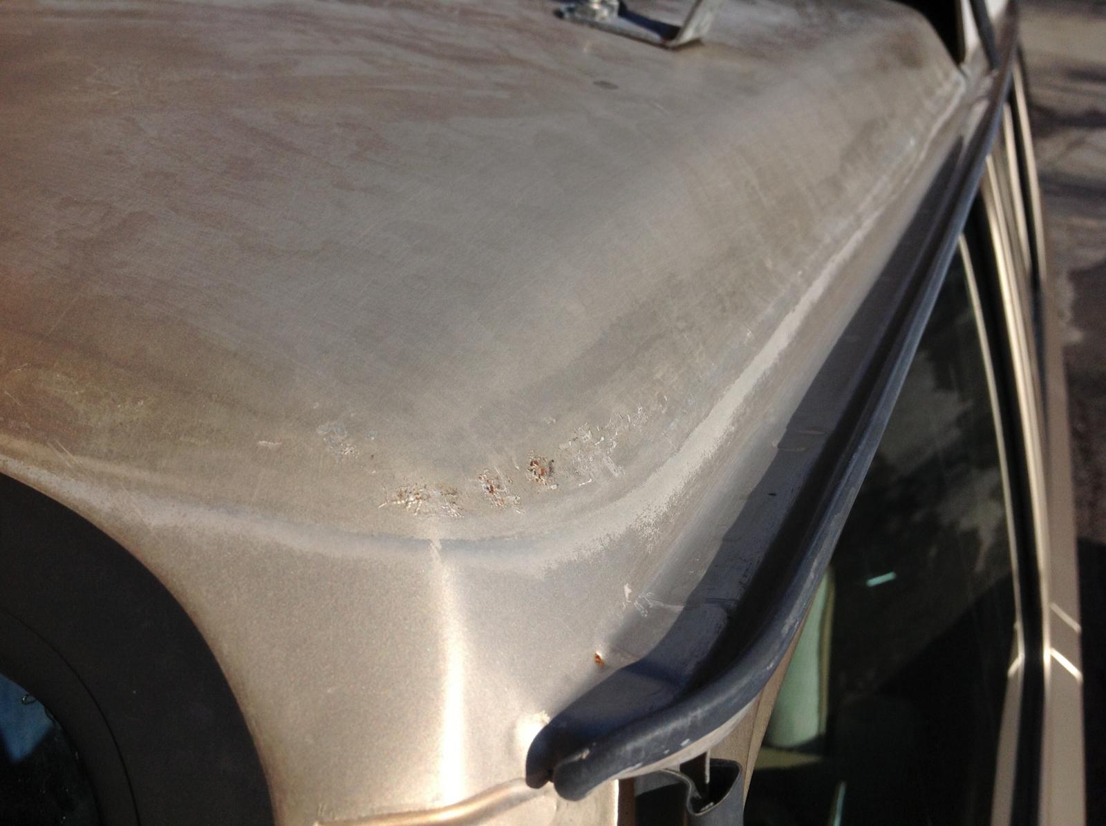

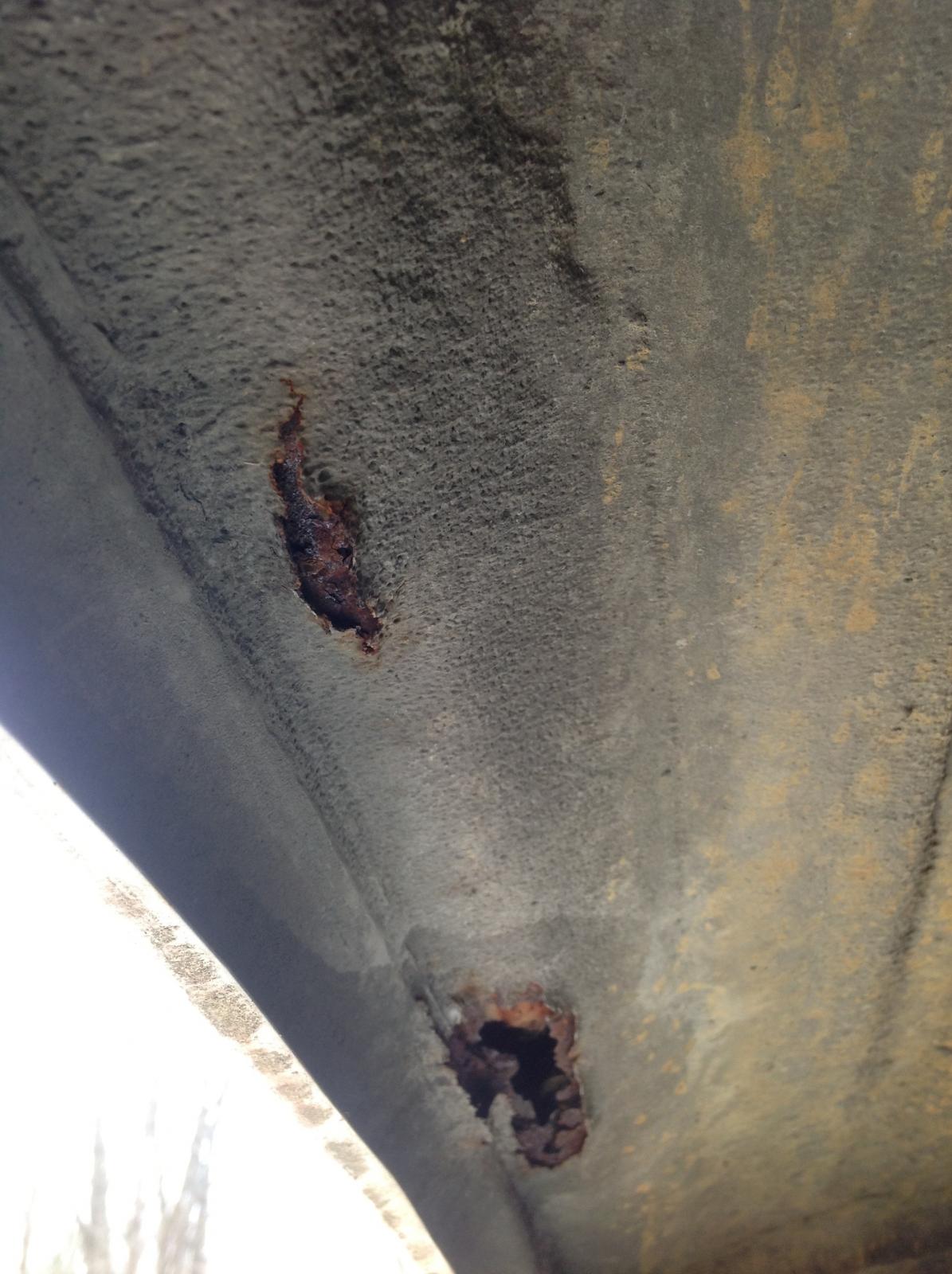

The worst discovery was some rust along the inner rain gutter, not bad......but still it's rust! Also without the seal to the body the fiberglass rubbed the paint off in spots which is now rusty!
(Right side rain gutter rust and luggage carrier rub rust.)
I figure I'll sand and wire brush off the rust, apply some rust treatment and then simply brush on some color. I've a can of Single Stage already mixed, it's all up in the rain gutter where no one will ever see that it's not perfect!
Better to have an "ugly" rust repair that it then to ignore it and Rust continue unabated!

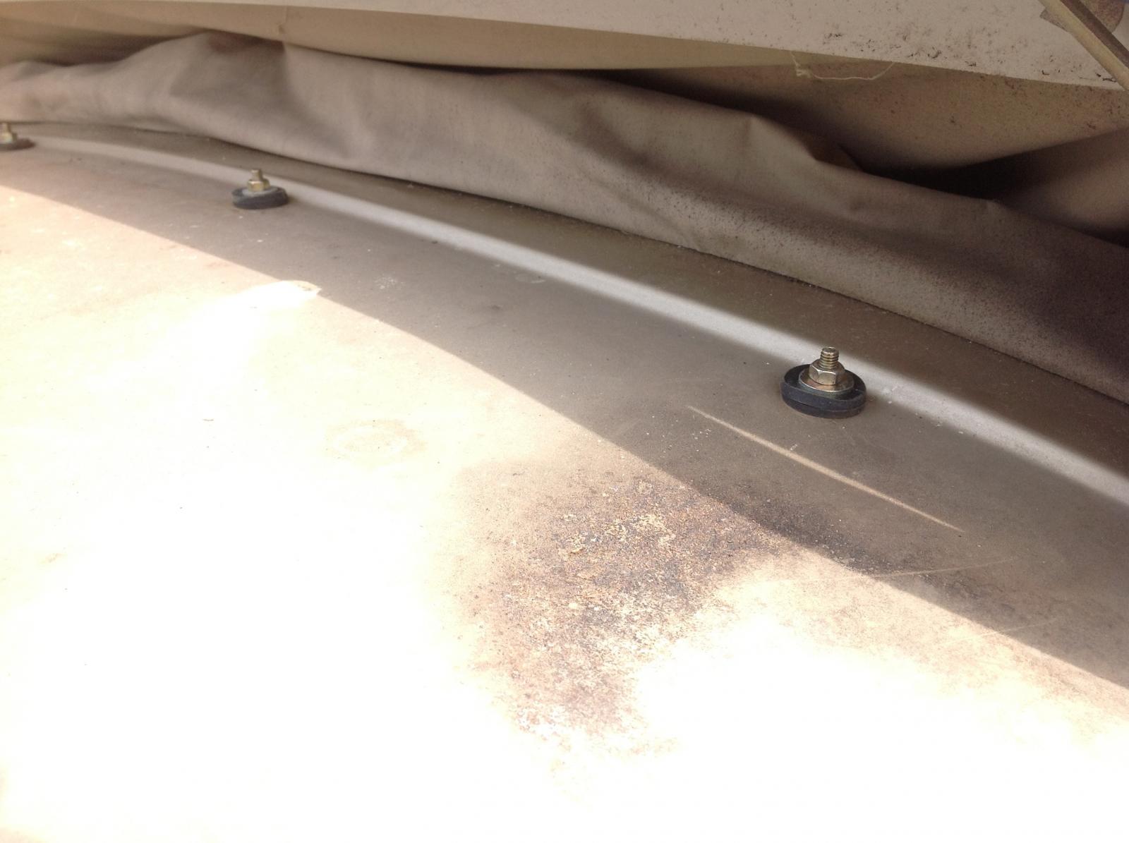

See the pictures of the underside of the luggage carrier? The edges where the seal goes are all rusty from the seal retainer and from rubbing on the roof without the rubber seal.
I guess the lesson to be learned here is if you are missing the seal to the body.....go get one and install it! The absence of a seal WILL cause damage!
(Photo of right side of pop top, notice the rust where it has rubbed for years without a seal)
There are two types of foam applied to the inside of the top, I presume for rubbing and rattling/squeaking prevention.
The Small black squares at each rear corner of the top and two larger white pads towards the rear. The white ones near the rear appear to have done nothing, no contact marks, the small black ones have obvious contact points visible. You can see the two small "clean" spots in the dirt on the roof.

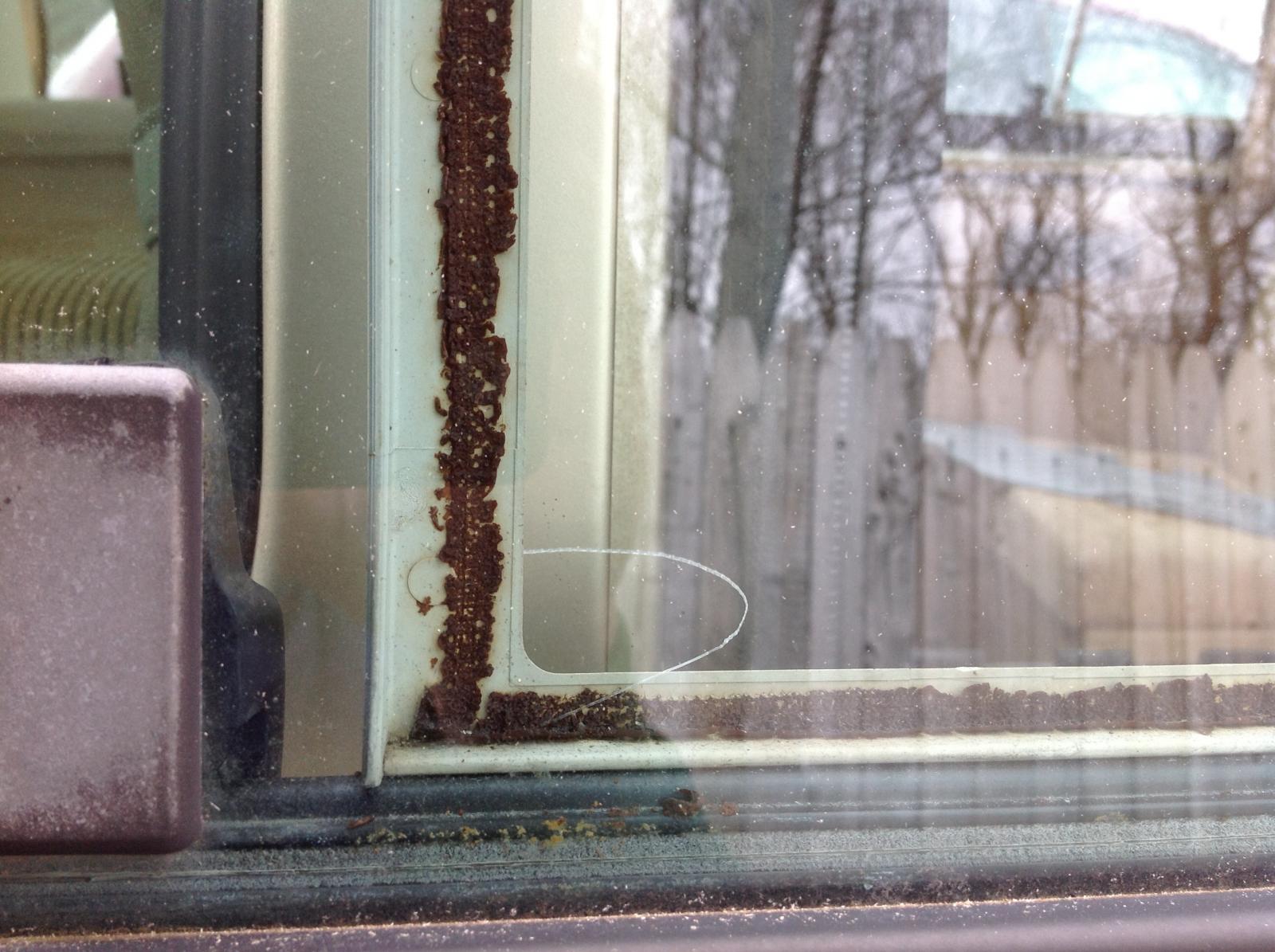

The photo below is looking into the sliding door glass. There is a plastic Frame that snaps over the sliding window that I assume one day had a screen in it.
What you see now is the brown residue of an adhesive?
The "hair" you see is a fiberglass strand from what was once a screen.
Can anyone help identify how this was originally?
Was it simply screen glued to the plastic?
Dave
Yep. fixed mine with dark colored aluminum screen material - hot glued
to the original plastic frame. Five years now & solid as new.
Careful removing the frame from the window. The friction tabs tend to break
and replacement frames are about $40 (complete w/screens are $70).

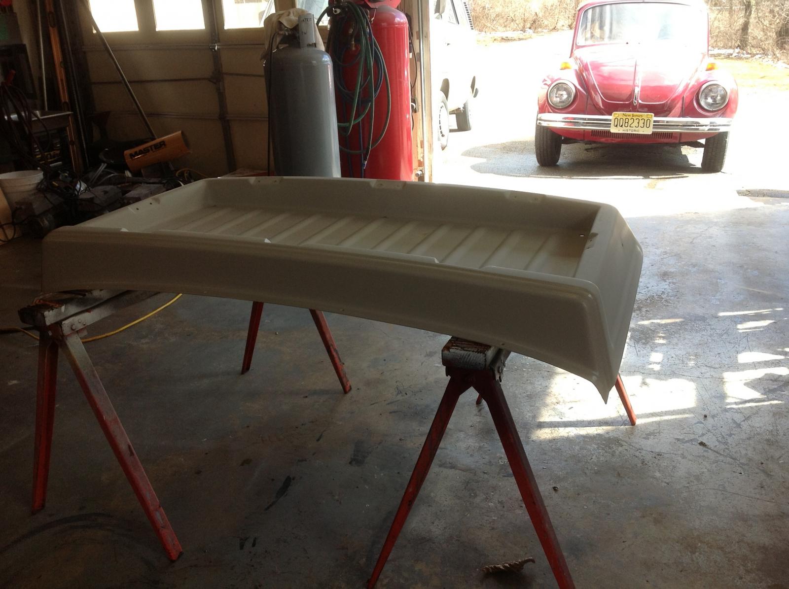

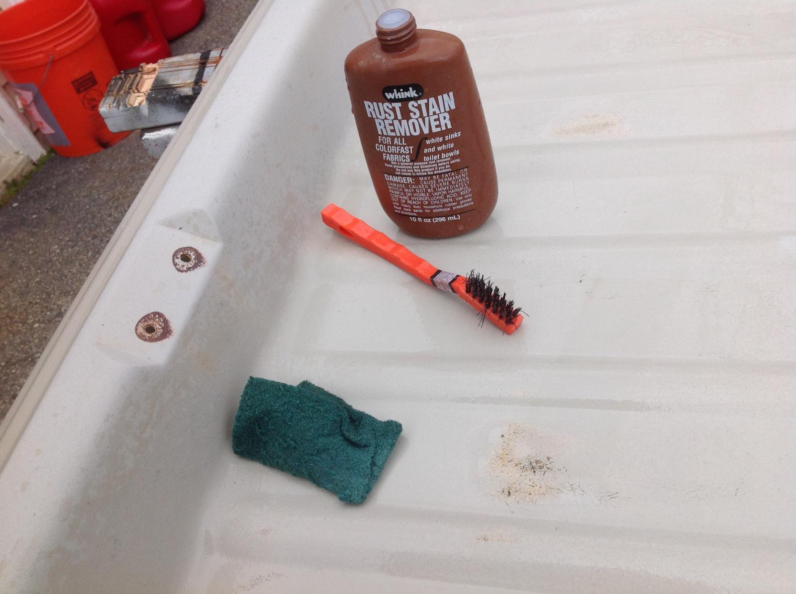

Painting the POP TOP part "A".......
The luggage rack.

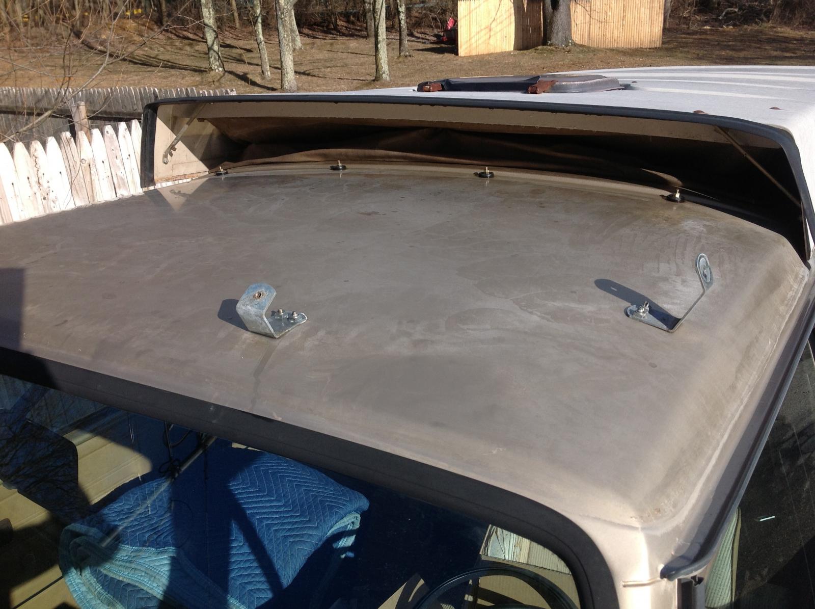

I removed the rusty FOOT MAN LOOPS which wasn't hard, several simply came off when I nudged them!
The rest I drilled out the top of the pop rivet and knocked the loop off. I then pushed each headless rivet out the back side.
Left behind were horrible rust stains!
My wife has a rust remover agent for clothing........hmmmmmm............. Clothing.....fiberglass.... Eh! What's the difference?! I tried it and it worked.
I also used a stiff miniature wire brush and a green 3M scotch brite pad.
The rust is gone!
Now I scrubbed the entire top with Simple Green and the 3M pad.
Rinsed well, several times with HOT water.
It now sits in the garage with heat on drying off and warming up. (Yes I closed the door)
I do hope the new WESTFALIA decals are the same size as the originals for I've got an unweathered shadow left behind, clearly seen in the right light.
You can also feel them, they stand proud of the old surface.

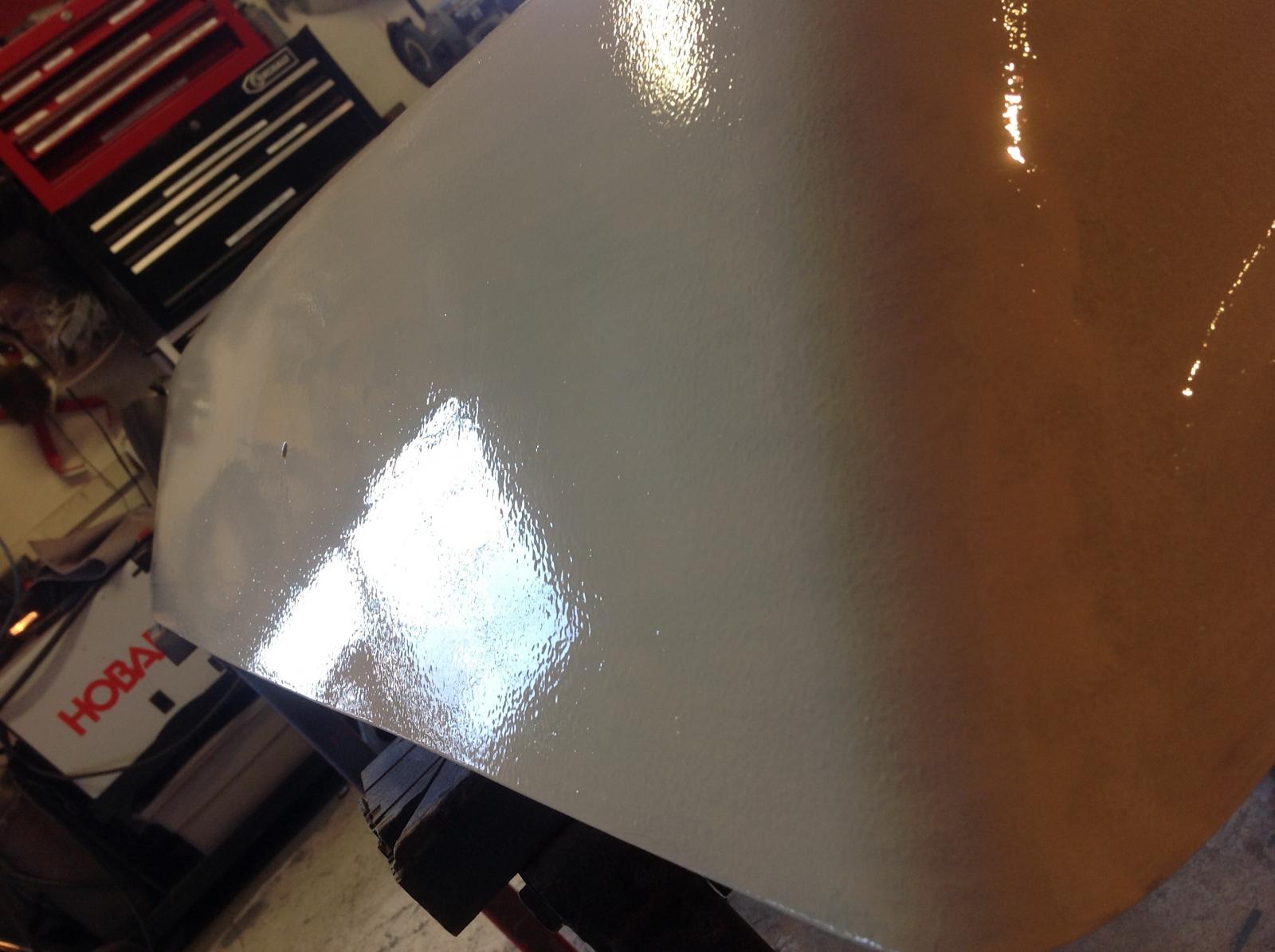

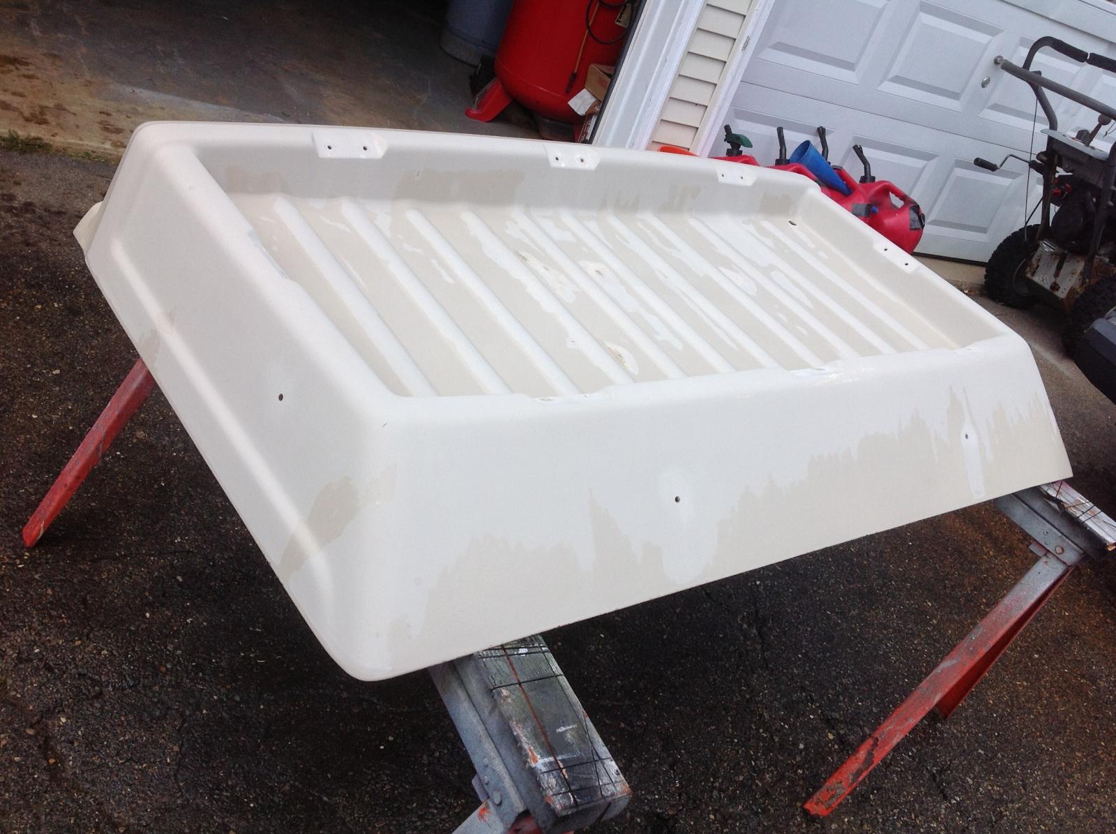

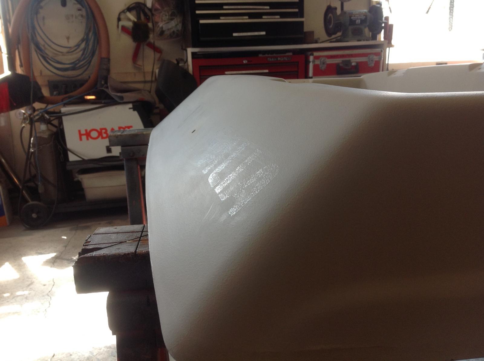

I sanded the top well with 180 grit after it dried, blew off the dust, tack ragged I and then used a de-waxed/de-greaser before painting.
First coat of Interlux Brightside is on.
I took this photo because with the eye you can see letters for the WESTFALIA sticker, with the camera.........not so much!
Weird stuff this Brightside. I'm brushing it on, it covers poorly and leaves streaky brush marks behind. I found that I tend to get a lot of tiny bubbles In the paint as you brush. (key song here)
http://www.elyrics.net/read/c/connie-francis-lyrics/tiny-bubbles-lyrics.html
As I progressed I kept going back and brushing over again brushing out the bubbles.
I found that it is Very important to keep a wet edge which isn't easy!
Also, The brush marks melt away after a few minutes which I'm pleased about.
All in all I'm happy with coat one. I'm anxious to check out the color my wife chose against the paint.........I trust her but this time I'm wondering..........
Instructions say to apply three coats sanding with 320 between each coat. With a MINIMUM of 8 hours drying before sanding..... Shocked

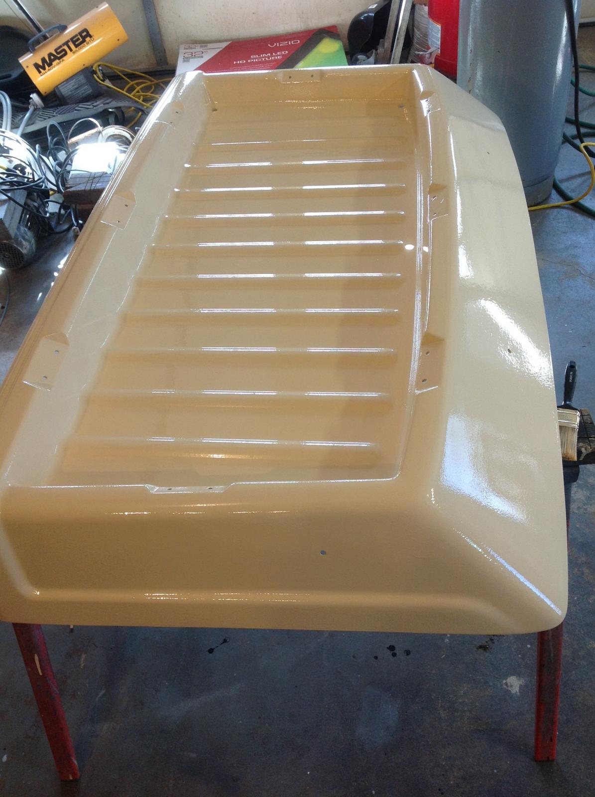

Well, coat #1 is dry, scuffed it with 320 grit and wiped it down for dust. Lightly scuffed the phantom WESFALIA really pops out!
And 2nd coat on! Smile
It should be mentioned that the 2nd coat had an entirely different "flow" to it than the first coat.
The first coat acted almost watery with little body to it covering the original paint/Gelcoat.
The second coat wanted to amply adhere and cling to its chemically identical first coat. Way more coverage, almost to much, really had to brush it out and be extremely vigilant watching for sags!
This should by dry by nightfall....... Hopefully do the 3rd this evening.

dhaavers
Joined: March 19, 2010
Posts: 7848
dhaavers is offline
PostPosted: Sun Mar 24, 2013 7:29 am    Post subject: Reply with quote
Wow - that is shiny for sure. Should clean up well...???
Great pics & documentation!

The 4 studs that hold the rear of this luggage top on are simply Carriage Bolts pushed up through the roof panel from inside. There is not a water seal except for the round rubber seal between the top and the roof panel.
My Van is parked front up on the incline into my Garage, any and all water will be headed towards the rear and into these four bolt holes.
If this happens, Rain water will seep down and probably ruin the cardboard? Headliner.
So I simply installed the hardware sans fiberglass for this impending wet event!
(Still have to clean and wax the roof under the luggage rack)

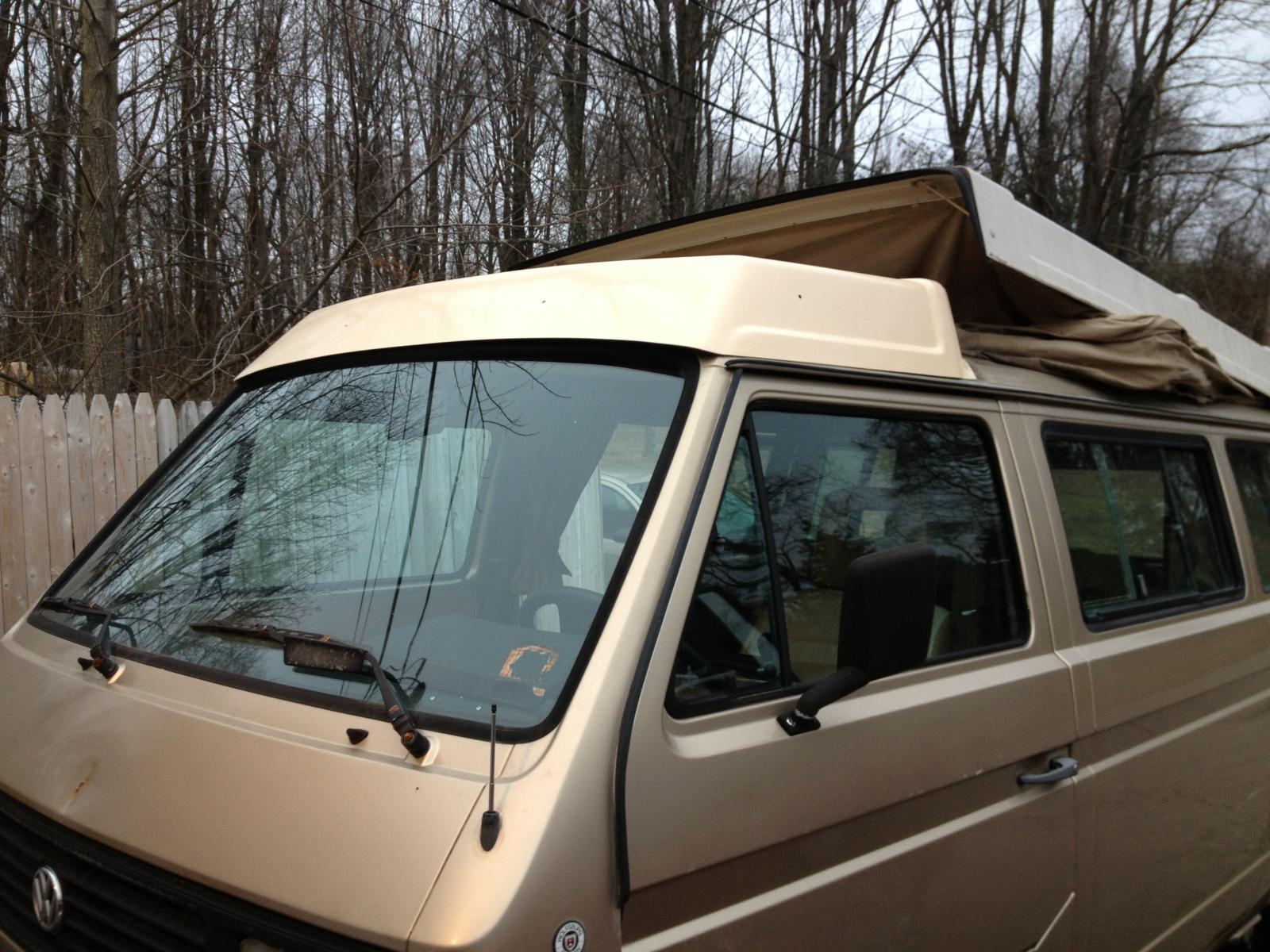

Anyway, simple greened the top of the Van below the luggage rack, scrubbed it with a scrub brush and HOT water, absolutely BLACK suds!
Rinsed it off well, no shine, still a thin layer of grime. I figure some rubbing compound should clean it right up!
Before......
After..........
One of the more discouraging points is the rust caused but the fiberglass touching the paint for 27 years! Sad
Dave
Ghia
Vanagon
Beetle
dhaavers
Posts: 7848
dhaavers is offline
PostPosted: Tue Mar 26, 2013 5:01 pm    Post subject: Reply with quote
^^^ That is just surface rust and should clean up quite easily.
Good work - keep it up!

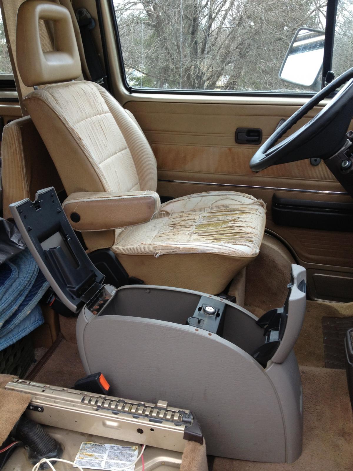

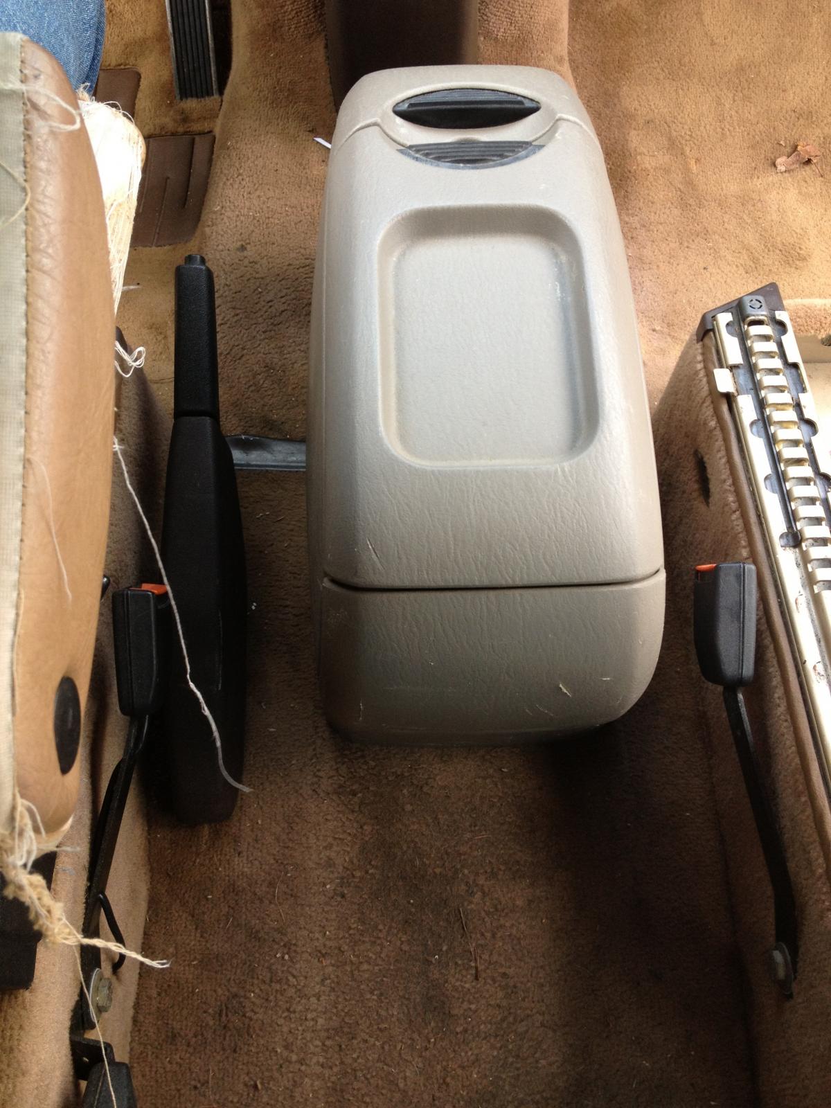

As typically happens while in the midst of a project.......... distraction!
If you've seen the movie "UP" remember the dog ? ........."I love you! Will you be my Master?"...............and his reaction to seeing a "SQUIRREL!!!! "
Well, I'm the dog!
Thinking ahead, looking at the Vanagon interior, no cup holders, no place to put needed "stuff" as you drive.......
Looking at consoles online....... looking at threads on here about various consoles...... build you own ideas............iffy at best............ purchase an after market unit.............. a decent one is an easy $100....... hmmmmmm
Wait! I've got a 2003 Dodge Caravan that will soon be leaving..... nice center console.......electrified with lights and power ports..... I wonder.....

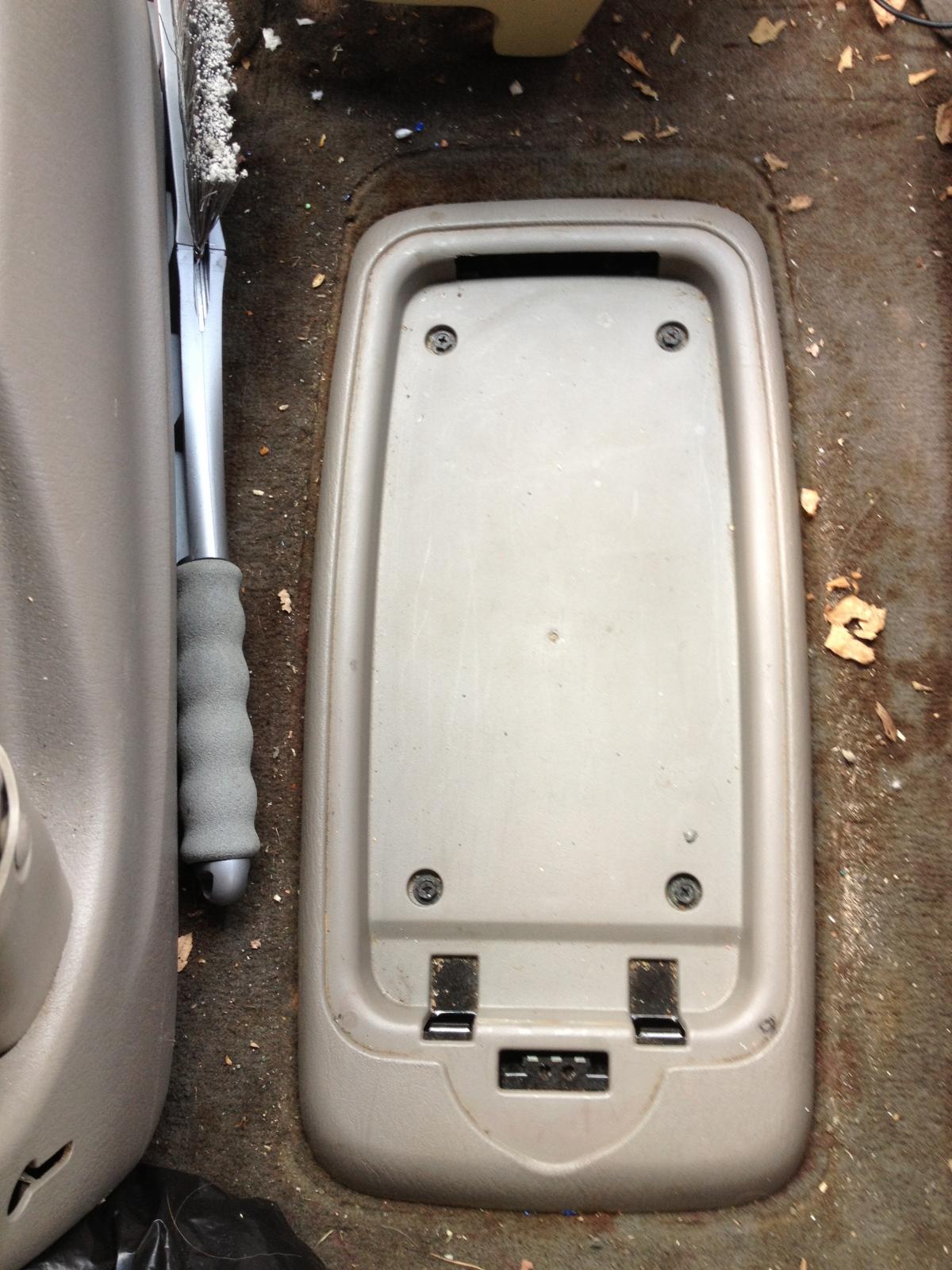

So, I removed it and carried it to the Vanagon.... a quick coat of a Brown Plastic paint......... add a cup holder of some sort on the back..... it fits nicely between the seats..... it clears the parking brake......and a bonus is that it easily removes with the quick squeeze of a lever from the base! If it's in my way, bye bye!
OK photos....we all LOVE photos! Very Happy
(the passenger seat is currently removed for upholstery, can't imagine why? )
(it has a lit removeable tray for the rear door area)
(see, there is plenty of space to incorporate a cup holder in the back of this unit.....)
(and the floor mounting bracket. Power connections and firm attachment to the floor, yes the van needs vacuuming, its mostly dead leaves)
Feedback? Alternate ideas?
Dave

PostPosted: Wed Mar 27, 2013 3:22 pm    Post subject: Reply with quote
- I don't see the point of a power port in that console - you already have the nearby dash (front) & camping battery (rear).
- for Lighting inside the compartments, the easy thing to do is put battery operated LEDs in - the batteries could last several years and will not drain your vehicle battery.
1986 2.1L Westy 2wd Auto Trans.
djkeev
Joined: September 30, 2007
Posts: 32900
djkeev is offline
PostPosted: Wed Mar 27, 2013 3:58 pm    Post subject: Reply with quote
Well, if you are one of those who have fully embraced the 21st Century as my wife and myself have.......power ports have become extremely useful while traveling.
Our GPS unit, Cellular Phones, iPads, etc all need charging.
I guess if you run no tech or low tech, it's a non issue.
If that is your situation, don't bother wiring the hot foot on the console mounting base, that makes the installation super easy!
A light inside the storage box area is great for a night time search for a given item.
I'm not even thinking of power port or light usage while parked.
Dave
