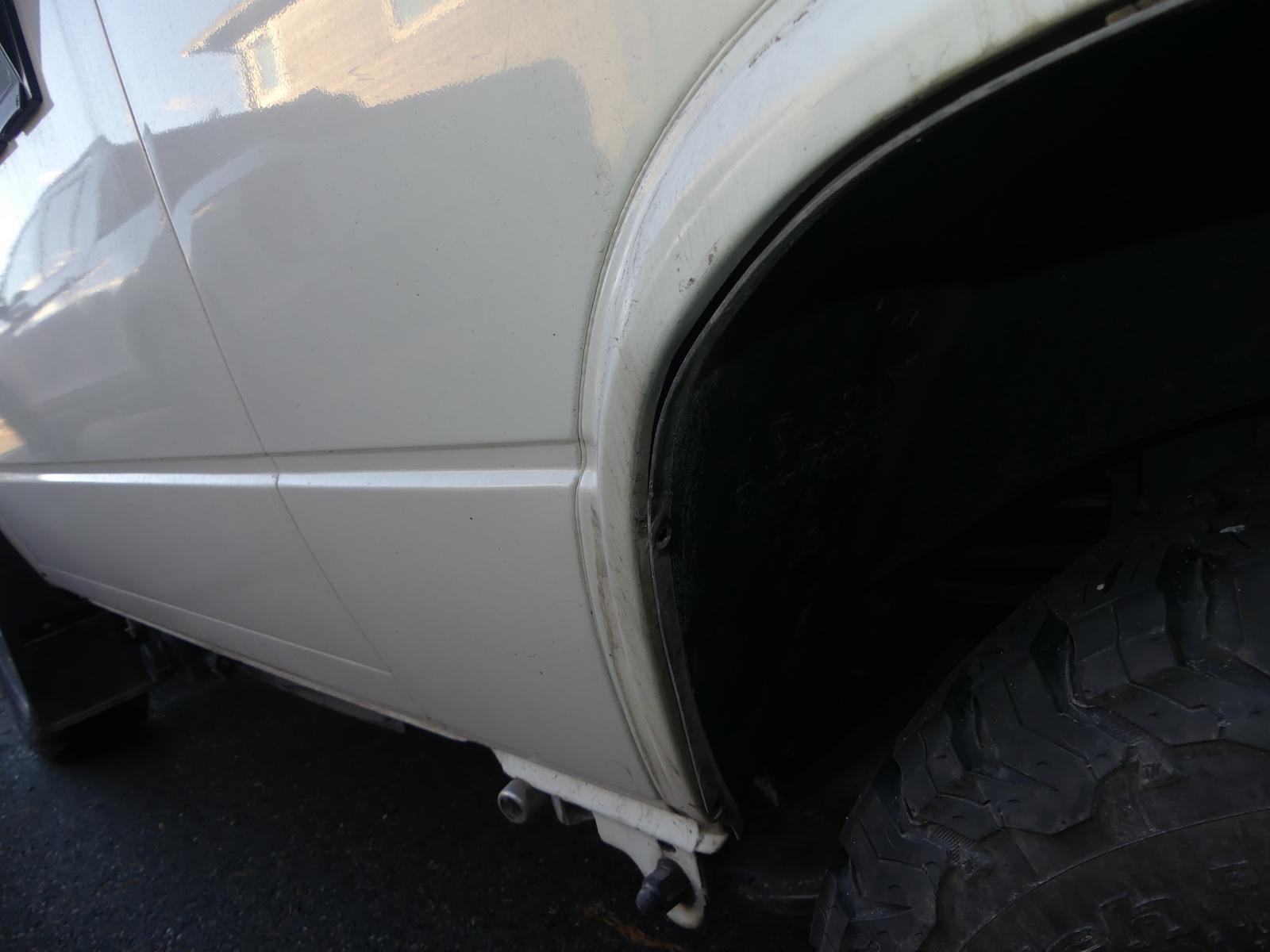

Gee, I don't know....maybe I'm doing something wrong but these don't seem to fit very well on my '91 Gl. The passenger side front went in OK, but there seems to be gaps around the lip of the well where water and mud could get in. The others could be trimmed to fit (and BD does state they might need to be) but even if correctly fitted I'm wondering if they're going to trap moisture around the edge of the wheel well. And, will trimming effect the tension needed to keep them in. Is there more to installing these than pushing them in and tucking the edge in?

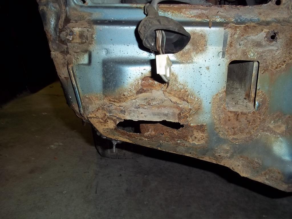

Here is the back end of a 88 van. Twenty five years of salty winters and it was shot. In all honesty that is a pretty good accomplishment. I doubt many vehicles could do that.
Here the salt water got to the front, side seat belt attachment point on a 88 van. I just pull the belt up and this is what I saw.
It is a lot of work to "rust proof" a vehicle every square inch inside and out needs to be protected. It can be done but not with out a lot of effort. Non salt belt areas of the country might not have as tough as a time.

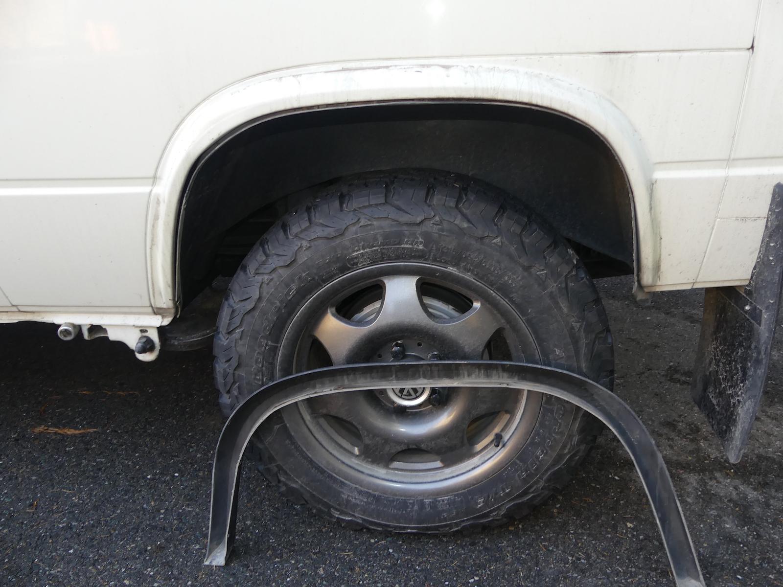

The fitment problems with these liners has to do with trying to tuck them under the outer wheel well lip.
If installed outside the wheel well outer lip they fit fine, but look like crap!
For the rears at least, using fender flares (Terrawagen) to cover up this join works great. Unfortunately because the front flares attach to the door this trick won't work for the front liners, so I'm running only the rears.
Looks good and works.
Been using since last summer. Happy with result. I do plan to take off both the flares and the liners every year or so to clean and wax underneath to protect against rust. So far the liners have kept the area protected by them very clean.
Of course I did a thorough cleaning and rust protection regime before installation. Just putting the liners on over a rust problem won't help any!
(edit) I got to thinking about the front liners again. Since the front flares do cover the wheel well lip when the door is closed maybe I will try fitting the front liners. The front flares are split between the portion which fits to the door and the small section that is attached to the body, this may present a problem but a little trimming may help. The edge of the wheel well liner will show when the door is open but that might be a small price to pay for added protection and maybe a little less road noise.
I'll play around with it when I have time (trying to finish the house this summer) and report back with pics.

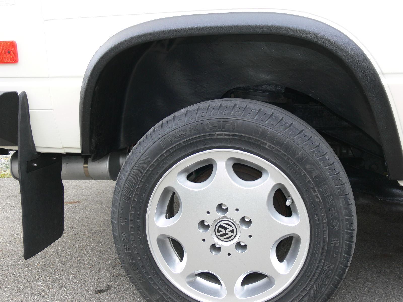

I've been using the liners sold by BusDepot for years. Mounting them works best if you also use TerraWagen Flares.
By putting the liners in so the edge is outside the wheel well they fit much better than trying to stuff them under the lip. This is where the TerraWagen Flares work to cover that join and look good.
I pulled mine off recently when doing extensive maintenance and the amount of grime under the flares was less than I expected.
The liners do a great job of reducing the amount of dirt/mud that spray around the wheel well. You still need to use something like Fluid Film before mounting to protect from salt corrosion.
Plenty of clearance with 215/65r/16 tires.
Pretty clean under here considering the roads I've been driving. The plastic liners clean easily with a hose.

I used rubber trim to help seal the gap.
I tucked the liner behind the fender flare.
A heat gun softens the plastic so you can push and stretch the liner for a tighter fit. Go easy with the heat, don't hurry this step. Hold the plastic to the shape you want and let cool. Do this step gradually.
My mud flaps help hold the liners in place. I had to trim then just a little.
I also trimmed the liners slightly they are sloppy from the factory.
Bulb trim.
https://www.amazon.com/gp/product/B07HR1N87N/ref=ppx_yo_dt_b_search_asin_title?ie=UTF8&psc=1
Also sprayed a few coats of Flexseal on body side of the liners to help deaden the sound.
This is not shown in the pictures, of course be sure to do this after the heat gun process.
