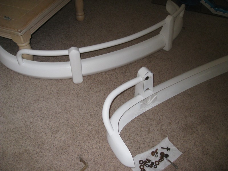

I had Denver Bumper straighten and powder coat mine. You can see the before and after.

They did a great job! I've seen others here show me their bumpers repaired and power coated or just painted professionally and they all look amazing actually better than new even. What I just don't understand is why I am still unable to locate someone in the north east to do the same work and save me on on shipping. The cost to make a set of bumpers look this good is certainly not cheap but when you add in the shipping round trip it is very costly. I travel from NJ to NYC weekly and still nobody has posted anyone to do this work in the northeast Shocked . I guess I need to go to some big American Car Show and ask the guys and gals with 50's American cars where they get their bumpers done. I'm assuming chrome shops which I am in the process of checking as we speak. I want my bumpers to look like your's Very Happy
