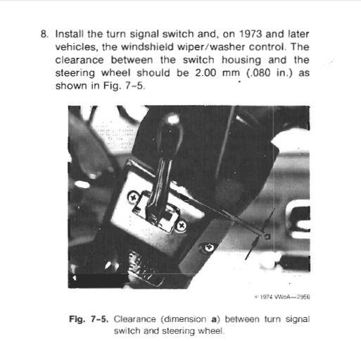

PostPosted: Sat Jan 24, 2015 1:35 pm    Post subject: Horn Early Repair Reply with quote
68-74 VIN 214 2 164060
the beloved horn ground wire tab
70Crew wrote:
There are 2 wires you need to connect on the steering column.
The first wire is the column tube ground. There is a short wire that comes off the main wiring harness and ends up right next to the steering gear box. This wire needs to be routed through the metal loop (A) on the underside of the cover plate and then attached to the tab that sticks out from the end of the column tube (B). These tabs break off easily; I have 3 column tubes and 2 of the ground tabs are missing (broken off). I attached this ground wire with the steering column, gear box and cover plate in place. It took a lot of cussing, a shop light and a pair of Harbor Freight extra-long needle nose pliers but it is definitely possible (see space G.... yep, that's pretty tight). The alternative is to remove the gear box which I didn’t want to hassle with.
The second wire (also a ground wire?) is brown and runs from the top of the steering column (C) to just above the gear box. The steering column is hollow and this wire runs through the center of it. The bottom end of this wire has a large loop wire terminal that fits around one of the 4 hex head M8 bolts that connect the steering column to the coupling disk and top of the gear box. There is a small gap (D) between the coupling disk and top of the gearbox which allows you to feed that wire (E) from the column and around the corner to one of the hex head bolts (F). I attached it on the bottom, under a nut, so that the contact was metal to metal rather than nut to rubber. I’m not 100% sure that is how it was done from the factory but it makes sense to me (anyone out there know better?).
Bentley says you are supposed to install the column tube first and then the steering column from underneath. That was not possible without a lift so I installed the entire assembly from the top. I did it alone and the only part that was remotely difficult was attaching the aforementioned column tube ground wire.
Good luck and holler if you have any questions.
Chris
(MiOdy81)
Good Luck
