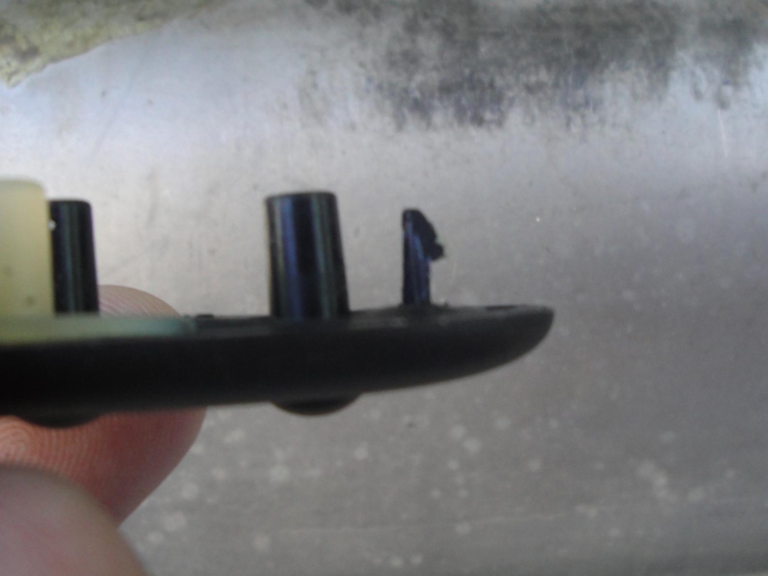

Fortunately the gap on the plastic clips that fasten the faceplate of the HomeLink device to the back is exactly the same depth as the thickness of the ABS glovebox (right of picture).
I was able to snap the faceplate right into the holes that I drilled without any glue.
Because the control unit is now about 1/8 " further back from the faceplate, I had to put something in the gap in order to insure that the faceplate buttons reached the microswitches on the control unit.
In the instructions provided by the seller, he recommended using pencil erasers, which you can in the next photo. I had to do a little trial and error for size and, ended up using the white ones that you see in the unit:

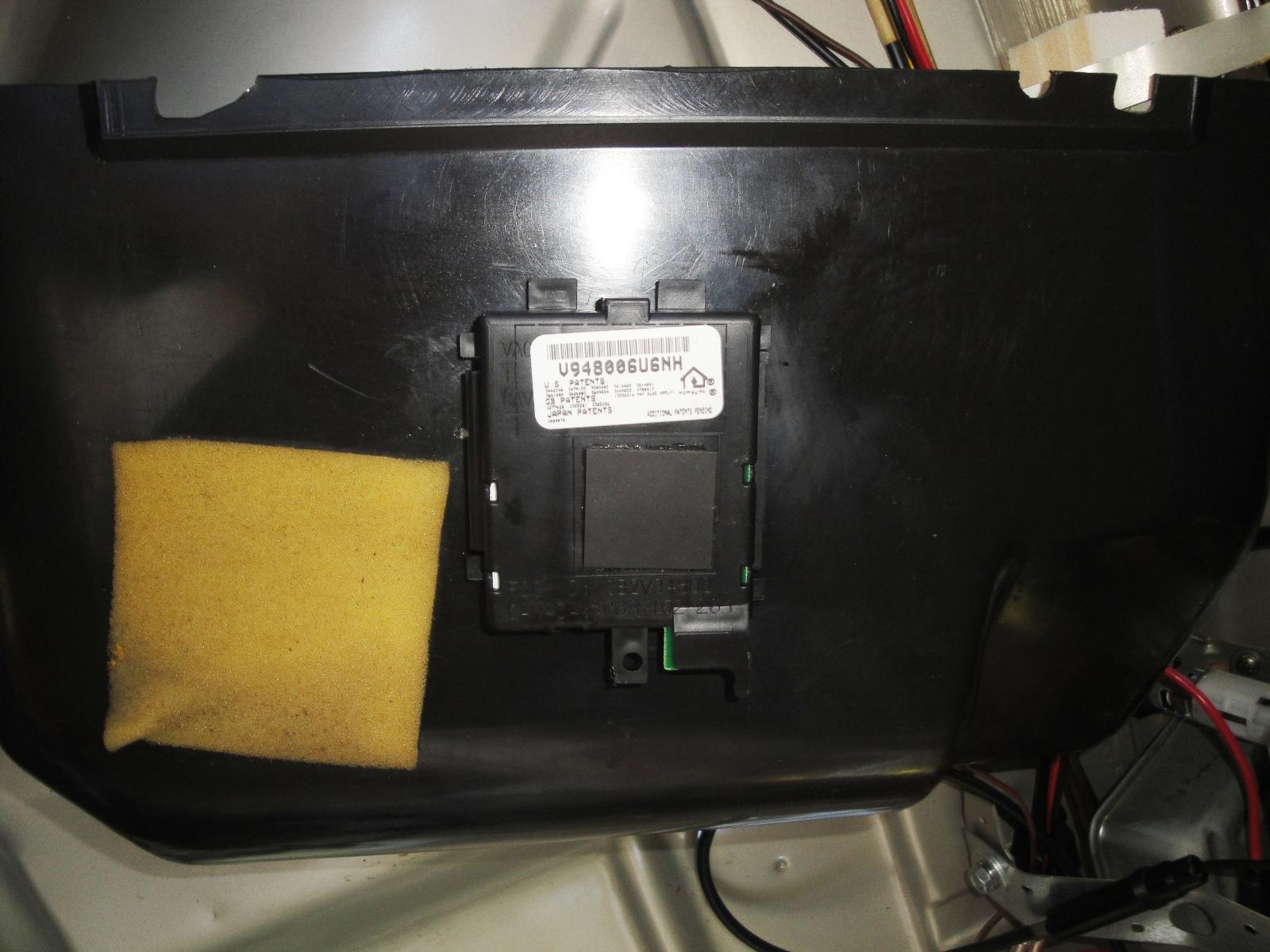

I mounted the control unit on the top of the glovebox and tacked it with some weather stripping glue (only because that's what I had laying around):
I reinstalled the glovebox, using the strap to hold the control unit in place and hooked up the wires. It is wired to a switched circuit, the ignition must be on to open the garage door.
The foil 'tape' in the second picture is the antenna for the unit.
