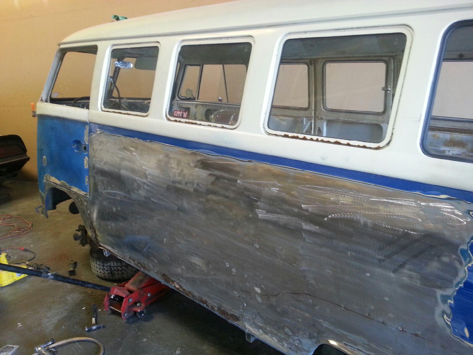

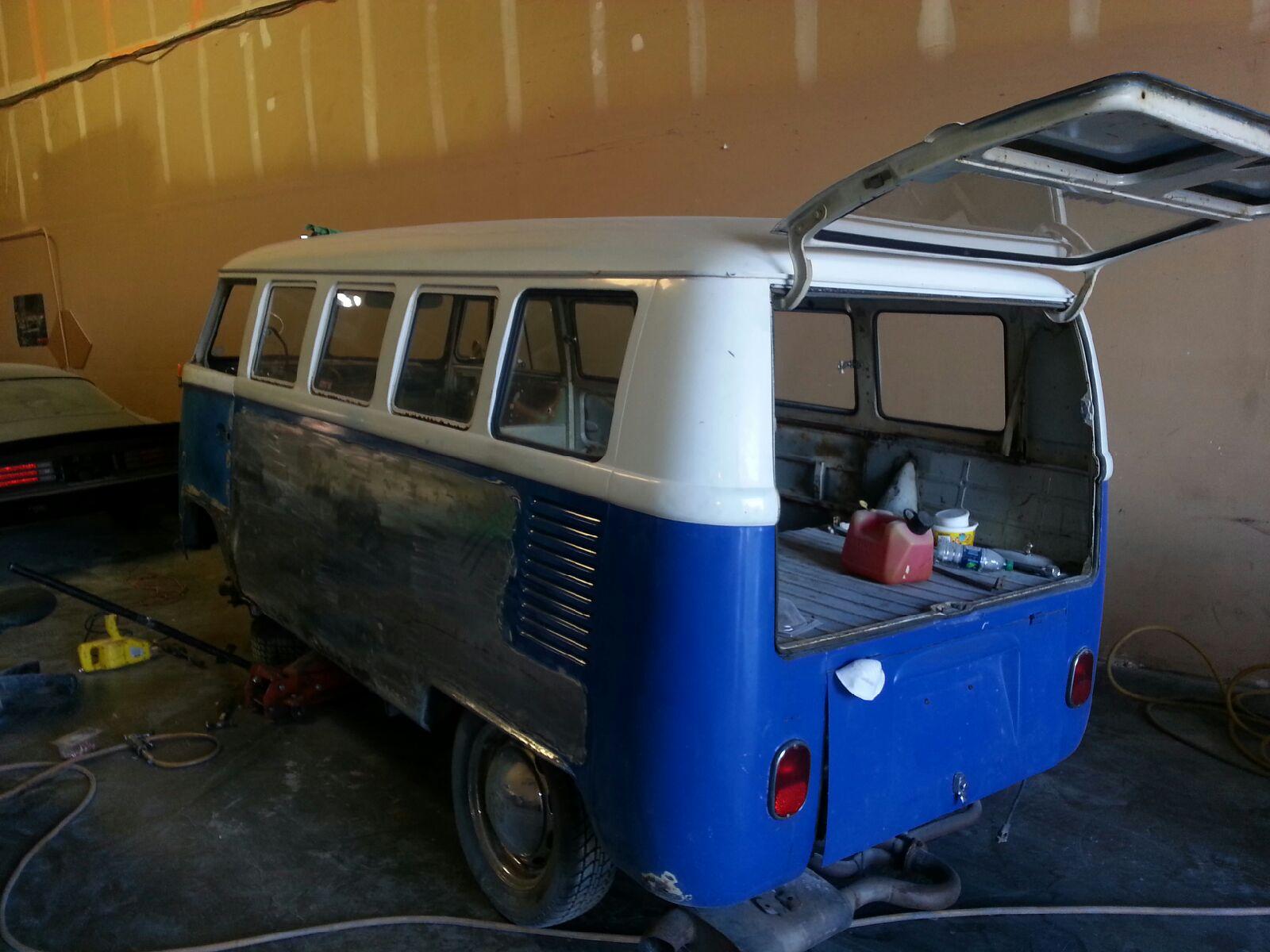

**Id love any input on what you see, what you think, opinions, and any help you may have to offer. Im no expert at this. Just love the buses and interested in getting this beauty restored to its original self the right way!
**I was told the rear looks like it may have rear reduction boxes or straight axles (not sure what that means) or a weird chamber angle. If the axles are short theres no adjusters or maybe the shocks are blown. Any ideas?
**How would you rate this bus?

PostPosted: Wed Sep 18, 2013 1:20 am    Post subject: Reply with quote
by the height of the bus and the camber the rear has it most likely has been lowered with the original rgb still there
what do you want out of the bus? nice original resto? daily driver cruiser? camper? lowered or stock height?

Just so you know, Kombi's only had 11 windows and were very basic. Yours is a 13 window which makes it a Deluxe (that's a good thing!). Judging by the panels on the back of the rear seats it originally looked like one of these (notice the chrome trim), and it would have had the jail bars around the rear windows and above the rear seat. And yes, your bus would have had grab bars on the middle seat.
Behind the passenger seat backrest there should be a ID plate with a wealth of information on it. Post a picture of that.
So I found out the rear wheels were just "turned inward" (cheap way of lowering). I just have to raise them back up to stock. The front was lowered to match. My plan I guess will be to get a lowering kit on it and do it the right way!
Im going to need a motor that can tow 750kg. Someone recommended I 1776 motor with dual carbs with 80hp, stock tranny can handle it. Possible clutch upgrade too and have an external oil cooler as an alternative.
*What exactly are gear reduction boxes and what do they do?
*What do you recommend I do with the motor for that kind of towing?
my guess from your posts are you are not in the US huh? Smile
there are several "right ways" to lower a bus depending on who you talk to
to me lowering a bus the "right way" is to lower it safely to fit your needs
a 1 ton rear end with rgb would be good for towing plus be fine mated to a mild 1776
and you can also safely lower a bus with a stock tranny with rgb's

is that a bay front beam? looks like the front was "upgraded"?
find a motor that makes you bus go as fast as you are allowed to tow, then just tow.
in europe for example, trailoring is limited to 50 miles or 80km/h usually. Stock 1600 with RGBs will do that all day long.
In the US trailering is not limited like that, find a motor that will go 70mph, and tow with that.
freeway flier most likely with a 1776 sounds like good start.
as i said, a 750kg trailer is not a problem, unless you cross the alps on a regular basis Smile
---- What photo are you looking at that makes you think that? (Im a newbie remember so Im not too sure what you mean) I sure hope its original.

Your front beam is definitely of late phatchick vintage. I'd go with IRS for the back too! (As I did already!) Anxious
Get it running safely and just enjoy it for a while before going crazy with mods like the sun roof and such. Good luck! Cool
