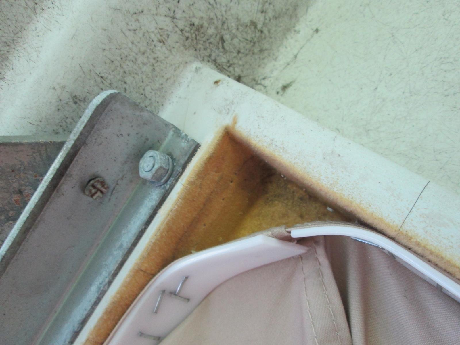

As promised - pics.
DaleNW - I will probably end up with similar or worse wrinkles than you have.
Below is the passenger side rear corner - it's the "good" one.
Below is the drivers side rear corner - where the biggest gap ended up.
In the next day or two, I'll try fasten it down all around the bottom. The rear corners will be a problem. I needed a break, though.
Also DaleNW - the JK instructions said not to worry about the wrinkles, they'll eventually smooth out!! I'm going to keep my original canvas to compare and measure any subsequent tent canvases I buy.

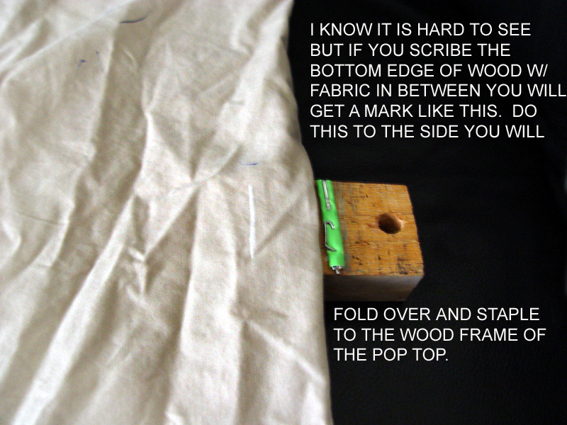

PostPosted: Mon Oct 07, 2013 8:57 pm    Post subject: Westfalia Pop Top Installation Tool Reply with quote
You need to make reference points on top portion that attaches to the top. You need to find the centers in between the canvas corners and the centers on the frames. Staple your corners first and then the centers. Before even do that. Get a small block of wood and mark off a measurement of no less than 5/8 to 1 1/2 inch. I believe I used 11/16 inch and used soap remnant to
mark in the first measure of fabric to be tack on to the frame. Then you find your centers on the canvas and the top frame. That is when you start to stapling and you must monitor how much slack you have between the corners and the centers. Take your time and if you make a mistake, take your time to correct it. You will find that the canvas will start to take the shape of the frame, and your job is half done. Next, find the centers on your top and on the bottom of the canvas where they mate. Be as accurate as possible and use the cheap orange handle Awls that are available from Harbor Freight to help you with the assembly. I hope this helps you and I hope you all the success.

Thanks GeorgeO! That's a great method for marking the line. And 11/16" same to have been the magic measurement for the tent you have. I'll definitely give it a shot when my new tent arrives.

I wish you all the success. Just remember, the marked off fabric is the going to be stapled first but find you center point and start from there. Get your corners right, your centers and start your stapling.
Here are the Awls I used to find the holes on the top.
