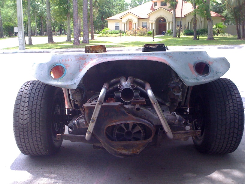

Looks like your engine might suffer from heat intake as cooling air intake draws heat off of the exhaust in this configuration... did you see Lo Cash John's approach to a T3 buggy exhaust?

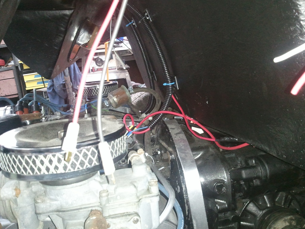

so I picked up some of those zip tie self adheisive mounts and some jb weld from the local carquest. I tested one out by sticking it to the rustomeum bed liner stuff I have on the underside of my buggy. worked great!!! I tried to pull one off and I thought i was going to rip the fiberglass apart. really cleaned up the wiring. everything is also wrapped in wire loom. even if one didnt get the best hold and eventully falls off I can just jb weld them back on. I think I put one every 8". also they only had white ones, but a quick coat of spray paint to make them black was all it took.
as far as the exhuast goes, any ideas? how about wrapping the 4 pipes in some heat tape? or maybe make some kind of funnel to get the cooling air from in front of the pipes? the only way to really tell if its going to effect cooling or not is to run it and monitor both cylinder head and oil temps. im still aways out from driving it, but ill post results as soon as I can.I

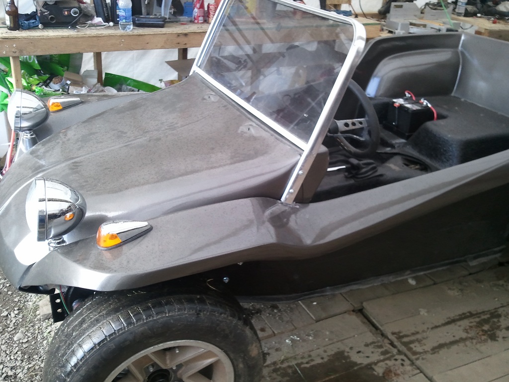

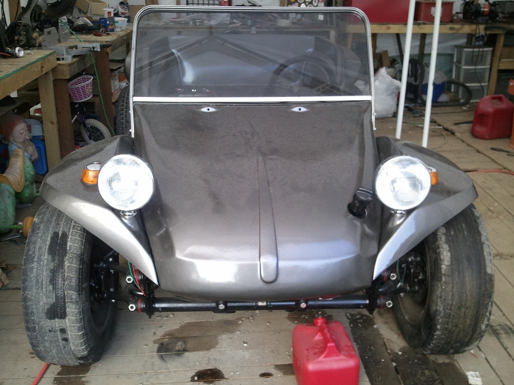

well, im exited and pissed off at the same time. the buggy moved under its own power today. drove it about 20 feet forward and back. sat my ass on the floor and putted out the garage to the driveway and back. it was awsome. but then i found out my gas tank has a leak in it. bummer. i dont know what happened. it had a small hole in the top and i fixed it before i installed it. found it while wire wheeling it. i filled it up with water to test my patch and it held fine. no leaks. so i dont know if i got a leak when i bolted it down or when i was trying to install the hood. it was a huge pain in the ass to get the hood to go over the steering coloumn support, over the gas tank filler, and it has to go under the front of the tub. i am not looking forward to haveing to remove it. lot of cussing and scratched paint. anyways, heres what it looks like today.
so you can see in a pic. that ive got a gas can catching the dripping gas.
the windshield is the one i got from buggyfaron. i need to replace the tinted glass with some road saftey glass.
also. whats with the vw gas tank. i noticed i had to put about 2 gallons of gas in the tank before it even made it to the fuel pickup tube. why is that? the pickup tube is in the middle of the tank, not at the low point. the tank is at so much of an angle im not getting the full potentol of the tank. im thinking if ive got to do some patch work to the tank(im thinking its leaking at the seam.) i might as well move the pickup tube to the low point. i probably should just buy a new tank. its just money, right?
so far, 1.5 years and $5000 into it.

so its leaking at the seam. both front corners now have a steady leak. dont know why. I filled it wih water to test for leaks and to see if my tank patch kit worked on the top of the tank. anyways, what can I do to fix it? I really dont want to buy a new tank. I know I should. one reason is safety. the other is because its such a pain in the ass to get the hood off. what would you do? still on a tight budget, dont have an extra 150 plus shipping for a new tank. might be another month till that happens. can I maybe roll the seam up and weld it?ive never used a tank sealer before. will it work on this?
Lo Cash John
Joined: February 06, 2004
Posts: 2284
Location: Jacksonville, FL
Lo Cash John is offline
PostPosted: Sun Jun 10, 2012 9:58 pm    Post subject: Reply with quote
The reason water didn't show the leak but gas does probably has to do with the molecular make up of the two different fluids. I could probably get my wife to explain (she minored in organic chemistery) if you want.
If I were you I'd pull the tank, wash it out three times with a hot water/detergent mix then weld it properly.
