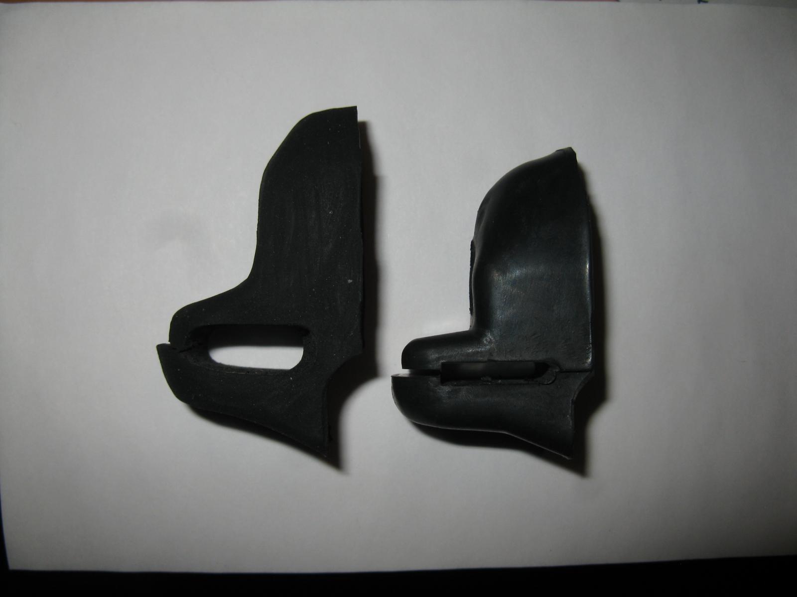

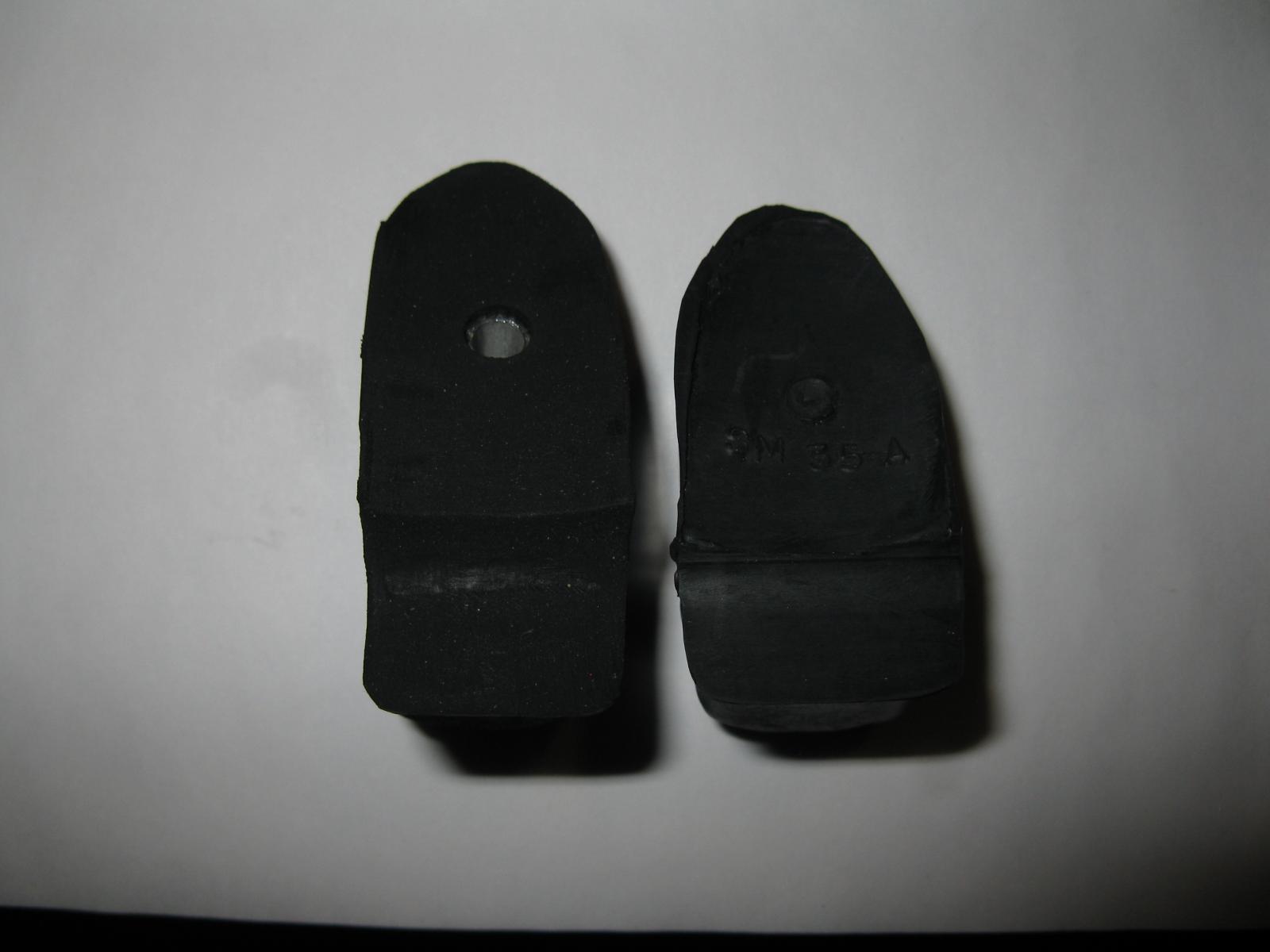

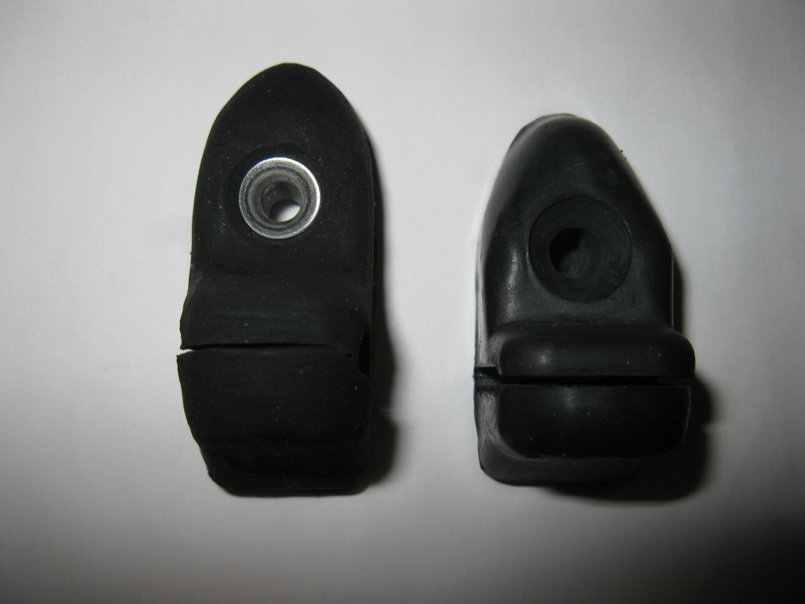

Has anyone ever come up with the lineage/history of the slight variances in "one-eye-ducks" ? I have a couple here with different shapes in the "mouth" area to hold the wiper blades. Also in height. It may be here already, but I didn't turn up anything in my search.
Here you can see the height difference between the two I have here...
From the side you can see the differences in the mouth opening to hold the wiper blades.
The back-sides...
I just didn't want to duplicate it if the info is here somewhere already. Thanks!
Bill

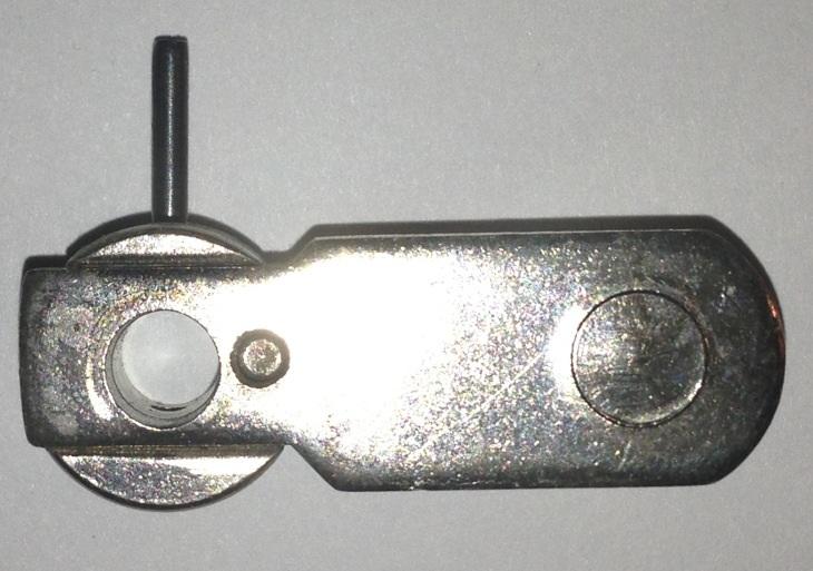

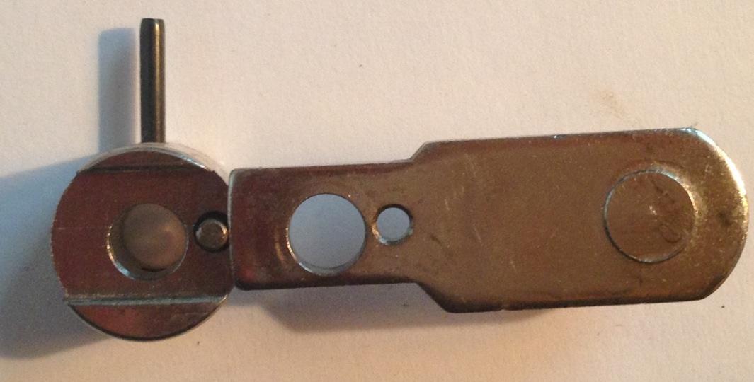

I had bought some repro 55-64 pivots from a samba member & thought they were a little sloppy. In the video... see how the metal is thinner and how the repro sags when I start to depress the shaft. The reproductions I had were missing a stabilizing pin that keeps them operating tightly & wearing out prematurely due to sloppy fit.
See vertical pin & corresponding hole, down at the lower part.
aka: Evan

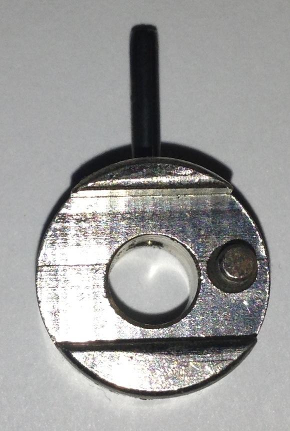

PostPosted: Sun Mar 30, 2014 4:06 pm    Post subject: 55-64 safari pivots Reply with quote

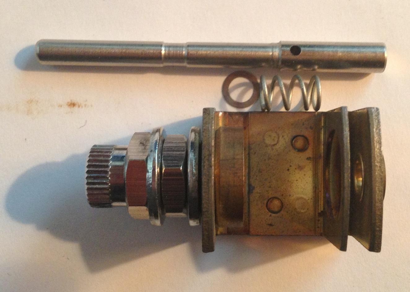

I've got a 55-64 pivot with a tattered shaft.
I disassembled an NOS one to get dimensions to make a new shaft & wanted to share some info. (Edit to info below: the 4.95 mm is actually 0.1955")
Next three pics just show how things are a little eccentric.
Washer goes to the top of spring & is 0.035mm thick & is almost a snug fit.
Spring:
Free length = 11mm
Compressed length = 4.5mm
Spring constant = 37 lb/in
OD = 7.05mm
Wire dia. = 0.86mm
aka: Evan
I bought a set of those too. They are S$%t. I was told by the seller that they were OEM. I think the main issue is the "disengaging tab" is too high. If you compare the red arrow on the NOS one to the same spot on the repros you can see it is a smaller gap. This means it takes a greater distance to get to the point where the arm is being pushed out of the spindle. I'm going to try and drill out the spot welds and move the tab and see if that helps.

Ya, OEM... original equip. mat'l. True, it's brass/bronze & steel... still leaves plenty to be desired. Did you install & recognize an issue or just a bench top evaluation like me? I've yet to hear any feedback from installed aftermarket '55-'64 disengagers.
That lower gap is a fuzz too large on our repro disengagers. The problem is exacerbated by the loose tolerances at the pivoting arm center hole & shaft.
Might consider trying to take the roll pin out (just past the shaft & not all the way out) & putting thin bronze fender washer at the bottom of the gap you highlighted.... sandwich the bronze washer between the bracket & pivoting arm.
Could probably mock up a test with a piece of sheet metal with a shaft width slit cut out of it to test for effectiveness at taking out the slop prior to disassembly & trying to find that special washer (or thin section of a bronze round with the right size hole drilled in it).
Thankfully i realised after a bench test too. The idea of adding a piece of sheet metal is probably the best way to go. I just re-inspected them and can see what you mean about the slop on the centre hole. Ill let you know if i find a good fix.

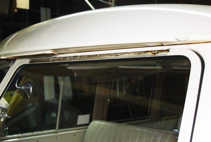

Scott's '63 23 wrote:
Just an update on my contact with CE. Mandy mailed me their epoxy to reattach the hinge but it never arrived. She feels it never made it through customs because of its liquid state.
I purchased 3M's Scotch-Weld 3501 Epoxy Adhesive (supposed to be the ultimate metal-to-metal epoxy) and made the repair. Back on the road.
LittleThunder wrote:
I reglued the hinges with the glue supplied to me by CE. I called them about the problem and the aircraft epoxy they use was at my door in 4 days. I glued them per the instructions and it's holding up nicely. He explained to me that they had one bad batch from a couple of years ago that didn't cure properly due to the cold weather over there in the winter. Since then they haven't had any failures. You're best bet would be to give Dave at CE a call and talk to him about your best option. Personally though, I don't have any problem with the glued hinges.
I moved this to the Safari thread after starting it in the Split Bus forum:
My CE safari hinge popped just like Little Thunder's. Contacted CE and they are sending me some of their epoxy to reattach. Thanks for everyone's help.
The photo below shows the hinge plate popped up off the frame:
Just a follow-up on this repair. I received a private message from someone asking me how this repair held up. I had forgotten all about the repair until this email came in. It's been 3 years and 4 months and it is perfect. Open them all the time and it's as strong as new.
When I made the repair, since the old epoxy could't be dissolved off, I removed most of it with a chisel, slowly and carefully. I then sanded it completely smooth before applying the epoxy. I also marked it precisely so that I could put it back together exactly as it was originally. Since I clamped it together after applying the epoxy, I wanted the marks to be seen on the outside of the clamp job, reassuring me that the pieces didn't move during the clamping.

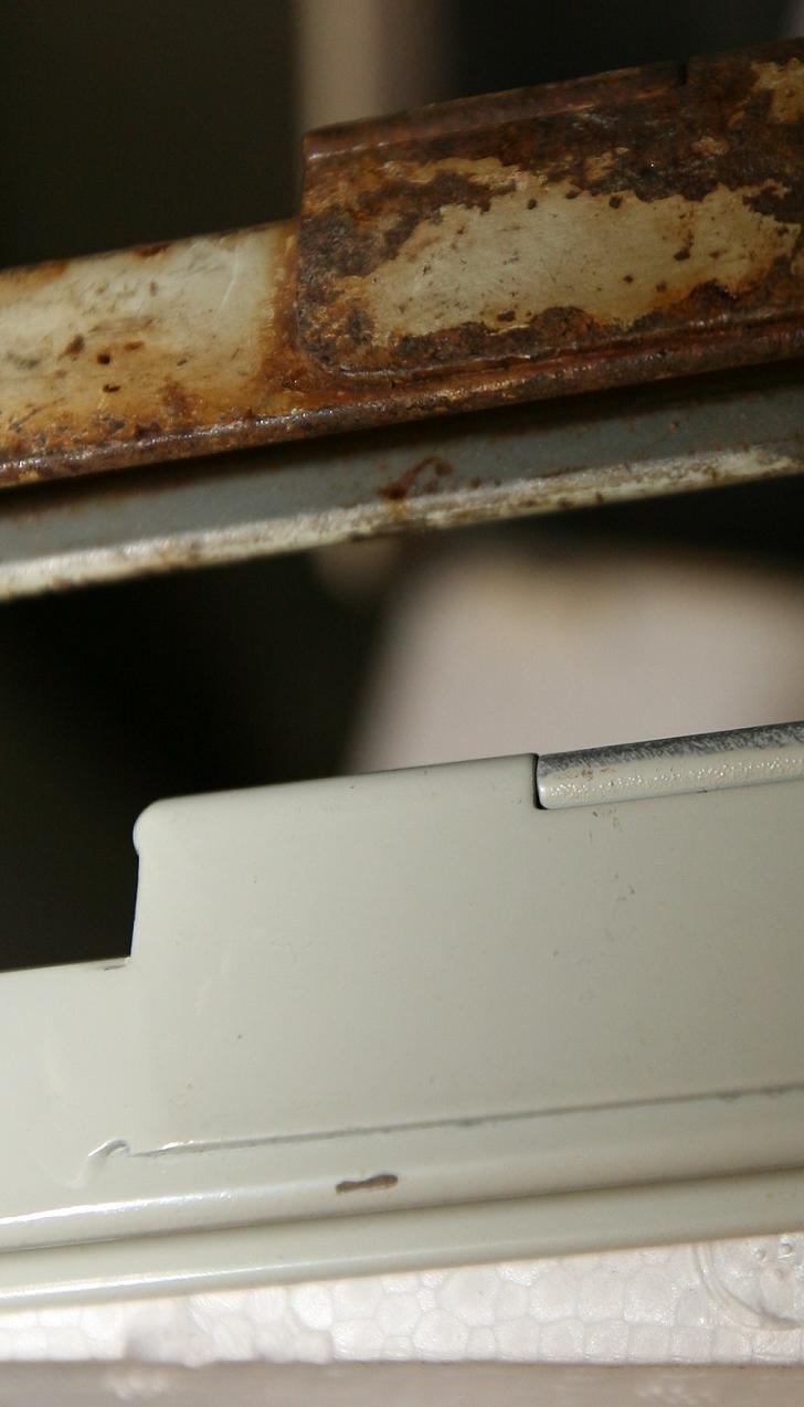

OK my buddy brought over a set of EIS and early OG to compare and test fit.
I have personally owned and installed:
- Izzy
- Wolfgang
- NOS
Pros:
- Double channel
- We could interchange top and bottom frame with OG
- Laminated glass
- Frames appear good quality overall
Negatives:
- Hinges are mounted to high
- Hinges were not mounted even, this seems to be the fit issue
Note, they did fit but were way close on one bottom edge
- Powder coating appears low quality
- Glass was loose inside
- Hand grinding on frames is very apparent
Overall, fix the hinge and they are the best repo by far. Edit, never tried the aluminum ones since nobody seems to sell them in the states.

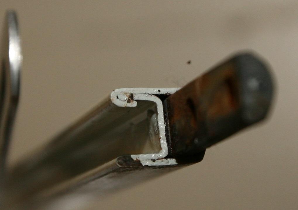

The hinge position was placed half way between a early and a late set to make them more universal. They fit tighter on the bottom on an early bus. The seals were messed up by the manufacturer.
I have had to take the frames apart and give a little tweak to square them up.
I have installed 6 sets to date, the powder coated ones seem to vary. I have had perfect and marginal ones. The primered ones I take apart and glass bead blast them, epoxy prime then paint.
Overall a good product and I'm sure the next run will be even better, they are the closest to original.
