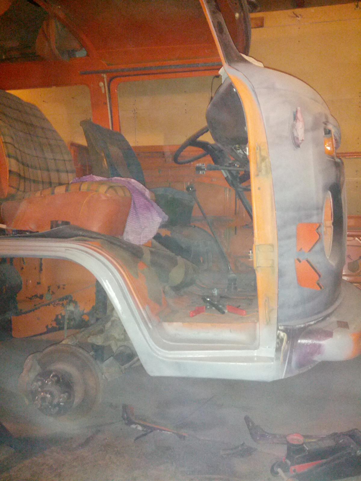

Hahaha! I never noticed that before. I was just trying to keep my welding magnets away from all the metal filings in the air.
No progress on the doors yet, I decided to paint the interior first. I didn't realize until I got into it, but the entire interior is made of curved edges, which has taken a while to sand Evil or Very Mad . In hindsight, I wish I'd sand blasted the inside like you did.
Should be able to finish sanding/scuffing tonight so I can paint this weekend though. After doing the body, sanding and painting doors will probably be a breeze.

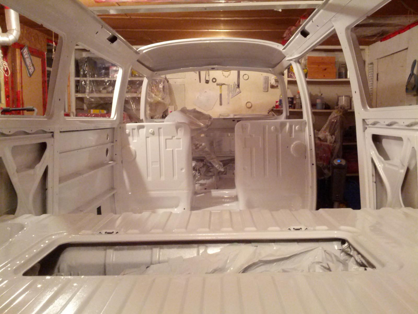

Quick update, spent the last week touching up sanding and prepping the interior and got some primer down on Saturday! I was planning on doing the paint later in the day, but the primer I'm using is so toxic I was having issues with the fumes despite wearing a respirator and goggles.
20cm of fresh snow in the mountains didn't help my decision either Cool
Looking at the photos now on a computer I can see a couple hard to reach areas that need a bit more primer... I'll touch them up before paint in the next couple days. If I let the primer sit for more than 7 days I need to resand/scuff before top coating, and there is no way on earth I'm going to sand that interior again...

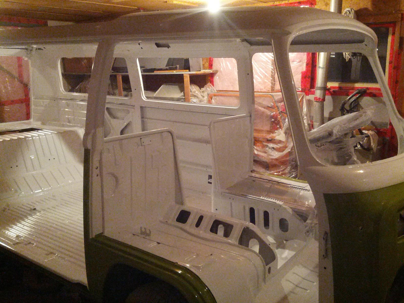

Painted the interior last night! I was having problems with my gun (think I need to replace a bushing) and the paint would spray for several seconds after I let off the trigger, so I struggled with over spray on the floors.
I suppose it doesn't matter to anyone buy myself though as it will be hidden with flooring and seats anyways. Laughing

Because my garage is pretty small I figured it would be easier to paint a couple parts at a time. So this round it got to be engine door + hatch, rear and sliding door!
Primered one side, waited 24 hours, then turned them around and flipped upside down to make sure every side had appropriate coverage.
If you're temporarily heating a garage in a cold climate like me, make sure to keep parts off the floor. The heating and cooling will cause a lot of moisture to build up on the floor, which could give you some rust/adhesion problems. I propped them up on wood scraps.
To paint both sides I made some half-hearted wooden stands for the bottom and something heavy to lean them on.
Then paint!
After the garage has aired out for a couple days I'll get started on the front doors, and finish up the bumpers.
