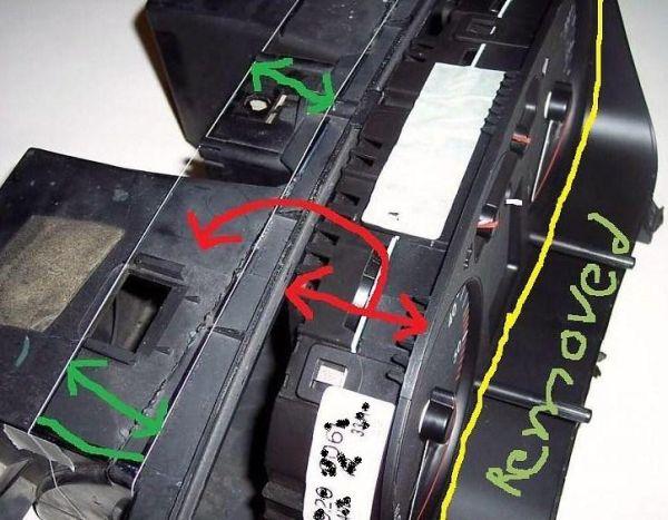

TDI Cluster Mod. I Planned to do.
TDI Cluster Mod after cutting & inserting the Cluster.(Note, same mounting & screwing points).
Front view ----------------------------------------Back View. Easy access to Cluster Sockets.

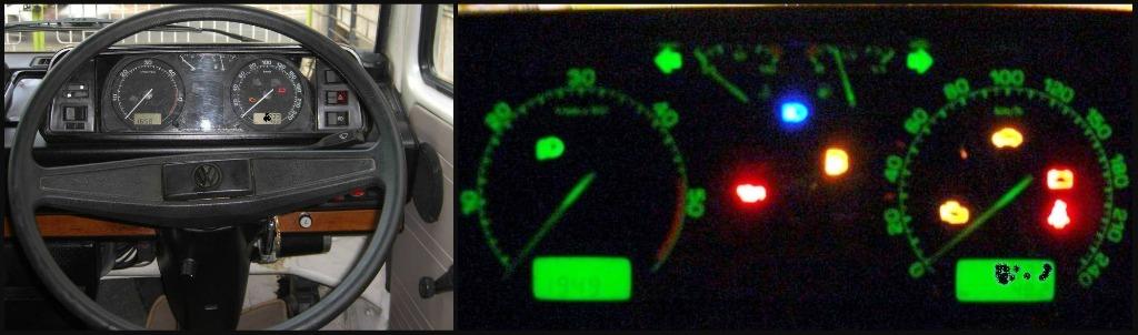

TDI Cluster on Dash.-------------------------------Cluster display in night.
.TDI fuel Float sensor fused into TD float.
Now, Cluster has Reserve warning light. Van covers a distance of app 50km once light comes on.

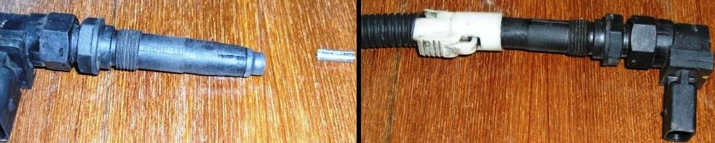

3a..TDI Speed sensor to be mated.-----------------------Ready to be used.

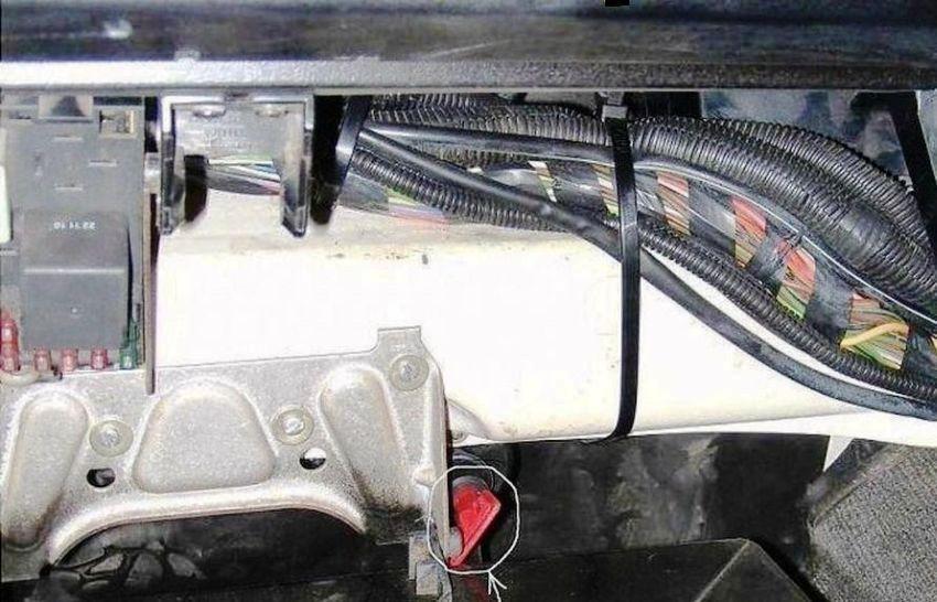

Electrical continued….

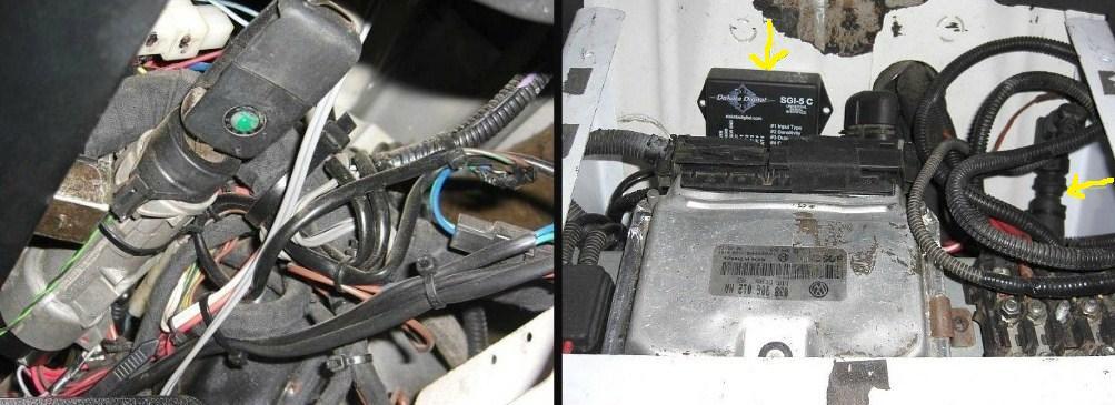

50% of the TDI Wires, Engine related Relays, fuses & Sockets were retained.
Mine doesn’t have Cruise control.
Crimping &Heat Sink Sleeve used to join the wires.(No short circuit & Proper Current amps flow).
Engine to ECU to Cluster wires were separately taped. TD wires were not tampered.

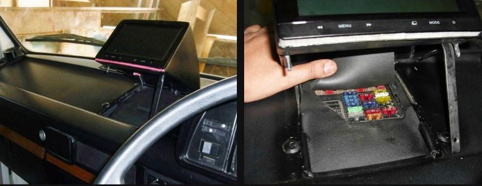

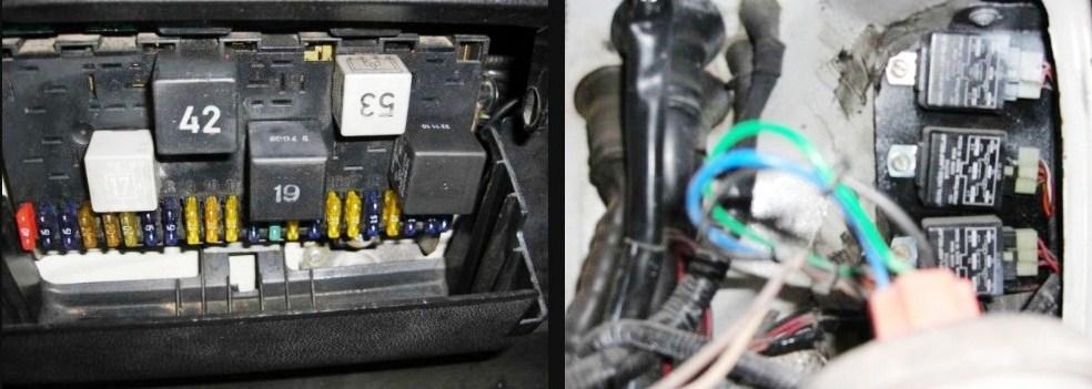

1. 5” Monitor, for Rear view, front view & side view.(Details?) 2. TDI Engine fuse box. (Note the projected rods which acts as a Guide & lock for firm fitting).
1. TD fuse & Relay Box. (All are doing their duties). 2. Relays for H/L & Extra lights located behind the H/L.
Wires segregated & strapped. Killer switch Bellow the Glove box, (Safety, Just in case).
1.Immobilizer Key mounted inside the Dash, behind the Cluster.(Why am I making it public Wink )........ 2..ECU bellow Rear middle seat, the nearest point to the engine. This avoids tampering of wires. Speed calibrator & Speed sensor can be seen (Arrow shown).
To be continued……

Finial Electrical details.

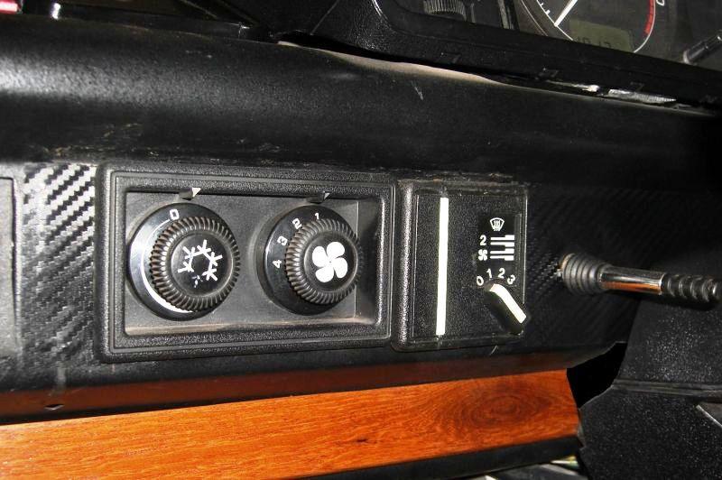

Note all the Cluster switches are from TD (H/L, Fog lamp, Defogger, Hazard).
TD Dimmer switch for Cluster, works.
-Since hot Air circulation was pre fixed, Switch controls were simplified.
Dash viewed from Driver side.. EPS Control knob is seen on the bottom Steering Colum cover.
Toggle switeh Working , explained before.

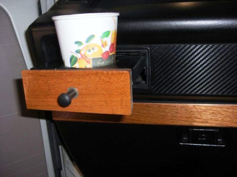

Cup holder, Dash left dummy Vent.
-19G ms sheet box fabricated to slide into the Vent frame………...A part of sheet was removed to reduce the weight. Cup dia, your choice. Made sure to bent the sheet 3 or 4 mm inside the hole, this gives good grip for the Cup.
-Woody for the looks & firm fitting.
-On duty. The pulling knob is your guess.

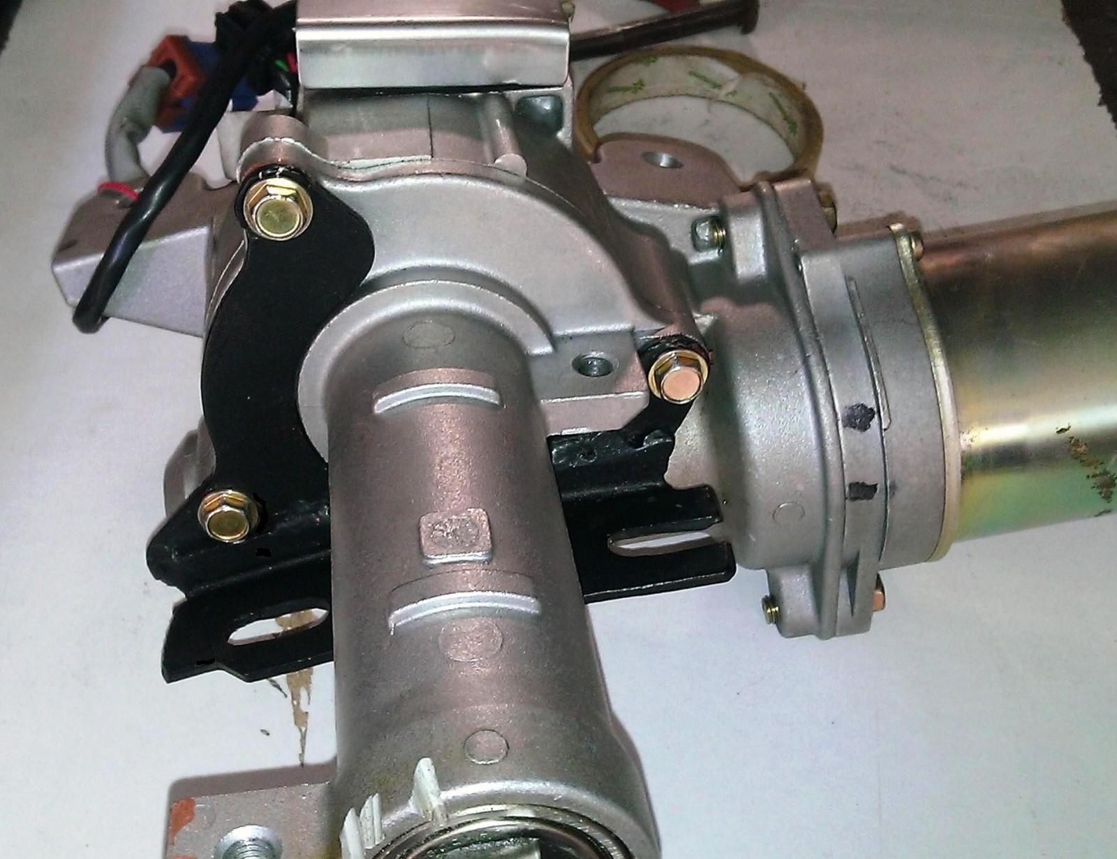

Electrical Power Steering.
Make NSK Japan. Famous for Bearing.
EPS Manufactured for GM. Corsa C. Late 2000 M car .
Cost of EPS:-- 290 GBP with shipping.
Note:- Unit provided is not a speed sensitive. A control Knob is provided to vary the assistance.
Most Rally & race cars use this setup. (Now you are focused). Wink
Please note this Mod had only one single go. Any cutting, I made sure it was 100% necessary.

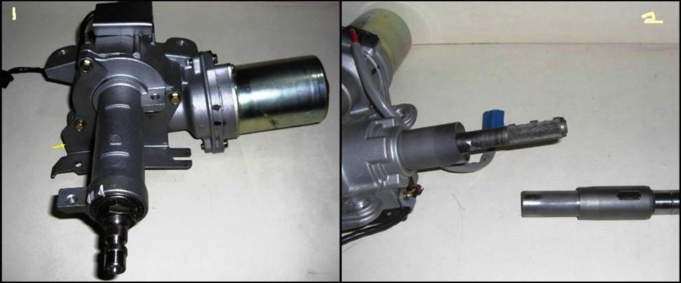

1.Contents when unboxed:- Steering Colum, Motor, Bottom shaft, Top shaft, Mounting bracket, Control box, Mini ECU, Speed control knob & Fuses.
2. Motor & bracket fitted to the Colum.(Later bracket was customized to required setting)……....Provided Top shaft is of no use.

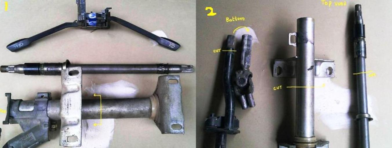

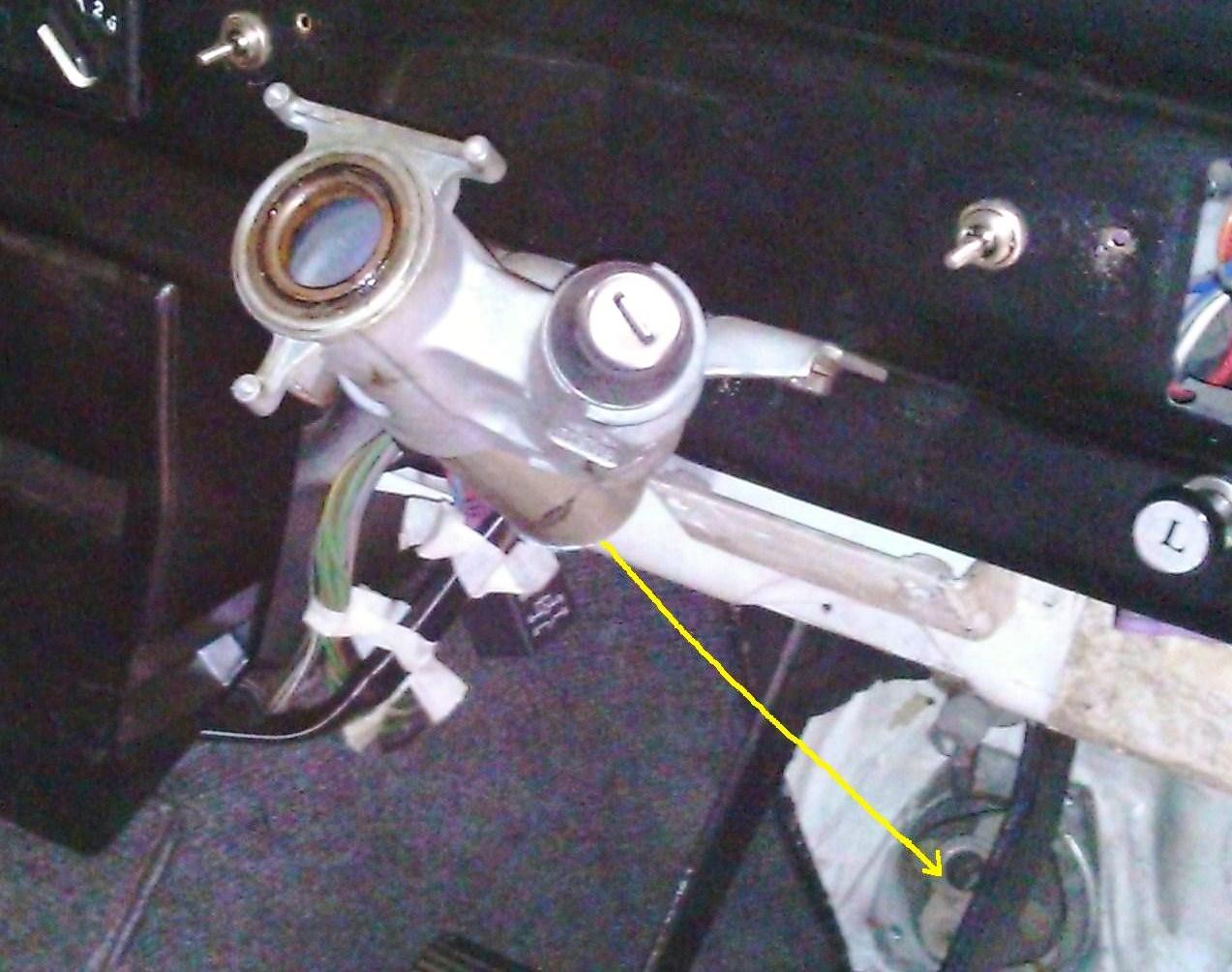

3.Steering Colum removed from the steering mount. OE bottom shaft yet to be removed. ( Sorry for blurriness.)
4.Parts dismantled from the OE Colum.( Note:- Arrow shows where Colum will be cut & the top part fused into EPS unit)……….Ready for dissection. Right detail is for EPS top &Left detail is for EPS bottom shaft.

The Bracket provided for EPS unit’s bottom fitting, had to be modified to achieve correct Colum alignment.
1.Spot weld to make sure proper fitment.(No stress on bracket or bolts)……...2. After seam weld, rough edges grind & a coat of paint Bottom bracket is ready.
(Note:--left side slot is open. The EPS unit is heavy to hold in position & bolt it by a single person. Solution, first a bolt is screwed few threads on to the van’s steering cross member then the Bracketed EPS unit is slid into the bolt. Once one point holds, rest three bolts can be easily bolted. This concept can be used in different situations).
The bracket fitted back to the EPS unit.

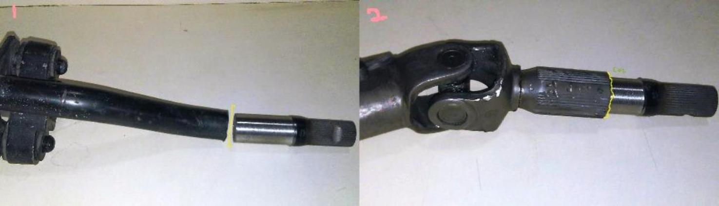

Provided Star joint bottom shaft bored app 1mm.
1.OE bottom shaft is cut & outer dia is reduced by 1mm……2.OE shaft is press fitted into provided Star joint bottom shaft . Once length is determined it will be co2 welded(End to end app 185 mm).
To fix actual length, the EPS as a unit should be fitted temporarily with the Steering wheel bolted. The bottom shaft bolt which connects Steering box pinion also to be bolted. Once the length is determined, EPS unit is carefully removed & Both shaft welded with that fixed length.
The top TD shaft press fit to EPS shaft, is co2 welded. Job Repeated to Bottom shaft.
Both top & bottom Shaft were drilled extra 8mm Hole & co2 welded, Safety at it’s best( Above arrow shown).

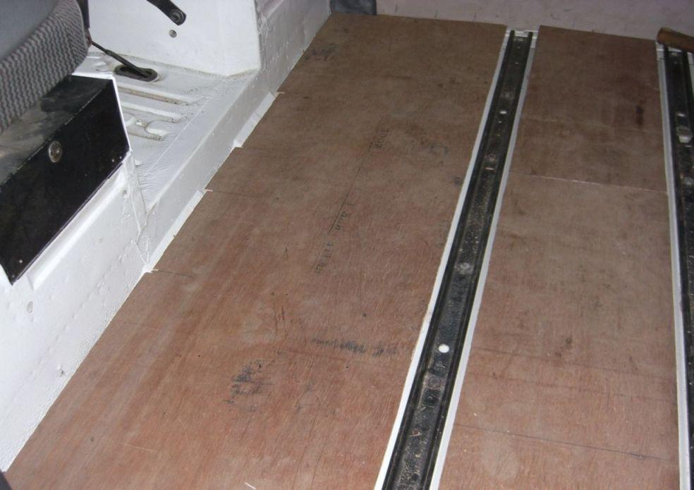

Wood flooring Mod.
The Mod is done in such a way that wood will sit in the slot & does not move around. Screwing the Wood to any part of the Van is avoided.
Easy removable of Wood floor helps in checking for any rust or floor is to be cleaned.
2” teak bedding used to level the floor.
¼” water proof Plywood is glued & nailed to the bedding.

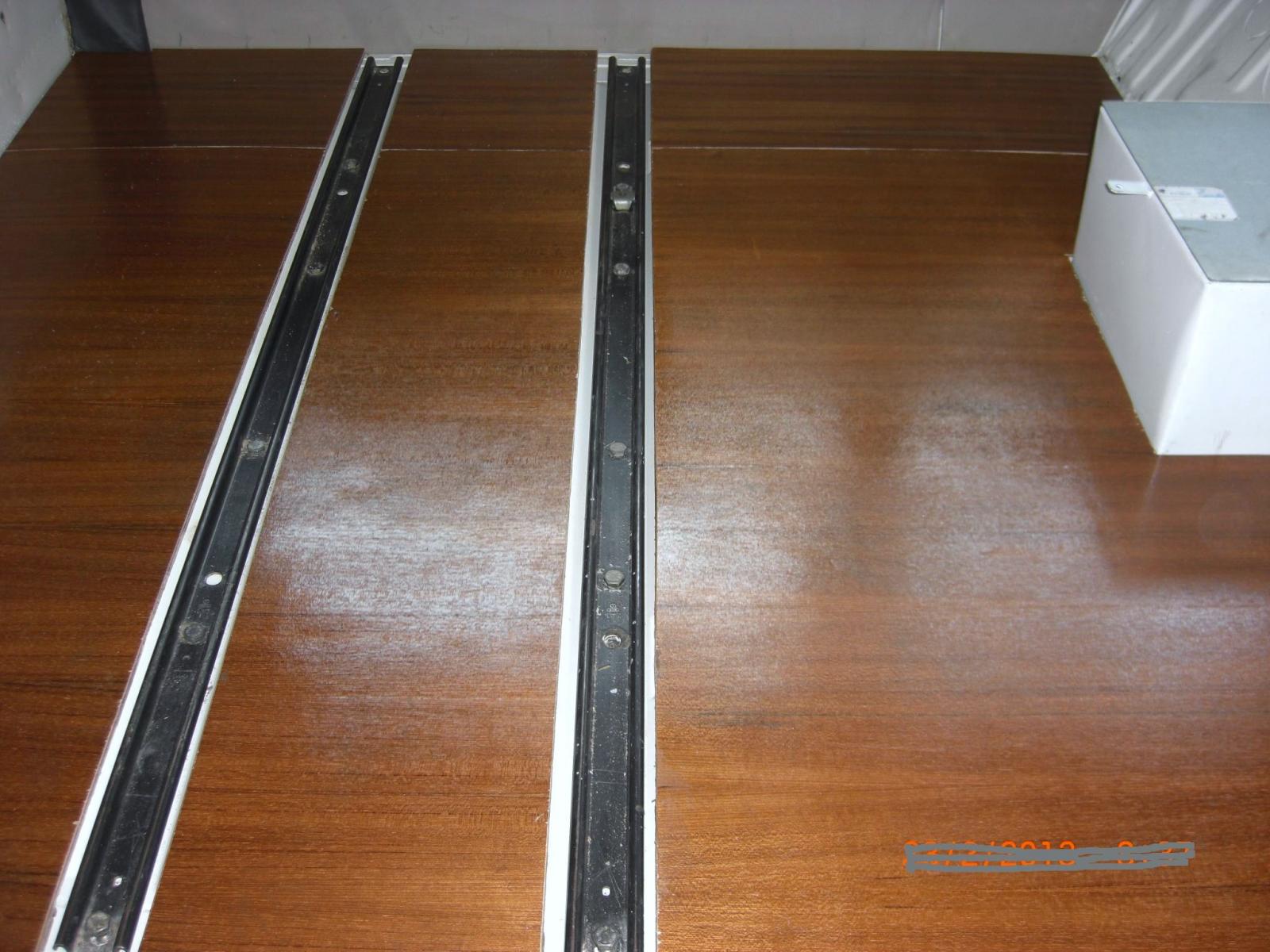

One more ¼” layer of OSP(One side polish) is glued over the existing Plywood.
One coat of plastic coating & one thick layer coat of clear completes the Wooden floor.

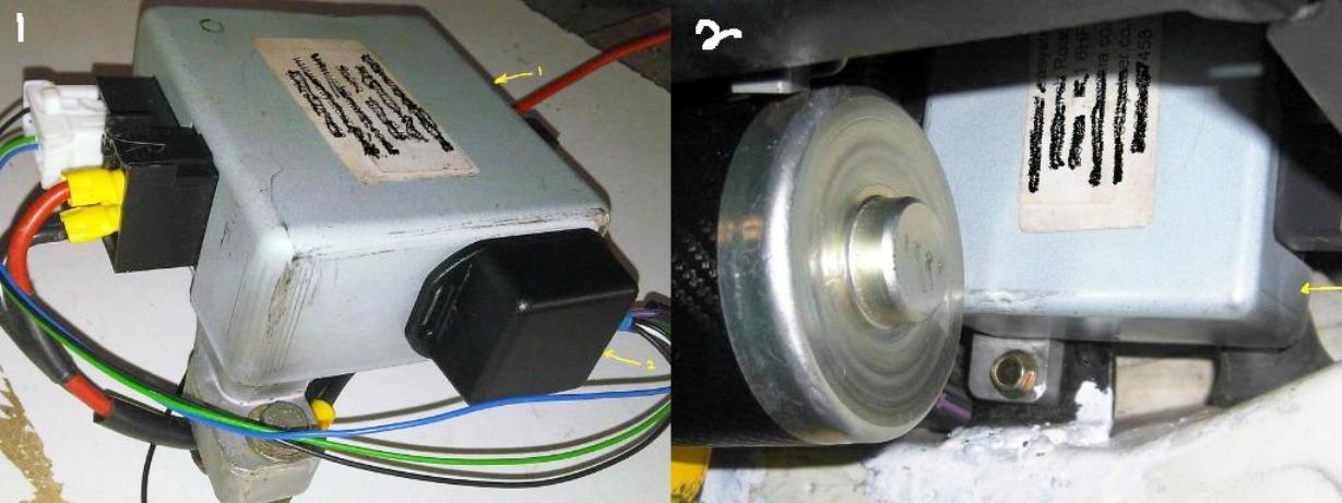

Electrical Control’s & Connection.
The circuit wires have a very neat socket which are well marked to go into their designated places. Two colored wires for control knob. Connection to main battery & Ignition on switch via fuses & two wires for grounding. This completes wiring.
1. Electrical control box & Mini ECU(Black Box)………….2.Control box fitted in it’s predetermined place.
30 amps fuse for motor, 5 amps for mini ECU(Not shown). TDI Engine relay sockets can been seen.
This completes electrical safety.
Completed work out look . Except motor projection, rest are all in OE position.(Control knob on bottom Colum cover).

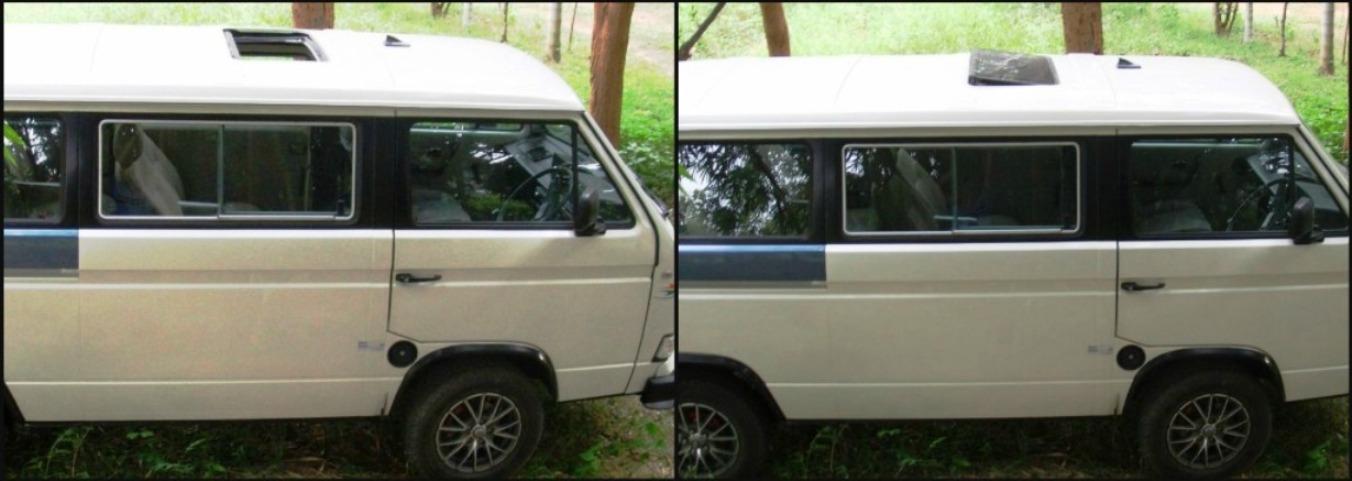

Cut the donor roof sheet 3” more, right round the Sun roof. It comes in handy while aligning & proper fixing.
The most important, Sun roof needs proper water drainage on all four corners. Front two drain made way through the sides of front Door catcher Pillars, Other two found their way to the rear, where ac water drains out.
Roof cut to the required size.
Sun roof slide open………..2.Two way Operational.
Sun Roof seen from inside with closed Sun Shade. Note the TD ac vent Mod.
Sun roof top view. Shark fin antenna also seen.

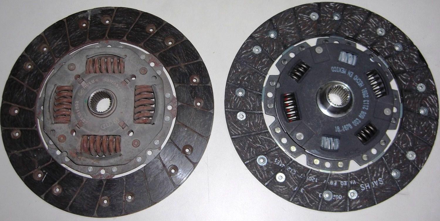

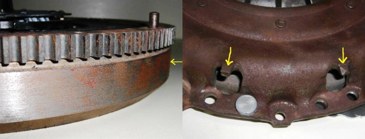

Clutch unit Up grade.(Samba, I owe you for helping me make this possible).
Clutch plate upgraded from 215 mm dia to 228 mm dia.
Parts used,
1.Donor, Skoda ALH engine’s Fly wheel & Pressure plate. Luckily, I had stored these in a safe place.
2.Clutch plate, WBX 2.1 (Spline of WBX 2.1 Clutch plate matches with Top gear shaft Spline of the TD 5 Speed Gearbox).
Try not to discard any old parts until the project is finished to your satisfaction. It may come in handy later.
Work Done.
1.ALH flywheel outer dia skimmed 4mm for starter access.
2.Pressure plate tabs were bended to make space inside the Bell housing.
3.Custom dust plate made because TD dust plate can’t accommodate due to the narrow space between engine block & the flywheel.
Note: TD starter works with ALH flywheel ring. The ALH ring has 3 teeth more then TD ring.
ALH engine starter works by using a spacer(I have set my mind on it).
Clutch Up grade Visuals.
TDI Flywheel
Left:-- 228mm ALH Clutch plate(Spline does not match)…… Right,:---228mm WBX 2.1 Clutch plate(Sachs Make).
ALH flywheel & ALH pressure plate getting ready.
Dust plate customized.
TD 5 speed gearbox. Note: the starter fits on Bell housing top. This Gearbox is perfect for the Clutch Up grade(In particular Top Gear shaft length).
My observation after completing 3000+ miles.
1. Engine vibration has reduced drastically(TD mounts are used for engine mounting).
2. Engine idling sound is minimized.
3. The Van running in higher Gear with a low rpm, runs without giving any jerks.
4. 1st Gear, sudden acceleration causes wheel spins.
4. No burnt smell while hard Gear shifting uphill or downhill driving.
Clutch Life, still early days.

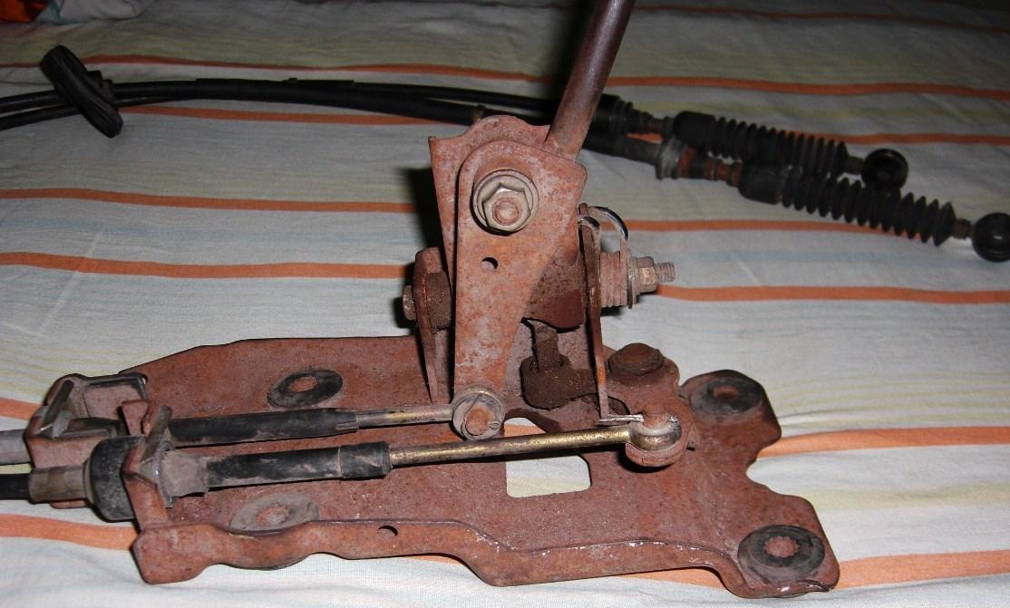

Cable Type Gear Shifter.
Hi, folks! I would like to know if any of you have thought of switching to cable shifter or have had it modified already & are using it. Please share your experience.
Since I am working on it, your feed back will be helpful in my progress. Presently, 25% of the work is completed.
I am not working directly on to the van. To be sure, I am making a working Model.
I have fabricated a fixture which works like a gearbox shifter shaft. Once perfected, the unit will be transferred to the van.
Yes, I know many Units suitable for the Van are readily available, . However, they are quite expensive for me to import. Along with Unit cost, I have to pay Duty & shipping cost. So, I decided to work on my own design. I am very happy with the present progress. Smile
Things I had to keep in mind for the Unit to work efficiently ;
1. Gear lever positioning( Easy to reach (Not like OE) & Arm moment is not limited.
1.Shifter’s reverse & 1st Gear with spring load Design matches with the van shifter Design.
2. Shifter Cable joining unit( I am using two cables in each line to over come the 8’ length).
3. Selector lever’s Stroke length for the Gearbox shifter shaft.
I am making two points for cable adjustment & also working on shorter Stroke shifting.
Note:- The only consumable part in this Mod, will be the Cable.
To start of,
There are two types of shifter units.
One Gear shifter cable connected to the gear lever above the pivot point & one below the pivot point.
Both can be used. The only change will be in the Gearbox’s shifter lever position.
I preferred the latter one.

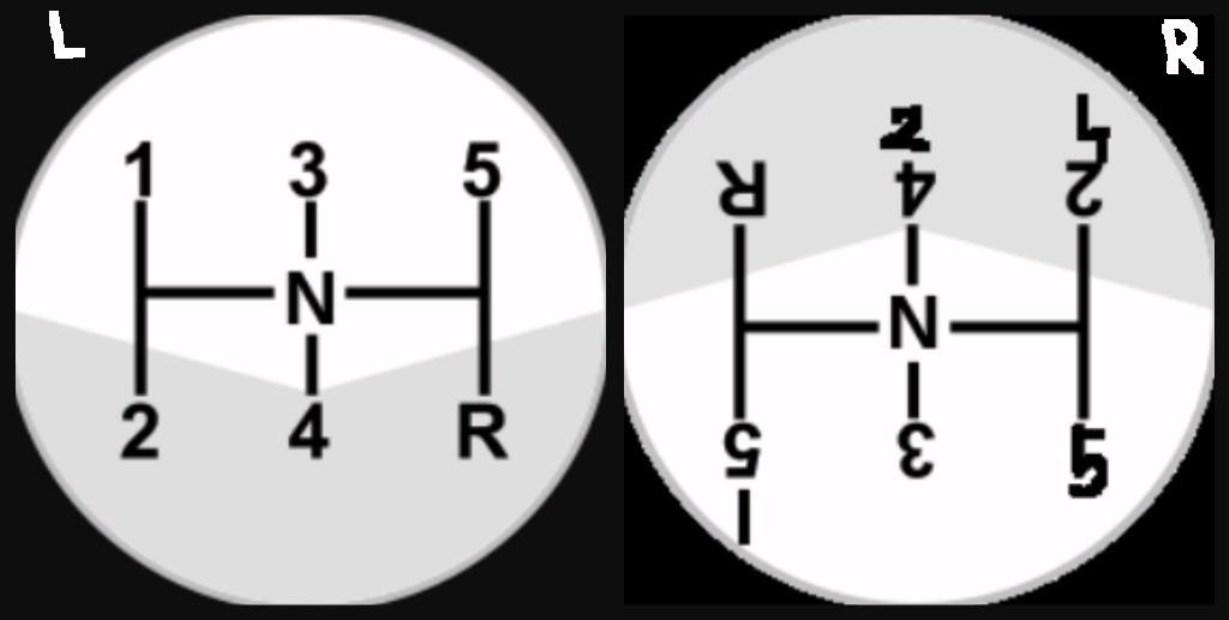

I am using Mitsubishi lancer metal 5 speed Gear shifter. Most of the Japanese Hatch or Sedan FWD 5 speed unit should work. Please look out for metal Shifter unit. They are Mod friendly, Strong & Long lasting. Avoid plastic shifters.
Visuals.
Shifter with Gear shifter cable connected to the gear lever above the pivot point
Mitsubishi lancer shifter. Note:-- Gear shifter cable is below the gear lever pivot point.
L...FWD Japanese Sedan’s Gear shifting position…….R…When the Unit is reversed, it perfectly matches with the Van’s Gear shifting position.
