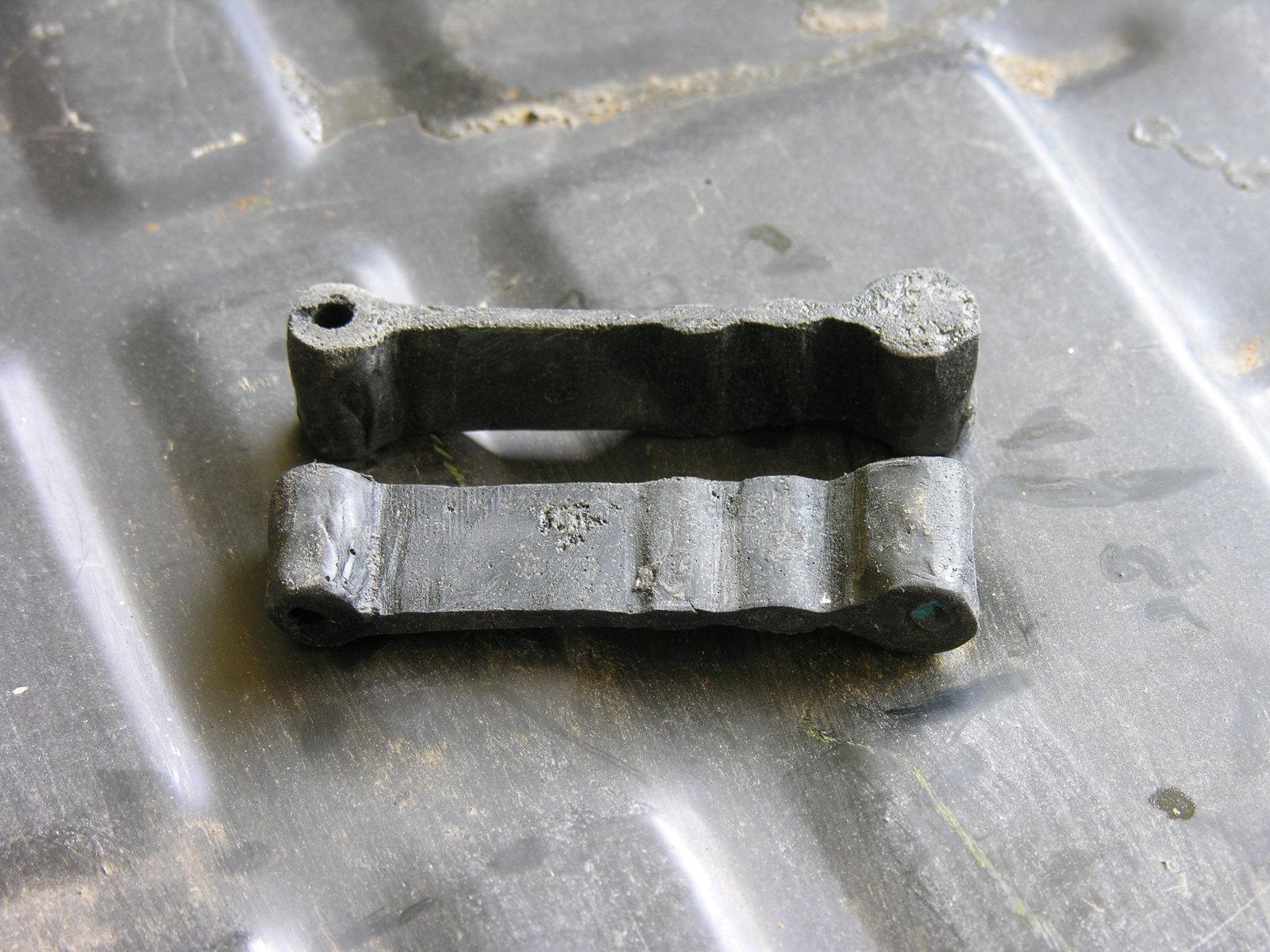

Redid my hinges and made door check straps by making a mould and pouring high impact polyurethane around the old metal straps. After a bit of filing they work good but who knows how long they'll last. The hinges ended up nice and stiff with no sag.

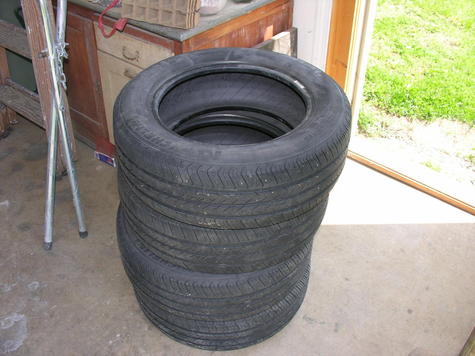

Got a set of used 185/65/r15 Michelin tires for $75 with a bunch of life left in them. Soon I won't have to inflate the tires every time I want to move the chassis. This is also the exact size I was looking for. Good deal all around.

I bought a set of 5 185/65/r15 tires on American Eagles and put two on the rear of the 70 Ghia I bought to move it. They are a tight fit. I plan on adding small flairs to my 73, which is the car I bought the tires for.

I got room. At worst I'll roll the lips over steel rod. It's going back on the chassis before the outside gets color.

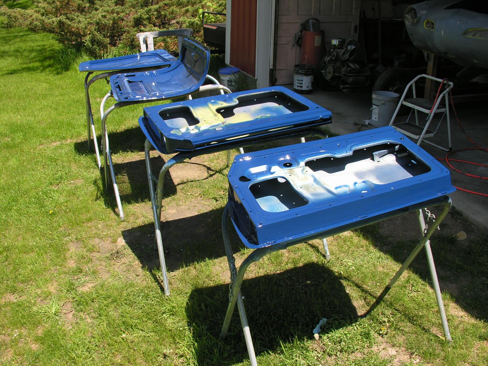

More painting

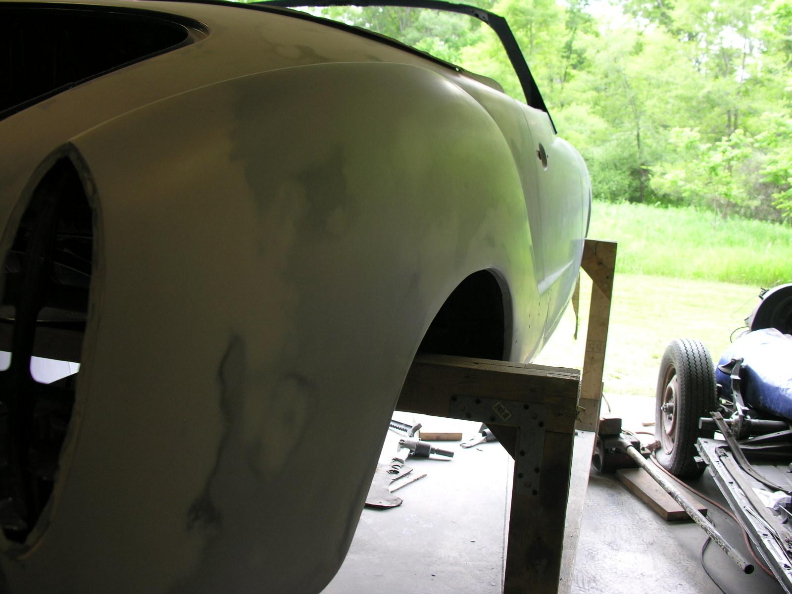

I managed to get to primer stage today. Ive been using some less expensive products since this in a budget build. I will say I've been very happy with Kirker enduro epoxy and their single stage urethanes. I've been using another brand of clear but I forget the name. My main requirement was that it have UV protection.
However Kirkers Perfect Prime is way too thick as mixed even with my 2.2 gun. had to thin it a bit. It also starts to thicken in the gun in no time, It would be fine for spot priming and it sands easy, but trying to prime a whole car with it is a nightmare.
I put down an epoxy sealer coat today and three coats of primer
I don't think I've seen the last of the filler I still have a few spots that will need attention.

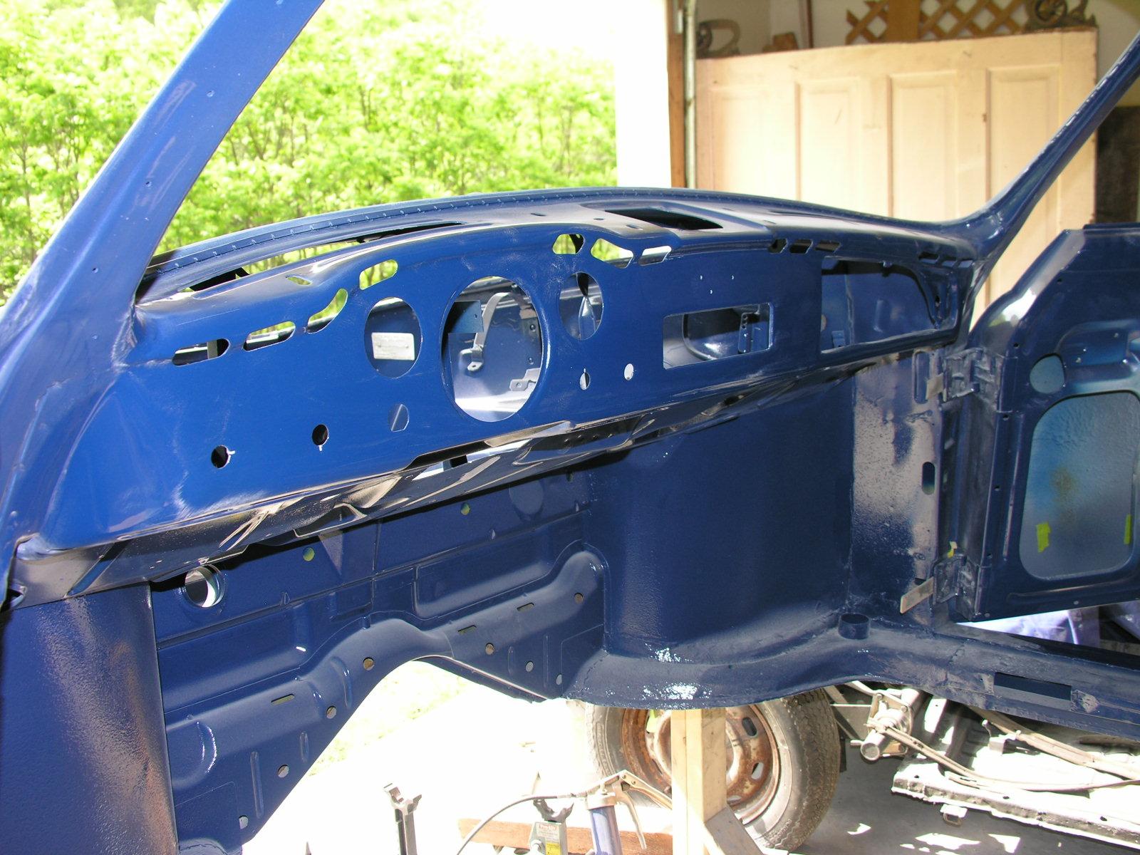

I painted the dash. It's a bit dusty in there.
A view of both sides primed and sanded. I blocked with 150 then 240 then went back and did some spot filling and priming, took it back to 240 then DA'd with 400. I need to scuff edges and sand one more time with 600-800 but, it's close.
