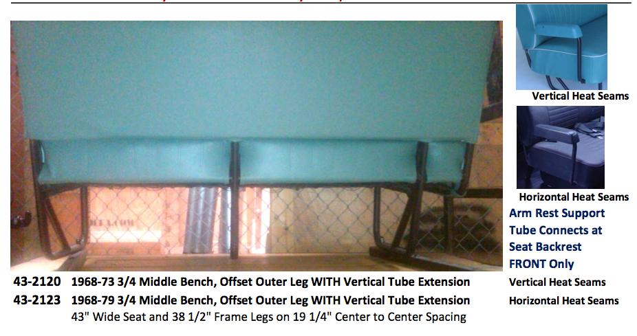

I am also checking to see what year this seat would be as TMI has 3 groupings for Bay seats: 68-73, 74-76 and 77-79. The arm rest comes from the front but there are no holes up top for head rests.

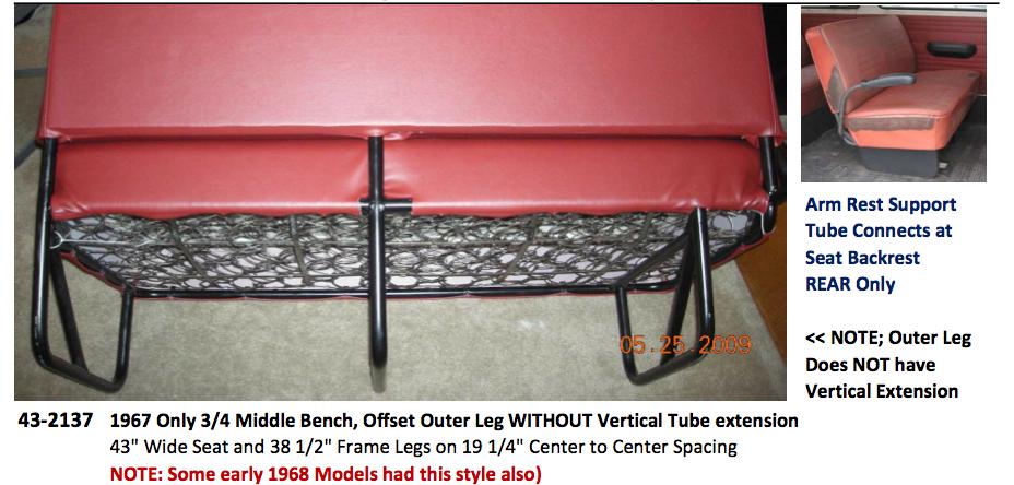

68-69 2/3 middle seats are different than the others. They are referred to as a hot dog armrest, like this:
VS the 70 and later style of this:

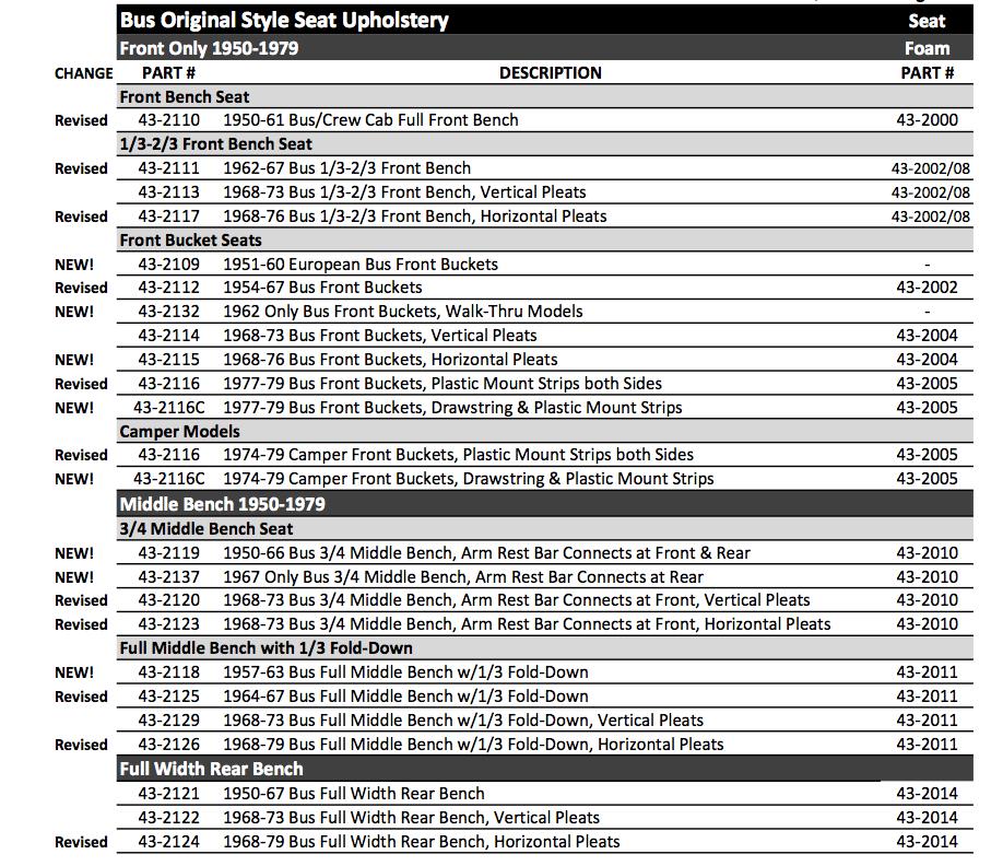

I just went through this....
It gets even goofier than you think. The frames have odd differences which changes the covers.
TMI emailed me a cheat sheat. I have it saved at home. I can post it later if you want

Alright folks, here are the charts skills@eurocarsplus sent me. All from TMI, posted with permission. I broke them up into multiple files to increase the size/quality.

Thanks for doing that! Now hopefully it will avoid confusion when ordering covers. If you need any help, Dean Satterfield is a super nice guy, and was a huge help at TMI. He gave permission to post these photos, and they are working on adding them to their site.
