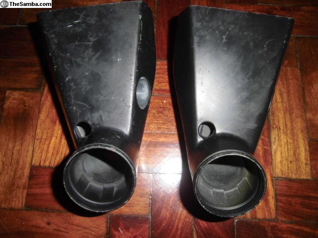

Can anyone tell me what year(s) these housings are for? They both have column lock posts so they must be 1970+.

Right side is like my 71 bay Surprised

PostPosted: Tue Nov 13, 2012 4:19 pm    Post subject: Reply with quote
LH is 68-69 and RH is 70-72

I assume these aren't interchangeable? They really don't look similar at all, but you know how camera angles can mess with things.
Anyone know from experience or just know?

PostPosted: Sat Dec 14, 2013 8:09 am    Post subject: Reply with quote
you assumed correctly.

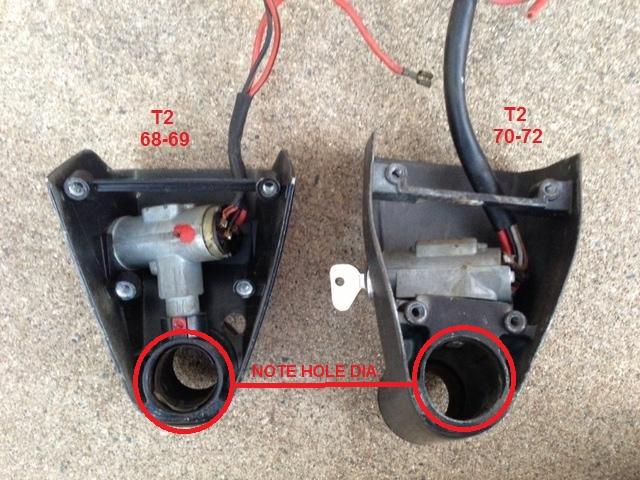

PostPosted: Mon May 12, 2014 10:45 am    Post subject: Ignition Lock Housing ID Reply with quote
It's been said that VW went to the longer housing when the padded dash was introduced.

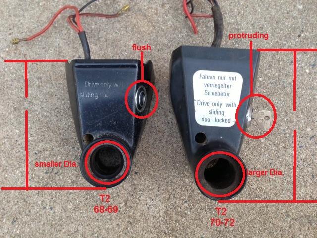

PostPosted: Fri Aug 28, 2015 5:06 pm    Post subject: Ignition Housing Reply with quote

PostPosted: Tue Sep 27, 2016 7:24 pm    Post subject: Re: Ignition Housing barrow Identification Reply with quote
Ignition/Steering Lock ID

PostPosted: Tue Sep 27, 2016 7:29 pm    Post subject: Re: Ignition Lock Housing ID Reply with quote
68 had a padded dash, no cut out for the column pod. all wires ran through a hole in the face of the dash in the same area the lights switches were in. iirc it wasn't until late 69 that the dash got cut into the profile of the 70-72 column pod and the pod went "into" the dash a hair.
non padded dashes had a thin "u" shaped rubber gasket on the front of the pod where it met with the dash too
another fun fact is the 68-70 pods had the "drive with door..." warning water transfer decal on them and 71 up had the silver sticker
