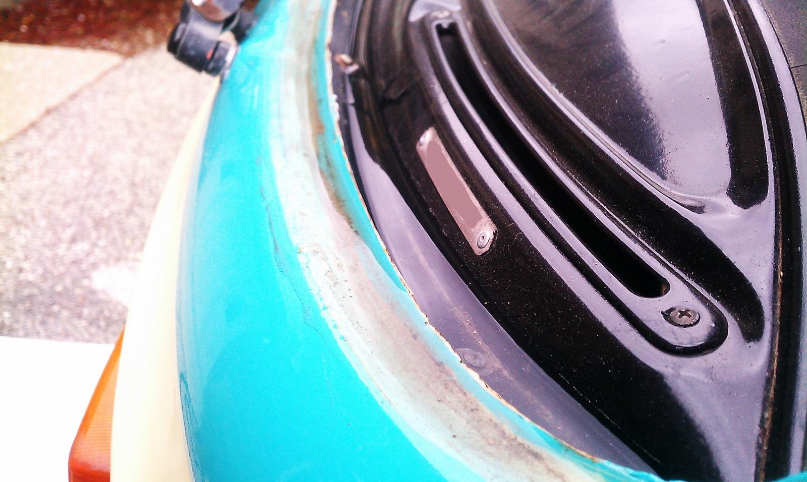

Next, remove the windshield (in my case the seal was already installed on the windshield, and the whole unit just resting in the body recess) and sponge out the standing water on your dash.

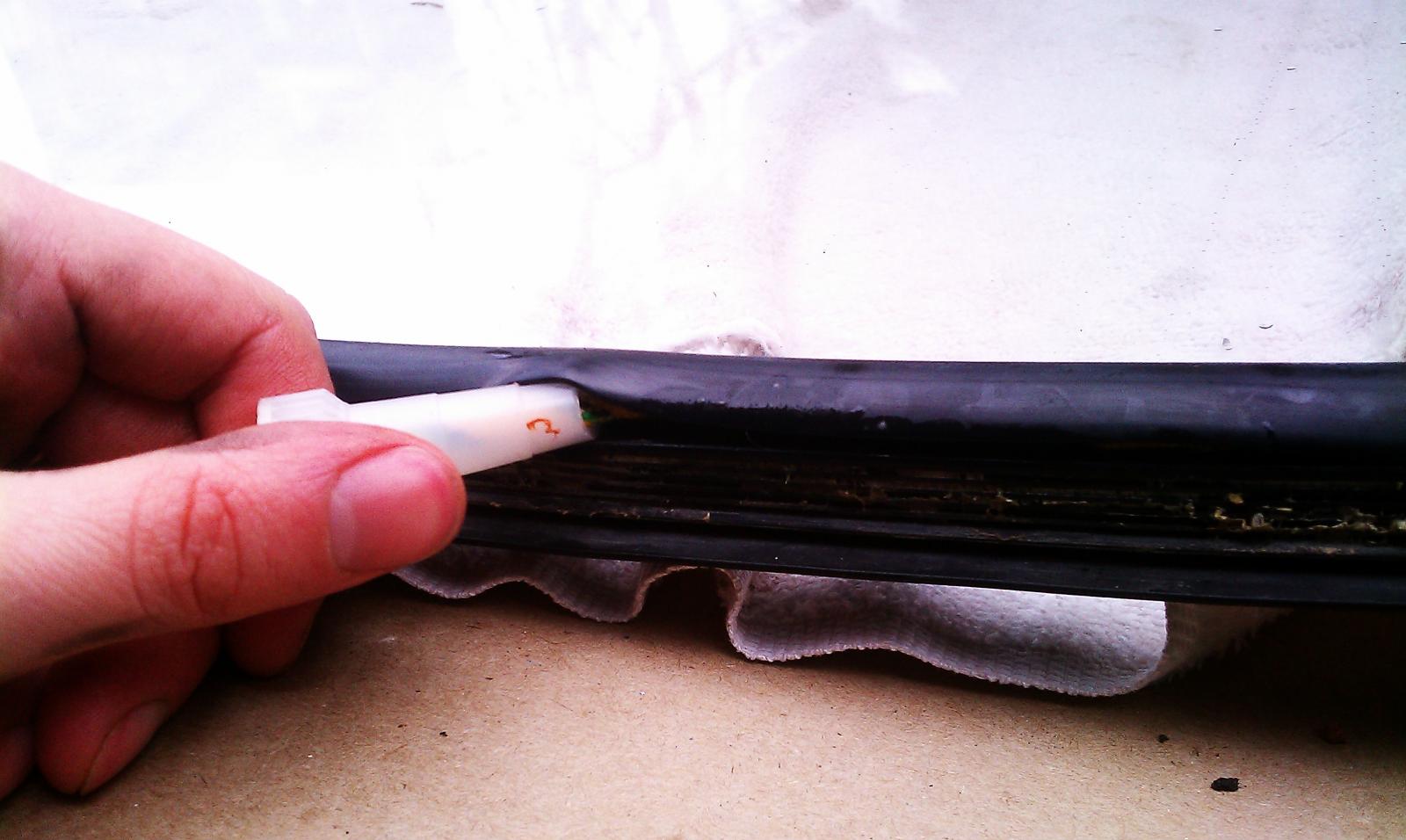

While that dries, fill the Tupperware with Simple Green, and soak the cord in it. The Simple Green acts as a lubricant that will neither absorb water, which you don’t want under the seal, nor will it attack the rubber of the seal. As the cord is soaking, find a caulk tube topper thing (the little white thing in my hand in these pictures). Spray everything with Simple Green. Cut it so the cord passes through easily. Thread a cord end through the caulk tube thing and into the seal. Using the caulk topper to spread the rubber lips of the seal, run the cord in the lip around the entire windshield twice, ending about a foot past the center of the top of the windshield on both sides. Leave about six inches of cord hanging out of the lip on either side of the center.

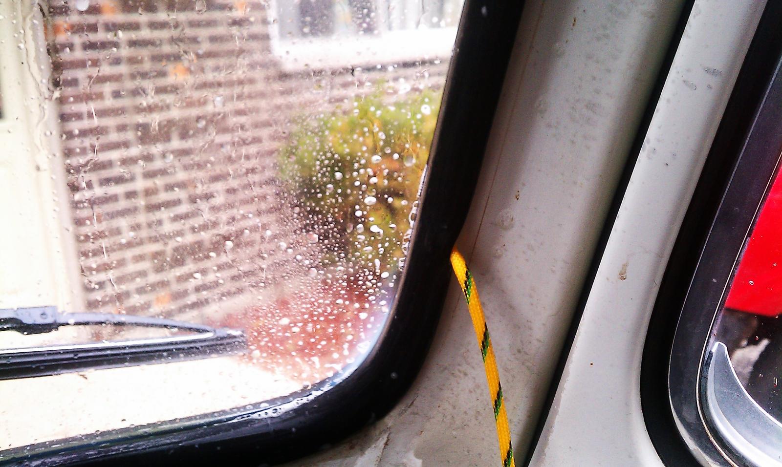

Spray the rubber seal and the sealing surface of the bus body with Simple Green, and help your friend set and position the windshield in the hole. Once in place, get inside the bus (you’re pulling the seal lip from the outside of the bus across the lip into the inside of the bus), start pulling the cord ends evenly, a few inches each side at a time, 90 degrees to the seal. If everything is set correctly, when you pull the cord out, the seal will be forced to the inside sealing surface of the body lip, securing the windshield. In certain places, it might help to have your friend put a small amount of pressure on the windshield from the outside. Too much pressure will make it more difficult, however.
And that’s it. Our windshield went in the first time around with the cord. I had the second wrap of cord in the seal as a backup, but it was not needed.
Steps to install a windshield:
1. Gather materials
2. Lube seal with Simple Green, install on windshield
3. Soak cord in Simple Green, use caulk tube top to insert cord into seal where it will interface with the bus body.
4. Spray everything with Simple Green again
5. Position windshield in body opening
6. Pull string out of seal from inside the bus, rolling the seal lip to the inside of the bus.
