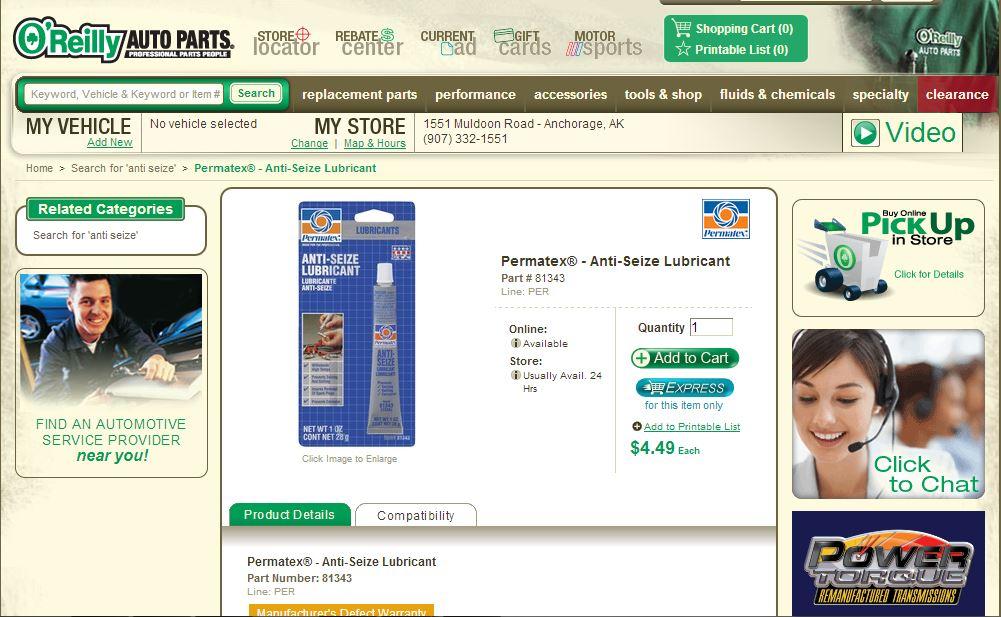

PostPosted: Wed Jun 11, 2014 9:17 pm    Post subject: Heli-Coil Spark Plug Thread Repair, Save A Thread Reply with quote
http://www.oreillyauto.com/site/c/detail/HEL0/5334...]Heli-Coil
JB Weld
Anti-Seize
Good Luck
