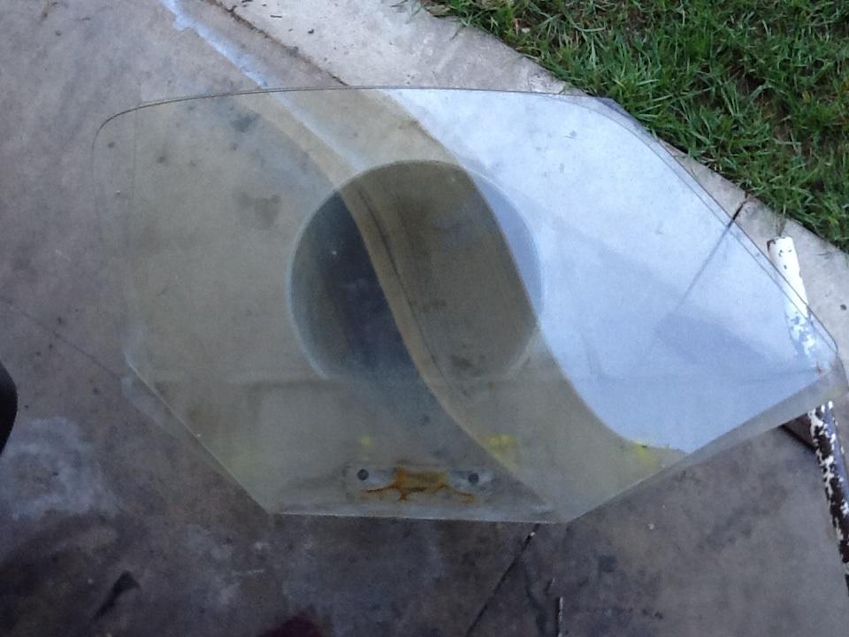

I was putting the door windows in. I thought it would be good to see just how different coupe and convertible door windows are. The answer is dramatically. The mounting holes are lined up in this photo.

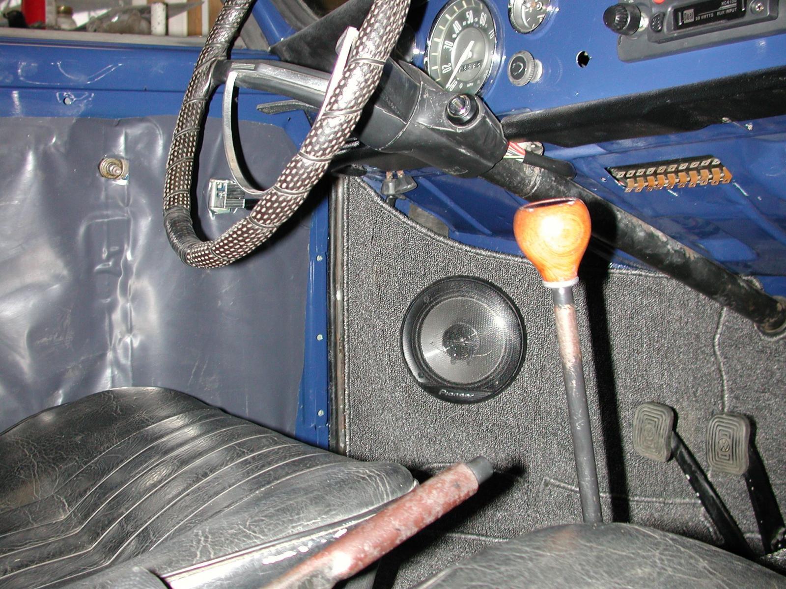

Not the best pictures. I put down some padding for under the carpet. I just used a couple of $7 harbor frieght walking pads. Closed cell poly foam, about 3/8 inch thick. The carpet is TMI salt and pepper gray loop. The fit is pretty good. A good price point. I wanted something that would hide a little dirt.
kman
Joined: November 04, 2005
Posts: 739
Location: Michigan
kman is offline
PostPosted: Fri Dec 12, 2014 3:02 pm    Post subject: Reply with quote
Worked on the interior a bit more today. Slow going. Used some 8mil black plastic and contact cement for the inside of the door panels.
The in cleaned up and installed the passenger panel (I reglued the pocket in).
I wish the Left door panel were in as good of shape, its waterdamaged, dried up at the bottom and has a speaker hole cut in it so I'm going to see if I can do some surgery to it before I use it.
I installed the seats and drove it around the yard a couple times. Hopefully the last time I need to do this (fun isn't it).
I've been leaving the patina on some things. I hate to erase all the character a car has. The emergency brake handle and shift rod aren't really this brown looking. The flash kind of did that. The electrical tape and steering wheel wrap are kind of growing on me.
