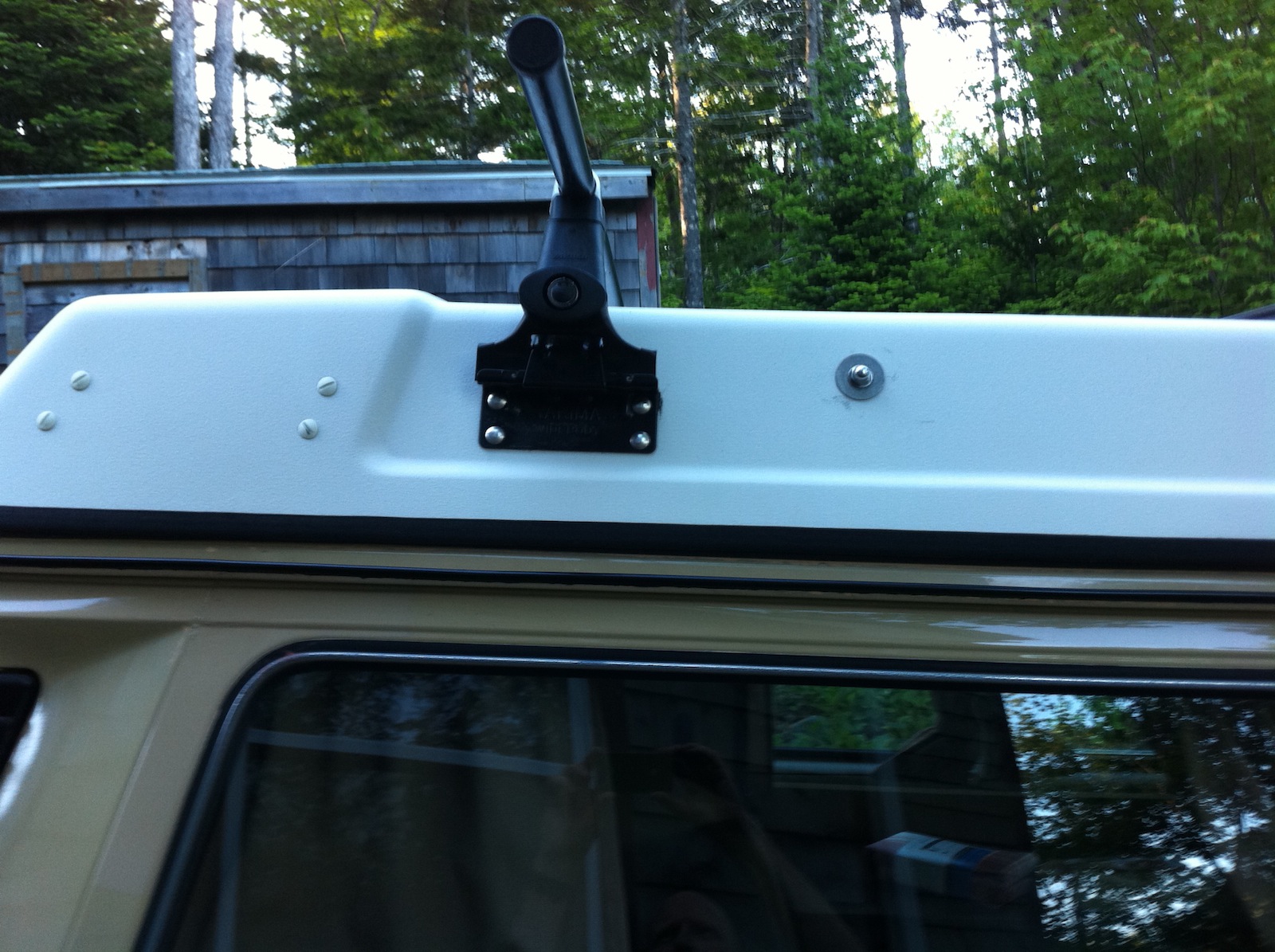

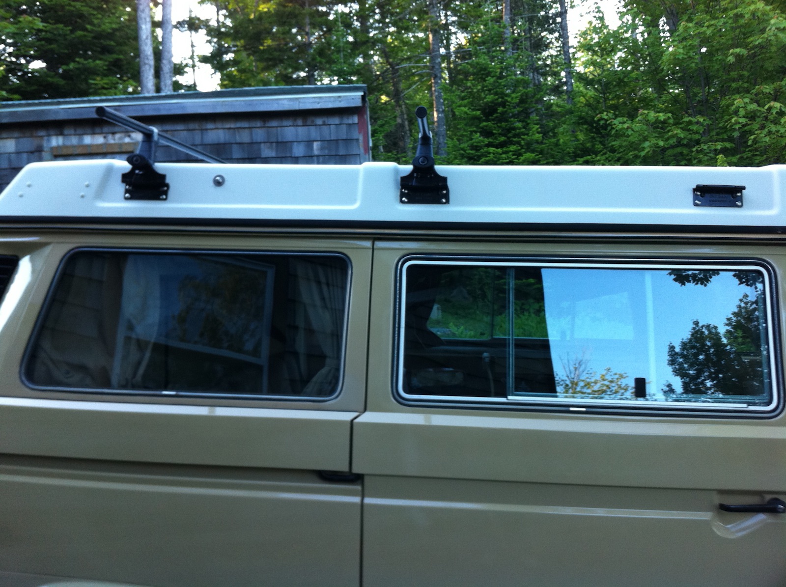

Just thought I'd add my set up for your consideration...
I installed my racks last year before I bought the shocks from JB. I had cut all the bolts for the ARG's when I installed them to be flush with the nuts. When I installed the shocks my only concern was clearance for the bolts. No worries...it works fine.
The funny thing is...now that I'm all set up with racks...I don't see myself using them very much. They are too high for ease of use. Down the road when the kids are not interested, they will be great for two kayaks. I could have held off for a few years. I set up my little trailer with the roof box and yak racks. It's easier to load/unload.

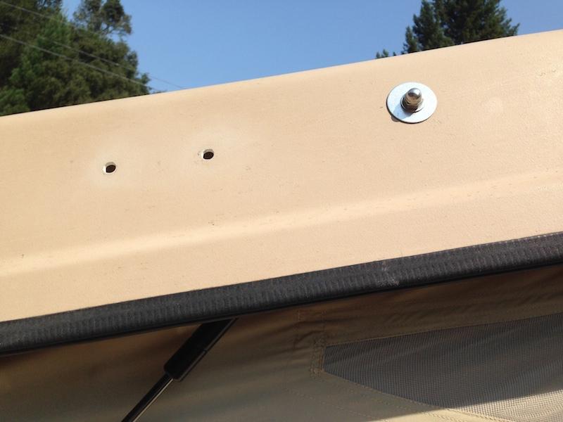

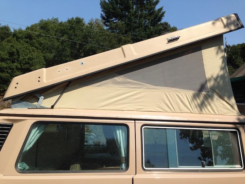

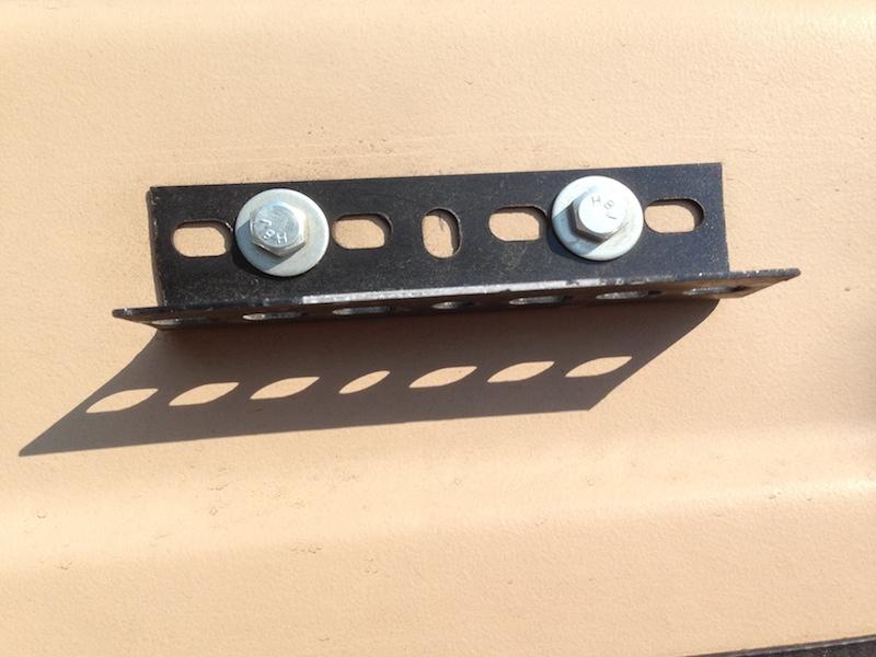

Right, so the PO installed Yakima Racks and installed fake ARGs. Really it's just some angle iron and it looks bad, but worked.
So then I install the pop top shocks and have remove the rear set of them. Also the box I have will only span 36", so I'd have to move at least one pair any way...
I'm tempted to complete replace them with Yakima ARGs. Put one back behind the strut (possibly using the rearmost existing hole) and then move the middle one to be centered 36" foreword of that (after the bump). That way I have an option of adding a third up front later on.
Which leaves the holes. Crying or Very sad
I saw a recommendation for Solarez Ding Repair. Is that enough? Or do I need something stronger.
Pictures:
Anyone see problems with the plan?
