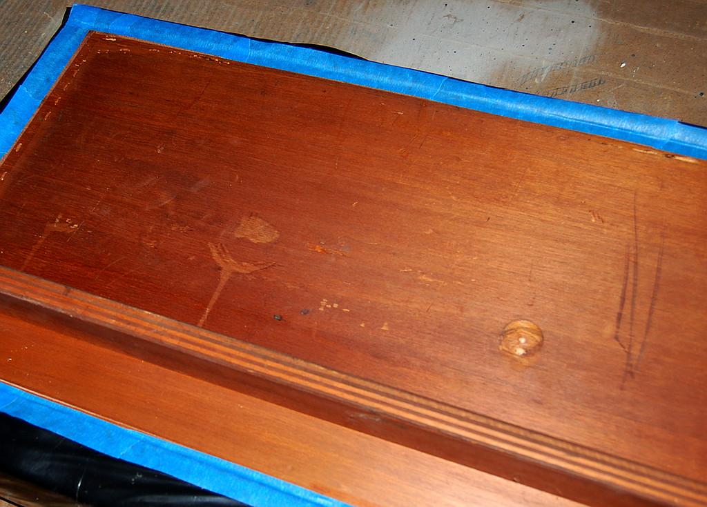

As mentioned, the seat back wood was pretty abused. The wood is a very thin Mahogany veneer glued over a cheaper fir or pine. It doesn't take much to sand right through the veneer when trying to remove gouges and scratches. If that happens, you'll have a HUGE problem on your hands trying to make it look right.
The cheesy seat cover installation had left about 100 deep gouges and punctures around the perimeter of the wood. There was no way to repair this without replacing the wood itself and I had no intention of opening that can of worms. (No, you can't fix this with wood filler. Rolling Eyes) The black cloth tape normally used to cover the upholstery seam would be widened to cover the staple marks.
The plan would be to block sand overall with 180, then wipe down with lacquer thinner / acetone several times to remove as much of the old varnish and stain as possible. Then a combination of block and spot sanding with 180 would be used to remove as many imperfections as I felt possible. Since the work would be extensive, I would use a gel stain (Minwax Cherrywood) to even out the tone of the wood. Finally, a few coats of wipe-on Satin Polyurethane varnish would be applied, sanding with 220 between coats, finished with a final coat of spray Poly varnish. This process has served me well with the other cabinetry.
It would be necessary to seal off the upholstery from this mess, so I would use a yard bag cut to size and then sealed at the working edge with painter's tape.
I wasn't too worried about cleaning up those stains and drips, but the thought of trying to sand out those gouges and scars put real FEAR in my heart Crying or Very sad . Perfect could truly be the enemy of the Good. Here's a closer look:
The process works. It's a combination of skill and luck. Here's a photo of it on a very messy workbench, refinished:
With my wife's skillful application of the slightly wider black border tape, the old staple marks "go away". No longer crappy! Very Happy

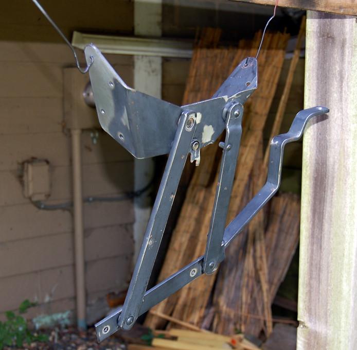

OK, so we've got a couple of nice seat sections now, but it doesn't do much good without something to hold them together.

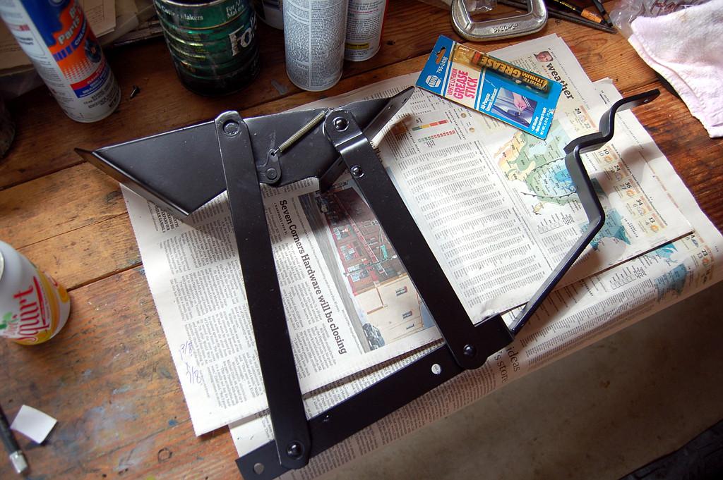

Things began in hinge-land with getting the latching mechanism squared away. I found a good replacement for that overextended spring by cutting down and re-forming the end of one from the hardware store. The tips of the small pivoting latch arms were bent such that one was basically smashed tight against its base, no longer able to move. Prying and filing got them back in good shape.
One thing I hadn't noticed before was that the hinges and seat bottom support arms originally had closed cell foam tape applied to the surfaces where they contacted the seat. I took note of the locations so as to duplicate after painting.
You could tell the hinges were originally dipped in paint, a common practice with parts that are difficult to spray due to hidden surfaces. As I would be spraying new paint, I opted not to strip the hinges bare, else I would have had plenty of trouble getting in the tight overlaps. There was no need to make the hinges look pretty, but they certainly needed to be sanded down to remove plenty of peeling and chipped paint as well as allow good adhesion for new paint. Big job - really thick OG paint and lots and lots of nooks and crannies! Here's one, sanded and ready to paint:
Here's a refinished hinge, greased up a bit, with new "anti-scuff" pad in place. Oh yeah, those are grease smudges, not paint defects. Wink
Yeah, I know. Hinges aren't real exciting. Let's put the damn thing together...

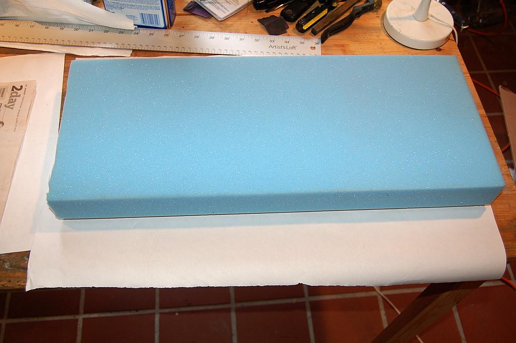

A new piece of polyurethane foam was bought from "The Foam Factory" I noticed the OG foam was very dense, so used "Lux Foam, High Quality", the densest stuff they had. It seems right!
Once the new foam was glued onto the board using 3M Super 77 spray glue (sprayed both board and foam for best bonding), the new cover was stretched on and aligned.
Everything back in place. A rented electric power stapler was used to install new staples all around. Sanded backside will be easier on the woodgrain wall panel if it rubs at all.

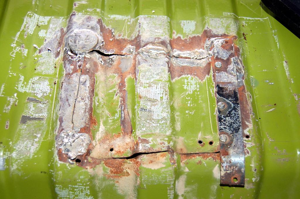

You might have noticed silver duct tape sticking out in some of the recent photos of the rear of the bus. That was an embarrassment we inherited from a Previous Owner, and covered over the remains of his fuel sender replacement job. I wanted to clean it up some and make sure it was properly sealed off before putting the rear seat in the way. Simple enough, right?
Oh, so wrong.
Under the duct tape, this abomination lurked, words for which can scarcely describe.
Let's take a look inside, shall we?
It's no surprise to find that when the gates of hell are opened, demons lurk within ... or lurked. And when I say "demons", I'm referring to those wonderful rodents that took such good care of the bus all these years.
The amazing thing? The fuel sender was still working! But, no sooner had I thoroughly cleaned the debris away, I pulled off the ground wire and the sender's terminal disintegrated in my hand! Shocked So now not only did I have to fix the rubbish access hole hack, I had to replace the sender. That rear seat was not going in any time soon. Crying or Very sad
Here's a shiny new sender, calibrated, tested and installed. Before I put it in place, I had a good look around inside the tank. You'd never know it from the rodent pee induced scale on the outside, but the inside of the tank looked real good! WHEW! The surface rust will be dealt with down the road when an opportunity to pull the tank arises.
Back to the "metalwork".
Some fool had blindly drilled a BIG pilot hole, apparently realized he was far off his target and just started cutting a rough, oversized box, way bigger than necessary. What's more, he didn't stick to the horizontal surface, which would at least keep things simple. Oh no, he just kind of went nuts cutting down into the curve where the floor goes more vertical.
It doesn't stop there. Once the fuel sender was replaced, the floor cutout was SOLDERED back in place. Not welded, not brazed, but soldered and not in a way showing any actual skill at doing so. To top it off, a metal hardware store plug was then soldered into that big pilot hole.
As best as I could tell, the access hole had been opened a second time. This time, someone took a saw to the solder work and then once done with the job, used some scrap steel strips and screws to hold thing back together. Two strips for four sides, with some feeble attempt to resolder the remaining sides. Real rocket scientists. Rolling Eyes
First thing was to remove all the blobs of solder. There was plenty. A soldering iron or gun wasn't going to cut it. I had to use a propane torch and a wooden stick to push the solder away!Why yes, working inches from a fuel tank with a propane torch is very stressful!
With most of the solder removed, I hit it with a grinder to finally get it smooth. The results, before final sanding:
The "fix".
The goal was to strengthen the cut out area and seal it off from any fumes or what-have-you. Toward this end, we formed a cover plate out of 20 ga. galvanized steel, bent and formed to fit. The plate was then gasketed in such a way as to form a good seal all around. Before installing the plate, the bare metal was treated to self-etching primer and paint. Obviously, no effort was made to use matching paint, as a) I still don't have paint that matches, b) this is a temporary fix and c) will not be visible once the rear cushion is in place.
Installed.
It's ugly, amateur and a temporary fix, but a strong and safe one that allows the camper to be used until a welded solution replaces it down the road.

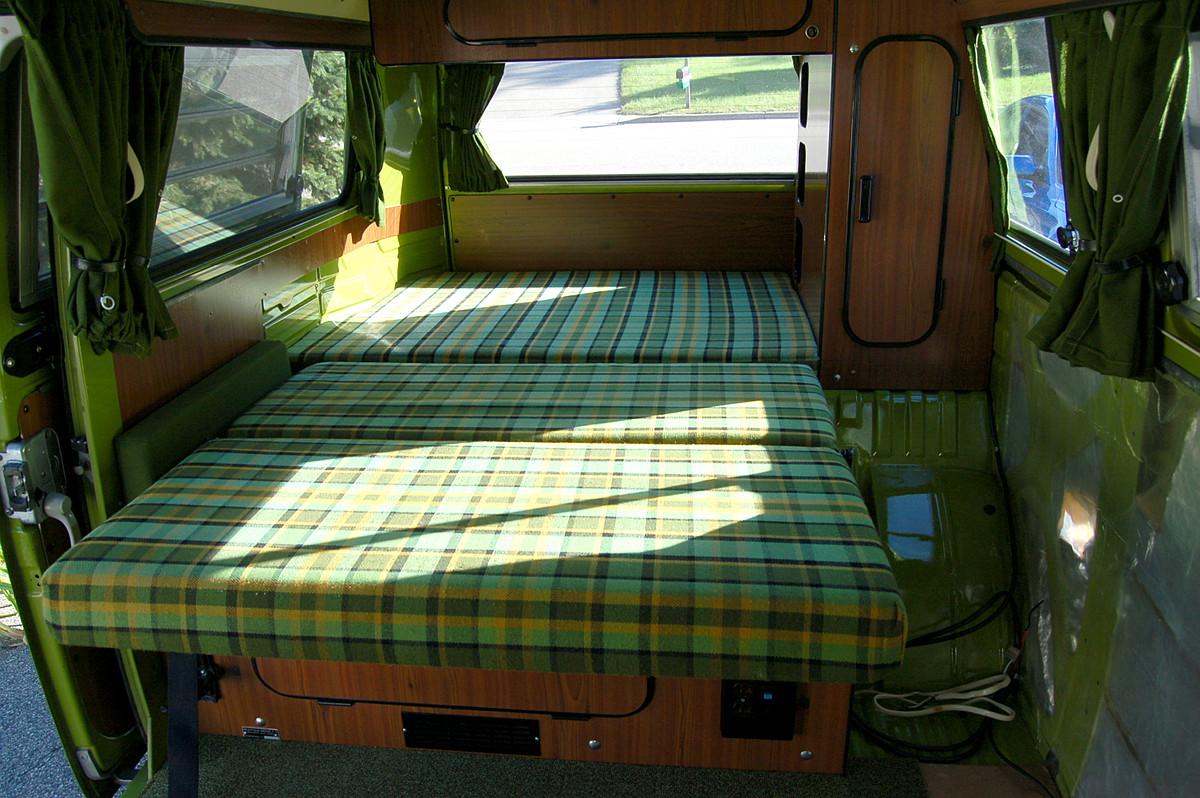

Rear Seat / Bed (Z-Bed) Refresh Final: installed!

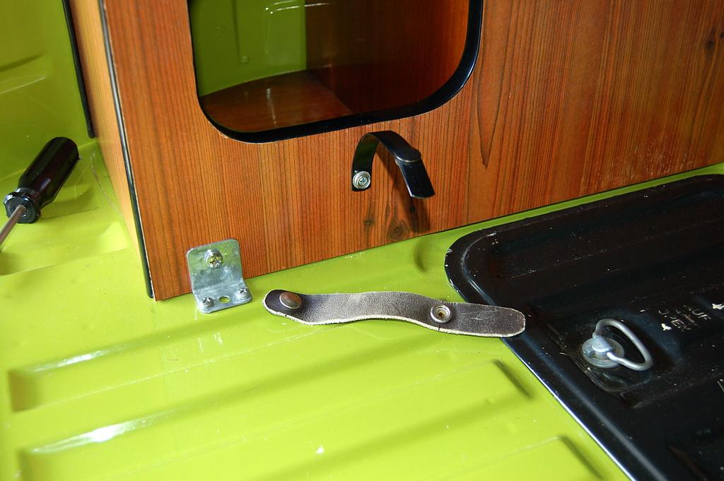

Never seemed like we'd get here. With a good cleaning and waxing of the area behind the seat, there was no longer "one more thing ..."! Very Happy
The seat was slid in place and bolted down. Half-ass details can be found in this Westfalia Repair Manual.
Have a seat!
Or a nap! Hinges and mechanisms work great!

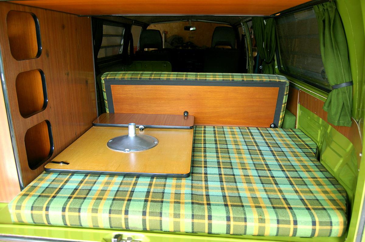

Let's go around to the back side.
I was finally able to tie up a loose end over on the closet cabinet. The table is secured to closet by a small strap. A PO had replaced the OG strap with the lovely grey one you see resting here. I didn't know if the PO's replacement was the right length, so waited until I could put the table into its storage spot before sizing a new one. This is cut down from a curtain strap and is now identical to OG. Note: on this '76 model, the strap is attached near the rear of the closet and table. On later models, the strap is moved up closer to the middle of both.
The restored table is now at home where it belongs. What do you think of the new, improved view from the rear?
One last look from the front. This interior is's actually starting to take shape!

Yes, I think I would recommend that same foam I used on the armrest for the bed/seat cushions. It's pretty firm, but so are the OG ones. My recommendation would be to get a small sample and see for yourself, as it's a pretty big commitment to buy that much foam without at least feeling it for yourself first.
