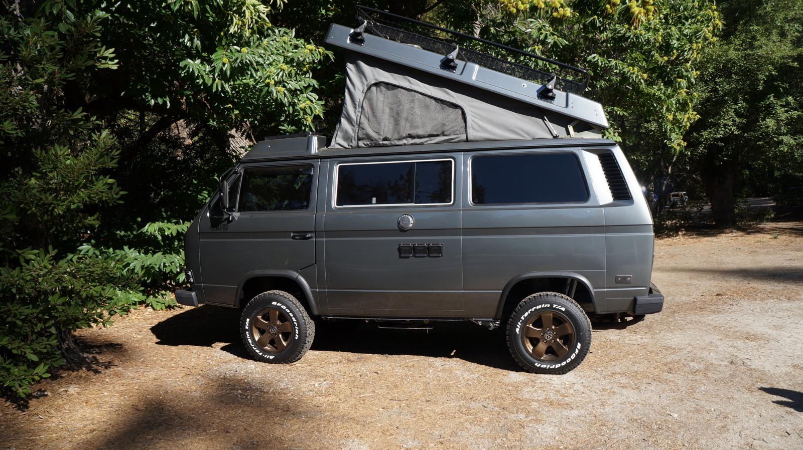

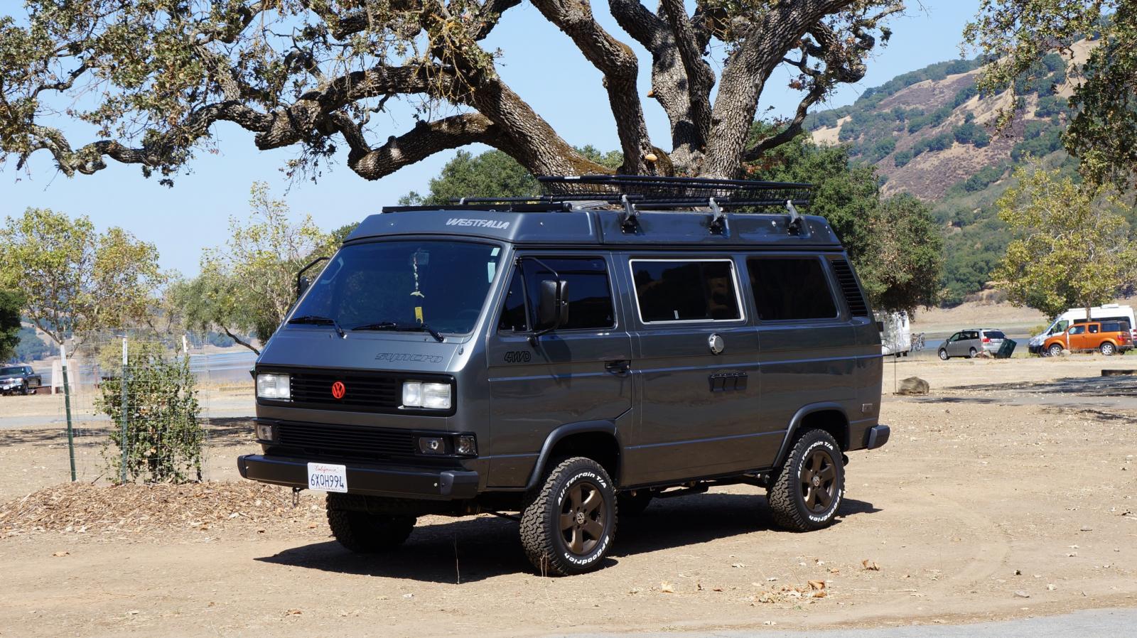

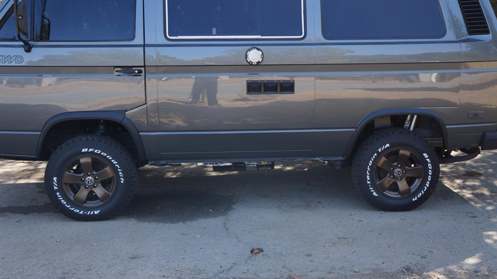

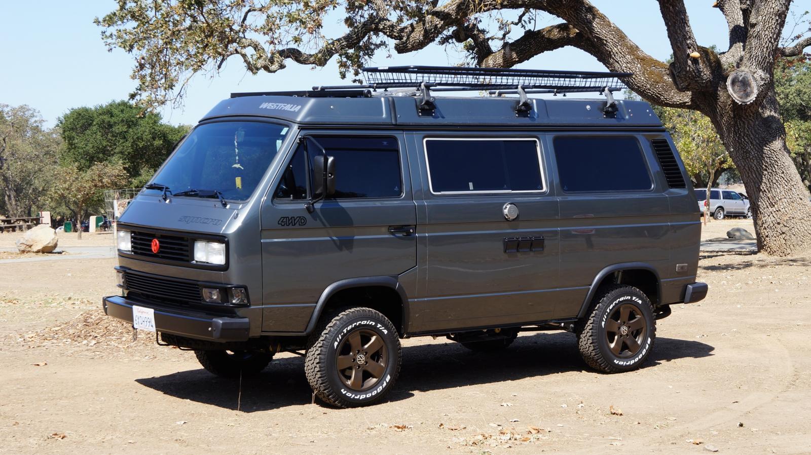

VC Carrot 15" rims powder coated bronze, 215/17/15 BFG's
I was nervous as hell about getting the brand new rims powder coated!!
I am very happy with how it turned out against the wolf-man grey. The camera doesn't do them justice!
All inspiration came from members on here cheers.
I know they will prob get scraped up, off roading etc....., but I will always know she was pretty once Laughing Laughing Laughing Laughing
