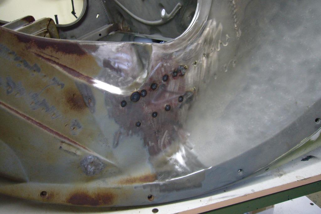

Another quick session in the shed. Seems like I only can grab an hour here and there at the moment. A bit frustrating!
Got the lower lip dialed in, plug welded the inner frame and finished cleaning up the join inside and out. Also added some spot welds to help hide the fact that the front had been grafted on.
Just the other side to do now.
