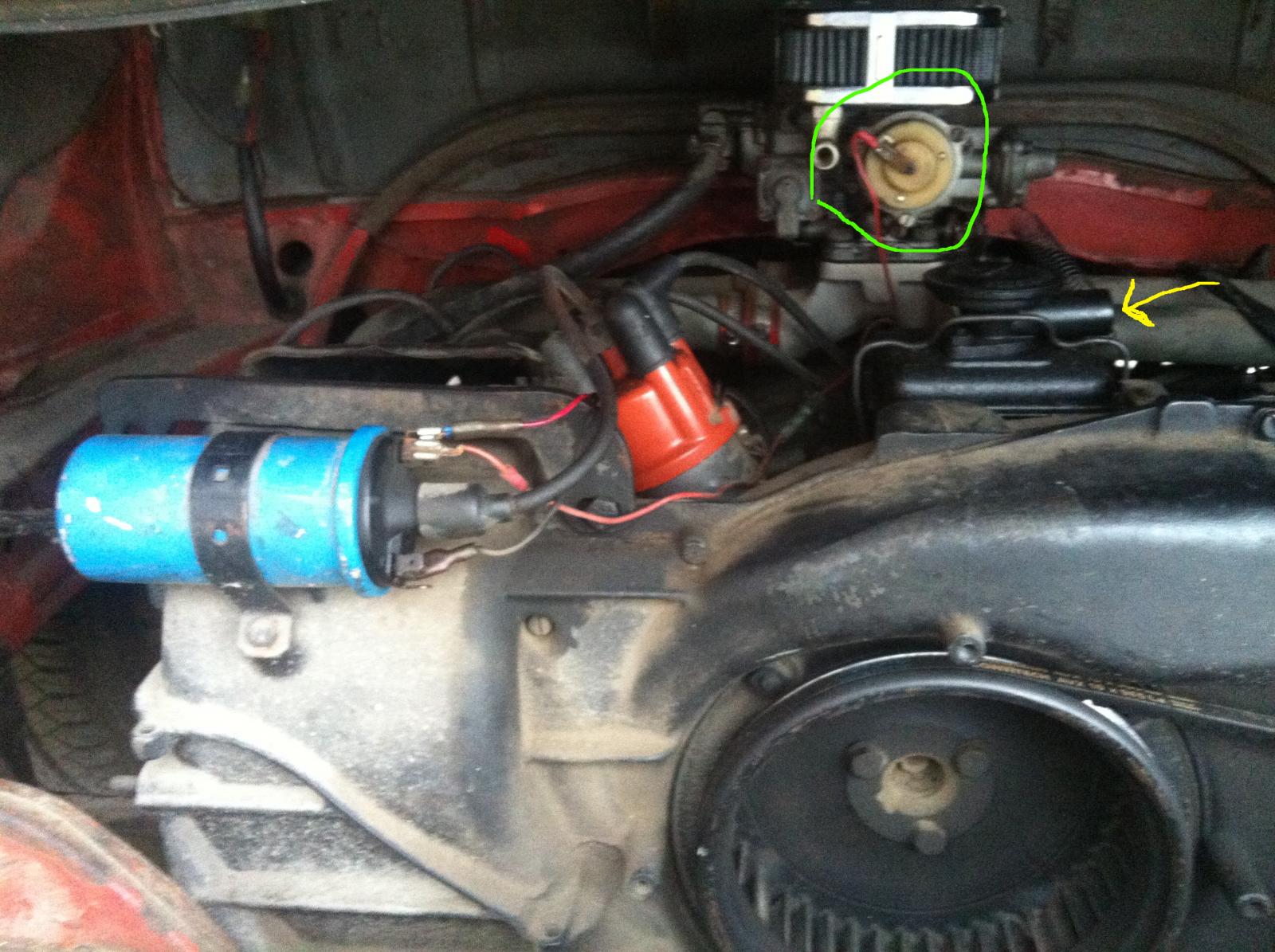

Here are a couple of pictures of the engine. I marked one of them with a yellow arrow (indicating where a little bit of smoke was coming from) and circled in green (where the mechanic was adjusting the three screws on the white plastic thing).
As far as the piping hot rims issue, they were amazingly hot. But that problem is totally solved and it's not locking up. The van has a whole other issue now.
The mechanic mentioned something about pistons or lacking compression. I'm trying to find someone else to give advice locally, but there aren't a lot of people here that work on these things. I wrote to the local chapter and have received no reply and their last get together was a long time ago (according to their website). So I'm still trying on that front.

PostPosted: Sat Dec 20, 2014 3:47 pm    Post subject: Reply with quote
It may help if we knew where "around here" is.
How long have you been running it with no tin surrounding the engine?, you shouldn't be able to see any road from above, your compression issue may be related to the lack of cooling your engine has been experiencing.
